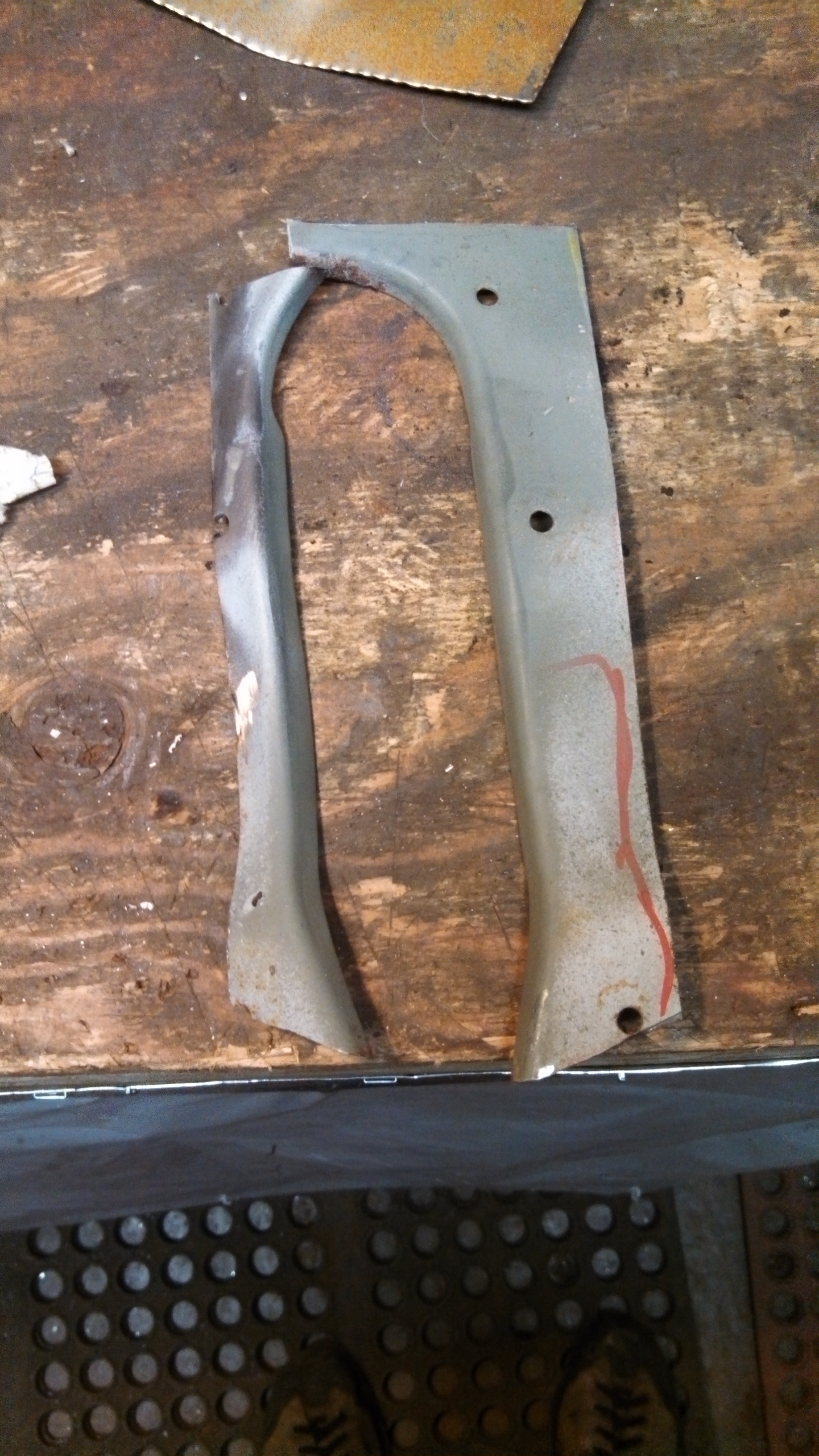

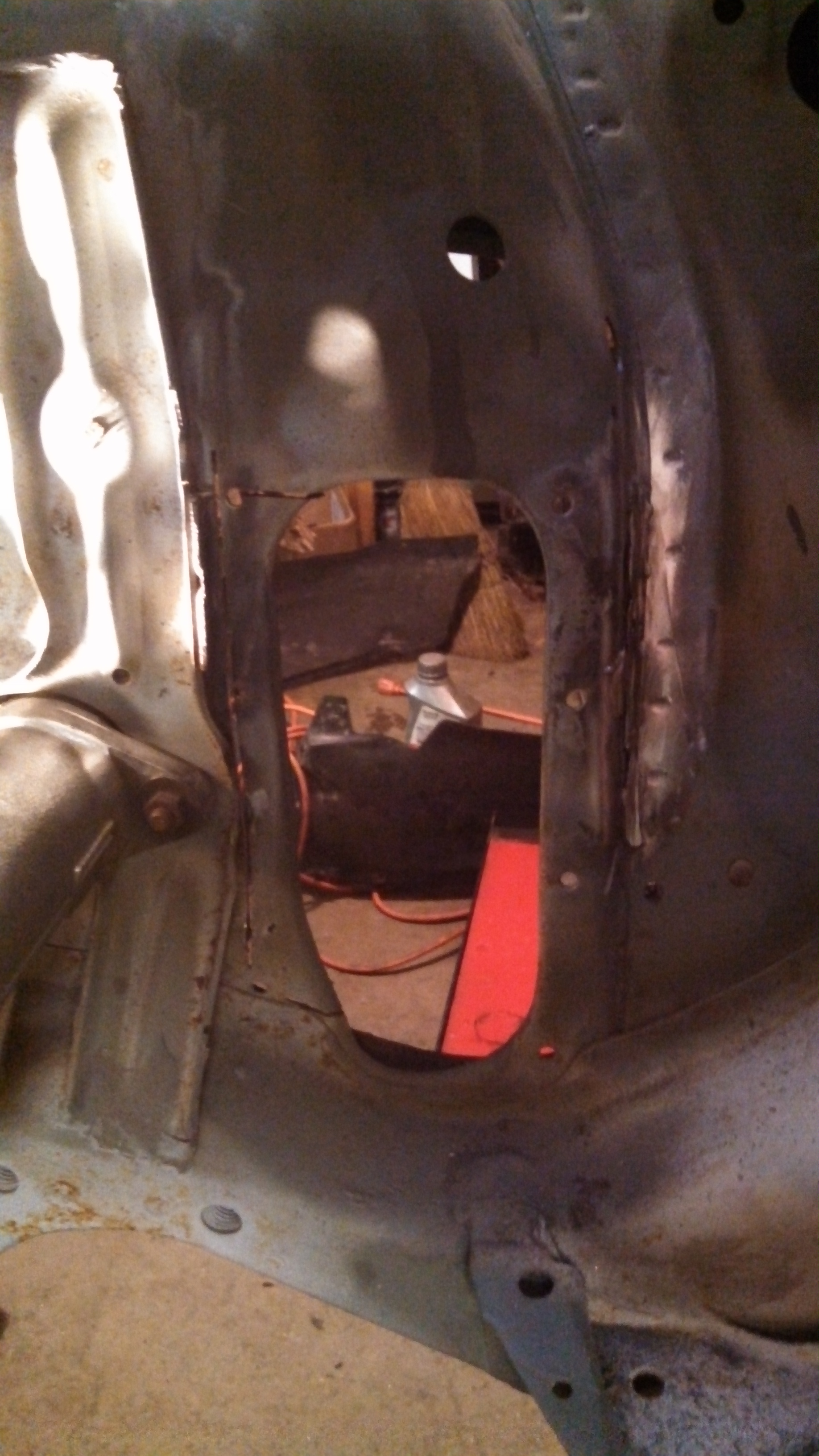

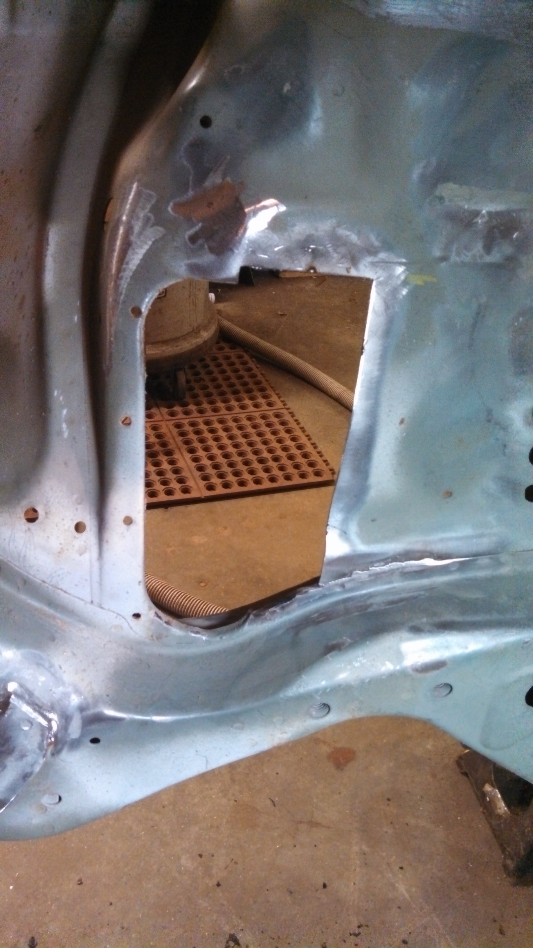

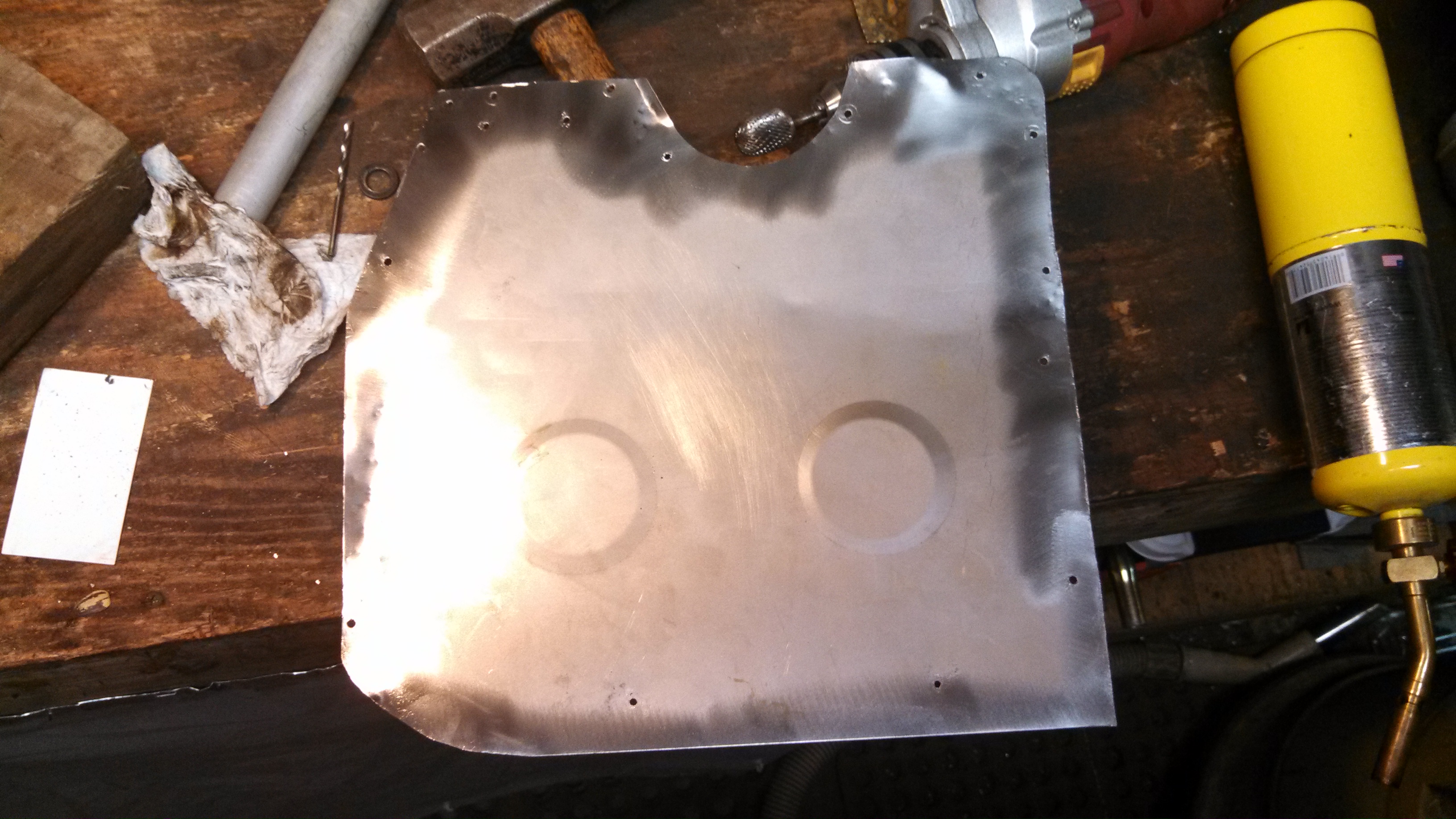

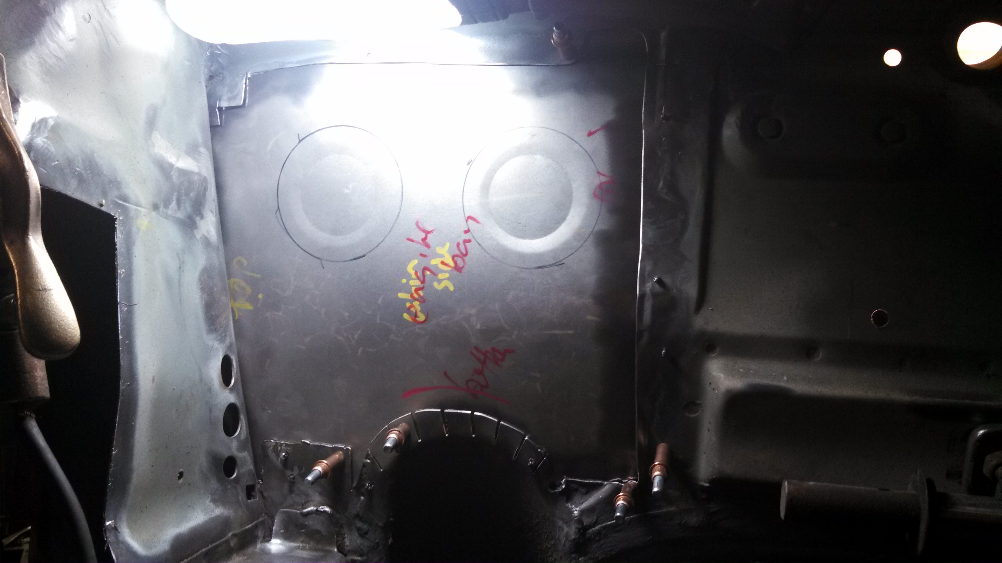

I got the DP relief area cut out and prepped for welding
DP relief area to be filled.jpg (1.61 MiB) Viewed 38747 times
DP relief area to be filled2.jpg (1.88 MiB) Viewed 38747 times
dp relief ready for final prep.jpg (1.38 MiB) Viewed 38747 times
I put a pair of simples in the sheet to help strengthen it.
DP relief dimpled.jpg (1.64 MiB) Viewed 38747 times
Here it is all prepped and ready for welding.
DP relief ready to weld bayside.jpg (1.21 MiB) Viewed 38747 times

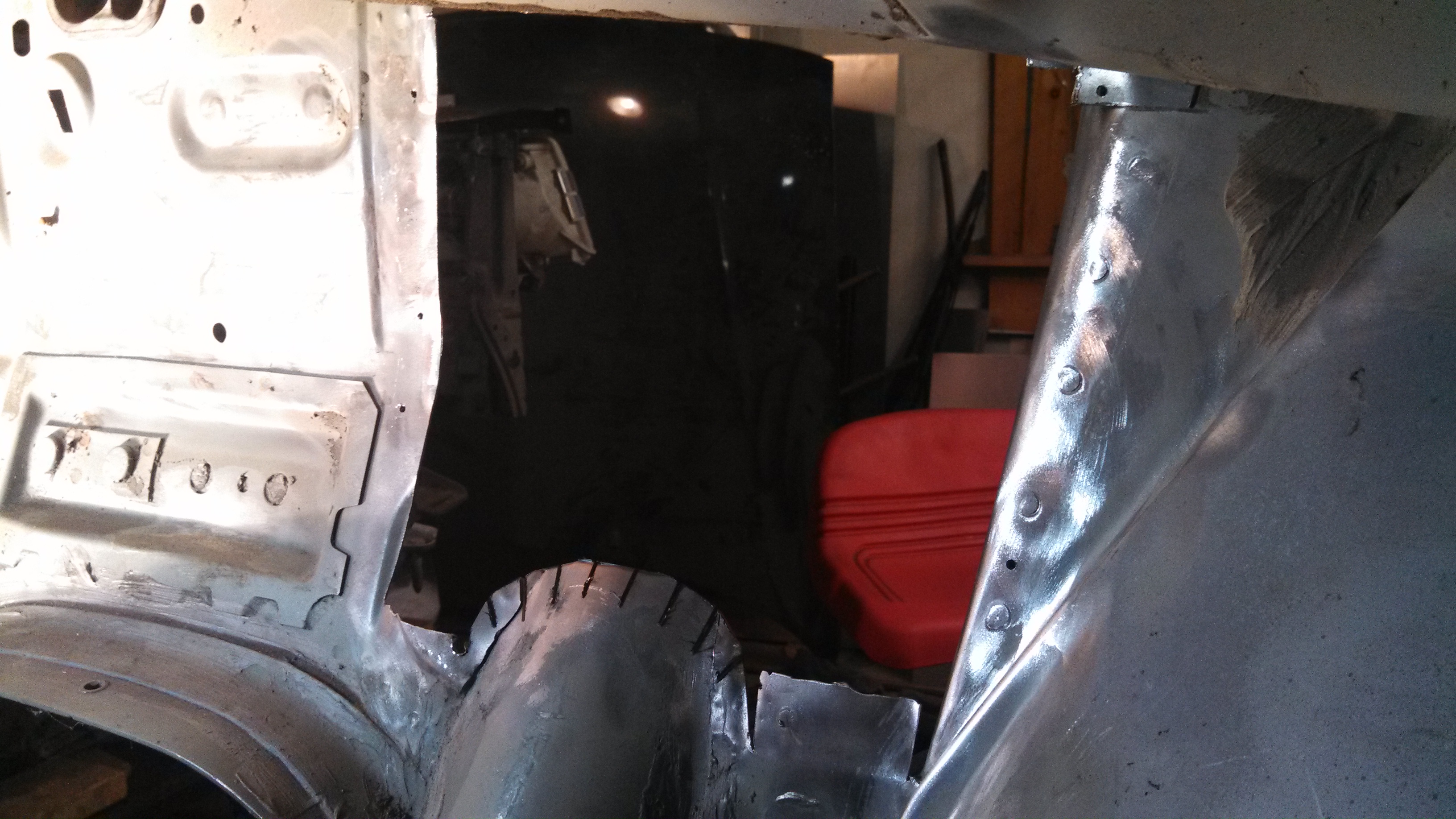

All welded up, getting a lot better with sheet metal.
DP relief welded engine bay side.jpg (1.49 MiB) Viewed 38747 times
DP relief welded engine bay side upclose.jpg (1.57 MiB) Viewed 38747 times
DP relief welded inside cabin.jpg (1.45 MiB) Viewed 38747 times
DP relief welded inside cabin upclose.jpg (1.74 MiB) Viewed 38747 times

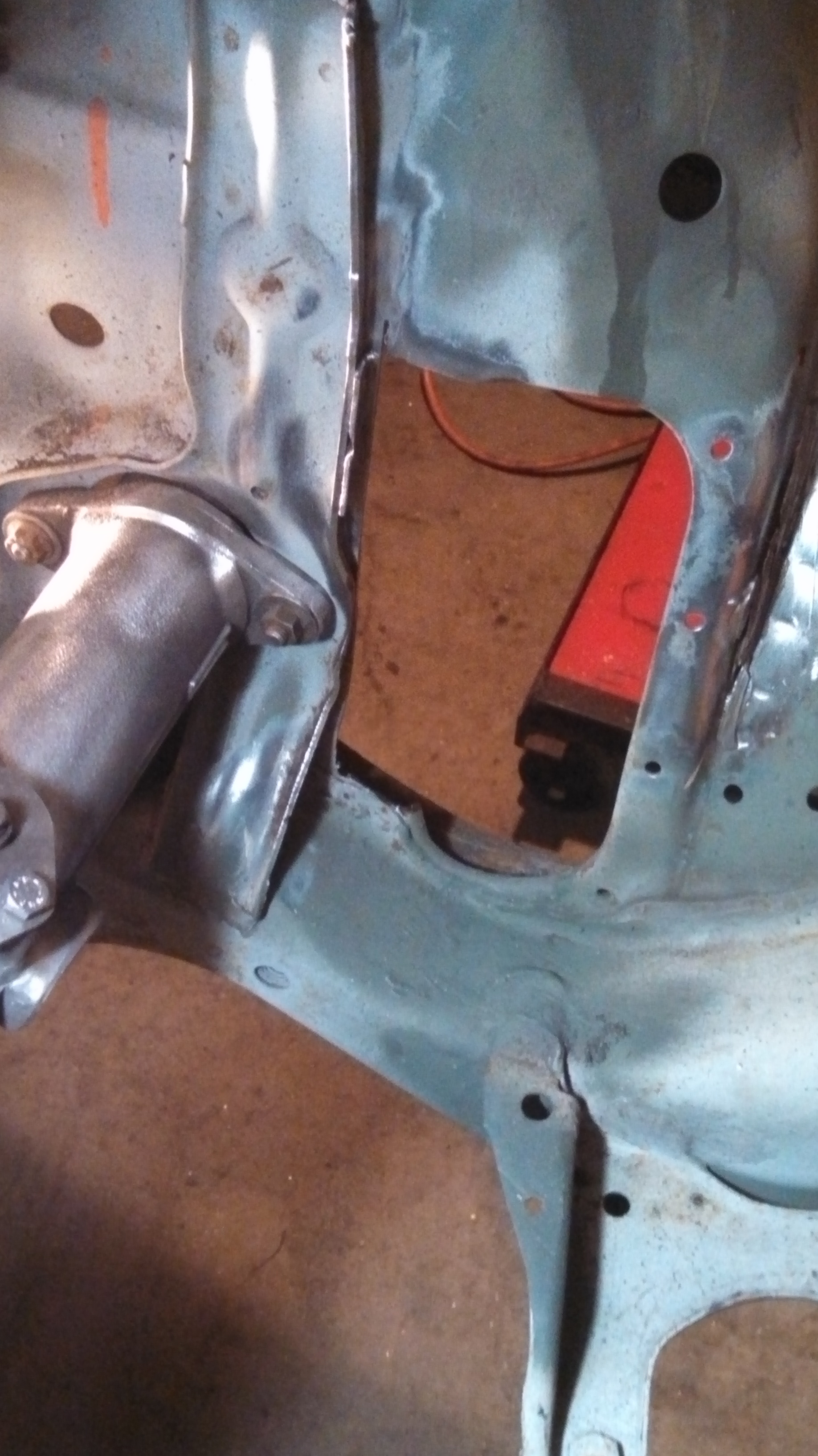

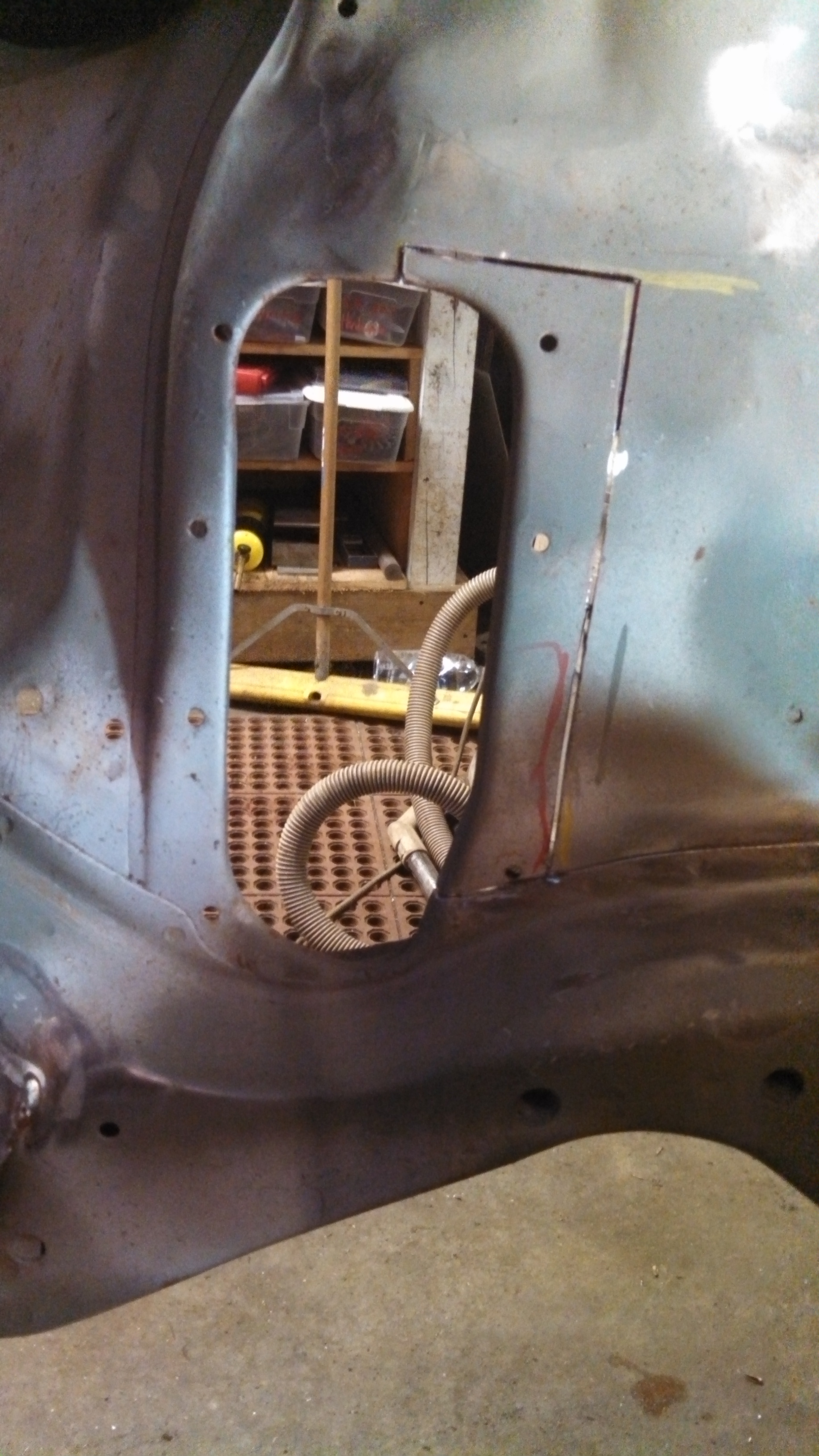

Since I’m running HT Motorsport steering arms on my uprights, the steering rods themselves have several different setup positions. In order to be able to utilize the full range of adjustment, I needed to open up my steering arm holes in the chassis, and move the rearward a bit.
Cutting them out.
cutting out Drivers steering arm hole.jpg (1.24 MiB) Viewed 38747 times
cutting out pass steering arm hole.jpg (1.39 MiB) Viewed 38747 times
Here they are, now in larger format ahah
drivers side steering arm hole cutout.jpg (1.09 MiB) Viewed 38747 times
pass side steering arm hole cutout.jpg (1.41 MiB) Viewed 38747 times
And here are the pieces that will get cleaned up, and welded back on a bit further rearward.
steering arm holes surrounds cut out.jpg (1.77 MiB) Viewed 38747 times

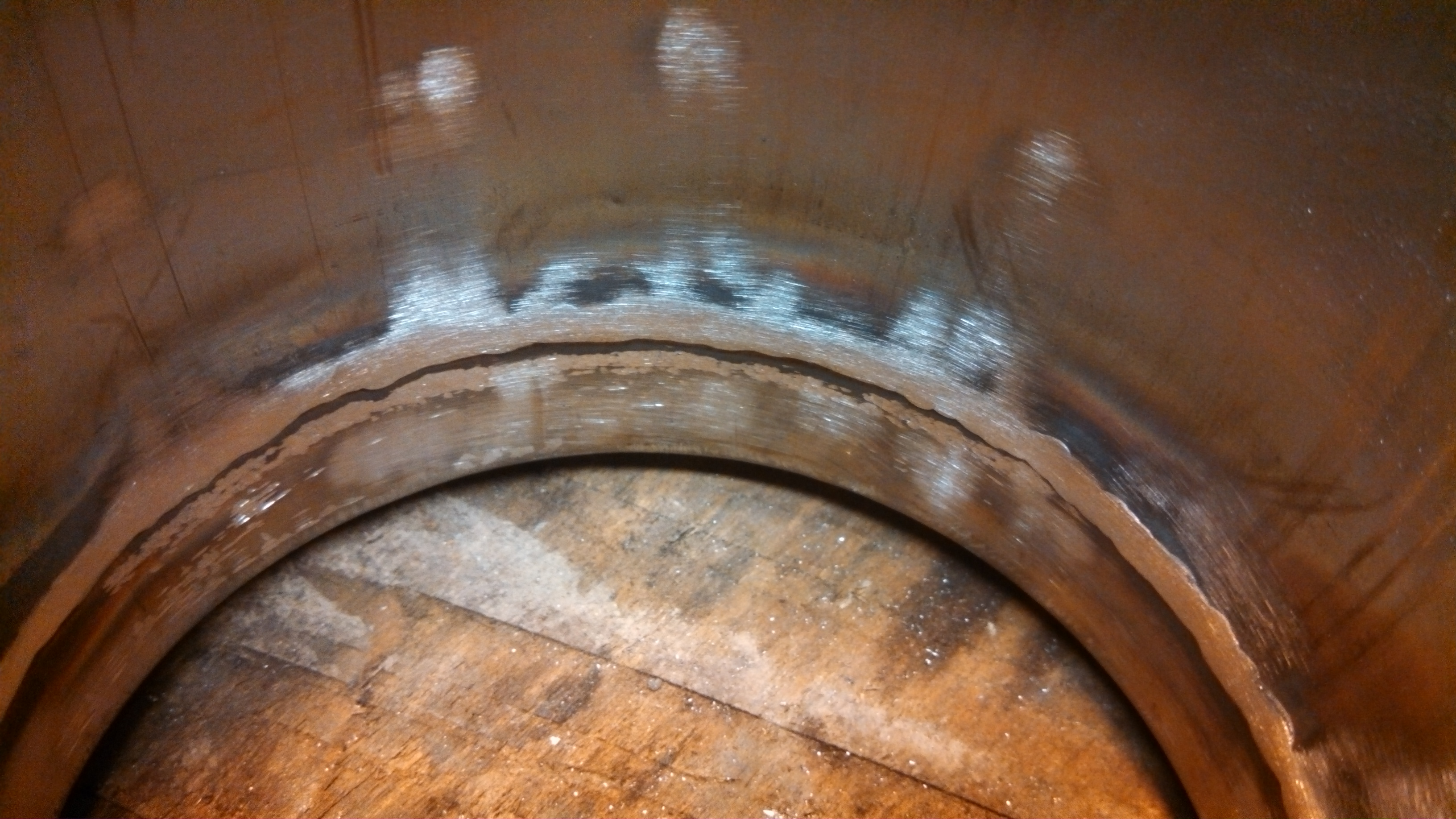

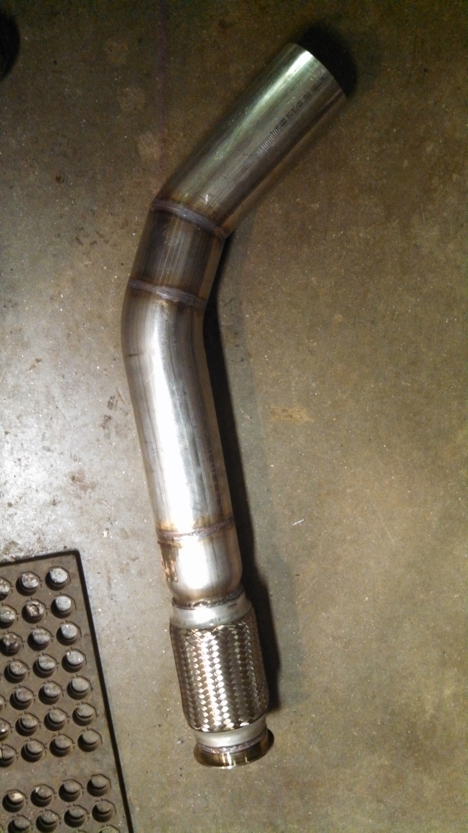

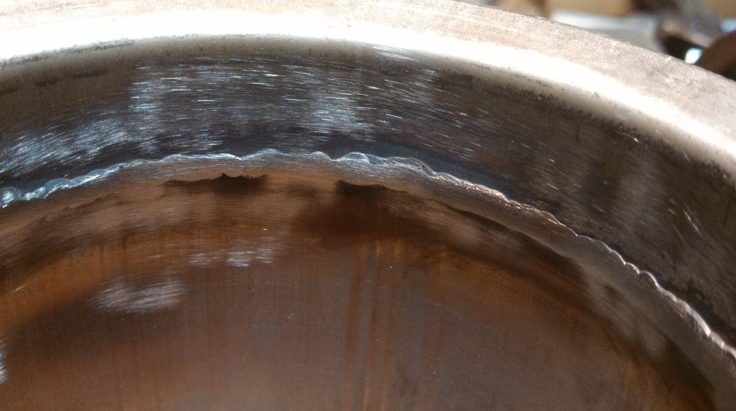

I had Ryan seam weld the inner and outer where the DP meets its v-band. I hit the inside with a carbide bit and then flappered it to clean it up a bit, all in the name of FLOW!!
dp inner cleaned up.jpg (1.62 MiB) Viewed 38747 times
dp inner cleaned up detail.jpg (1.58 MiB) Viewed 38747 times

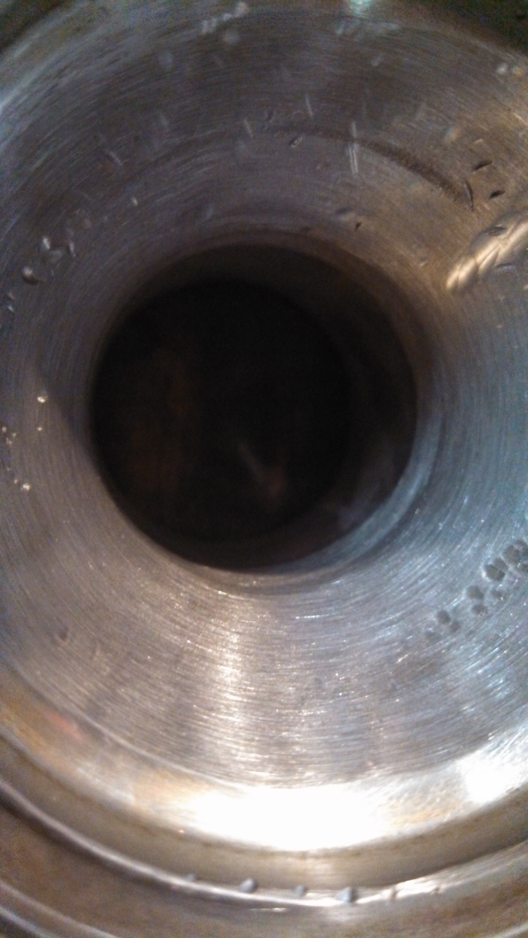

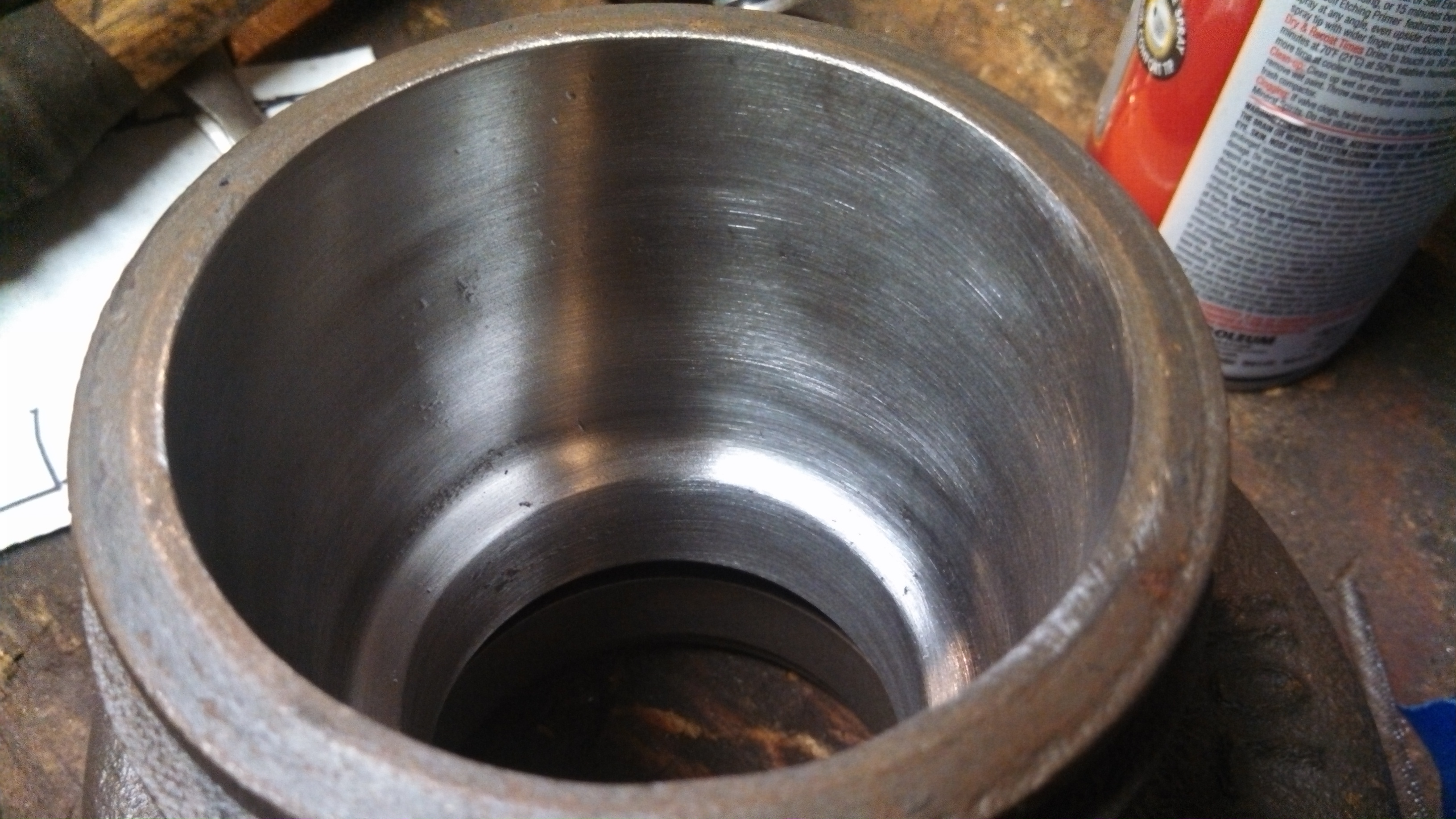

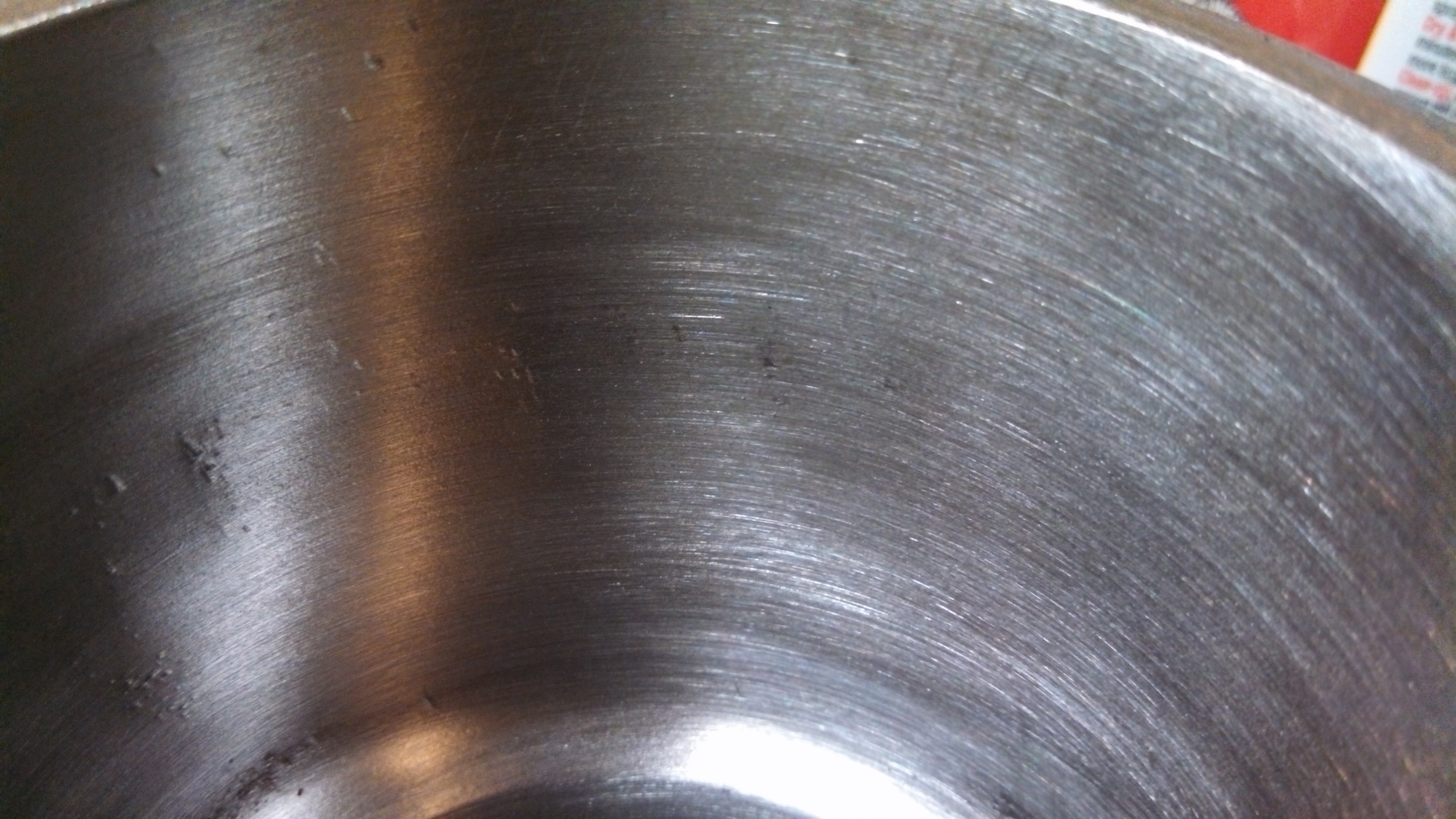

I also removed all the casting marks and cleaned up the inside of the Holset hotside. It’s now all nice and shiny, needs a bit more polishing but its 95% there
hotside cleaned up.jpg (1.53 MiB) Viewed 38747 times
hotside casting cleaned up detail.jpg (1.51 MiB) Viewed 38747 times

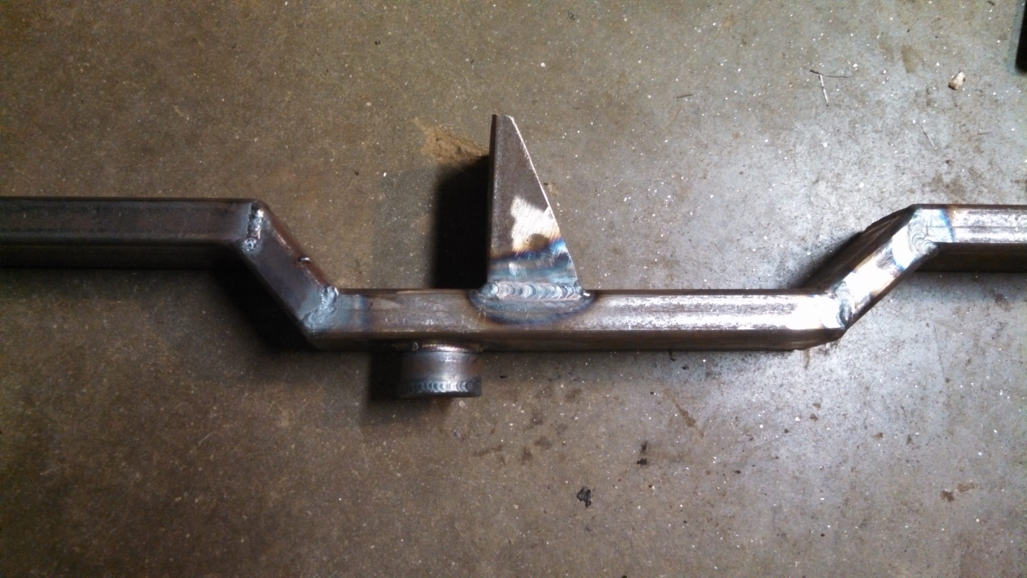

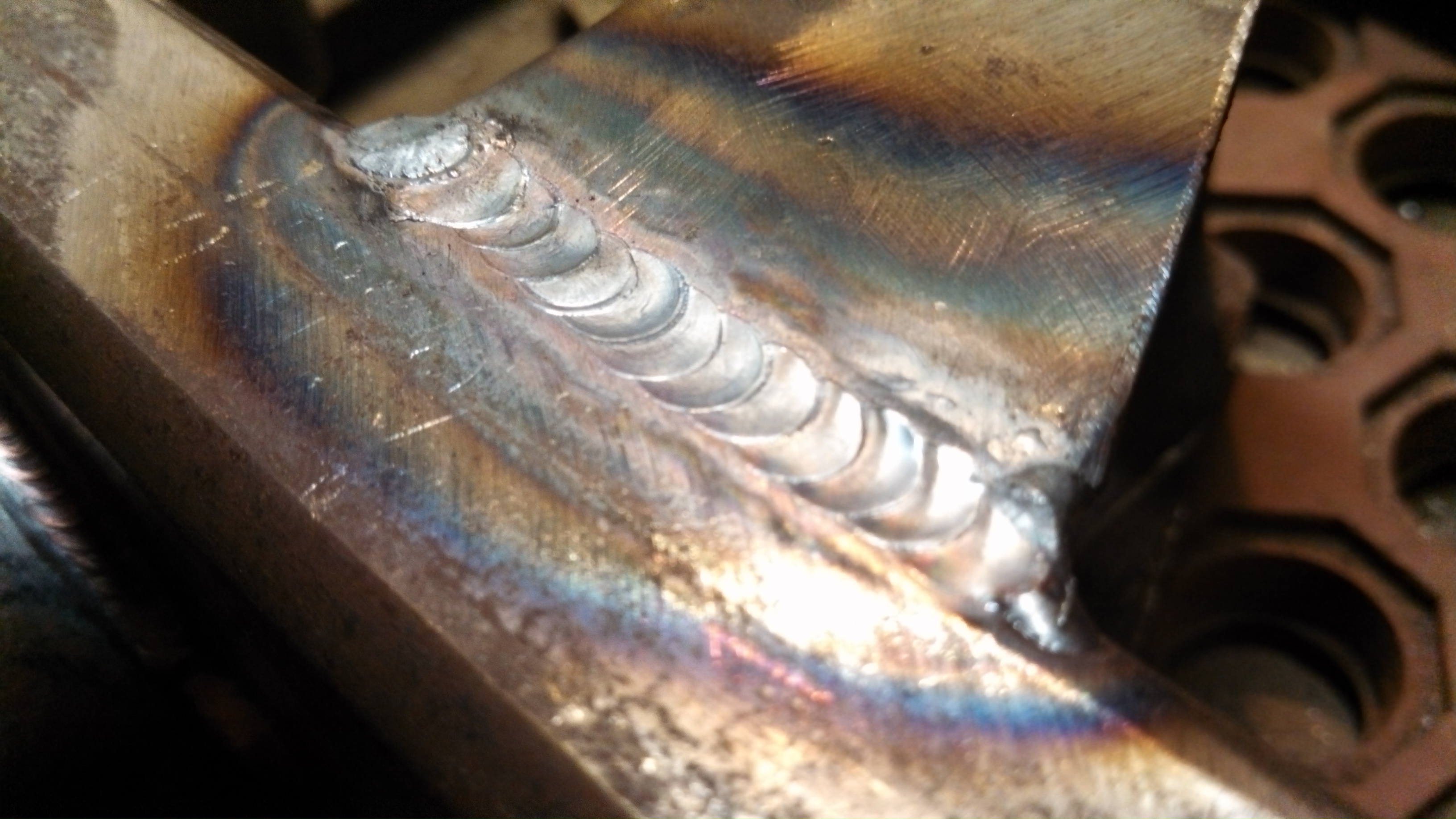

I got my front x-member back from Ryan after having the majority of the tacks seam welded. I also got the vertical pieces on that will support the lower IC. Radiator mounts are fully welded as well.
Main bar ad IC supports weld detail.jpg (1.3 MiB) Viewed 38738 times
radiator mounts and ic support bar.jpg (1.15 MiB) Viewed 38738 times
radiator mounts and ic support bar2.jpg (1.48 MiB) Viewed 38738 times

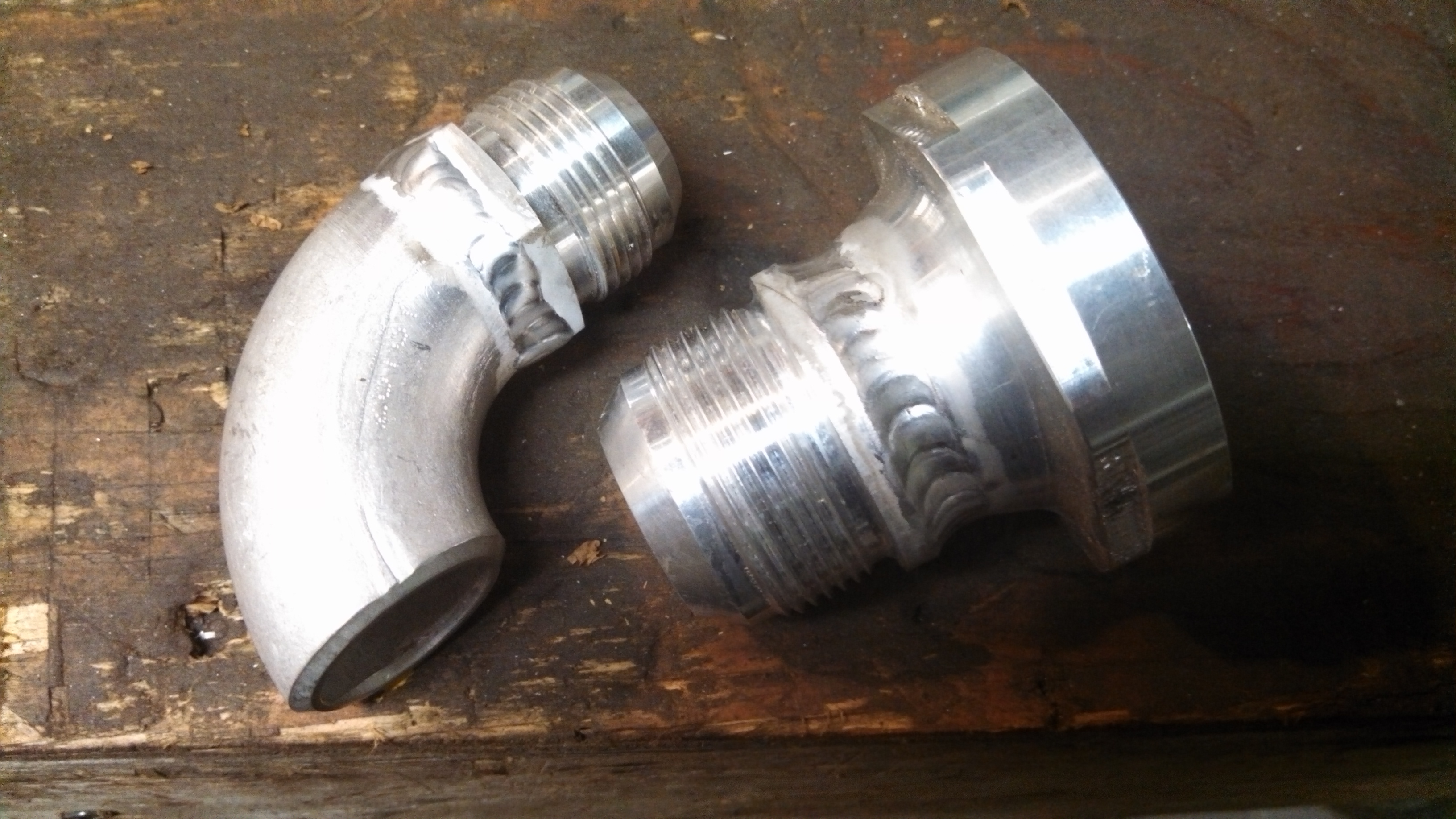

I also got the Vanjen ferrules welded to the inlet and outlet of the IC. The inlet and outlet also have small extensions/bends as well to keep things located where they are easy to get to, and more so to allow the joints to have some movement in the proper directions.
IC inlet and support bar.jpg (1.37 MiB) Viewed 38738 times
IC inlet vanjened.jpg (1.31 MiB) Viewed 38738 times
IC outlet vanjened.jpg (1.08 MiB) Viewed 38738 times
vanjen clamp weld detail.jpg (1.23 MiB) Viewed 38738 times
vanjen clamp weld detail2.jpg (1.35 MiB) Viewed 38738 times

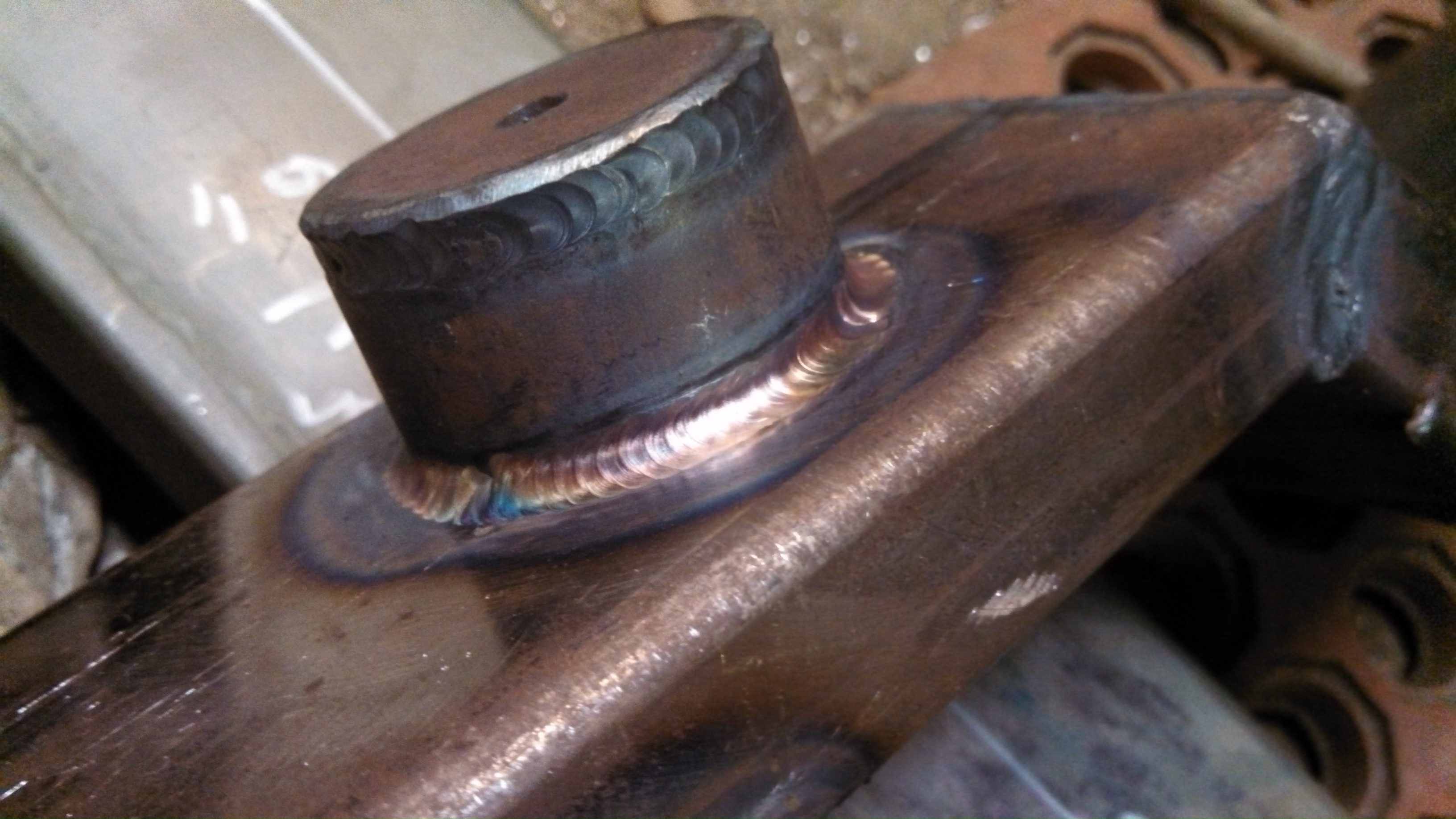

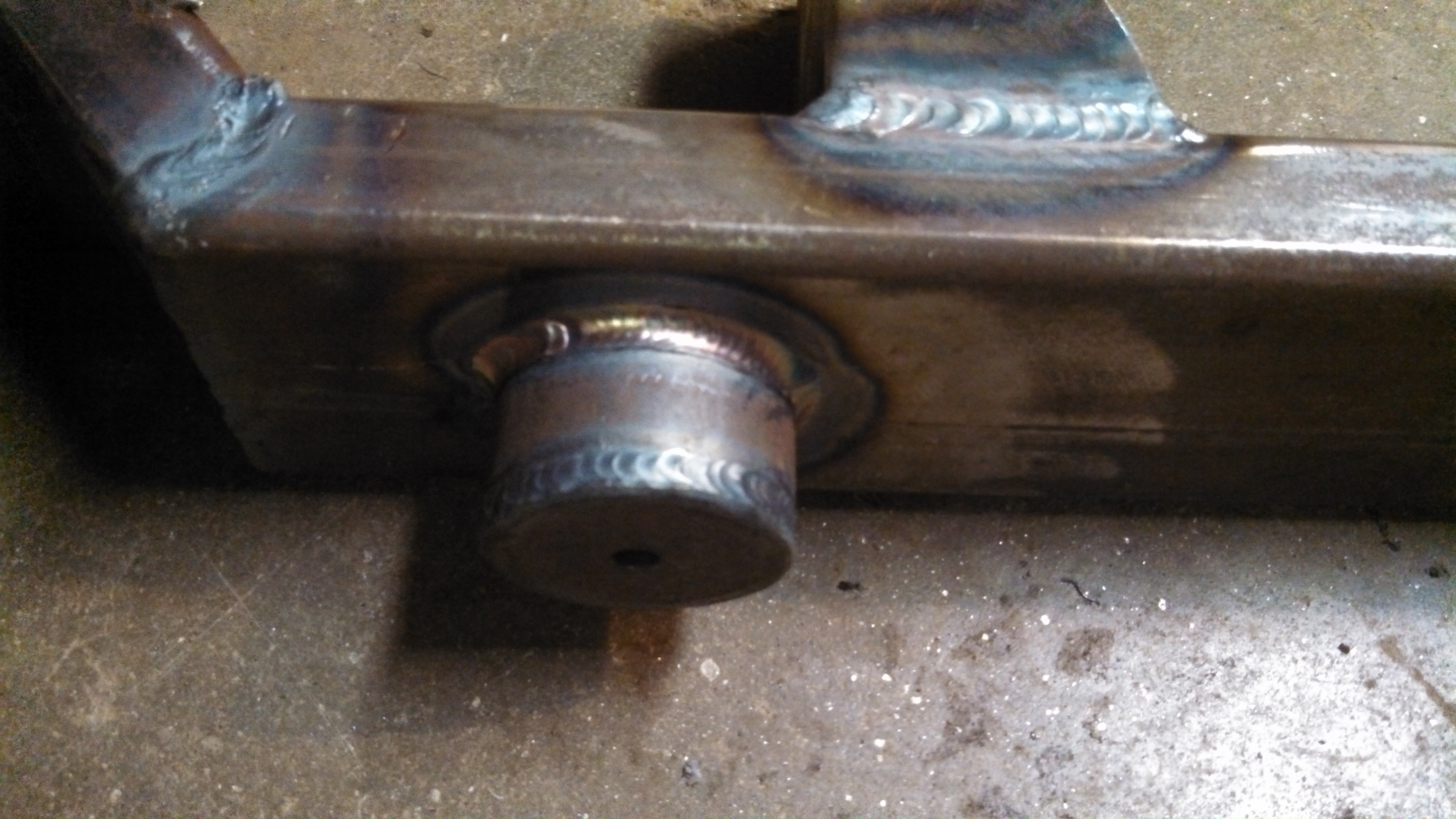

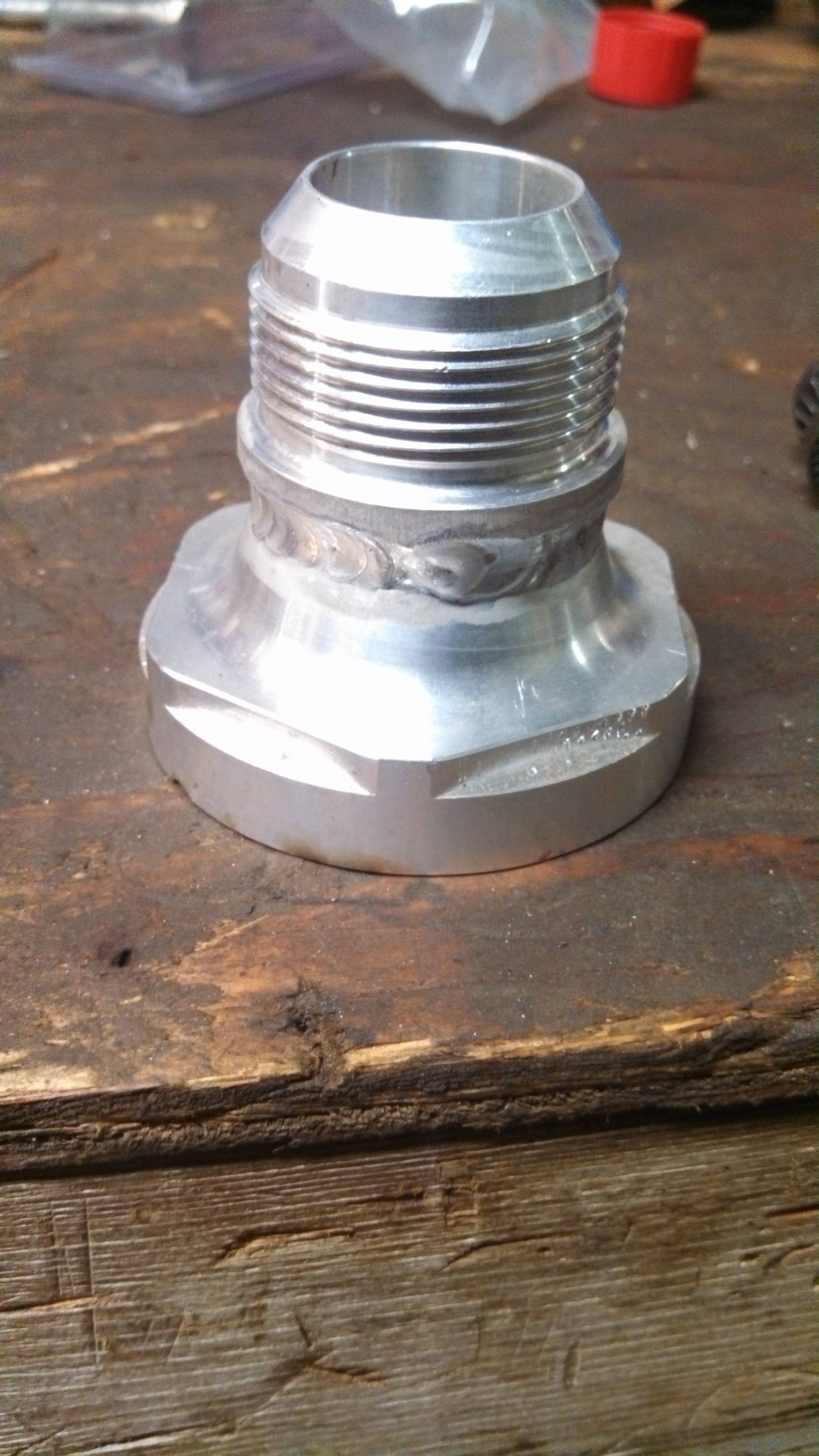

Turbo oil drain to oil pan return got the 16AN bung welded on. I’m not going to finalize the drain location in the pan until the exhaust manifold is done.
turbo oil drain to pan and radiator hot inlet.jpg (1.46 MiB) Viewed 38737 times
The radiator will be a 20AN hot-side/inlet and a 24AN cold-side/outlet. Here is the inlet welded to its 20AN bung. It just needs to be turned down a bit to get the outer threads off, and it can be welded to the radiator.
radiator 20an hotside.jpg (1.53 MiB) Viewed 38737 times
radiator 20an inside transition.jpg (1.31 MiB) Viewed 38737 times

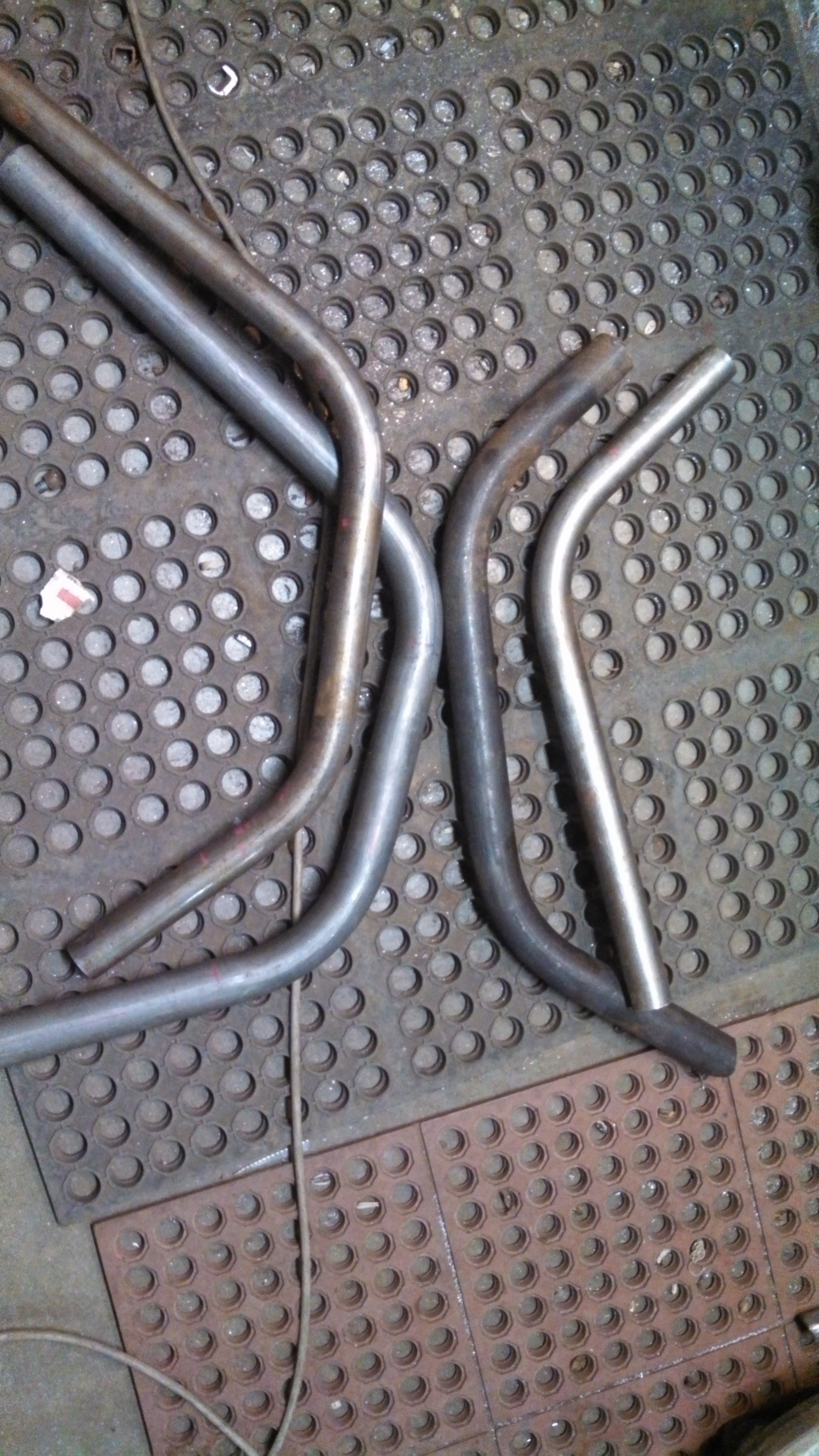

I also got a change to get down to Haydn’s to get my subframe transverse connector pieces bent up. Yes, I know, the bends aren’t the same on both sides. This is to allow the 4” downpipe and 3.5” exhaust to have good clearances. I wanted to be able to drop exhaust without having to touch the sub-frames.
bent tubing for subframe transverse members.jpg (1.92 MiB) Viewed 38737 times

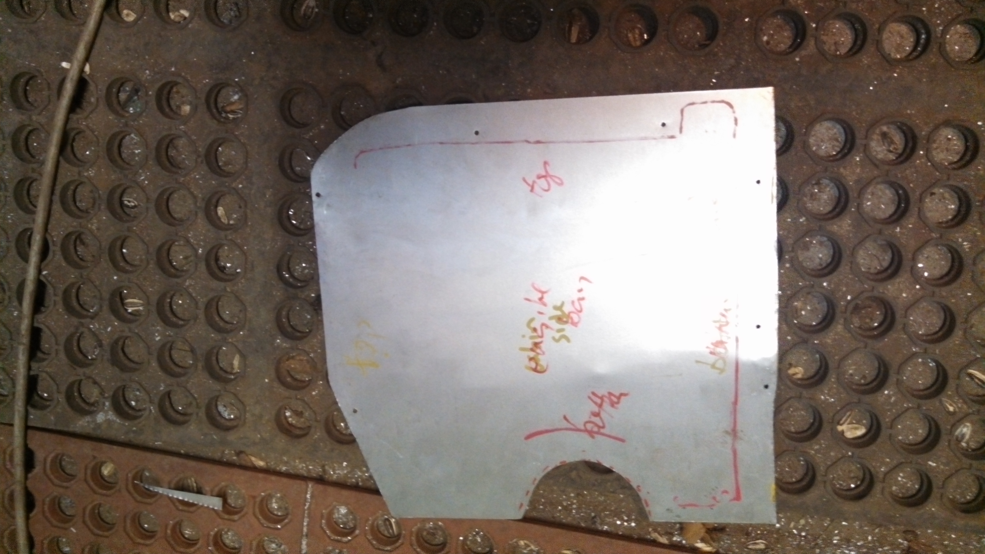

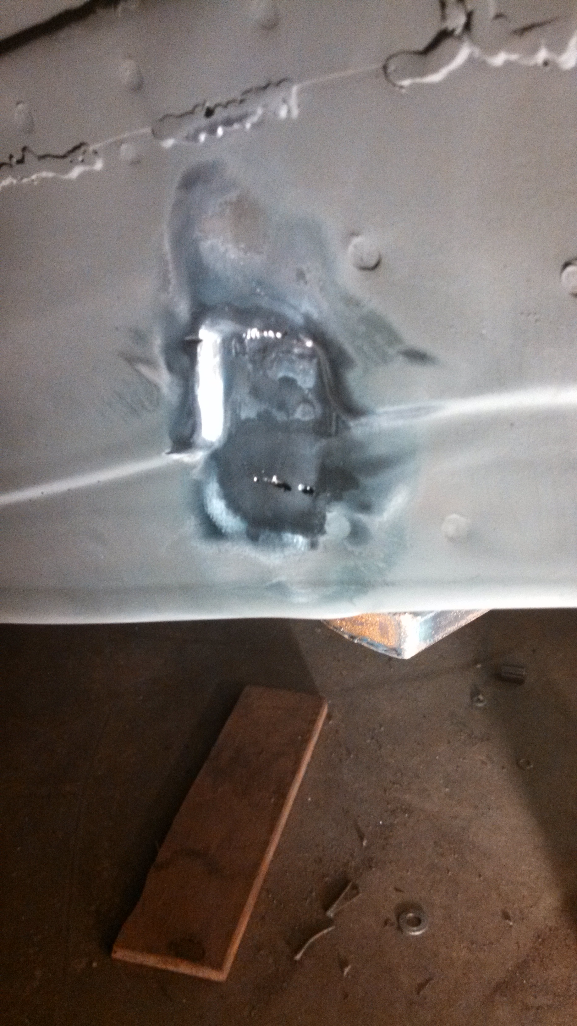

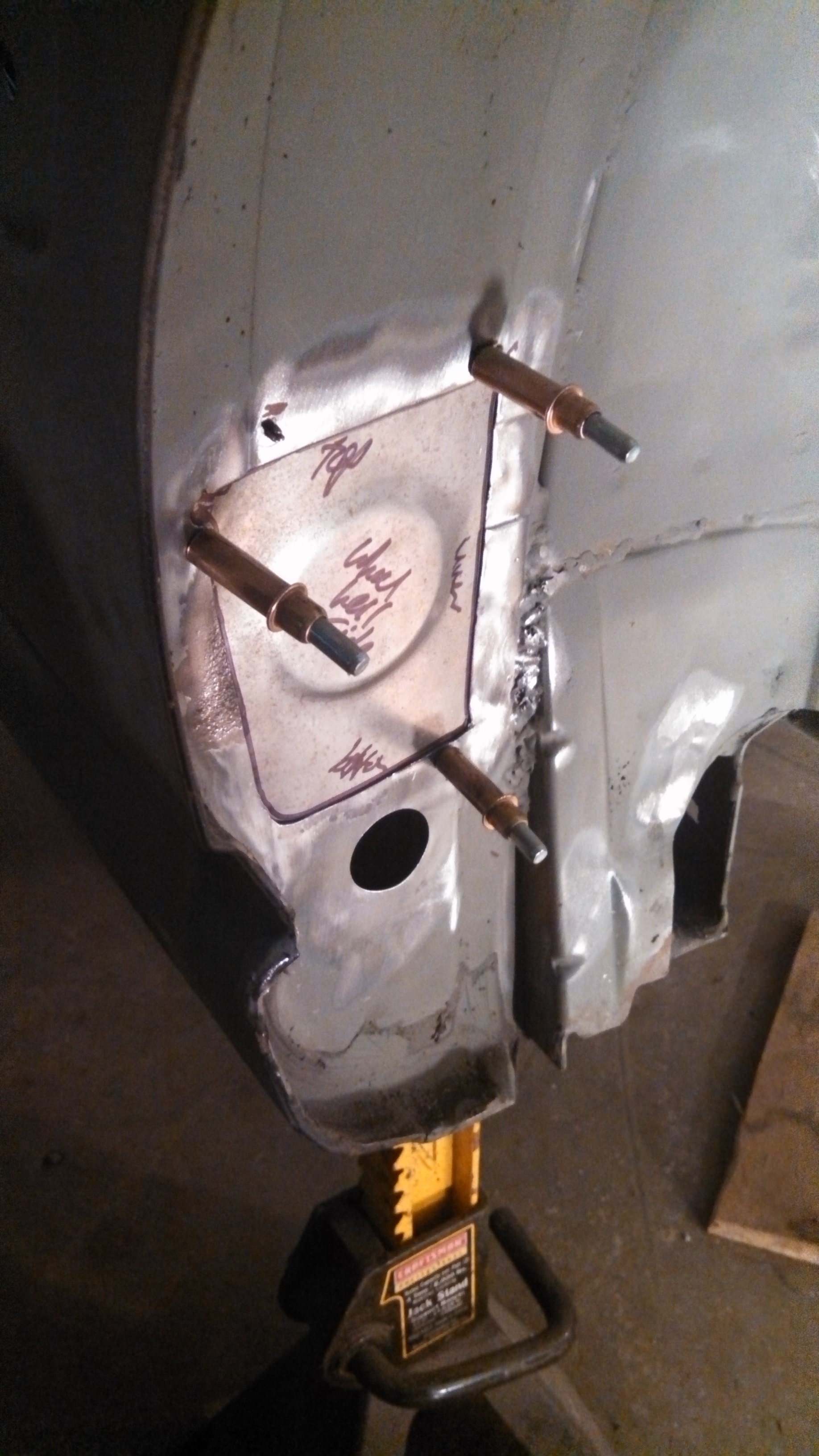

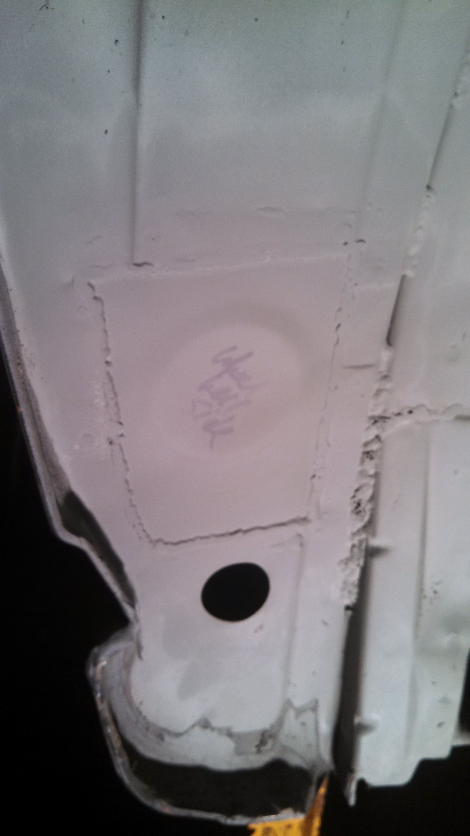

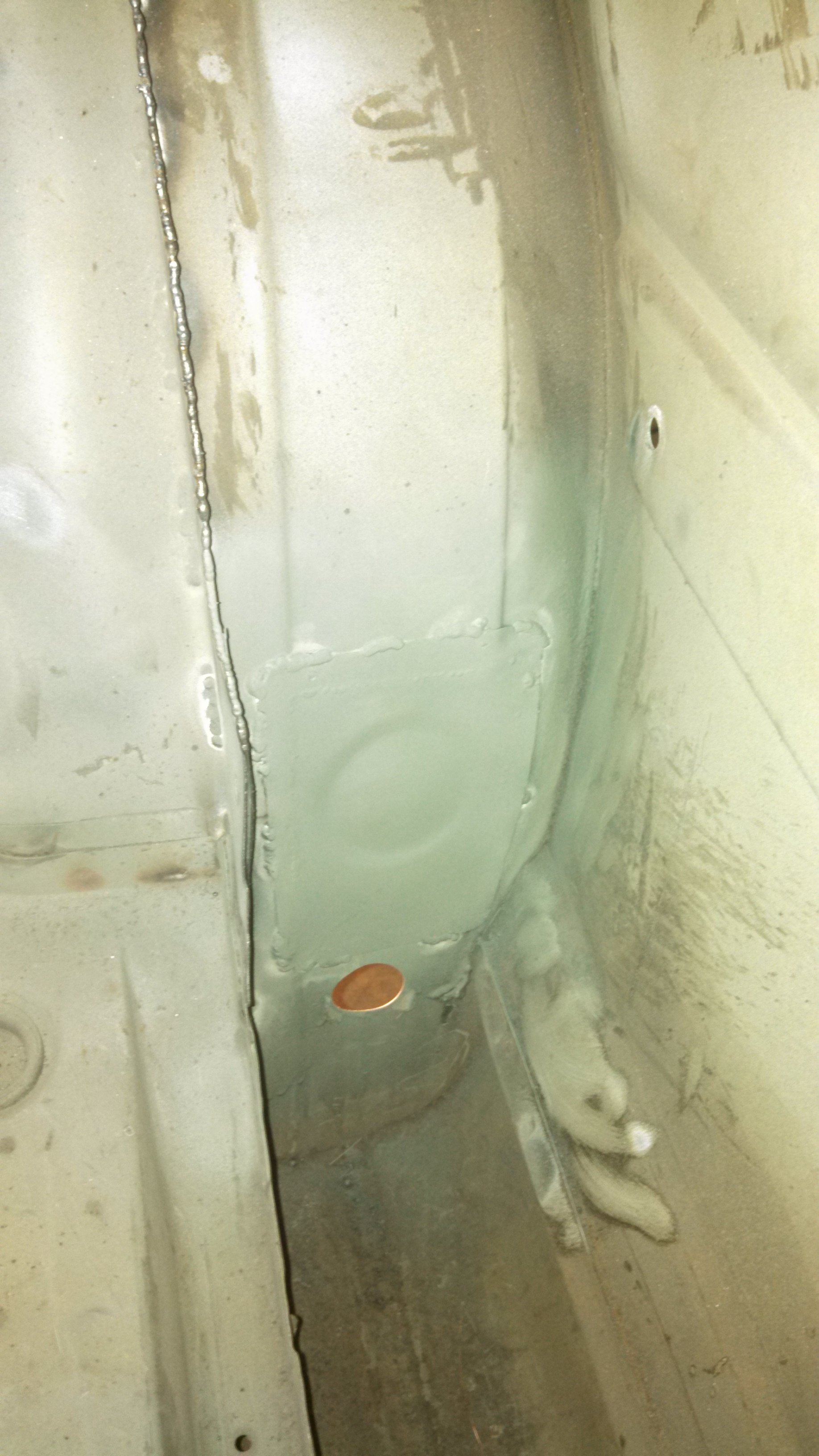

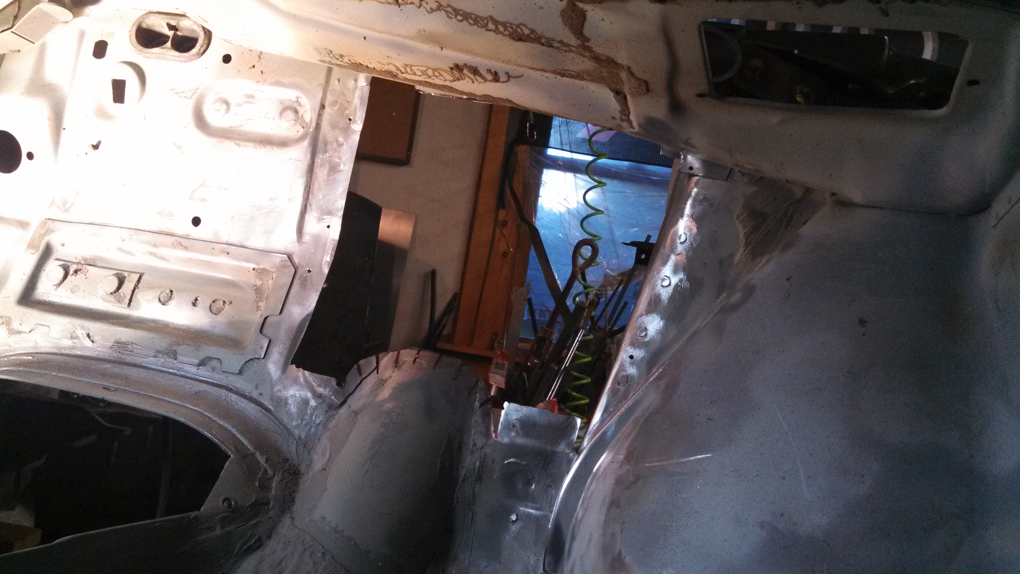

I had a few small rust patches in the rear wheel well area so I set to cutting it out and replacing the sheet metal.
Here it is all cutout and cleco’d in place.
driver rear wheel well patch cleco'd in.jpg (1.38 MiB) Viewed 38749 times
Seam welded in place and primed. It will get seam sealed as the rest of the chassis works gets finished.
drivver rear wheel well patch.jpg (1.28 MiB) Viewed 38749 times
dr rear wheel well patch primed.jpg (1.14 MiB) Viewed 38749 times

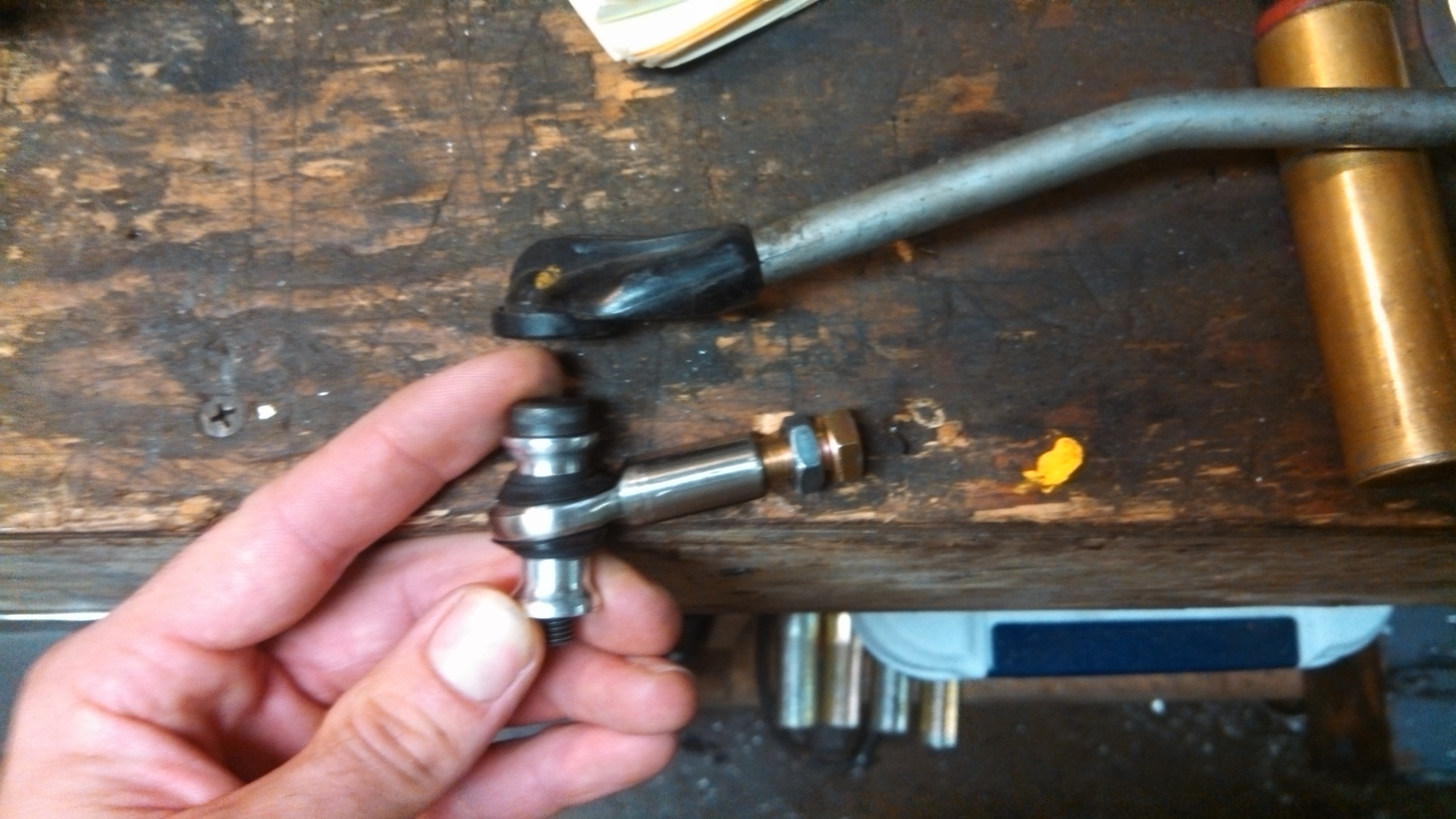

I also started collecting a bunch of small rod ends, spacers, seals etc. to convert the 01e b5s4 shifter x-rod to a small spherical joint. It will use rod end seals and some alu. spacers to give it correct height and articulation. More on that later
o1e crossrod spherical in the works.jpg (972.62 KiB) Viewed 38747 times

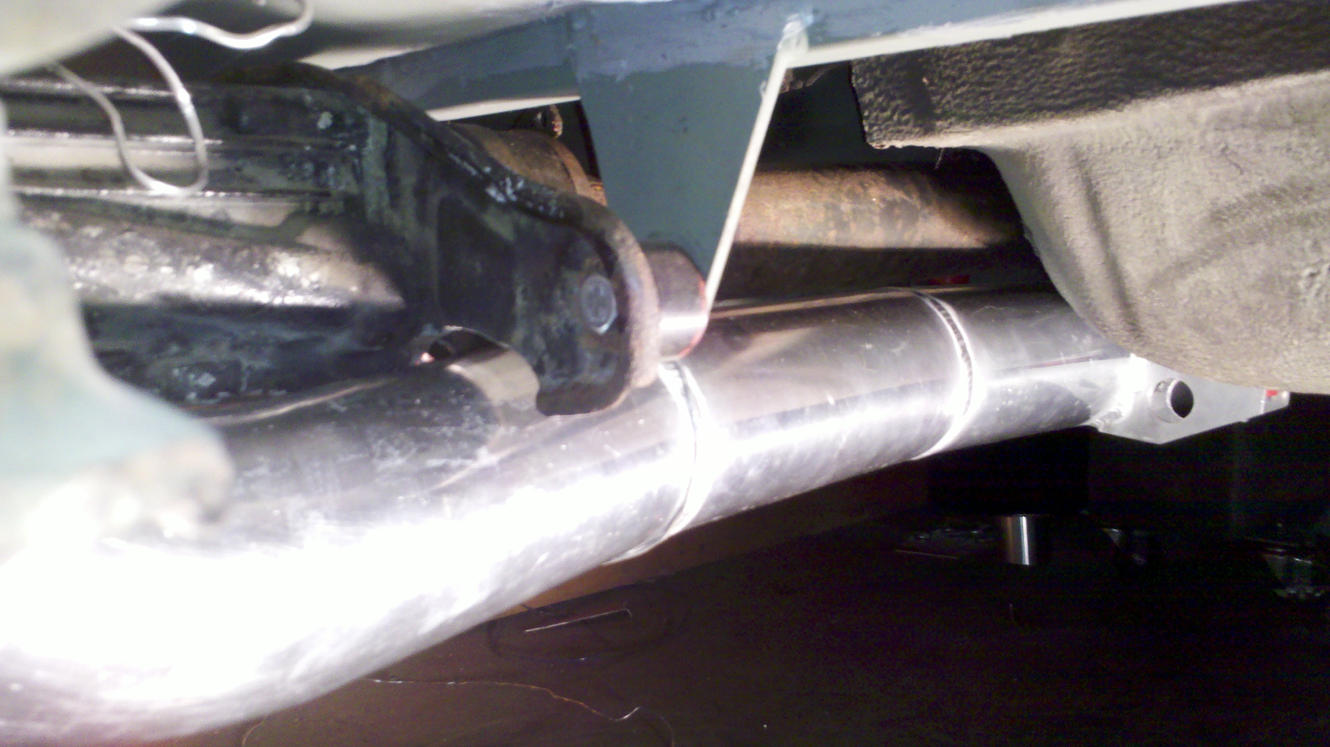

I had originally relieved the t44 rear diff mount bracket for exhaust clearance (see pic)
But that just wasn’t up to my standards for the rest of the car, so what to do? BILLET!
exh clearanced v8 dif mount.jpg (1.07 MiB) Viewed 38747 times

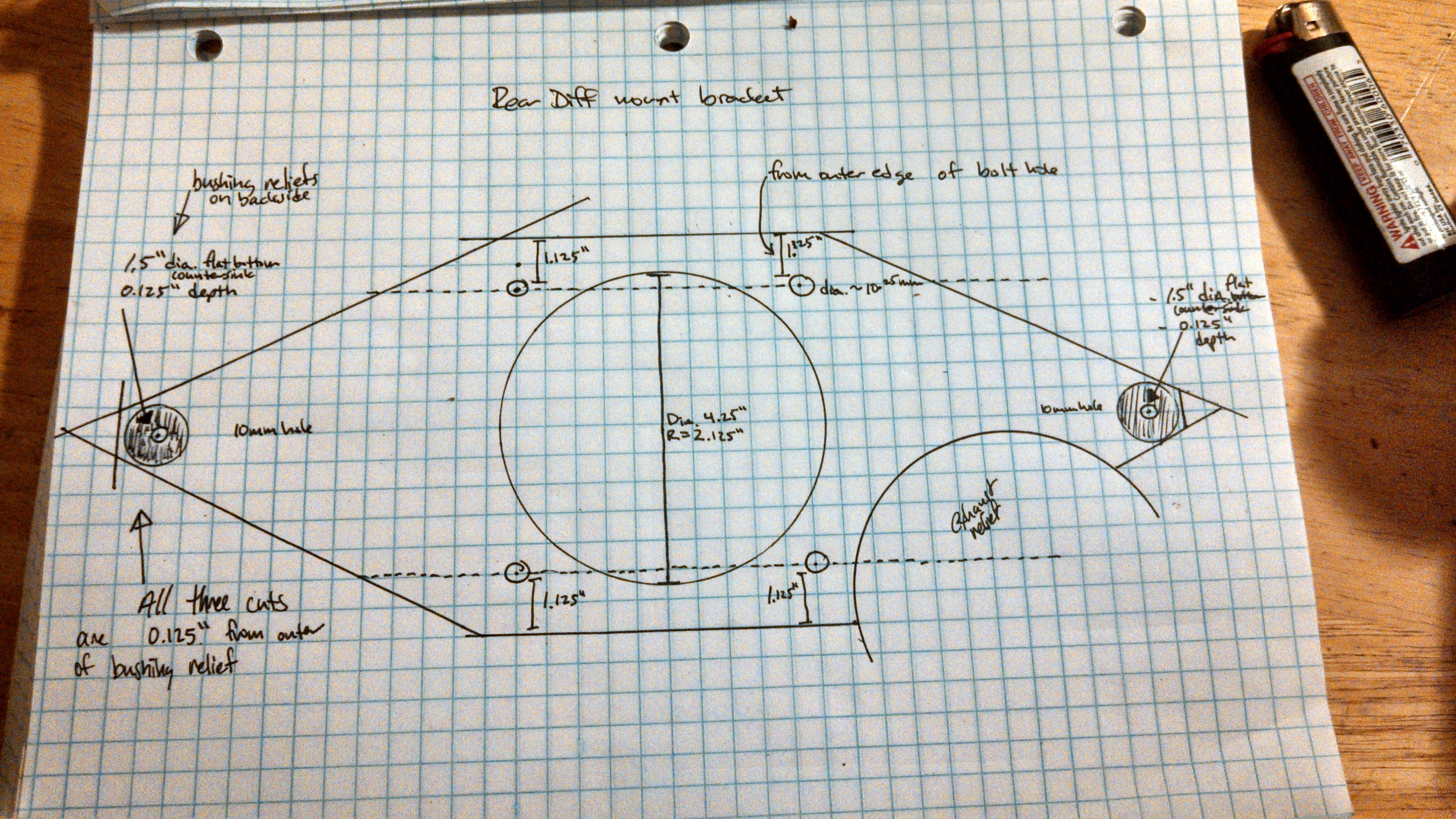

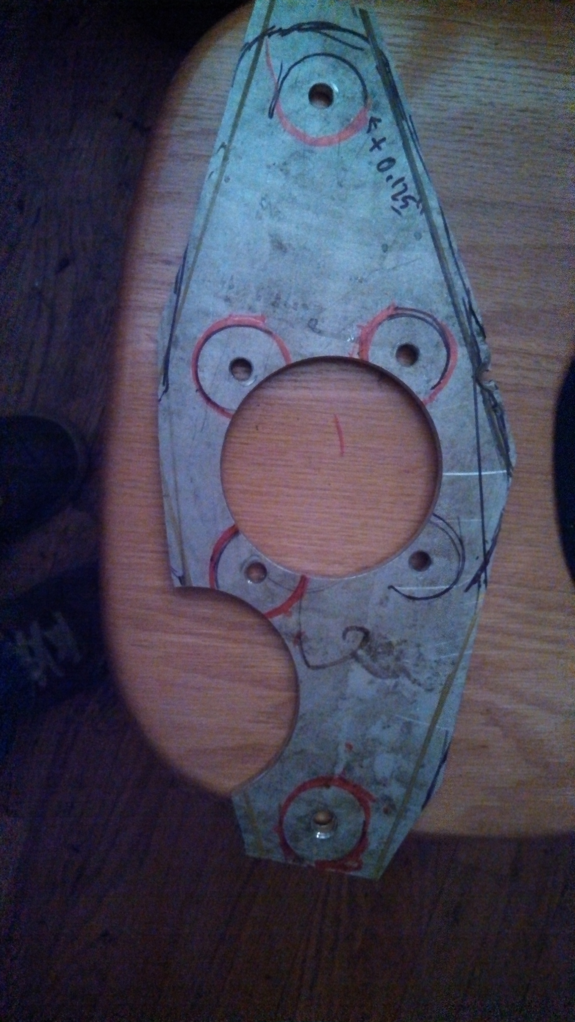

Yup, so I grabbed a piece of ½” 6061 plate and dove right in!! I diligently marked all the holes on the mount first. Then I took a hole saw to the diff. input cup hole and also to the exhaust relief. And that’s it, haha not really. I sent it off to my buddy who works at a machine shop. Its going to be milled down along the edges, have a radius cut along the edges, the diff mount bushings are being recessed to make up for the oem vs billet mount plate thickness, and lastly a light fly cutting for sexiness. It should be here in plenty of time to go to the first round of anodizing. Pics!!!
rear diff mount bracket roughed out.jpg (1.56 MiB) Viewed 38747 times
rear diff mount bracket drawing.jpg (2.17 MiB) Viewed 38747 times

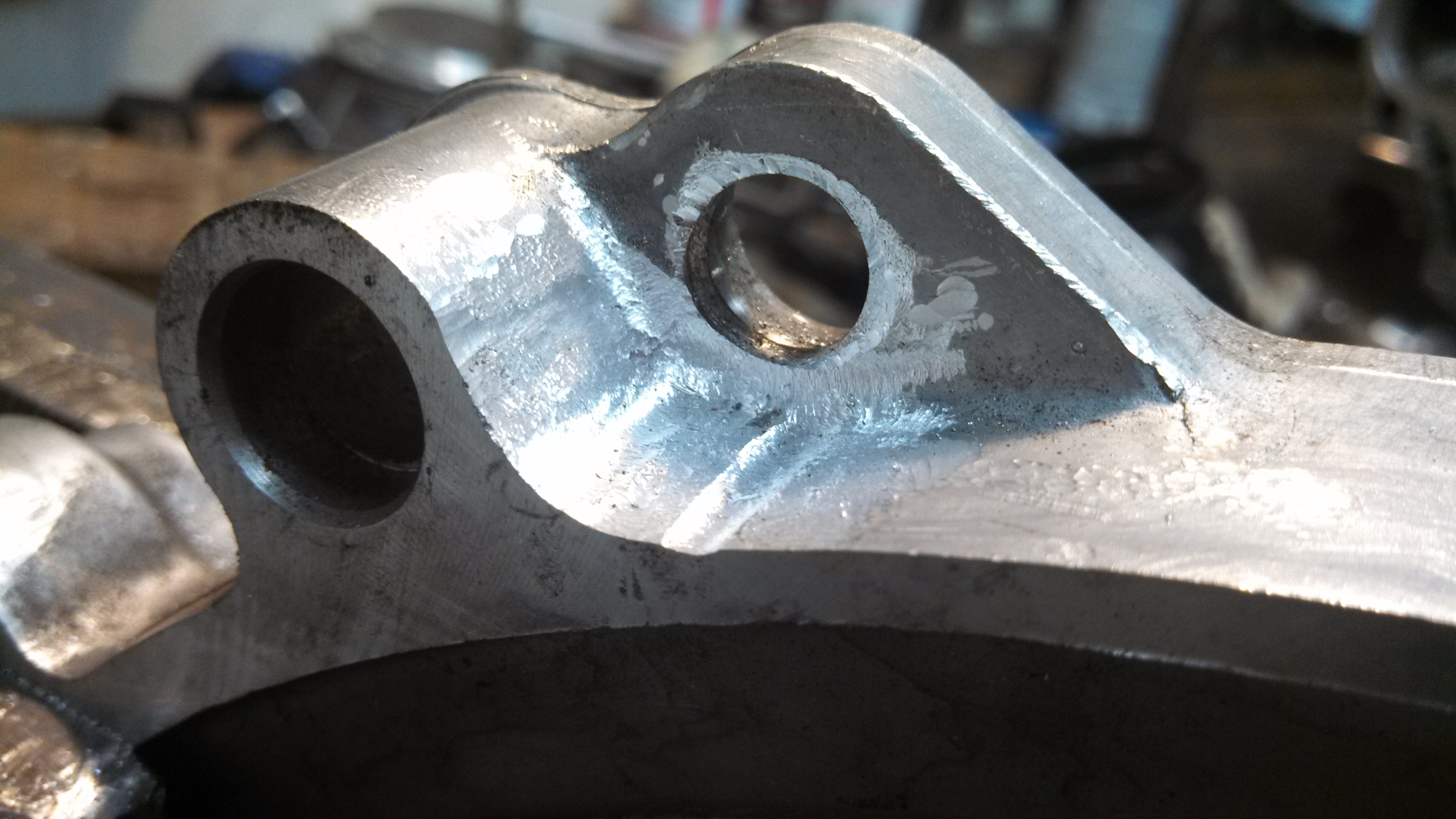

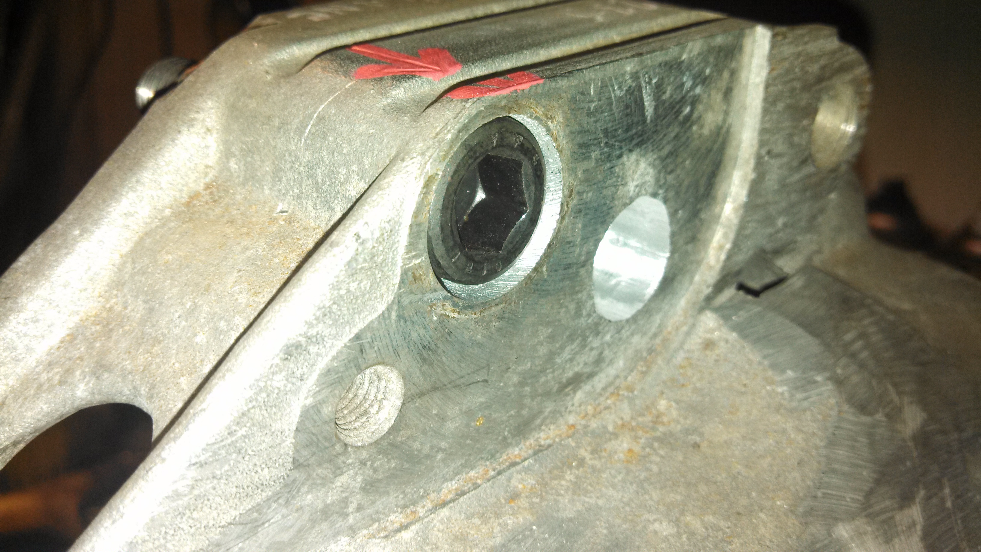

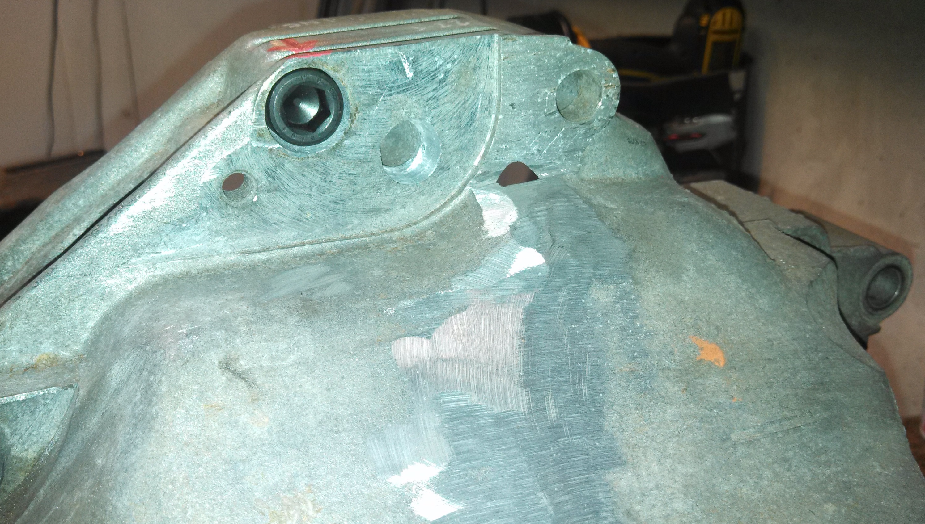

With the motor pushed back, there is very little clearance for the steering arms bracket to the bellhousing. So I got some m12x 1.75mm allens and counter sunk them into the upper bellhousing. This gains me a lot more room.
countersunk upper bellhousing bolt.jpg (1.62 MiB) Viewed 38764 times
countersunk upper bellhousing bolt upclose.jpg (1.75 MiB) Viewed 38764 times

Posted: Sun Oct 06, 2013 12:13 pm
by Mcstiff
Word is Audi Sport shaved those bosses off so it was easier to pull the transaxle.
Posted: Sun Oct 06, 2013 3:27 pm
by speeding-g60
i know i did, on two different times, going more cut off each time. still had to mess with the steering knuckle thing.

Mcstiff wrote:Word is Audi Sport shaved those bosses off so it was easier to pull the transaxle.
They sure did.
Looking great. Lot's of fabrication going on...........brilliant. :beer:
They sure did.
Craig.
I don't get it, how does this make it easier to pull the gearbox off the engine? Any pics?
Sent from my HTC One X+ using Tapatalk
Posted: Wed Nov 06, 2013 3:54 pm
by Mcstiff
kieron_32v wrote:
They sure did.
Craig.
Shaveing the top of the bellhousing removes 2 (or 3) bolts and makes clearing the rack easier.
Posted: Wed Nov 06, 2013 3:59 pm
by kieron_32v
Fair enough, so just having the remaining bolts is enough? Did they run any more dowels like that?
