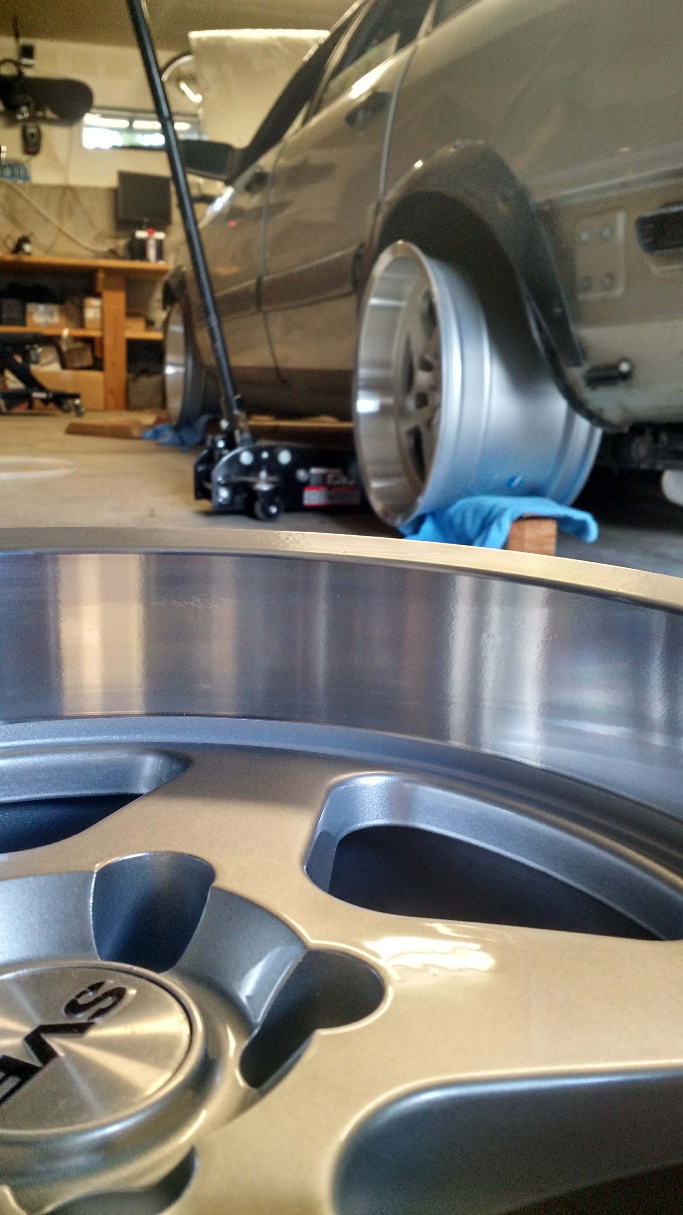

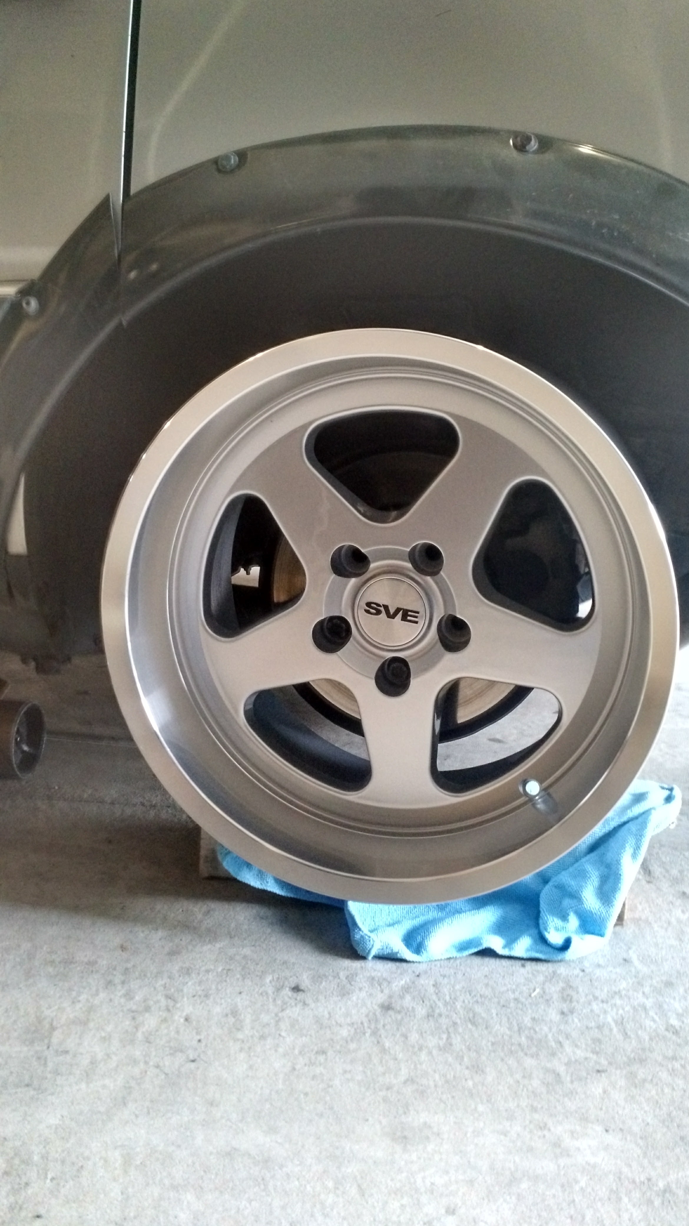

StanceNation Son.
- IMG_20170413_181525.jpg (973.1 KiB) Viewed 57083 times
- IMG_20170413_181551.jpg (1.08 MiB) Viewed 57083 times
Re: Phil's 20vt 5ktq, "TurdQuat" EFR7163
I wanted to run these x10's so badly... settled on 9's since I didn't have the fender, but I'm REALLY pumped to see this on yours!

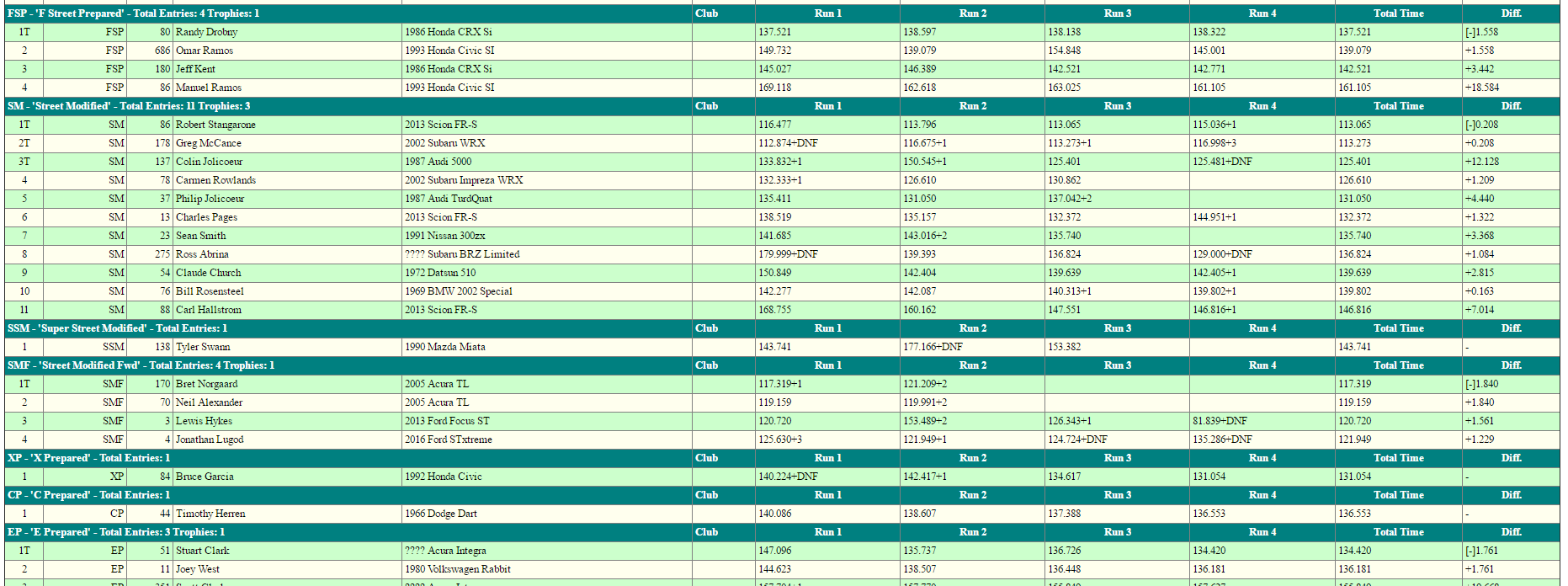

Some times from Saturdays runs.
I'm pretty sure I would have beat Colin's best time on my third run, but I fucked up at literally the last 10 feet and hit a cone and came to a full stop for what felt like a solid 5 seconds.
Final run the car in front of me broke down and tried to coast to the end of the course, which made me catch him and get a re-run. My brakes fully disagreed with running a final re-run and decided to practically catch fire.

What tires are on there now? I am guessing something in the 200 wear rating. Those guys in the 113s are surely on R-comps. Both of you being at the top of the list for street tires is pretty awesome.
Re: Phil's 20vt 5ktq, "TurdQuat" RaceCor
It's got Falken Azenus RT615k+'s on it now. Pretty new tire and pretty cheap. I'm really happy with them for the price.
The first and second BRZ and WRX were both on Slicks. The BRZ was running some pretty serious Aero and a supercharger, and the WRX had what looked like 18x12 wheels with what had to have been 305's or bigger.

Love the look of the car and the new wheels. Maybe I missed it but could you tell me the wheel offset please. Hard to tell but it looks like the wheel sticks out about 3" further than stock. If this is the case they might fit on my car after 5 lug conversion.
Thanks

Einbilden wrote:Love the look of the car and the new wheels. Maybe I missed it but could you tell me the wheel offset please. Hard to tell but it looks like the wheel sticks out about 3" further than stock. If this is the case they might fit on my car after 5 lug conversion.
Thanks
17x10 ET22 bolt pattern is 5x4.5 I think? whatever 5x114.3 in standard sizing is.
