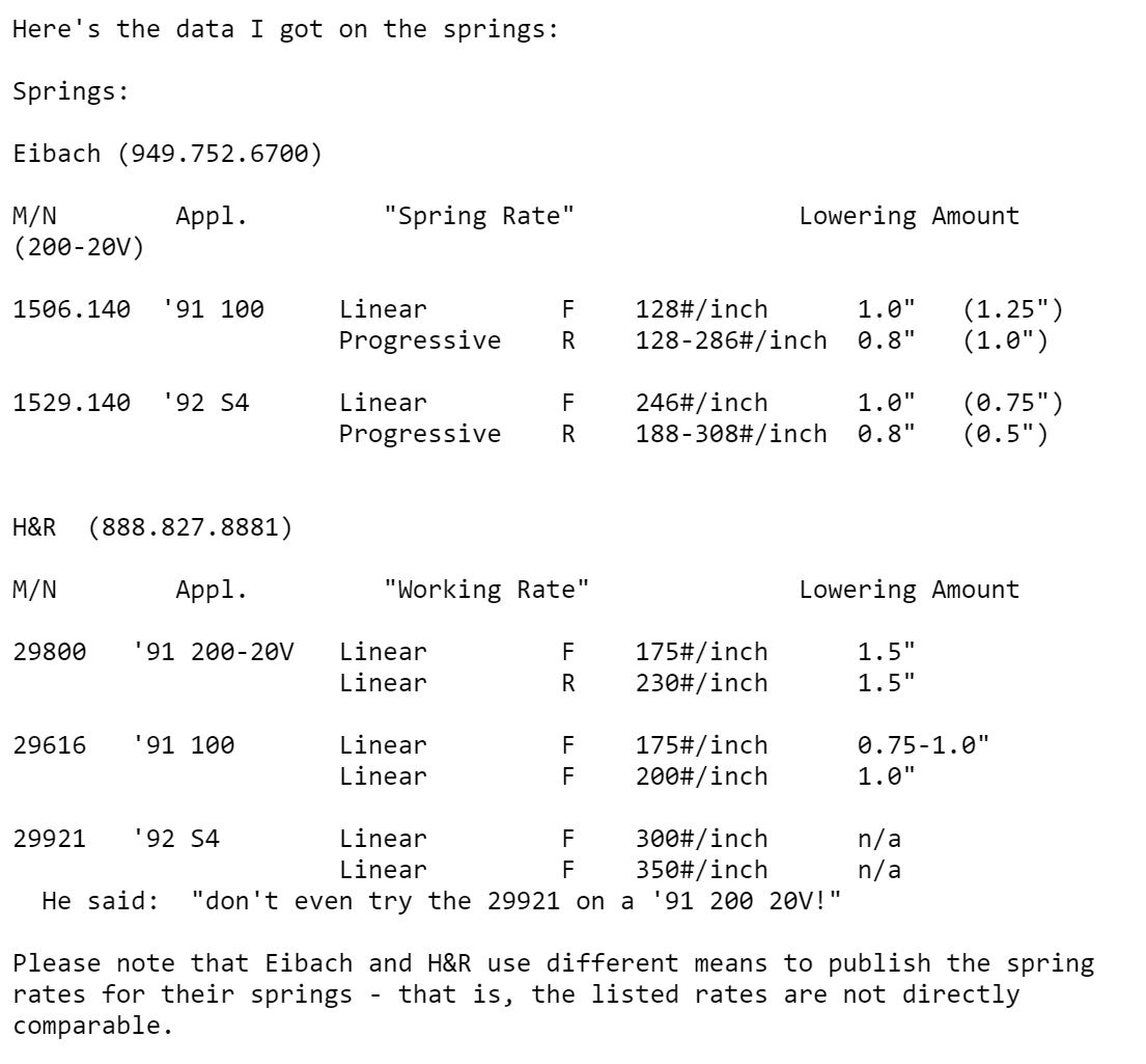

Okay, so true to word, I will document the brake stuff... later. I need access to some pics and measurements I left at home when I started back at school. :bangshead: But the brakes are great! The pedal's a little mushy, so I may need to bleed them more, but if you lay into it, the car nose dives considerably!
For those who have gone the DIY coilover route, what spring rates did you run, and what are your impressions of them? I know Chris recommends 450/550 lb/in, which is what I'm favoring, but at the same time, I accept that this is no racecar. I think the perfect setup for me would be just soft enough that you could take a non-car friend on a slightly bumpy road with a few potholes and such without them noticing a harsh ride. I'm just wondering if that's possible with the recommended setup.
I'm considering ordering springs somewhere in the upper 300/lower 400 range, with an appropriately-valved damper. Any thoughts?

Yeah... That's not going to happen with the rates I recommended. What did you think of Corey's setup?

I thought Corey's was just about perfect! I could go a little stiffer, but the feel was right where I'm imagining
Re: Kevin's 200 20v
Posted: Sat Aug 27, 2016 11:03 am
Corey's are 200 20v H&R springs with either Koni sport or Bilstein sport with regular valving. I found some strange information related to those spring rates... this is an old excerpt from some forum. It's odd that they quote the rates in #/in, but they are not directly comparable... I'm thinking the H&R rates are true lb/in, and the "OEM" Eibach's are not.
My 635csi has 375 lb/in springs in the front (which is a comparable suspension design to this car as opposed to the rear which is not). That car is more of a grand tourer, so I didn't want it super stiff, but I did want it to be sporty. I think it is a good mix of comfort and sporty, leaning a little more to the sporty side. This is something I have to consider for my avant too. I need it to be somewhat comfortable going "offroad" and on bad highways, but I also want to keep it pretty sporty. To that end, I might either just go with whatever the H&R rates are (like I said I would do earlier in this thread), or up them a bit to 300/375 F/R or something like that (so I can utilize some springs I already have).

Damn good info Chris, thank you! I'm sure a lot of this comes down to the dampers as well, but it's good to get a rough sense of what I'm trying to achieve. I'll probably order something in the 300 range, given what you posted.
Before I finalize anything, though, I'd like to get better acquainted with suspension setup and tuning, which will require reading up on some literature. That way, (hopefully) I won't be making such blind guesses with regard to part combinations! I will, as always, post my findings, if any.
