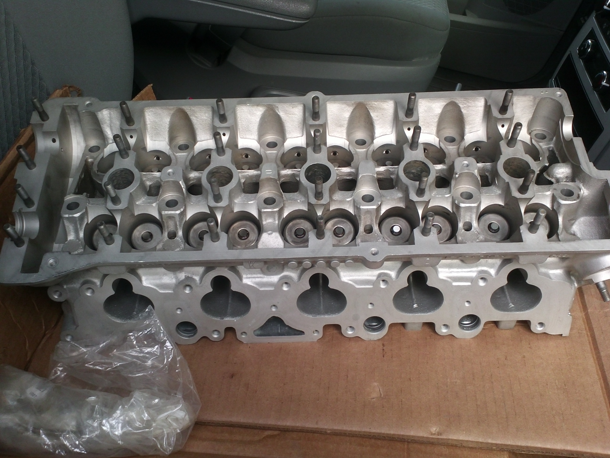

This thing is so.... Beautiful haha. The shop owner said they checked all the valves according to the Bentley page I showed them and they all checked out
it did look as if they ground the stems on some of the valves. 11 guides were replaced and the total Bill was freaking $515. The milling was the cheapest on the invoice of everything!

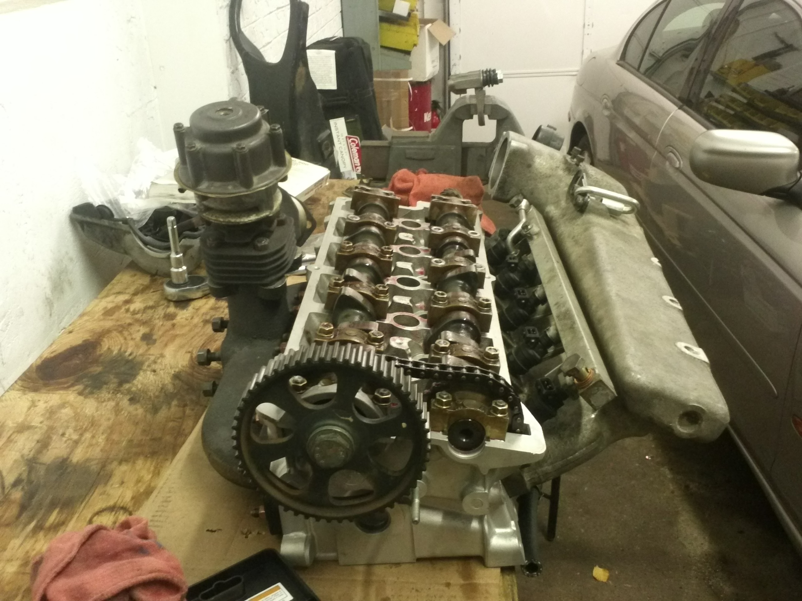

Things I would do differently next time (god forbid) include assembly of the valvetrain with assembly fluid AFTER putting head on.
End of list so far. That nasty spermy grease was dropping down from the head in a few spots. I cleaned them up my best and then the shit started running down the damn ARP hardware. Fortunately, I hope, it happened on the exhaust manifold side so I think the shit only went straight out toward the outside instead of across the entire head towards the intake manifold. Fucking made me nervous though. I pray that doesn't fuck me over in the end... Everything is on just about but I had to take a break since that ball buster guy was in my ear about being ungrateful all damn day. So sick of him. Maybe I'll finish the timing belt portion tomorrow. I didn't use his bay so I was outside and it was windy as hell so I went home to rest.

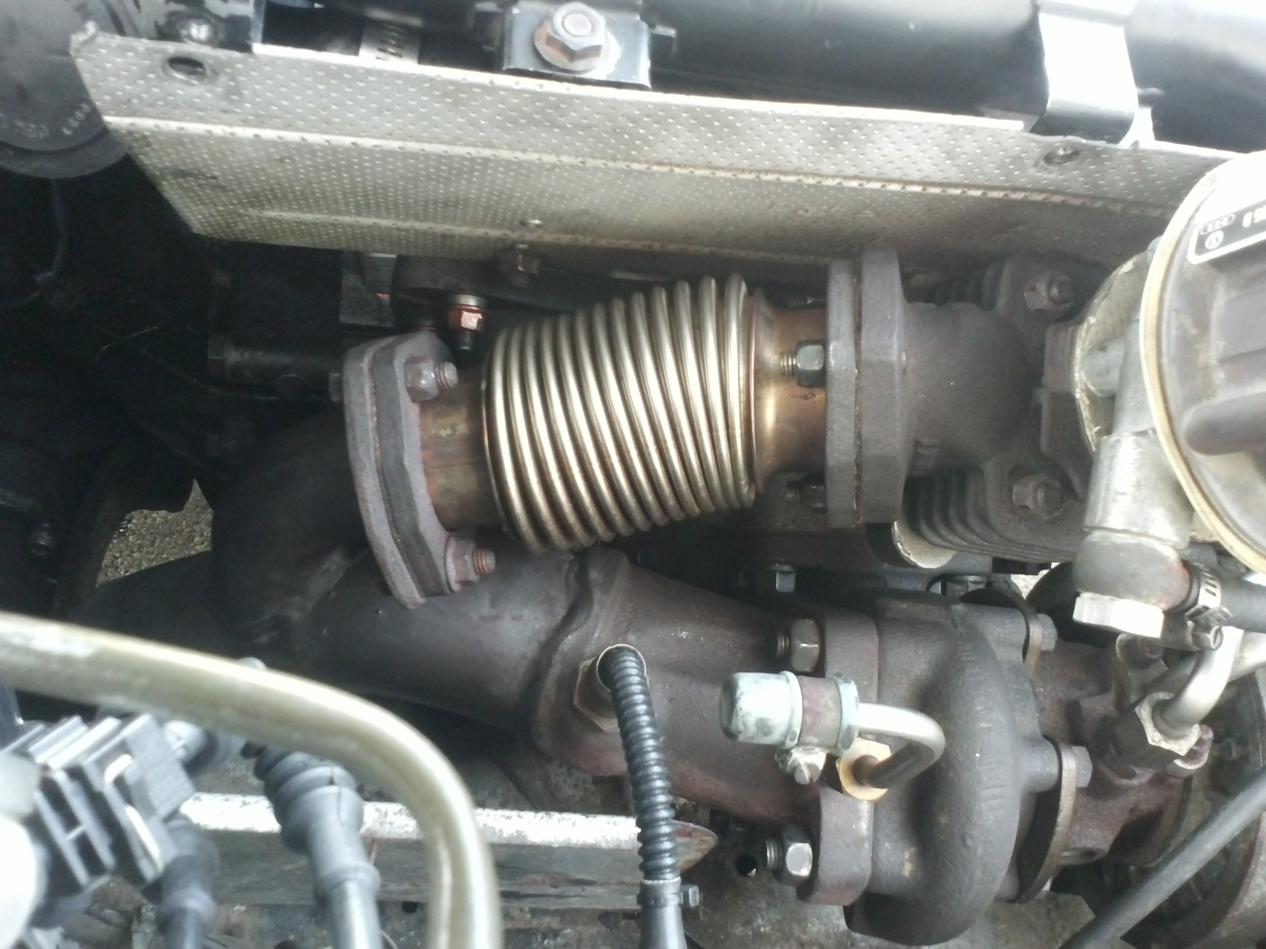

Now that's a tweaked WG flex pipe!
