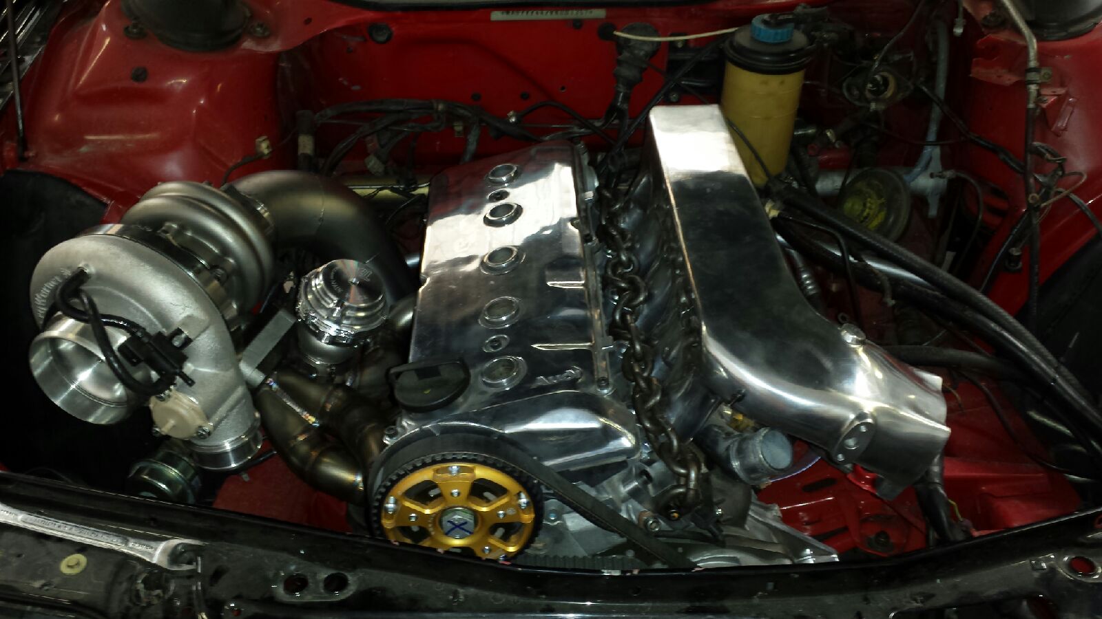

Josh's 2.5 200QT.
Re: Josh's 2.5 200QT
1000rpm is extremely over the top. Jims 2.3L would spool almost identical to my 2.6L with the same turbo/manifolds. My 2.6L would spool around 500rpm sooner than a 2.2L for reference. So It gives a nice 500rpm bonus of turbo efficiency that would otherwise not exist. Nice upgrade

So using that comparison... My 2.5 with quick spool valve and the EFR turbo, I should be able to spool faster than your 2.6... :D
Yes. A short rod ratio wil help spool the turbo as well, which a short deck 92.8mm motor does vs a 159 long rod tall deck. If I had to guess, I'd say this big 63mm turbo will have 30psi by 4000-4100

Hank wrote:Yes. A short rod ratio wil help spool the turbo as well, which a short deck 92.8mm motor does vs a 159 long rod tall deck. If I had to guess, I'd say this big 63mm turbo will have 30psi by 4000-4100
I would think around there. Dad's 64mm was exactly that, 4000-4100rpm, 92.8 2.5l stroker with qsv
Now I'm stoked to see 07k difference :D

Holy fox man. Wow. So what are you doing for crank case pressure relief?
2.5TYPE44
Posts: 461
Post by 2.5TYPE44 »
That's funny you mentioned it. I asked hank the same thing yesterday

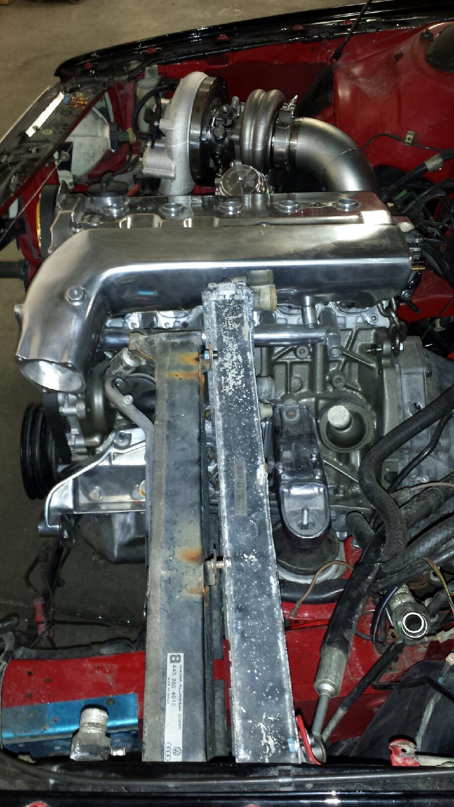

Using an RS2 intake? So you'll keep the conventional routing of the intake behind the head? Was curious to see how the Wagner would interact with the radiator.

Keeping the Wagner intake. Moving the radiator and a.c. condensor just behind the throttle body, using a RS2 water manifold

I don't have the ABS in the way, the bomb, and I did a vacuum booster conversion so there is more room now. A picture can describe it better. This will give you an idea of how it will be but just with the old radiator. I like not having to route the intake behind the motor. I figured the farther it stays in the front of the bay, the cooler and the shorter the route, the better.
