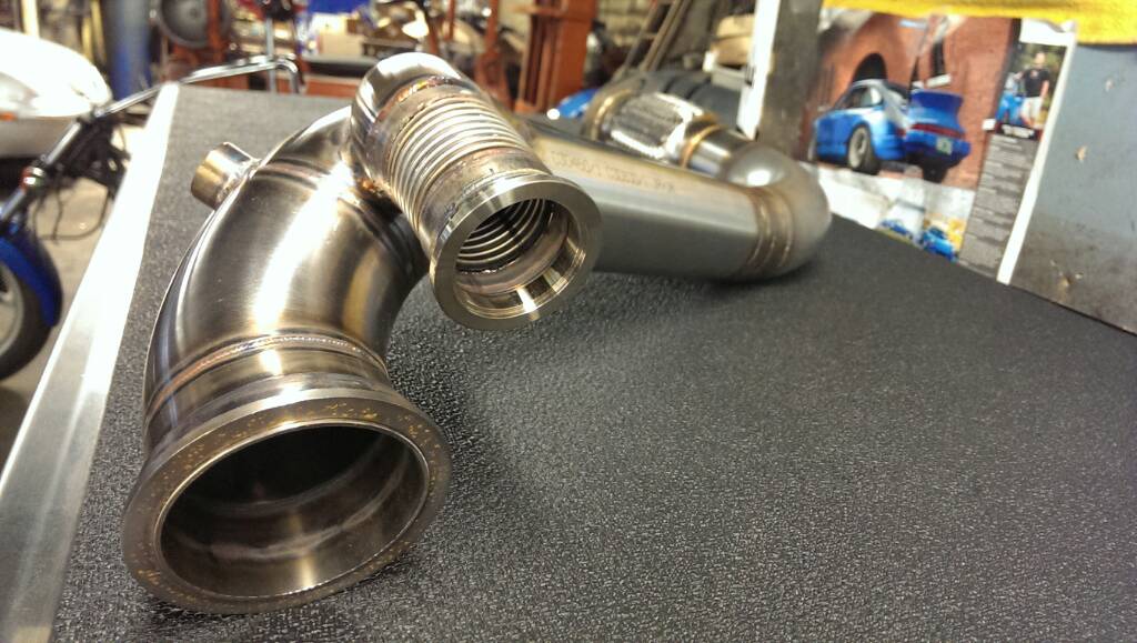

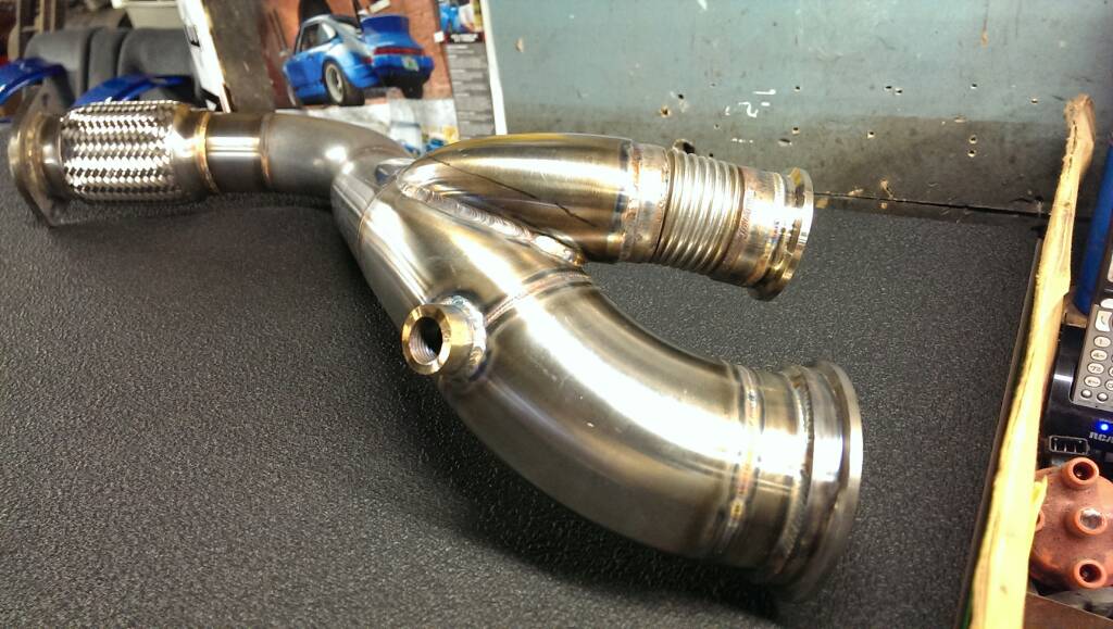

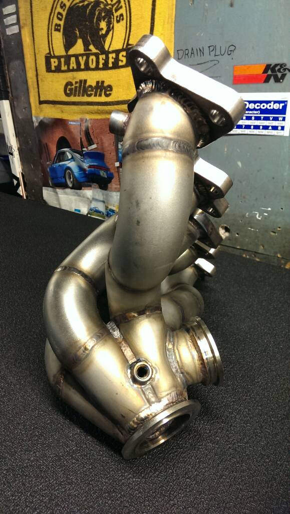

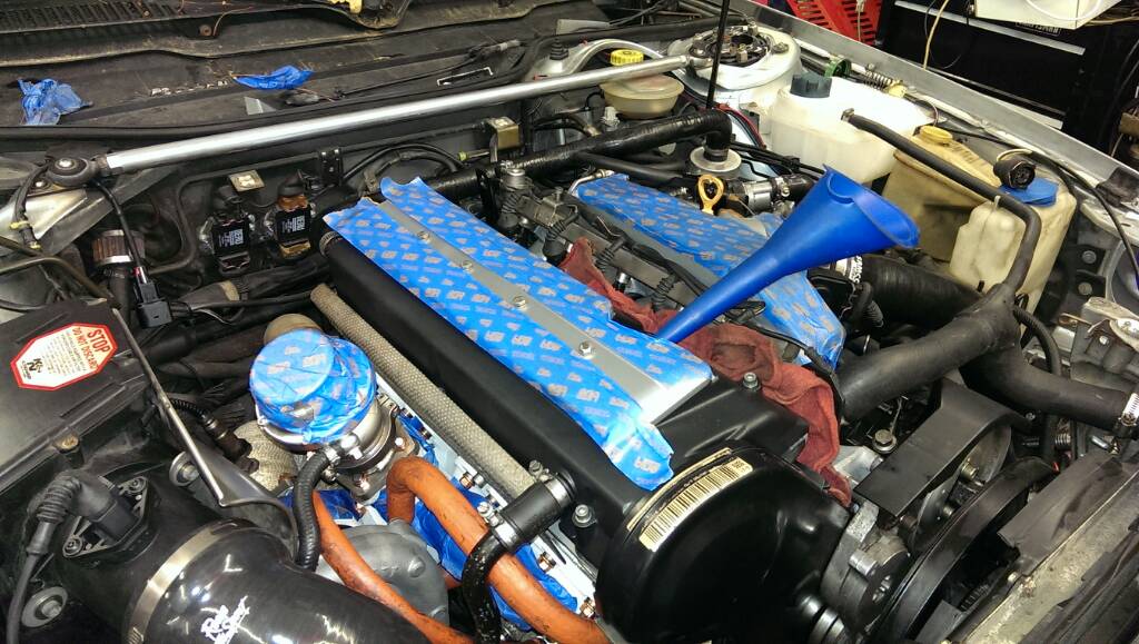

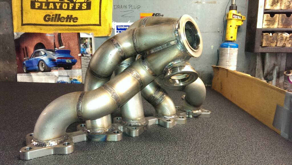

That is a #6 hotside... You know what that means.
Hank wrote:That is a #6 hotside... You know what that means.
Yes it is... & and I now know what it meant :grin:
Yeah, the old sticking a river through a straw, making high EGTs and lots o back pressure. IE, detonation city if pushed above 310-315whp on pump gas, 340-350 on race. Bigger compressor, biggerturbine, same results + Lag.
Good news is that 600whp is going to feel that much more impressive now. Woot woot
Lets get stuff done....
Hank wrote:Yeah, the old sticking a river through a straw, making high EGTs and lots o back pressure. IE, detonation city if pushed above 310-315whp on pump gas, 340-350 on race. Bigger compressor, biggerturbine, same results + Lag.
I will inspect my manifold to see it has any inherited cracks in it from the EGT's... No more childish straw sucking for me though and 600whp is a but lofty... I'll be content with an effortless 500whp...

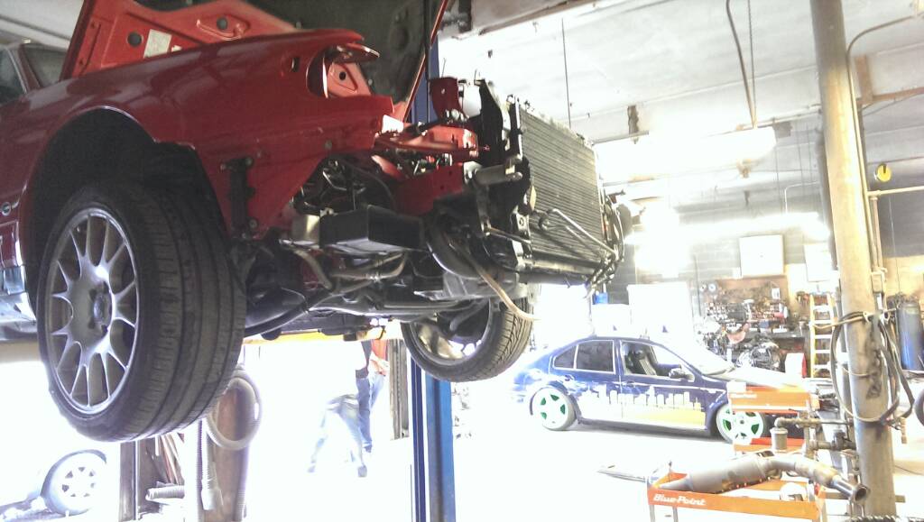

Re: A tale of Rubí... On lift w/PICS

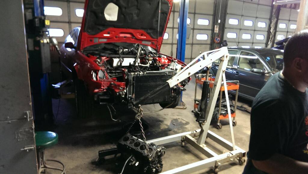

Out

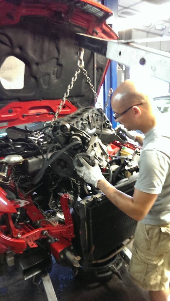

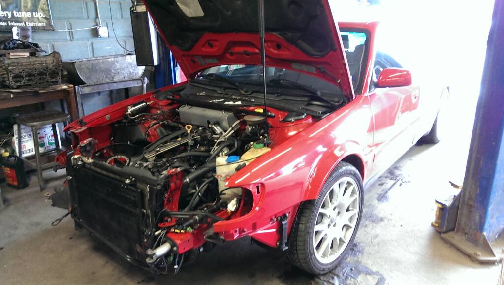

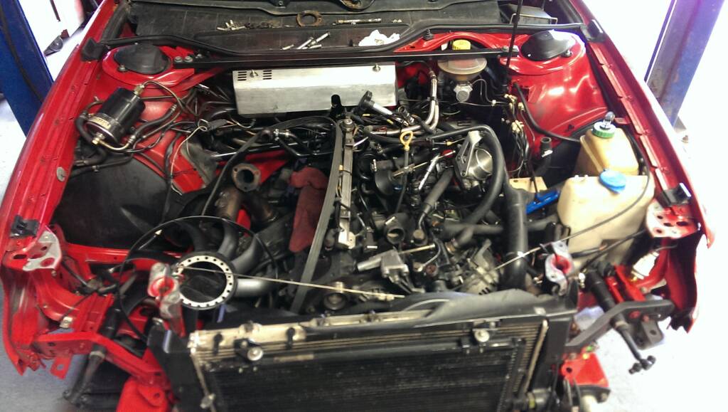

Dude, pull the radiator and AC condenser! Takes 10 minutes and makes things sooo much easier!

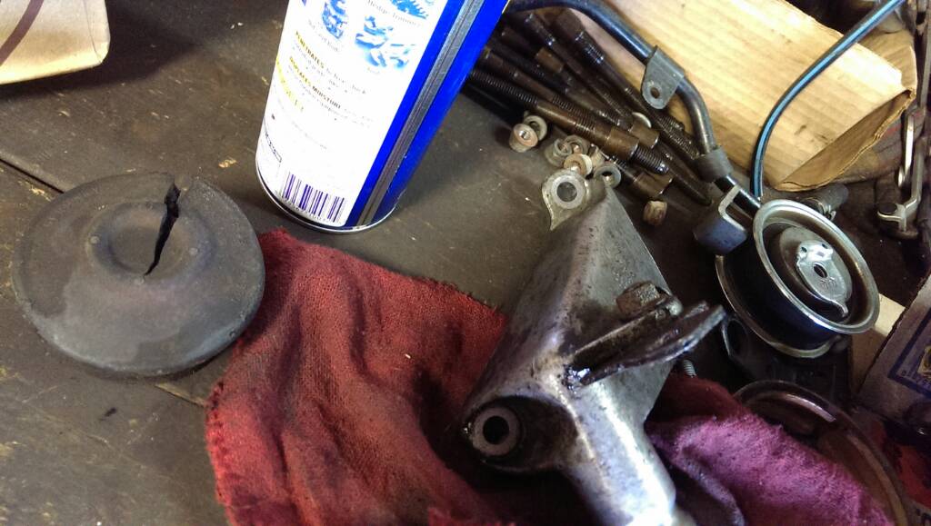

After 2 failed attempts to remove the used ones crack free... Had to pick this up.

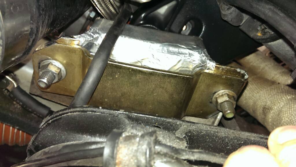

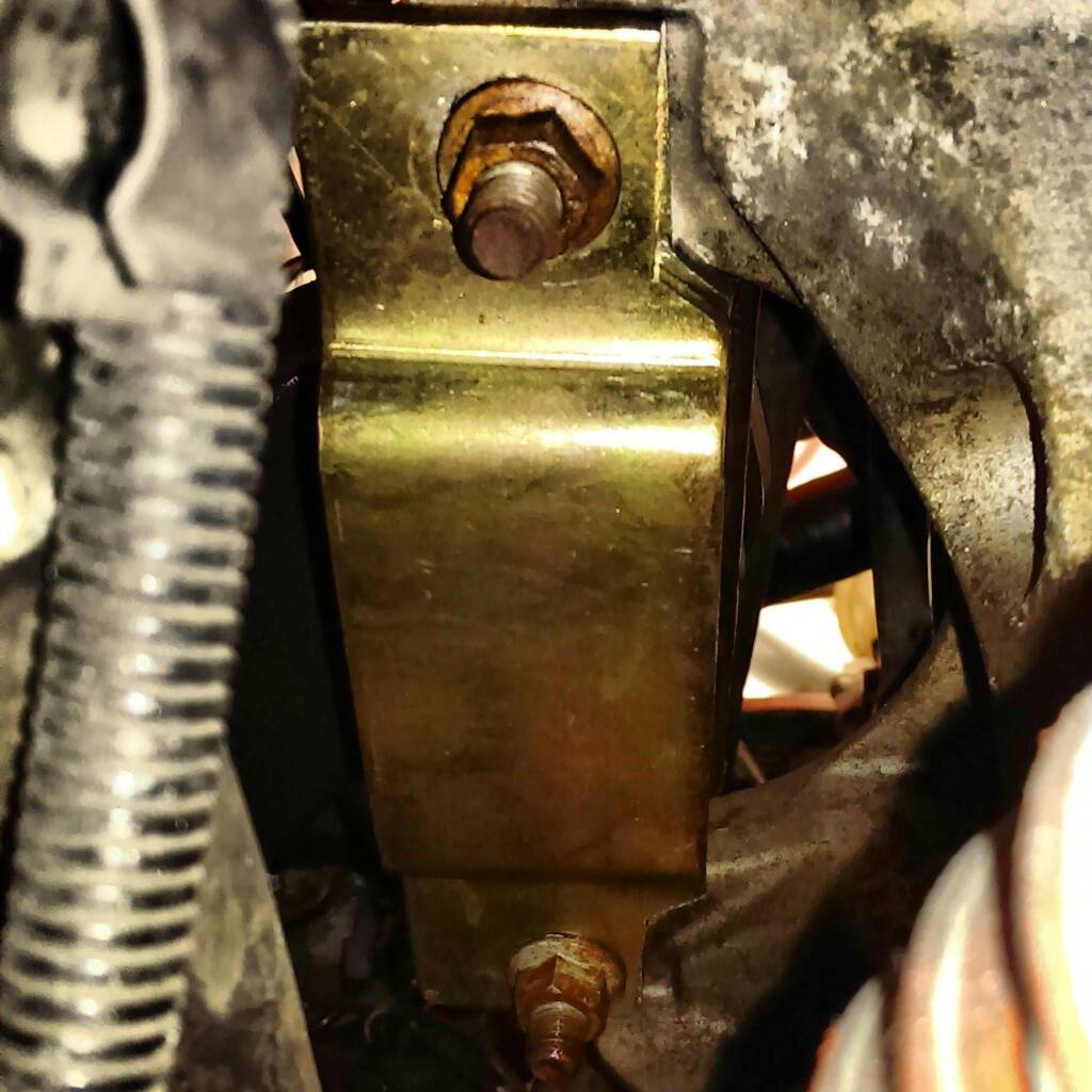

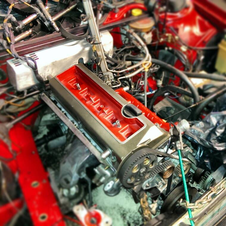

Edigreg here's the Driver side
Re: A tale of Rubí... New hardware w/PICS

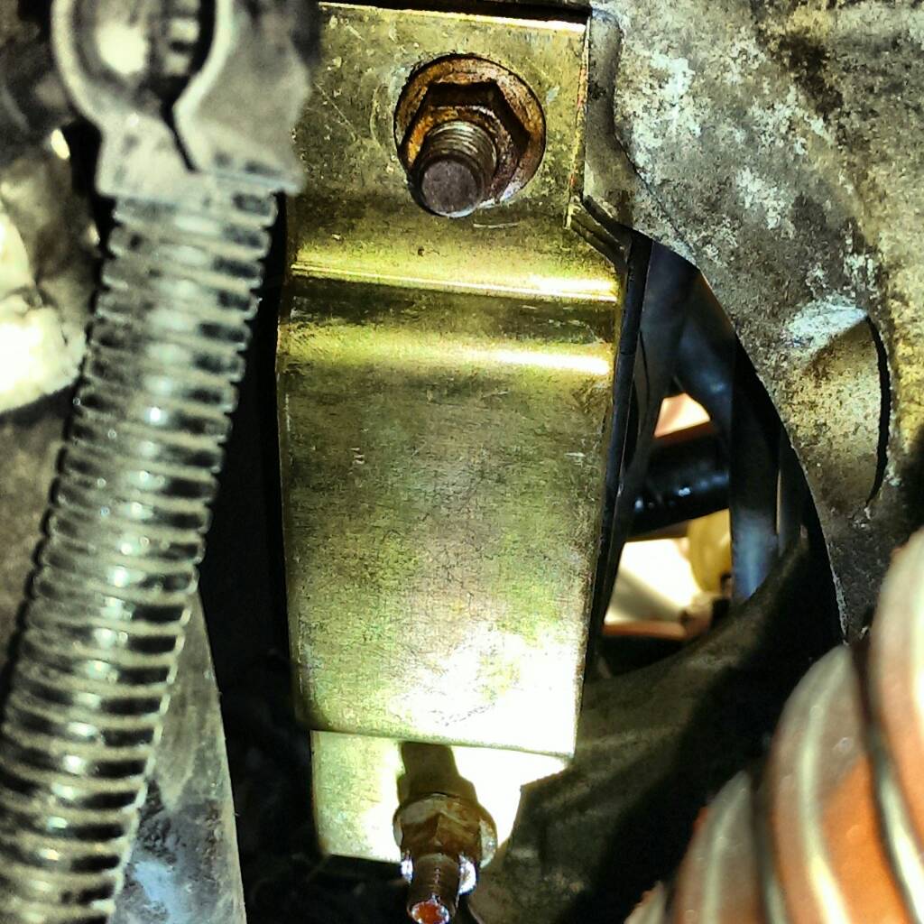

And passenger side
From this car

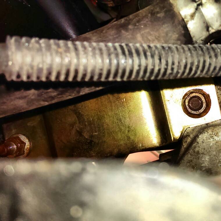

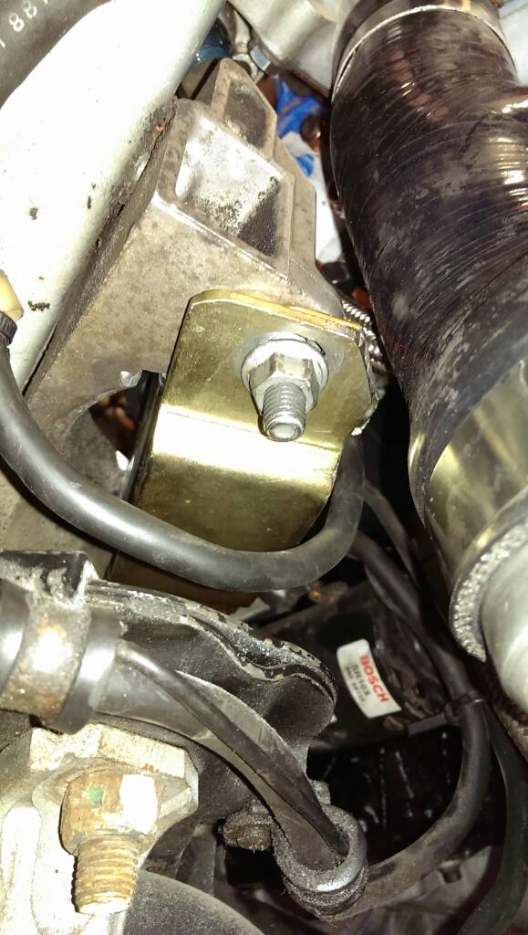

The bottom bracket is installed wrong in the photos. It should point upwards to support the mount
EDIGREG wrote:The bottom bracket is installed wrong in the photos. It should point upwards to support the mount
Really? I actually had 2 people specifically point this out as the proper placement. I was under the same impression as I thought it should go in the notch... How'd you figure it the other way?
It's obvious. The plate provides no support to the mount if it is upside down.
Google photos of the mount if you don't trust me :)
