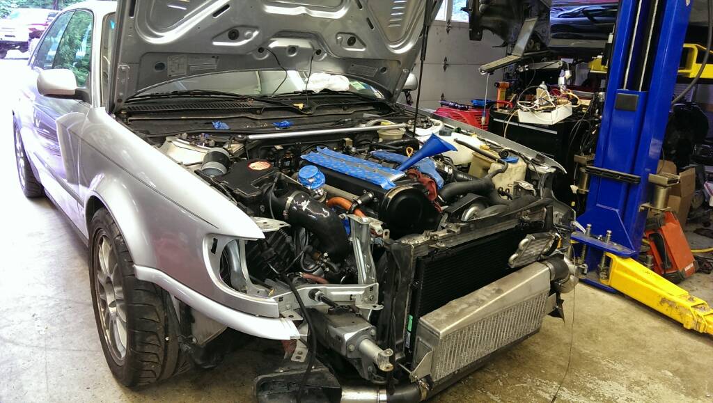

That is a #6 hotside... You know what that means.
Posted: Wed Jun 26, 2013 6:42 am
by mushasho
Hank wrote:That is a #6 hotside... You know what that means.
Yes it is... & and I now know what it meant :grin:
Posted: Wed Jun 26, 2013 9:45 am
by Hank
Yeah, the old sticking a river through a straw, making high EGTs and lots o back pressure. IE, detonation city if pushed above 310-315whp on pump gas, 340-350 on race. Bigger compressor, biggerturbine, same results + Lag.
Good news is that 600whp is going to feel that much more impressive now. Woot woot

I will inspect my manifold to see it has any inherited cracks in it from the EGT's... No more childish straw sucking for me though and 600whp is a but lofty... I'll be content with an effortless 500whp...

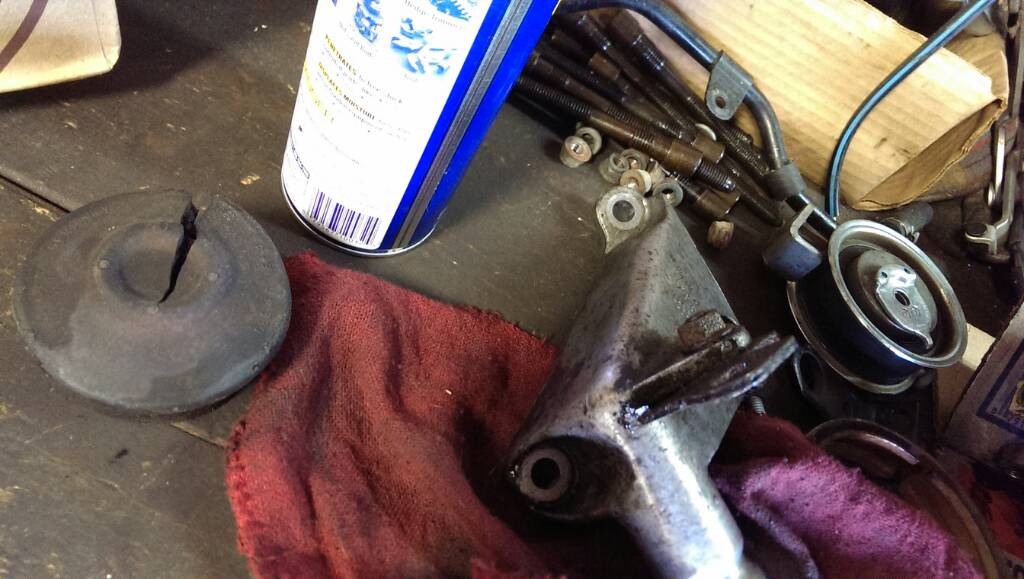

Of course I'm looking for someone on the east coast that stocks a poly snub that can ship it out today...
Re: A tale of Rubí... On lift w/PICS
Posted: Wed Jun 26, 2013 12:55 pm
OBI- If you want a free new reinforced Rubber snubber I ordered one for my 200 and when I went to put it in I realized I had a new one in already.
Free for you my friend - it's sitting in the 200's door pocket.

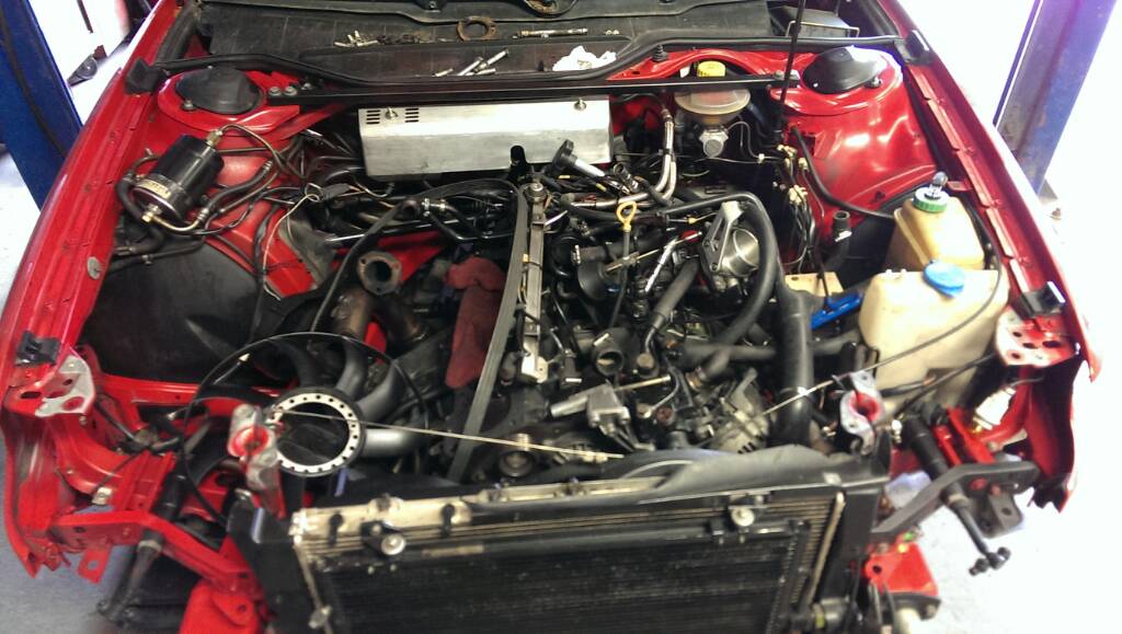

Posted: Wed Jun 26, 2013 6:33 pm
by EDIGREG
Dude, pull the radiator and AC condenser! Takes 10 minutes and makes things sooo much easier!

by mushasho
After 2 failed attempts to remove the used ones crack free... Had to pick this up.

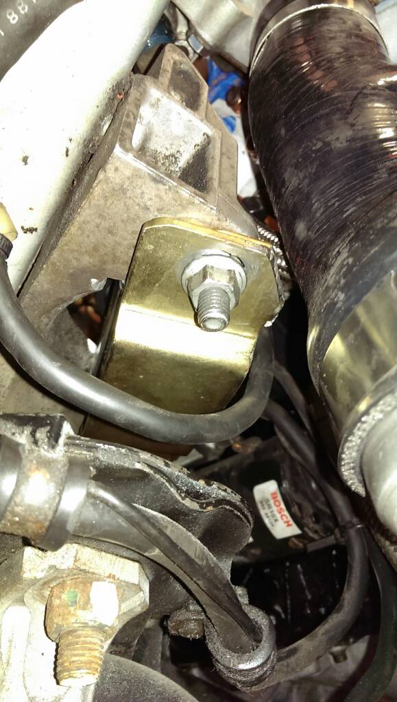

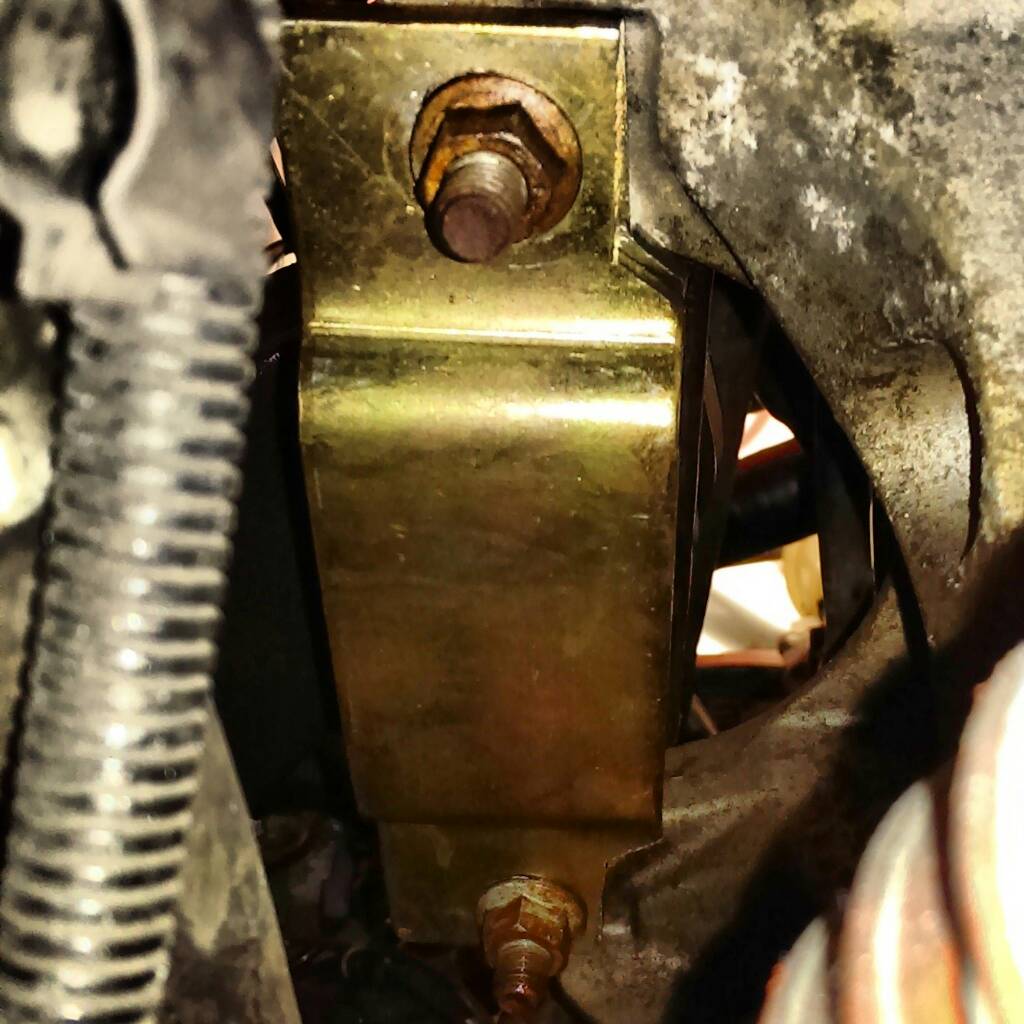

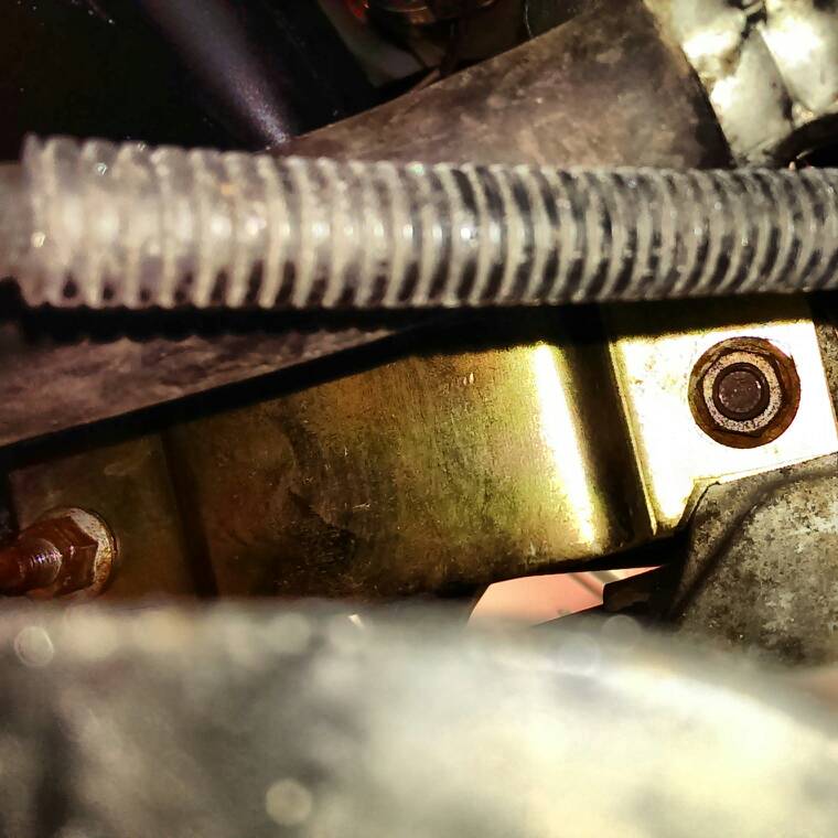

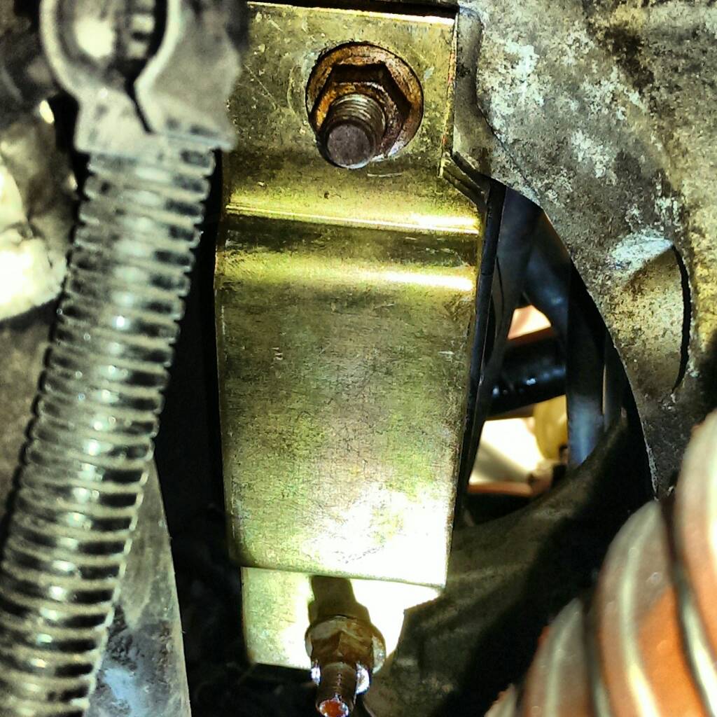

Edigreg here's the Driver side

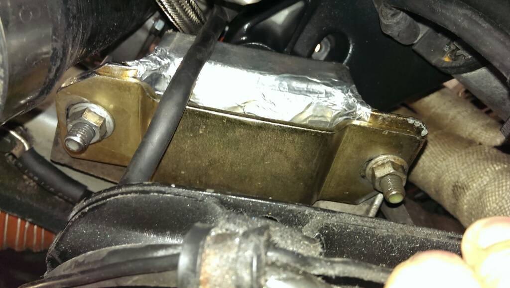

Re: A tale of Rubí... New hardware w/PICS
Posted: Fri Jun 28, 2013 9:19 pm
by EDIGREG
The bottom bracket is installed wrong in the photos. It should point upwards to support the mount
Posted: Fri Jun 28, 2013 9:24 pm
by mushasho
EDIGREG wrote:The bottom bracket is installed wrong in the photos. It should point upwards to support the mount
Really? I actually had 2 people specifically point this out as the proper placement. I was under the same impression as I thought it should go in the notch... How'd you figure it the other way?
Posted: Fri Jun 28, 2013 11:29 pm
by EDIGREG
It's obvious. The plate provides no support to the mount if it is upside down.
Google photos of the mount if you don't trust me :)

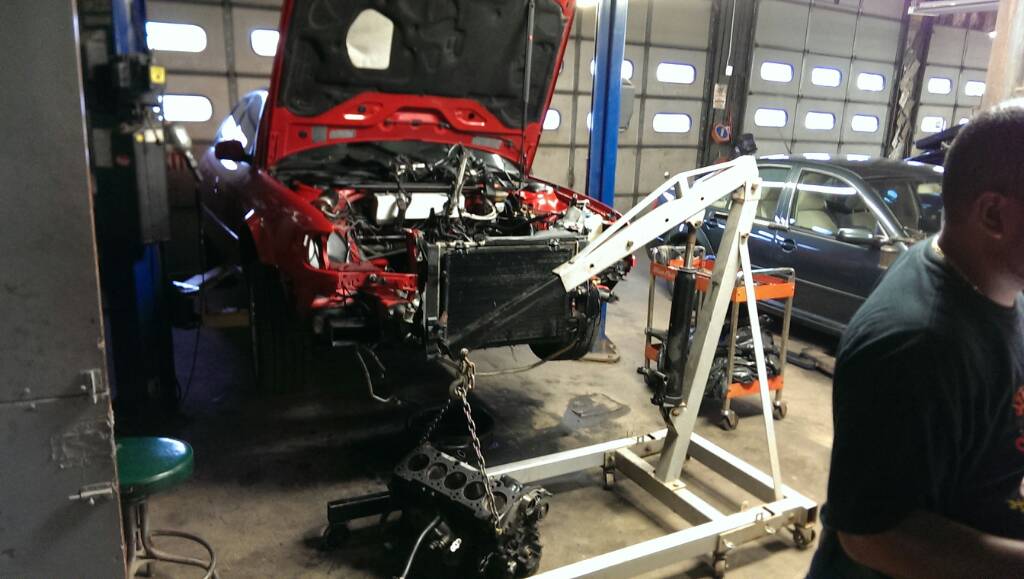

Re: A tale of Rubí... BLOCK INSTALLATION
Posted: Sat Jun 29, 2013 5:56 pm
by mushasho
Re: A tale of Rubí... Block bolted up awaiting mounts...w/PI
