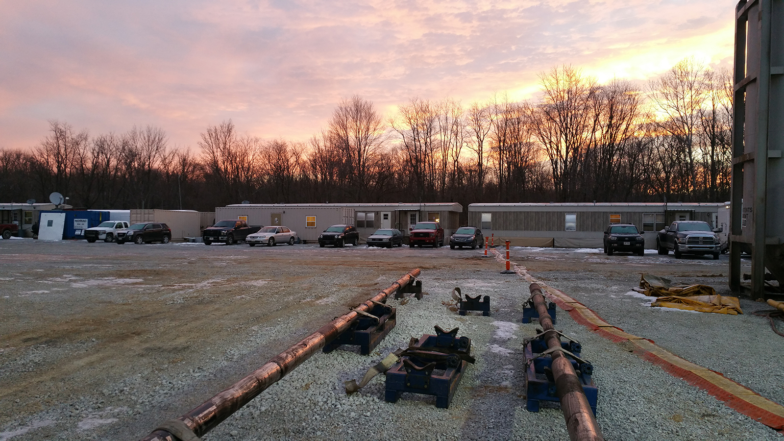

It seems I haven't posted a picture in a while. This isn't the greatest picture of the car ever, but at least it's in it! And proof that we're still drilling in the good ole' USA. :flag: :guns: :beer: :drive: :wave: :P
Audi at Rigs.jpg (1.23 MiB) Viewed 32053 times
I love making people eat their words about these cars! That's a great story!
Is the feed line the short one from the block, or the long one coming from the other side? I have a good short one from the block. The rubber was shot, but the metal line is in great shape. I can put a piece of silicone hose on it and send it your way if that's the one you need.

I've always thought the 200 was rather large, but don't she look like a cute little thing in that line up!
Good to hear it's been trudging through the muck. They really are tanks, especially when the going gets rough. I had a similar experience on the snow day we had here in K-town; it's always great to get the bewildered reactions from the passengers who insisted you couldn't make that hill you just effortlessly summited.
