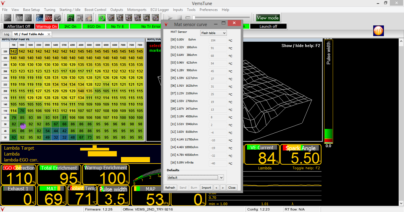

So an update. I modified the ECU by using a razor to carefully remove the 5100 resistor for the intake temp sensor circuit. I have a new 1.8t sensor here with a resistance in the 450 ohm range. The harness plug reads .016 volts or something like that and my laptop shows a reading of 154 C with the sensor plugged in and 49 C unplugged. I tried the firmware patch update procedure several times only using the IAT patch and a couple times with both coolant (online it says "For the coolant patch, select NTC 256/1900" but I noticed the order of those numbers are reversed in the software ie. 1900/256) and IAT patches for kicks. On a mostly cold engine my coolant says 30 C so hopefully that didn't change around. When I pulled out of my workplace's garage to drive the short distance back to my apartment (a whole parking lot), the unplugged sensor started out only reading 60 C and when I pulled up to my door it read 70 C. How can that value change AT ALL if the sensor is unplugged?
Below is a shot of the screen after shutdown. This table looks identical to the one from my older log files. Is this right?
- VEMS IAT.png (130.71 KiB) Viewed 36462 times
Marc is brilliant! And a huge thanks to him for helping me on the weekend! My problem was I cracked the Sauder because I didn't warm it before removing the top 5100 resistor. It works great now!
