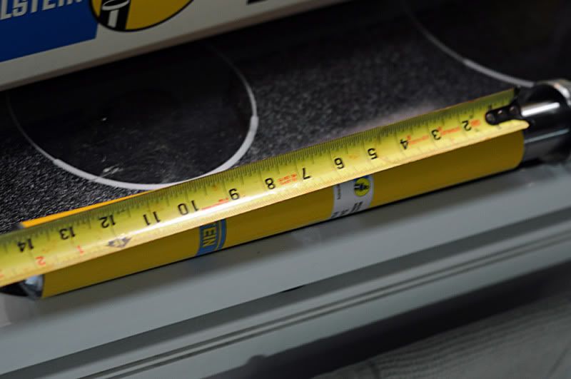

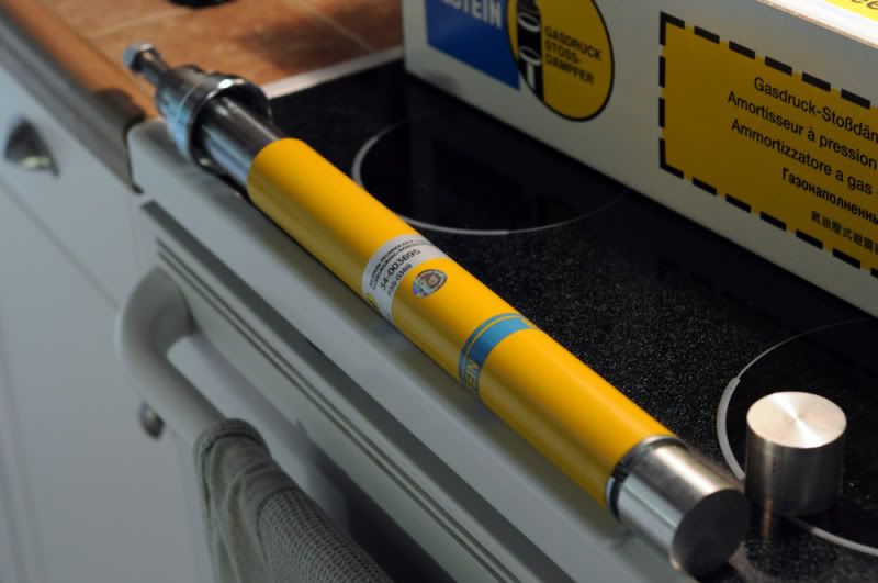

It turns out Bilstein screwed up again (I think). I finally got back home today to work on the Audi. First on the list of things to do was to get her on all fours again. Opened up my box of brand new "shortened" and revalved bilsteins for the Audi and rebuilds for my dad's 328. I looked at the Bilsteins and thought, "Wow! I can't even tell they shortened these. What a great job!"
I then went out to drop them in my un-shortened strut housings, but first I dropped my nicely made spacer in the the housing so I could run the housings un-shortened until I get time to take them off and cut/weld. Then it was time to put the strut in and go merrily on my way to getting the car back together. Too bad the strut was sticking exactly 1.5" up too high for the nut hold it in the strut housing.

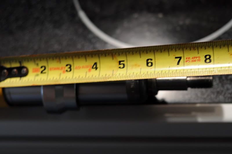

Apparently Bilstein shortened some other part of the strut. Maybe I don't understand what shortening the strut body means... can someone enlighten me?
Roughly 14" from top of the body to bottom.
8" from top of body to top of strut.
Can anyone compare these to stock ones? I'm thinking the "piston" part is the part that got shortened. I think this makes my suspension travel even worse :roll: Please confirm or deny my suspicion. If this is confirmed, I am going to contact bilstein and ask for a refund. If they deny me a refund, I will just have to tell them I will never buy Bilstein again and will steer everyone I know away from them.
I had to take the freakin strut housing off to get the spacer out of it. Turned a 20 min job putting the suspension back on into a 2 hour job :curses:

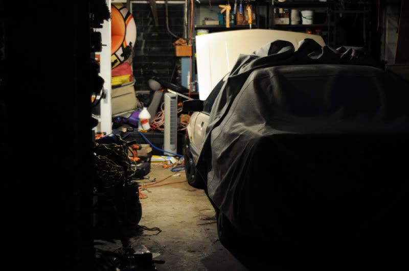

On another note, I'm just glad to have the car back on all-fours for now. I can focus on getting the new turbo/manifold/dp in tomorrow and hopefully get it started! Here is how she sits now

If i am not mistaken they do shorten the strut tube. Or did they confirm with you that they were going to shorten the body?
Loxxrider's 200 20v: :D
They are inverted, I'm guessing they consider the yellow end the piston and the silver end the body. Sucks if that is what happened.
Re: Loxxrider's 200 20v: :D
Yeah, thats what I'm thinking happened too. I clearly explained what I wanted done to them and why. Only problem is, I have no record of it because it was all phone conversations.

loxxrider wrote:Yeah, thats what I'm thinking happened too. I clearly explained what I wanted done to them and why. Only problem is, I have no record of it because it was all phone conversations.
Seems like it would be a common request! :frustrated:

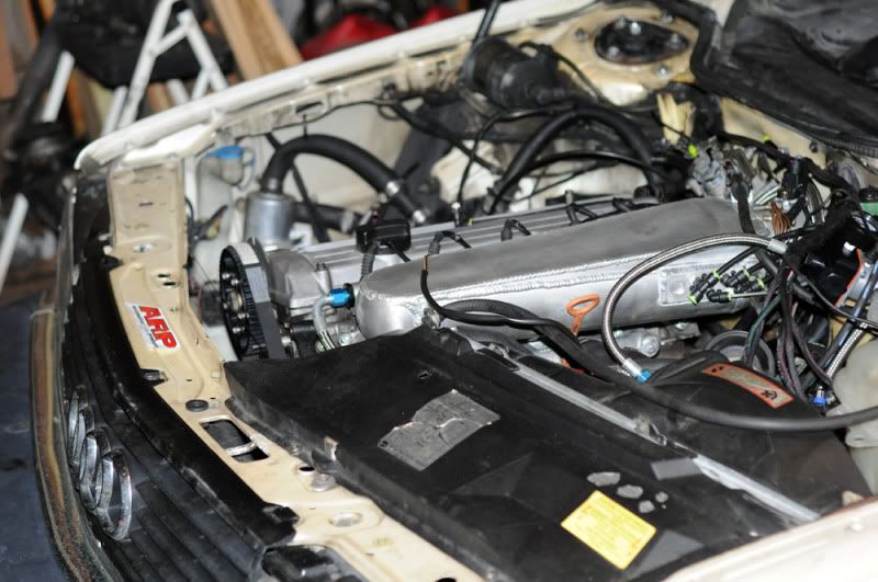

Teaser?
Only problem is my oil return line doesn't quite reach anymore. Good thing I brought extra -10 hose home :)
Off to make oil return line!
OK I don't really like teasers that much... here is one more :)
Hank, :heart: :dur:

1 fuel rail?
VWAudi4Life
Post by VWAudi4Life »
Speechless
Hybrid_Hatch wrote:1 fuel rail?
Should I have more than one?
Bad news, the oil line I brought home was a bit bigger than -10 :frustrated: the quest has now evolved into jacking some -10 from one of my friends.
