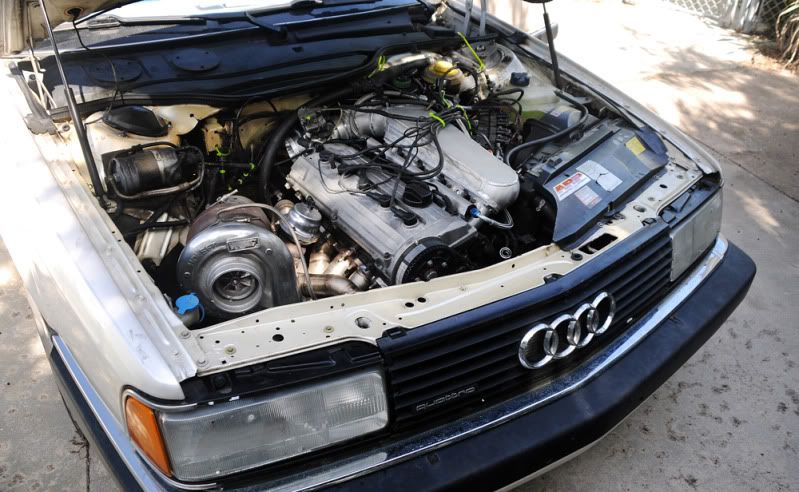

Re: Loxxrider's 200 20v: IT LIVES!!!!
This is the only "good" pic I have for now. Not good in terms of photo quality, just good in terms of it having all of my parts present and in OK lighting. Mind you, everything is very rough and thats why there are lots of zip-ties. I just needed it running and able to drive down the street basically.
