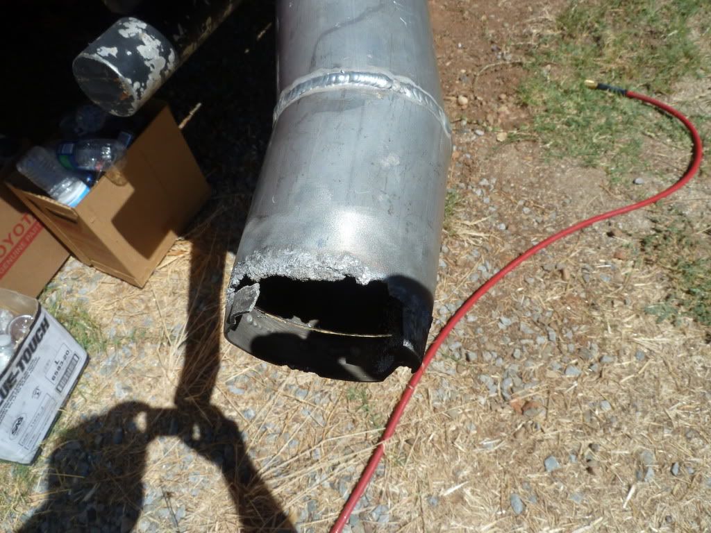

You can see how the rear mount doesnt allow for forward movement of the exhaust...
This is what happens because of that and a scrunched up flex pipe...
Heres the vband flange after grinding all the weld and pipe peices off and then hammering it onto the last of the 3" scraps...
Forgot to get a pic of the finshed product so i'll get one later.
Dan

Not sure if it's been thought about, but one other thing to consider with the aluminum exhausts is the high CTE of the material and that it will lengthen up to about 0.5" when very hot...This expansion requires mid/rear mounts that can accommodate the movement. This problem is also compounded by the poor fatigue life of aluminum.

Yes, I saw that too Chris. Being hard mounted will be very hard on the exhaust. Mine was always free flowing on rubber hangers.

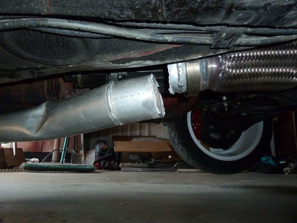

Well, bad news first. Exhaust broke again and tagged the ground which gave it a nice kink where it makes the transistion from singel to duall. Dont think its effective to try and repair it this time due to a couple reasons so plans now call for a single 3" stainless system with a real muffler at the back. Gonna start collecting parts for it soon. Stil havnt pulled it off yet but heres an undercar pic...
The real bummer is that the car is gonna sit until it gets towed up to derracuda so we can fab up the new exhaust while im there for the whole thanksgiving week in november :( Maybe I'll see if i can fab up a little muffler off of the flex pipe in the meantime.

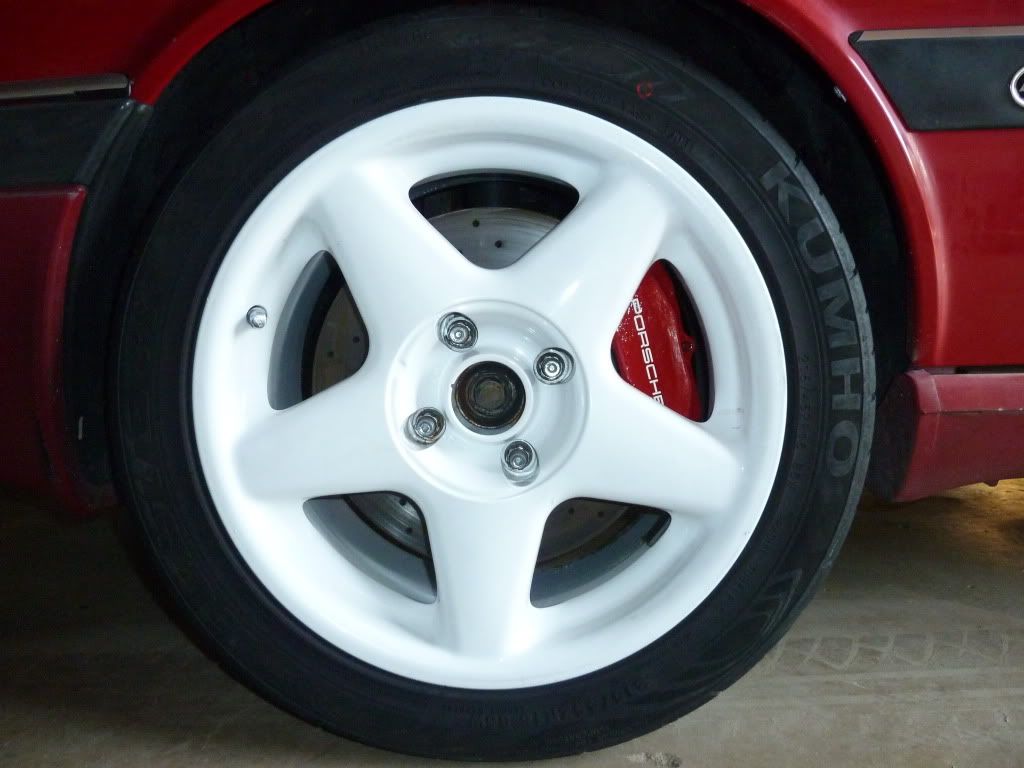

And now for the good news. I pulled my front wheels off to clean em and decided to give my calipers a fresh coat of red caliper paint and put on the high temp decals extreme90path got me while I was at it. This makes me happy...

Looks great man! ... other than broken exhaust. :(

On a side note, I'd seriously take a look at your exhaust design. I'm assuming a hanger broke then contact with the ground was made?
Your hangers should be redundant enough that every other one can fail and the exhaust still hangs in the same place.

What are hangers? LOL. No hangers in the front section, so your are correct as to why it kissed the ground. I wish the fix was that easy. I wish it was that easy to fix, the problem is that its kinked where the 3" was custom massaged down for the duall 2" pipe. So you cant just slide a pipe over it and clamp it on :( I still need to pull it off and officially declare it dead though. So there is a gilmmer of hope. The other reason why id like to just redo it is because of the lack of muffler. The rear section needs to be completely rebuild to add a muffler...so if the front and rear sections need to be rebuilt i may as well just build a more proper system. I'm gonna talk it over with derracuda in depth before i order any material.
