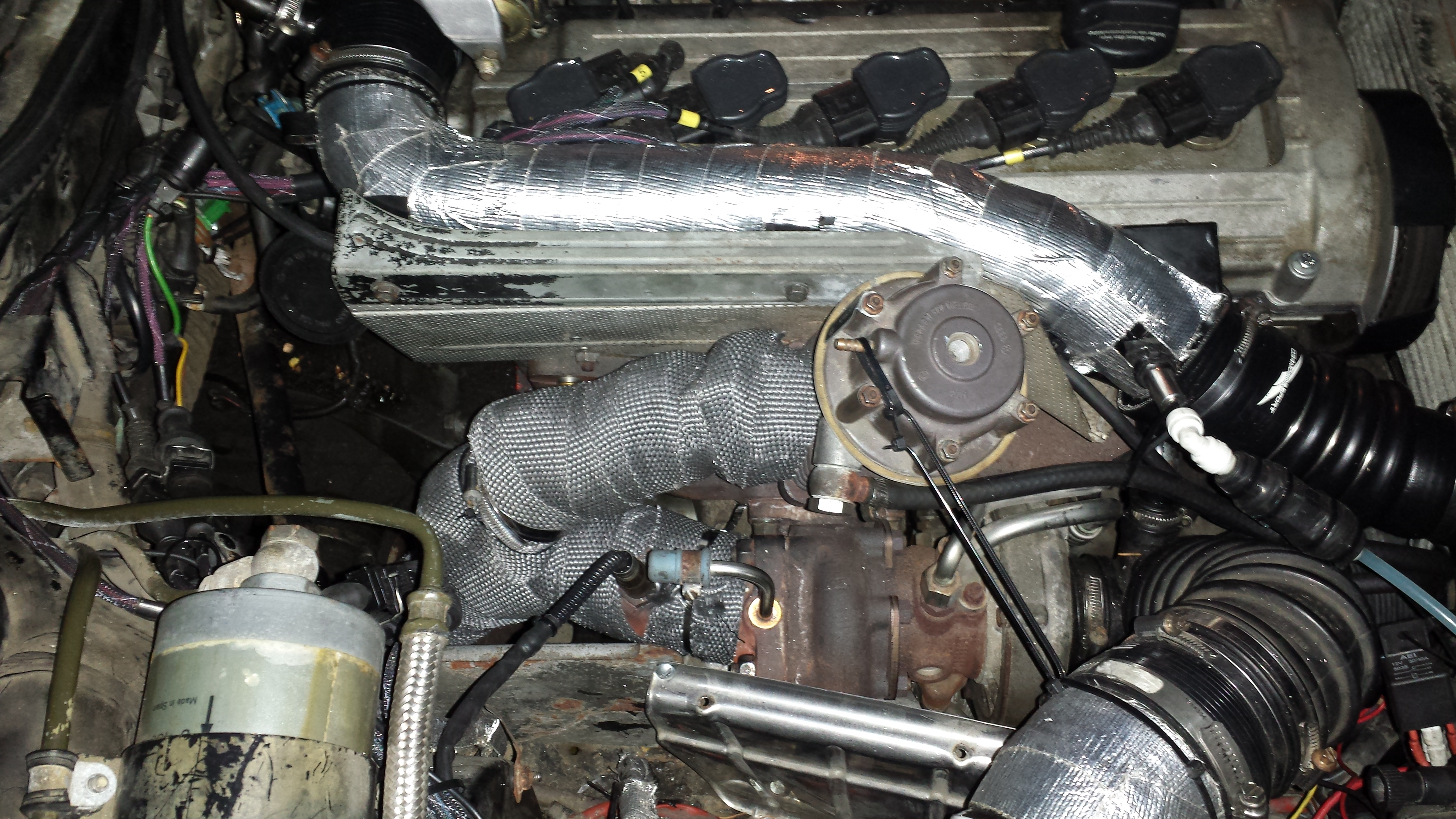

Rightio! I did this today in an attempt to bring down underhood temperatures dramatically. Time will tell me.
Also changed the oring on the dipstick and the car seems to run quite well in the lower rpm's. Maybe I found the cause of my stalling issue when engaging first gear. It was faaar too difficult to not be an intake leak in my opinion.
When I had to "modify" my wastegate flex hose to accept the s2 ebay exhaust manifold I had to remove an internal pipe from it which probably caused it to dissipate a cap load of heat through the very thin flex pipe into the engine bay. Just guessing but those flet pipe really seem thin on their own.
- 20141203_192303.jpg (3.87 MiB) Viewed 37613 times

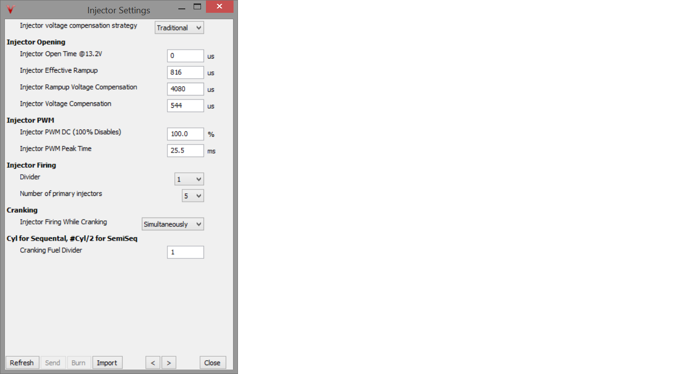

This week I am retuning my fuel VE table and the acceleration enrichment graph since my stock injectors were being stupid in low RPM's. The car stalled too often or encountered hard cold starting far too often for my taste and it was damaging my perceived opinion of how shitty my neighbor thinks my cars are
. I HAD to put the used injectors in in an attempt to solve this embarrassing side effect of old injectors. One of the old injectors had a cracked tip cap also so that may have been jacking up atomization.
I also realized I didn't have the smallest meth nozzle JB welded to my charge pipe as I had thought. I was running piiiiiiiiG rich on the lowest pressure so that needed remedied also.
The new injectors are used with 10k miles with p/n D3165BA . I don't have ANY information on these injectors except for what is turned up on the racetronix website for that part number. Its a long shot that they are the correct injectors IMO. First of all, the measured resistance I got was 15.1 and 15.2 ohms compared to the website's reported 15.9 ohms. What the hell does that mean?! I was a little concerned about that honestly. Im thinking it could be my ohm meter from Harbor Freight just has a % error. The seller is unreachable at this time...
I am getting very strange behavior with these injectors at idle. I have my first 6 VE cells set to 87 in the idle region (3 tall and 2 wide) as that netted the most stable idle with the stockers. Sometimes the injectors provide 0.99 lambda at idle and will go clear to 0.88 without my injector ms changing. That is just odd to me. No changes to my enrichment or afterstart stuff or even changing the fuel VE numbers to lean(er) affect the lambda at the time unless I blip the throttle. When I originally put the injectors in, I was under the impression I could just change the req'd fuel based on the ratio of change in flow cc's. It worked out to a 25% increase in flow if I was following exactly as listed here: http://www.racetronix.biz/itemdesc.asp? ... BA&eq=&Tp= . That link doesn't even give me the injector dead time or ANYTHING pertinent to VEMS settings except for the estimated lb/hr flow rate. Anyway, I calculated the correct req'd fuel value and it was too low by about 8 tenths or more IIRC. way off. Also, my VE table became useless and Im in the middle of a complete remap. I admit that my old tune, though it ran incredibly, was never tuned for fuel VE with meth injection turned off. I am running with it off until I can truly tune fuel. One last note in VEMS. With my fuel VE set to 87 for idle, sometimes it is as lean as 1.09 lambda or rich as 0.88 with that left constant and warm turned off. Its completely different from the behavior of the old injectors in an uneasy manner.
Can anyone help or make a suggestion as to figuring out the injector settings? I feel those are more pressing than the VE table at this time. I just am unsure how to determine the finer details of these injectors and VEMS settings. For instance, my injector angle graph is 720 across the board and my injector settings are still what my base tune provided shown below. THANK YOU to anyone who can be of assistance. I mean that intensely.
. I HAD to put the used injectors in in an attempt to solve this embarrassing side effect of old injectors. One of the old injectors had a cracked tip cap also so that may have been jacking up atomization.I also realized I didn't have the smallest meth nozzle JB welded to my charge pipe as I had thought. I was running piiiiiiiiG rich on the lowest pressure so that needed remedied also.
- Untitled.png (86.05 KiB) Viewed 37140 times
I found this concerning the numbers for the inputs in the picture above:
"Rep injector I used Traditional Idel 860 rpm 0,192,4080,544"
Not the best English but I may try that 192 to see if it blows up my engine. From s2 forum
Where did your base tune come from? If it's from Marc, just leave those injector settings alone. They work for anything from stock up to 2000 cc injectors with no problem. If you're having issues, it's either the injectors or the VE table (or some other mechanical issue we don't know about). Sorry I can't get more detailed at the moment, but I'm quite busy. Otherwise, I'd compare your settings to what I know works.
Thanks Chris. I changed that rampup to 192 and things seem to have improved sort of. Glancing down at my lambda I saw the numbers were much closer to target than before. I did have to bump my entire VE table up +5 after the change. The cfg is from Marc. I had a cold start issue that cleared up after going to 192. the rest will probably be handled with the VE table.
