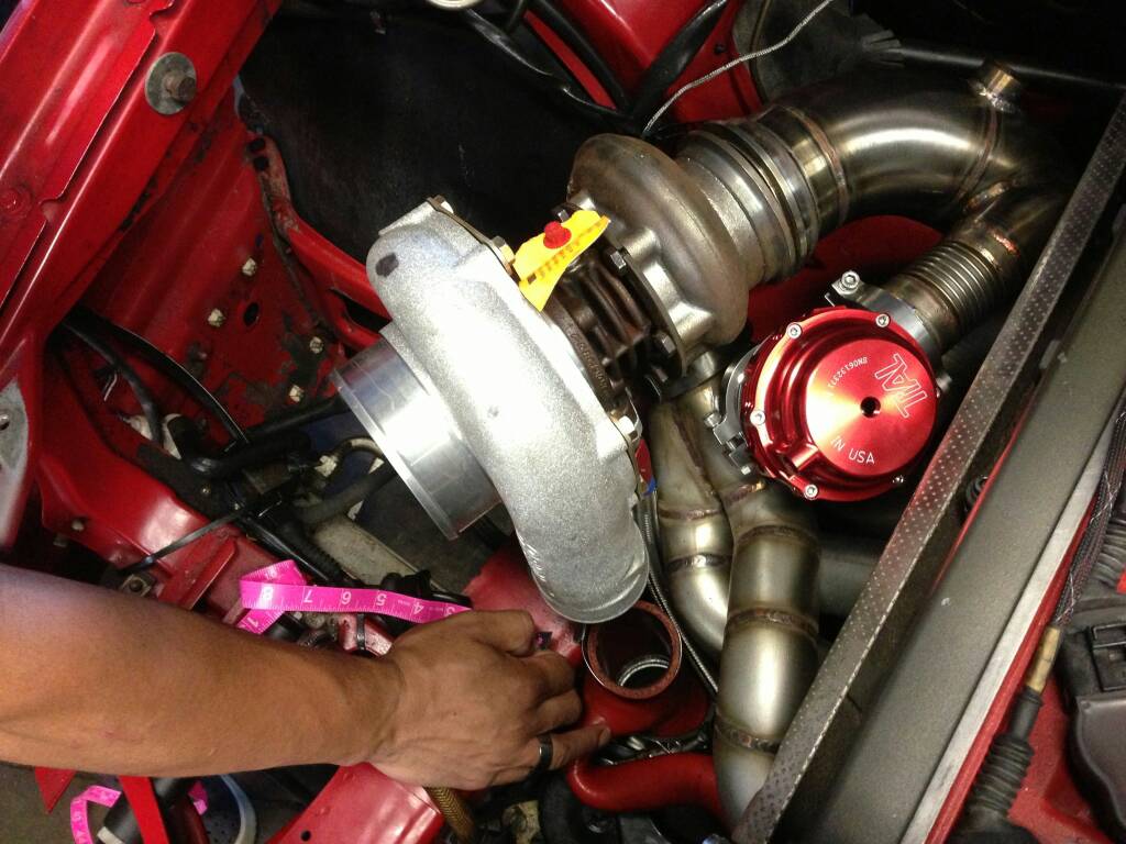

Re: A tale of Rubí... PTE & Manifold Sexy time..w/PIC
Posted: Wed Jul 03, 2013 3:27 pm
by Hank
Keep rotating it around. There is a perfect spot where they will both meet up. Anything small will be taken up by the flex first time it is heat cycled with decent wastegate use. Looks great
Edit, from my point of view, looks like the turbo needs to rotate back a tad, and the flex on the coupler shows that it is not perfect too.
Posted: Wed Jul 03, 2013 5:01 pm
by mushasho
Posted: Wed Jul 03, 2013 6:14 pm
by EDIGREG
Looking good!! Like Hank said, rotate the turbo back a bit and it will mate up perfectly

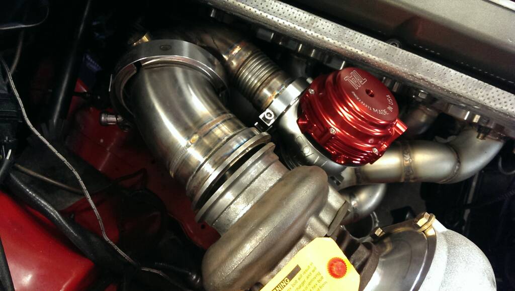

Posted: Wed Jul 03, 2013 6:42 pm
by mushasho
EDIGREG wrote:Looking good!! Like Hank said, rotate the turbo back a bit and it will mate up perfectly
Then wastegate tube stretches... Didn't think was supposed to be that way,,.. but whatever...
She'll be sitting like this until Friday
I still need more little things...
Posted: Wed Jul 03, 2013 8:54 pm
by Hank
No, the wastegate should not be stretching. Look, those all will line up if you rotate the housings inlet right, and then rotate the wastegate inlet vband a little bit till teh the right combo is achieved. You will find that once you get the wastegate on, the inlet clamp will likely never come off again. I never removed mine on my car once the initial install, even though the turbos came and went, along with downpipes when I swapped transmissions.
I really don't want that wastegate stretching at all in it's natural position, and compressing is better if you need to do anything. But all those pictures I sent you, those are all without a clamp needed on the wastegate outlet, and the fitment was within 1/32nd.
Looks freaking spectacular, the engine bay looks really nice. Well done OB
Posted: Wed Jul 03, 2013 10:21 pm
by roortube
OB...I concur...it you leave all clamps loose you will find the right angle for everything to fall into place. When I installed this combo in my S4 I got it right first time. It took A while on the S6A but I found it. Keep playing with it. You may find that it helps to have someone under the car playing with the end if the DP while you adjust the turbo and WG.

Hank wrote:No, the wastegate should not be stretching. Look, those all will line up if you rotate the housings inlet right, and then rotate the wastegate inlet vband a little bit till teh the right combo is achieved. You will find that once you get the wastegate on, the inlet clamp will likely never come off again. I never removed mine on my car once the initial install, even though the turbos came and went, along with downpipes when I swapped transmissions.
Muchas gracias... But I will give it a go in Friday again... Right now it's Moscato time...

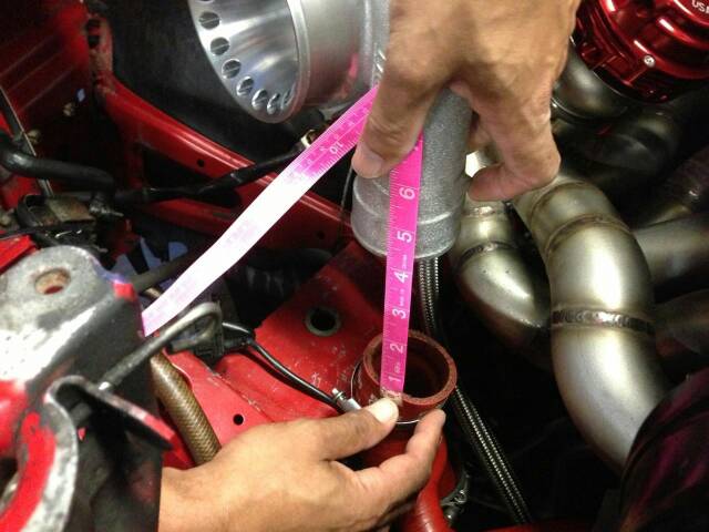

5) Figure out what the hell I'm gonna do with my existing Samco hose under the compressor. Extending the intercooler piping to raise the Samco's position higher does not look like it'll line up(for obvious reasons, ie, better turbo placement)... Going solid isn't feasible right now...
Posted: Fri Jul 05, 2013 7:47 pm

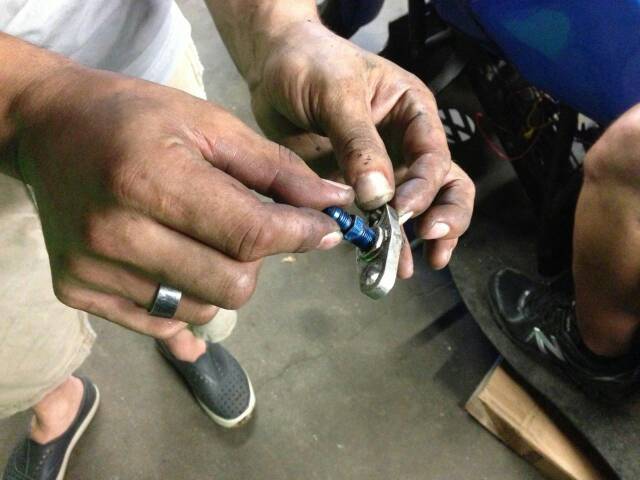

by mushasho
Gotta find a -4an fitting to reuse the existing flange....
Few inches off...
I'll have a cheap mild steel/silicone coupler fix in there in the meantime...
