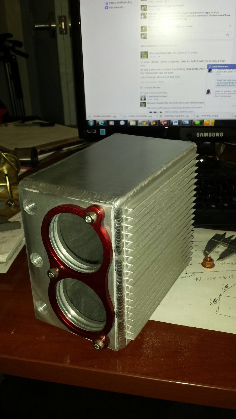

Post by 2.5TYPE44 »
I shouldn't have to worry about positive crank case or valve cover pressure and oil should stay cleaner for longer periods of time. There's plenty of flow, baffling, media, and filtering for separation in my catch can. I could probably have a half worn out motor with tons of blow by and still be ok as long as you don't forget to keep adding oil.

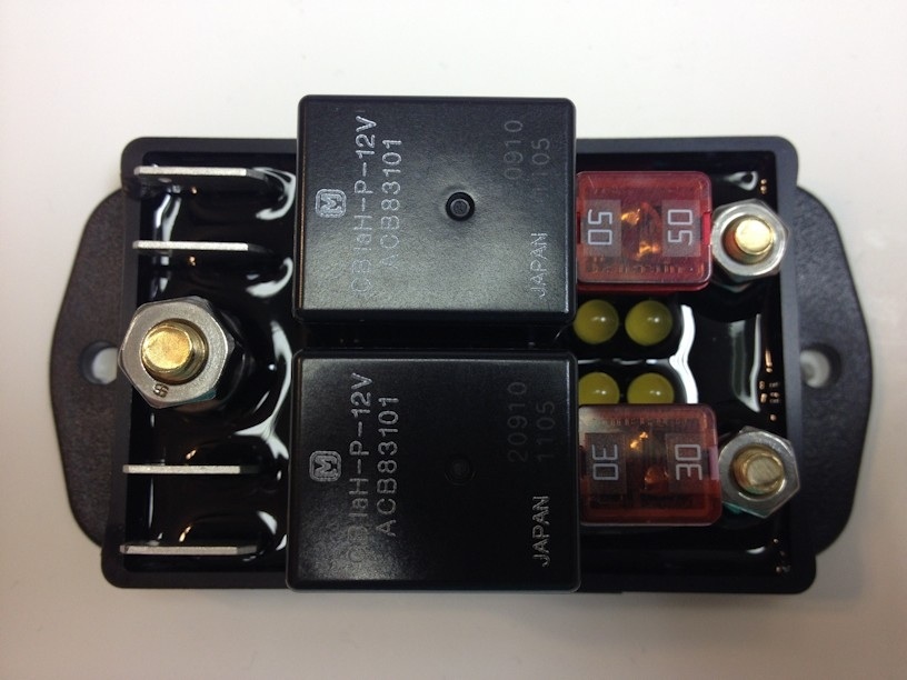

Got a nifty little dual relay board that has l.e.d. Failure indicator lights to run the dual 044's. Will make for a clean install. The fuel pumps should run pretty cool being mounted down low up in front of the car and help with keeping higher pressure being up front and close to the fuel rail.
