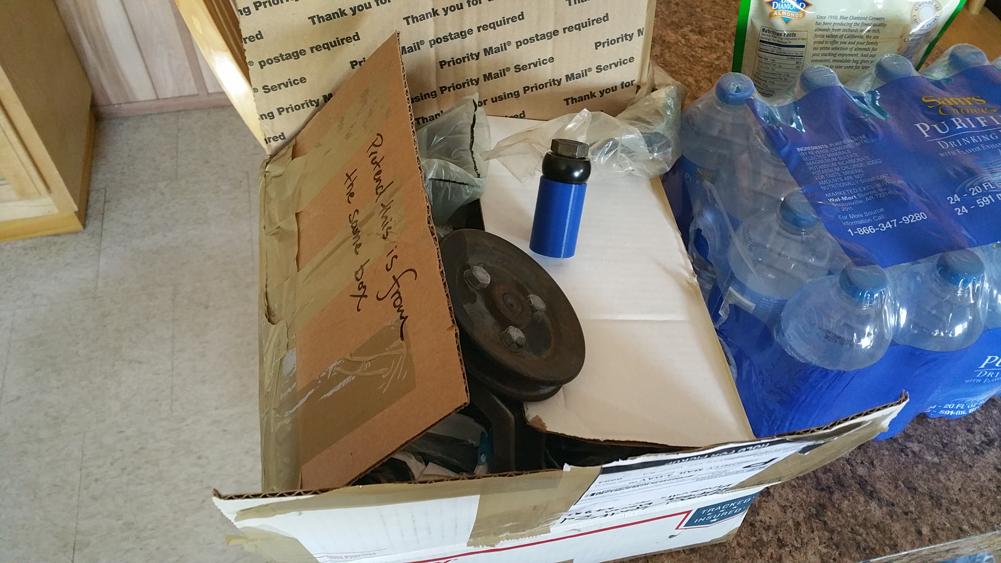

Just got the pumps today along with some of the other parts. I can't thank you enough Kevin!
Love the box lol

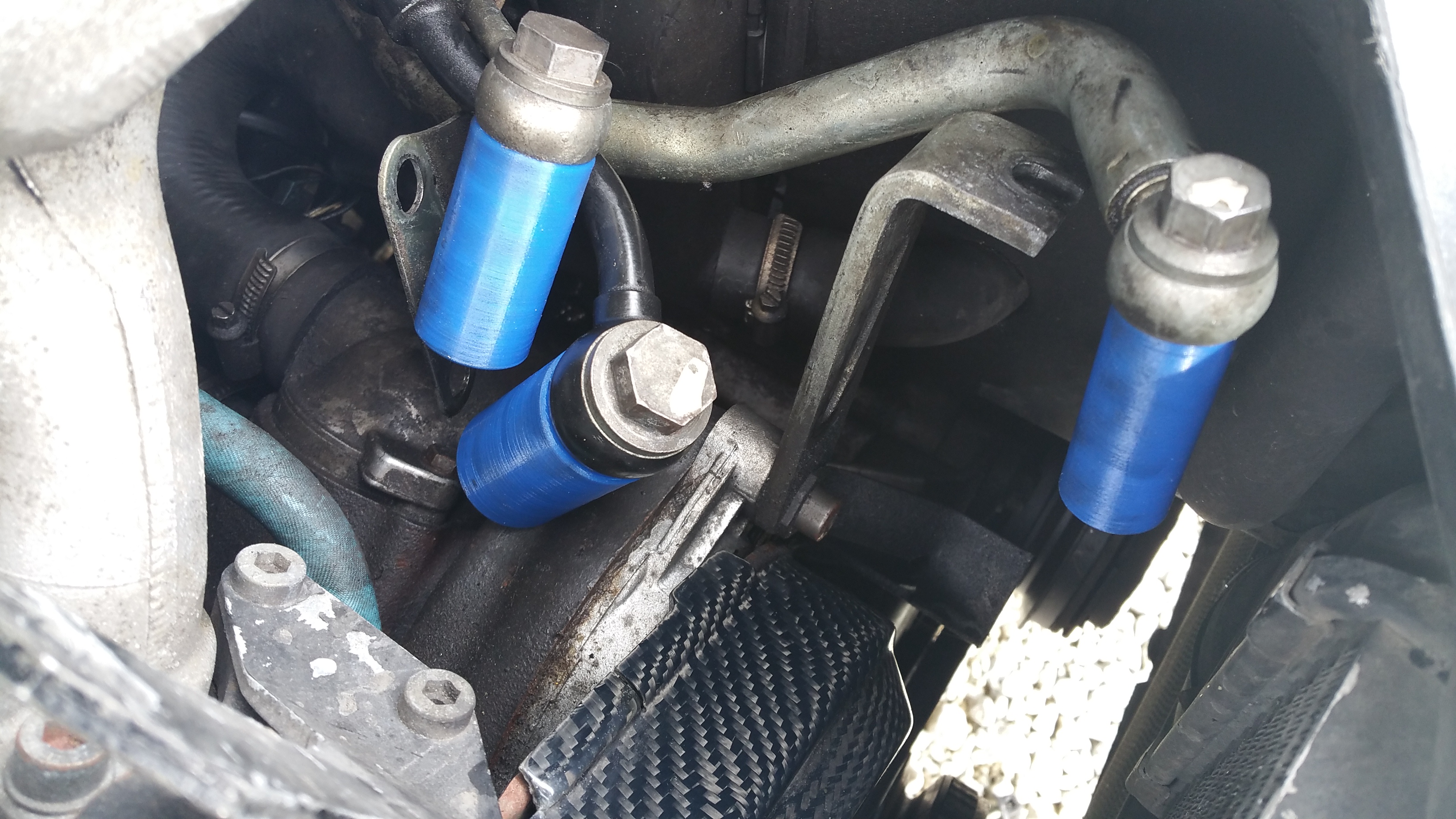

You can also see one of the temporary banjo plugs (blue) I made on the 3d printer so I could plug the lines in between getting the pumps swapped out. I love that printer!

Those banjo caps are pretty nifty, though. Probably beats the classic let-fluid-dump-all-over-everything method
