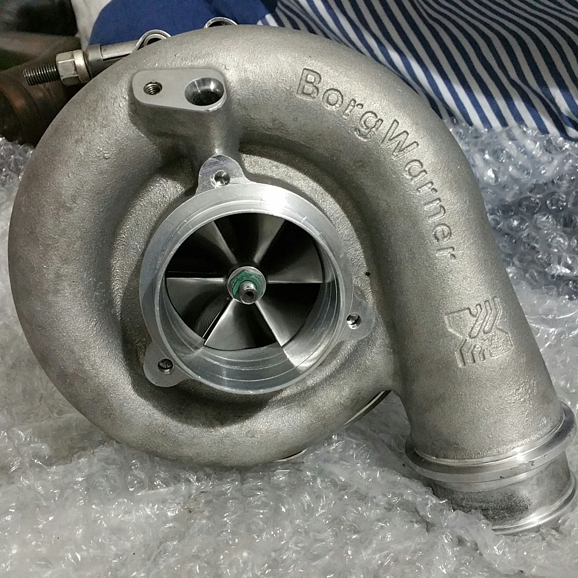

Hi
- 20160716_223130.jpg (2.2 MiB) Viewed 34657 times

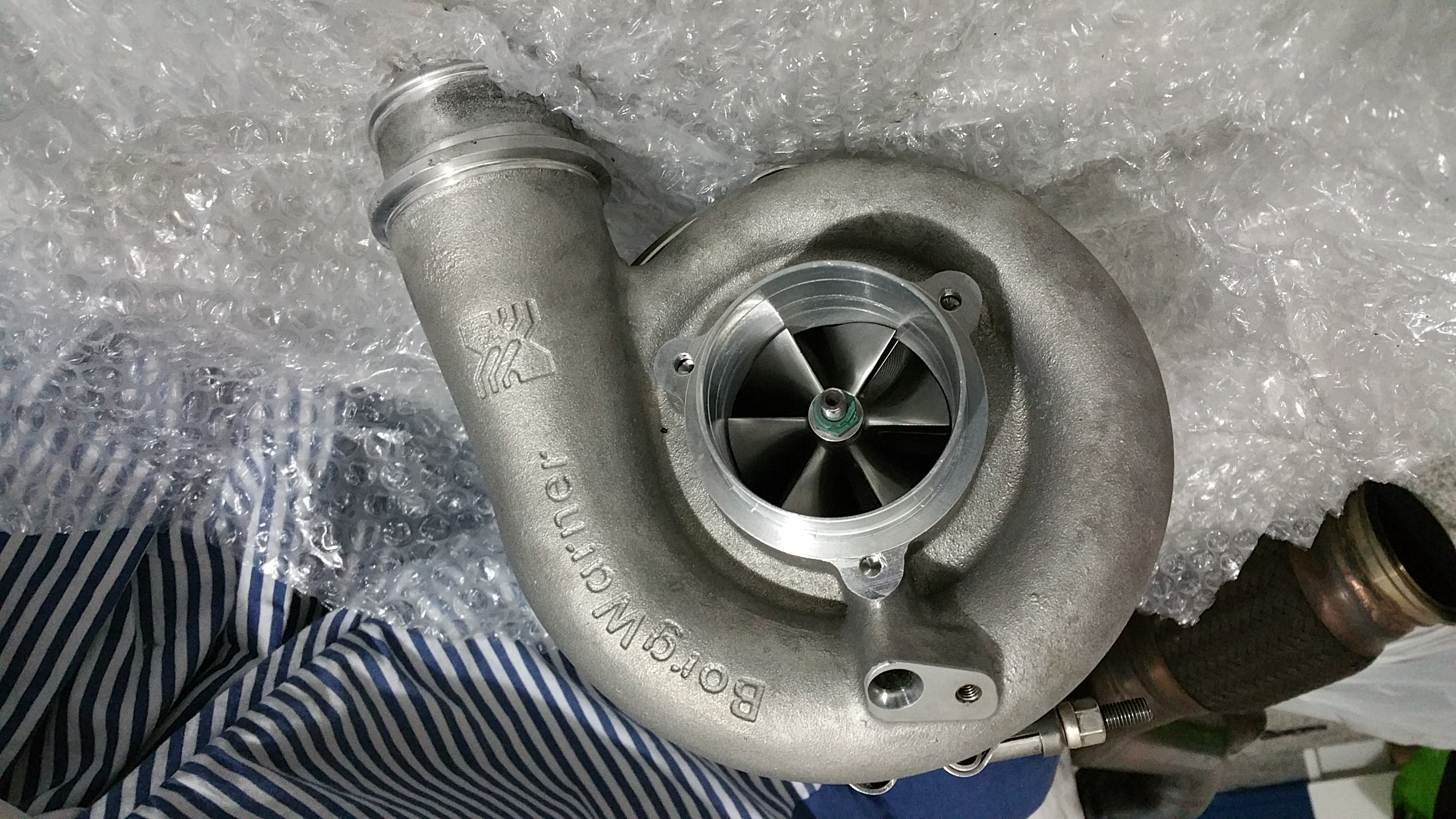

Hmm
- 20160716_223130-1.jpg (2.34 MiB) Viewed 34648 times
Someone had a good waterfest
Did you choose an EFR?
Is that a 9180?
Is that a 9180?
Haha no, just a little 6758.
According to Marc, spools like stock but then HOLY S****!
loxxrider wrote:Haha no, just a little 6758.
Can confirm
they're a damn hoot and a half.

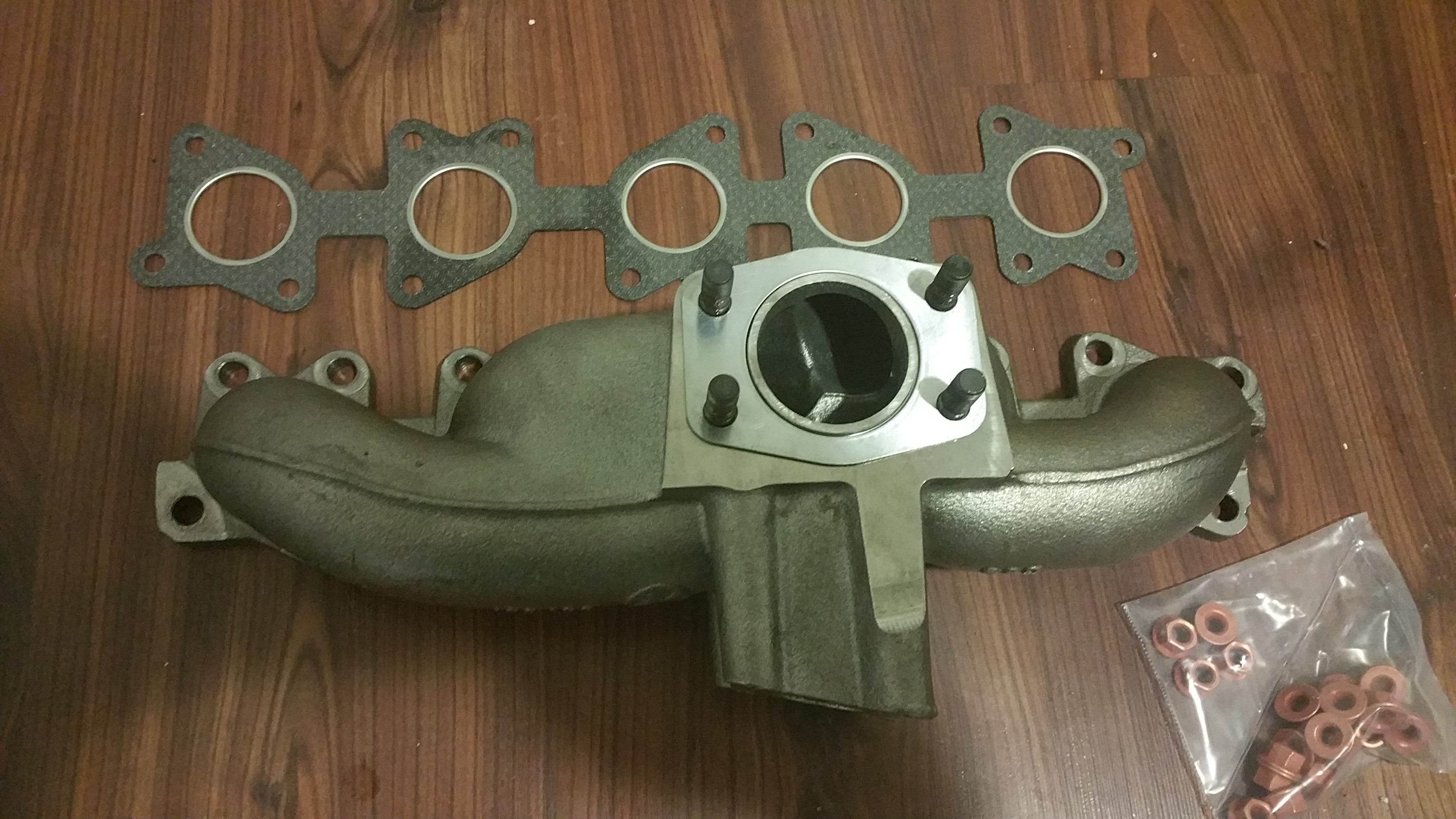

I do have at least a picture of the manifold and one of the car to hold you over.

Rennwgn

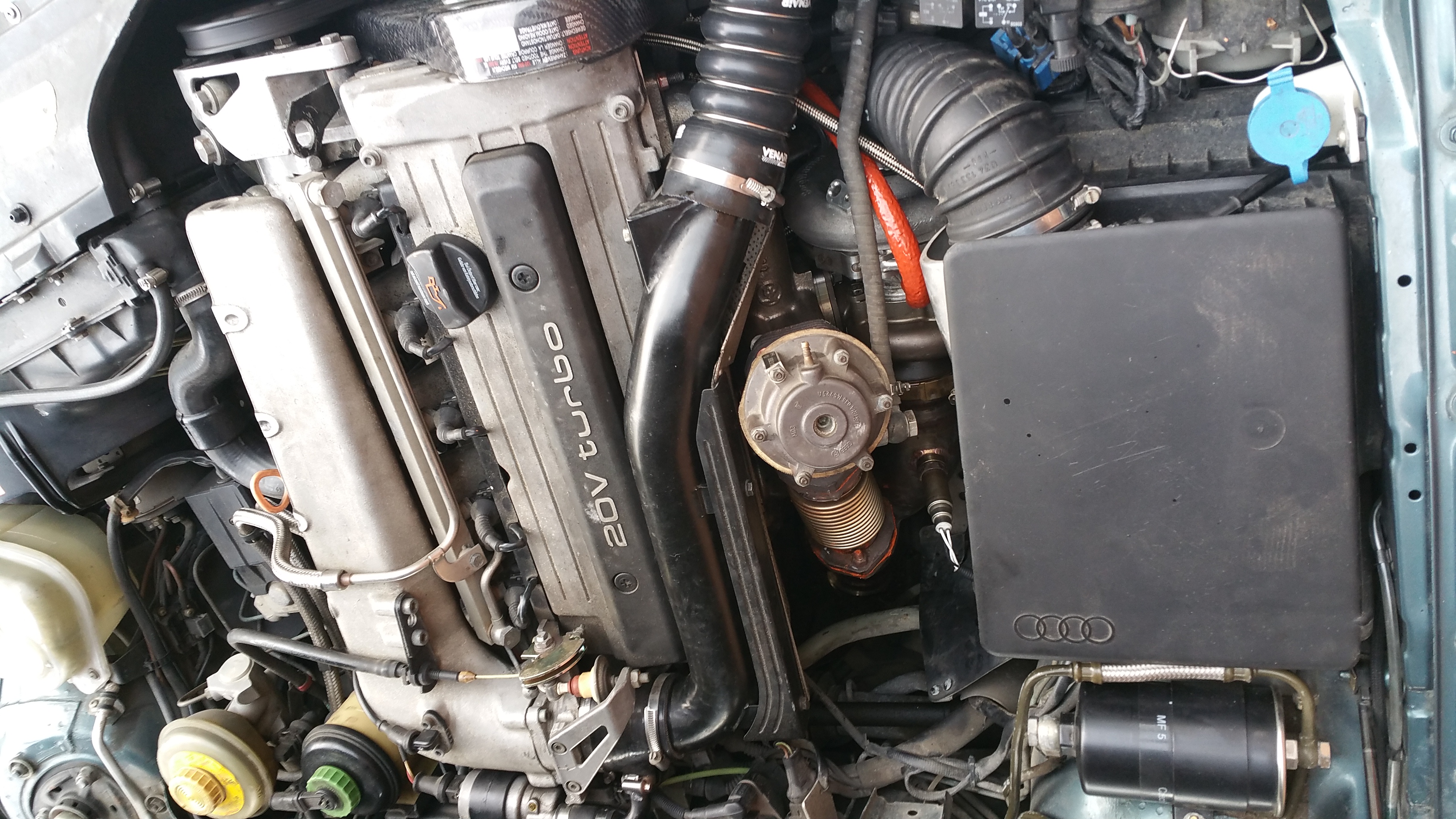

Welp, it's in but not without its problems. Still have to fill with coolant tomorrow, the rear section of the exhaust is bungee corded up near the transmission, the wastegate reference line is plugged because I didn't have the right size hose for it, and... Wait for it...
I forgot to put the gasket between the turbo and the manifold. FUUUUUUUUUUUUUUUUUH!!!!!!!
I noticed that after it was completely assembled. Not happy about it. I was thinking Oh, I have a vband. No more gaskets to put on, yay! Here's to hoping it still seals. At least enough for me to drive it for a while until I can redo it all over again :(
Yay for long distance drives with open downpipe!

Didn't look much different than stock!

loxxrider wrote:Welp, it's in but not without its problems. Still have to fill with coolant tomorrow, the rear section of the exhaust is bungee corded up near the transmission, the wastegate reference line is plugged because I didn't have the right size hose for it, and... Wait for it...
Haha! Sorry dude! Sounds like something i would do. Car looks good. New setup should make for a dynamite daily. Looking good!
