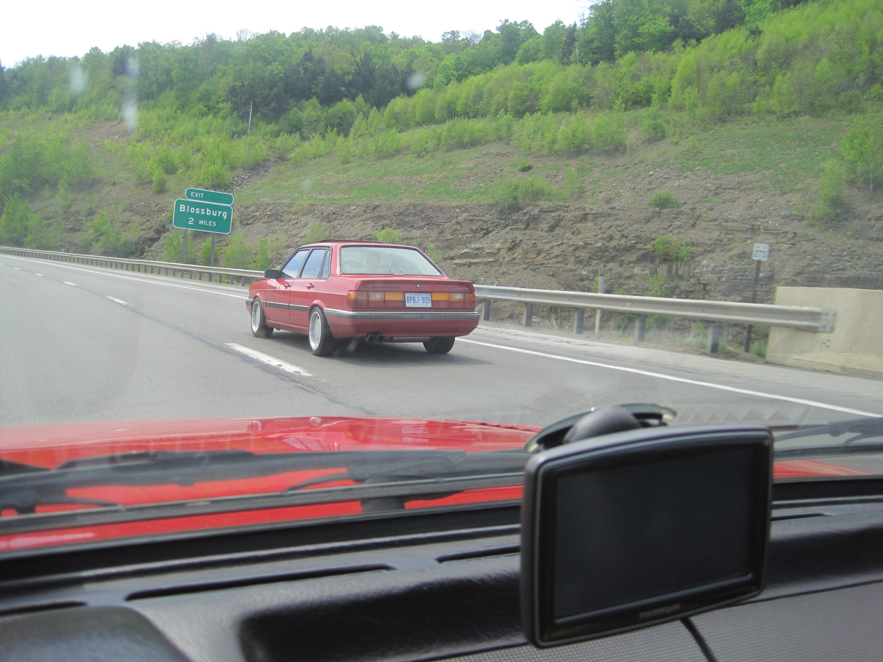

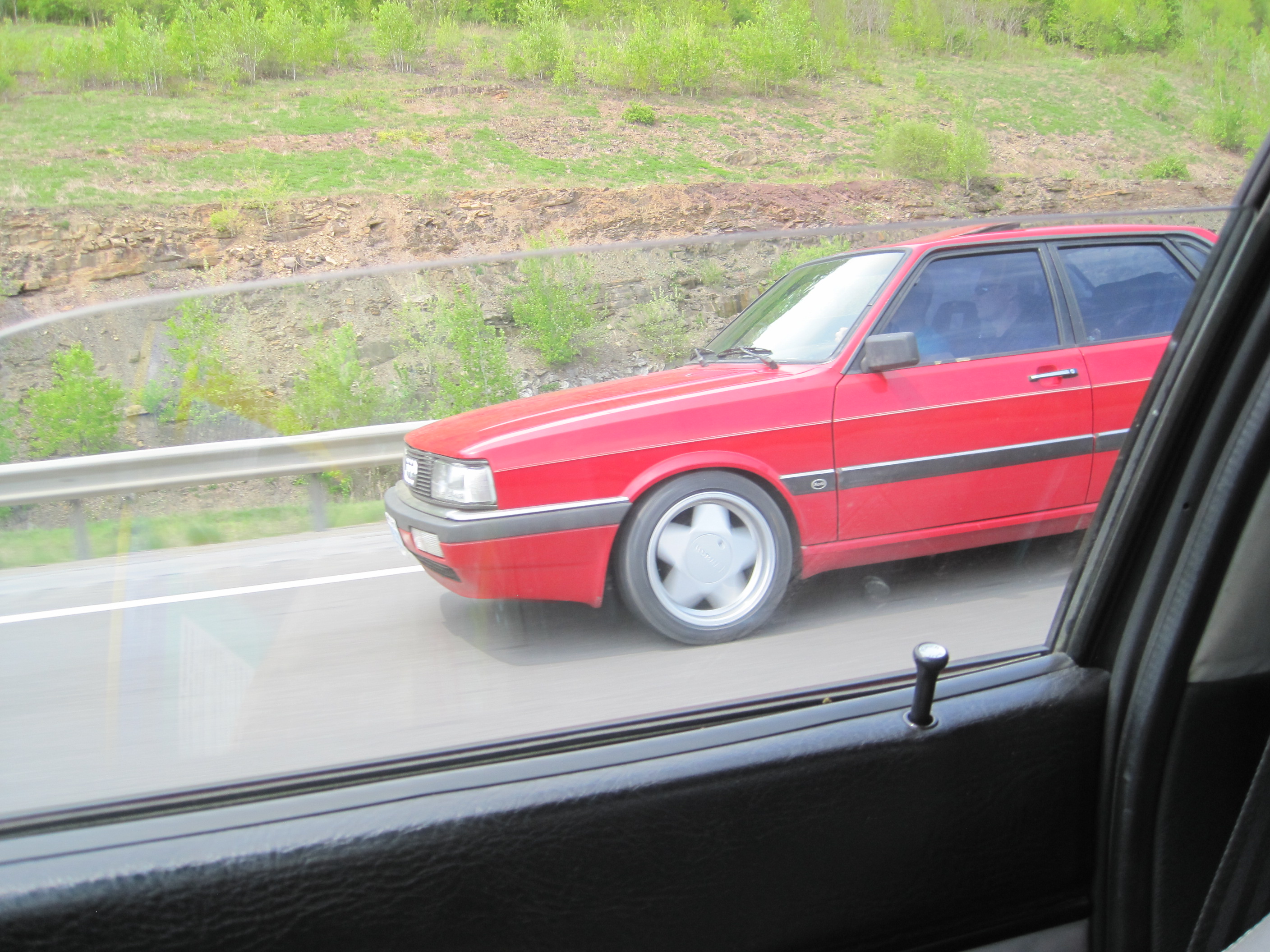

Matt,
We're getting this puppy back on track. Come hell or high water.........it will be done!!
These pics sum up why we do the crazy things we do. Happier times, pre carnage pics on the way to Carlisle.
Craig.
Craig.
- IMG_0559.JPG (1.46 MiB) Viewed 26381 times
