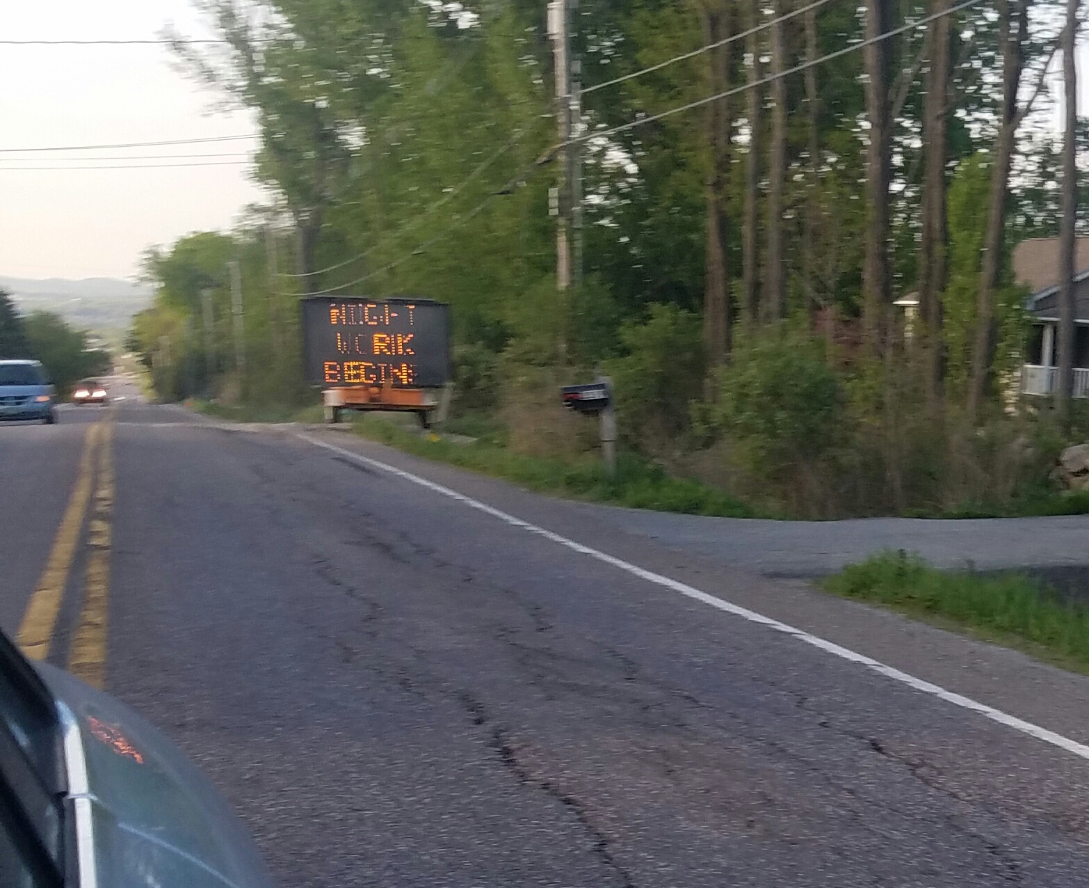

They put up a sign for the part of missing road Dana's brand new wheels found. That crevasse was no joke, I'm really impressed with how well the fifteen52's took it.
- uploadfromtaptalk1464221468364.jpg (1.19 MiB) Viewed 49766 times

awesome pic Ben, thanks!

vt10vt wrote:They put up a sign for the part of missing road Dana's brand new wheels found. That crevasse was no joke, I'm really impressed with how well the fifteen52's took it.
i still get hot with anger when I think about this. I need to get these wheels straightened. Its ruining the awesome of this car. After this week, it goes back into the shop for cam, lifters, springs, maybe some paint, and wheel fixing. Lame.

I hope it's cheaper up there to have the wheels fixed then here in PA. I talked to the one good local place about straightening a set a few years ago. He asked how much it would cost to replace them, and when I said $1500, he said to buy new ones... I wasn't very pleased with that.
Re: 1.9 TDI into 90q: The mad dash for Carlisle
DE80q wrote:I hope it's cheaper up there to have the wheels fixed then here in PA. I talked to the one good local place about straightening a set a few years ago. He asked how much it would cost to replace them, and when I said $1500, he said to buy new ones... I wasn't very pleased with that.
its 75 bucks per wheel if your bring it with the tire off. Fair enough I suppose. The new wheels are around 300 each plus they took 3 months to get custom drilled etc, so new isnt really what I want to do.
