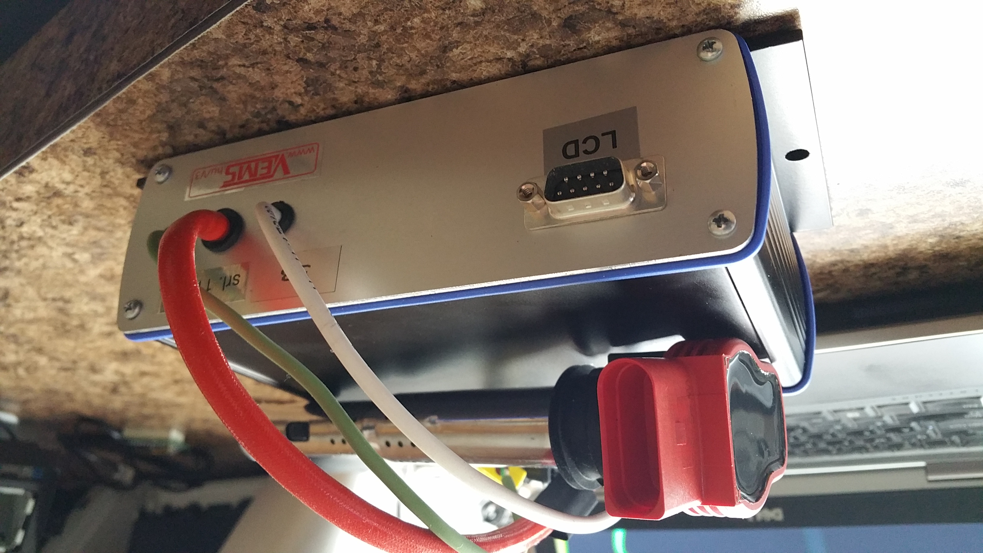

VEMS is coming. Woo! Thanks Marc.

Marc is sending the VEMS out today. It will have an input set up for a flex fuel sensor just in case I want a taste of the corn...

So I installed VEMS the other day, but the injectors I have were not sent to me with the bottom caps on them. I'm having some overnighted to the post office near the rig so I can install them on Friday. I have the old injectors out already, so I'd like to avoid having to put them back in due to the new bottom caps not getting here soon enough. Coil harness is on the way as of today as well, so it'll be ready for a full 25 psi Friday night I think.
I chose to have Marc send me a bluetooth module for VEMS, and since I need a new phone, I'm going to use my Galaxy Note 4 as a display during normal operation. I'll also tune with the bluetooth. Sweet! Now I have to figure out how to power the phone without the battery (so that it can turn on and off when the car does) and have it always start up on the VEMS app. I have plans for how to achieve both. I'll also probably design an enclosure for it to go into. So far, it seems the best place might be to just cover the oil pressure, oil temp, and voltage gauges in the cluster. That way it is easy to reach and very visible. It also wouldn't stick out too badly if someone was looking inside.
