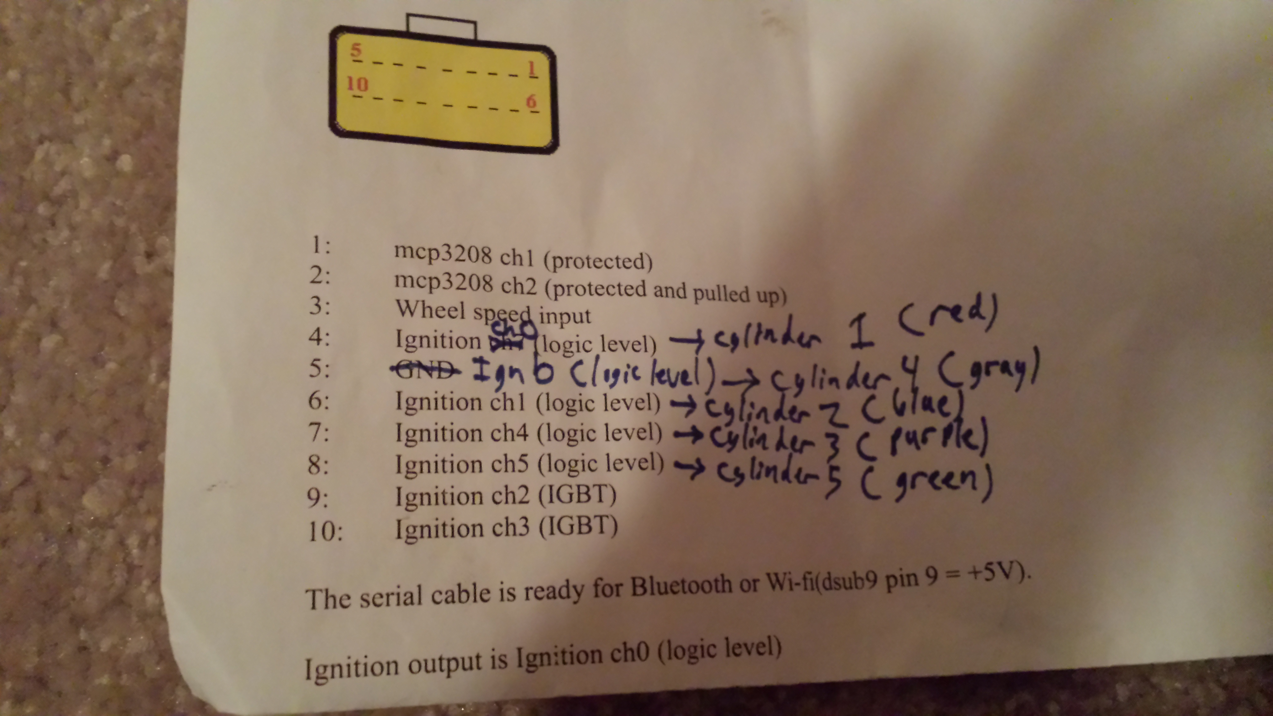

My pin out sheet
- 20150503_213632.jpg (1.61 MiB) Viewed 30763 times
