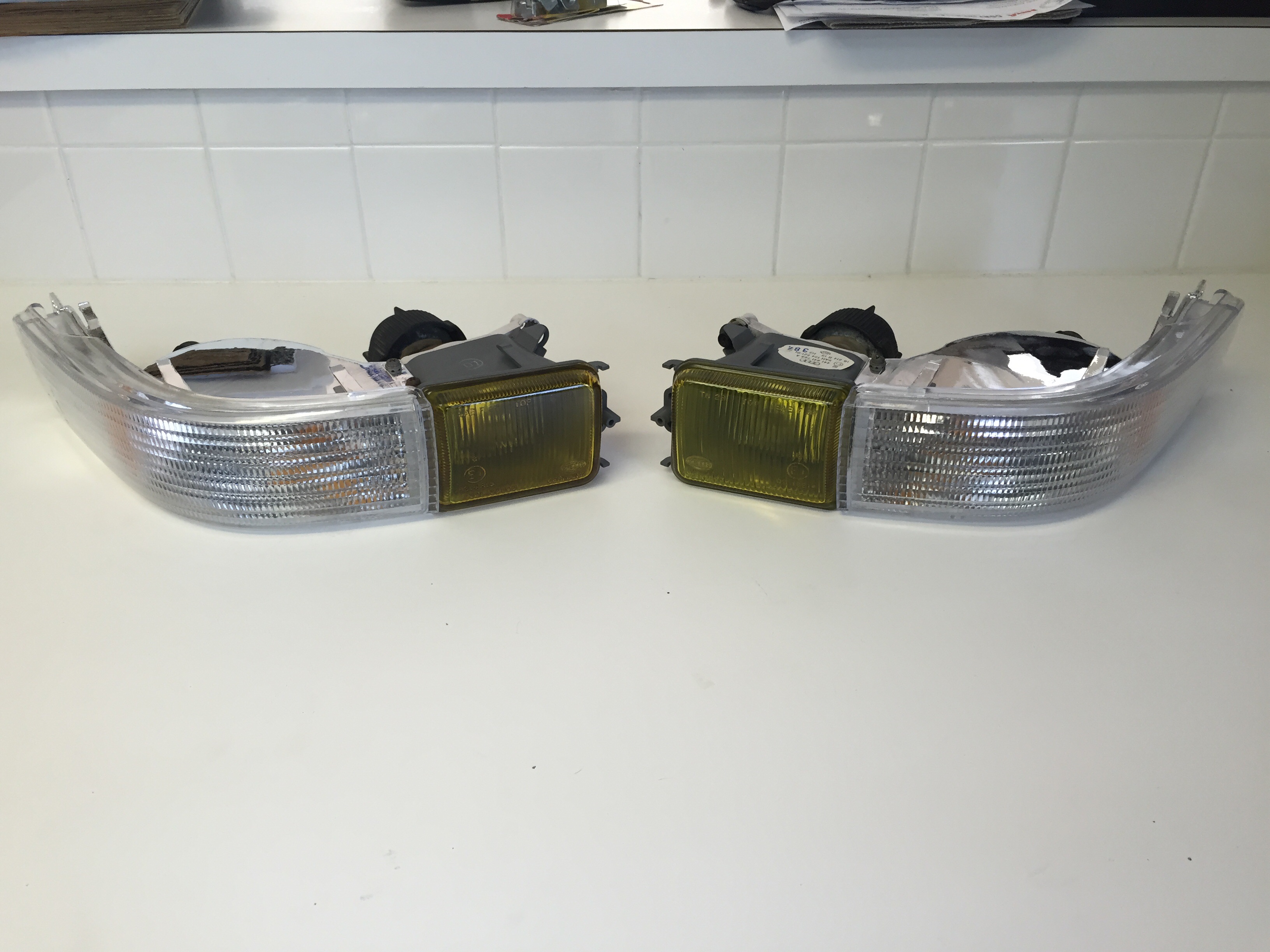

French V8 fogs and CAC clears...

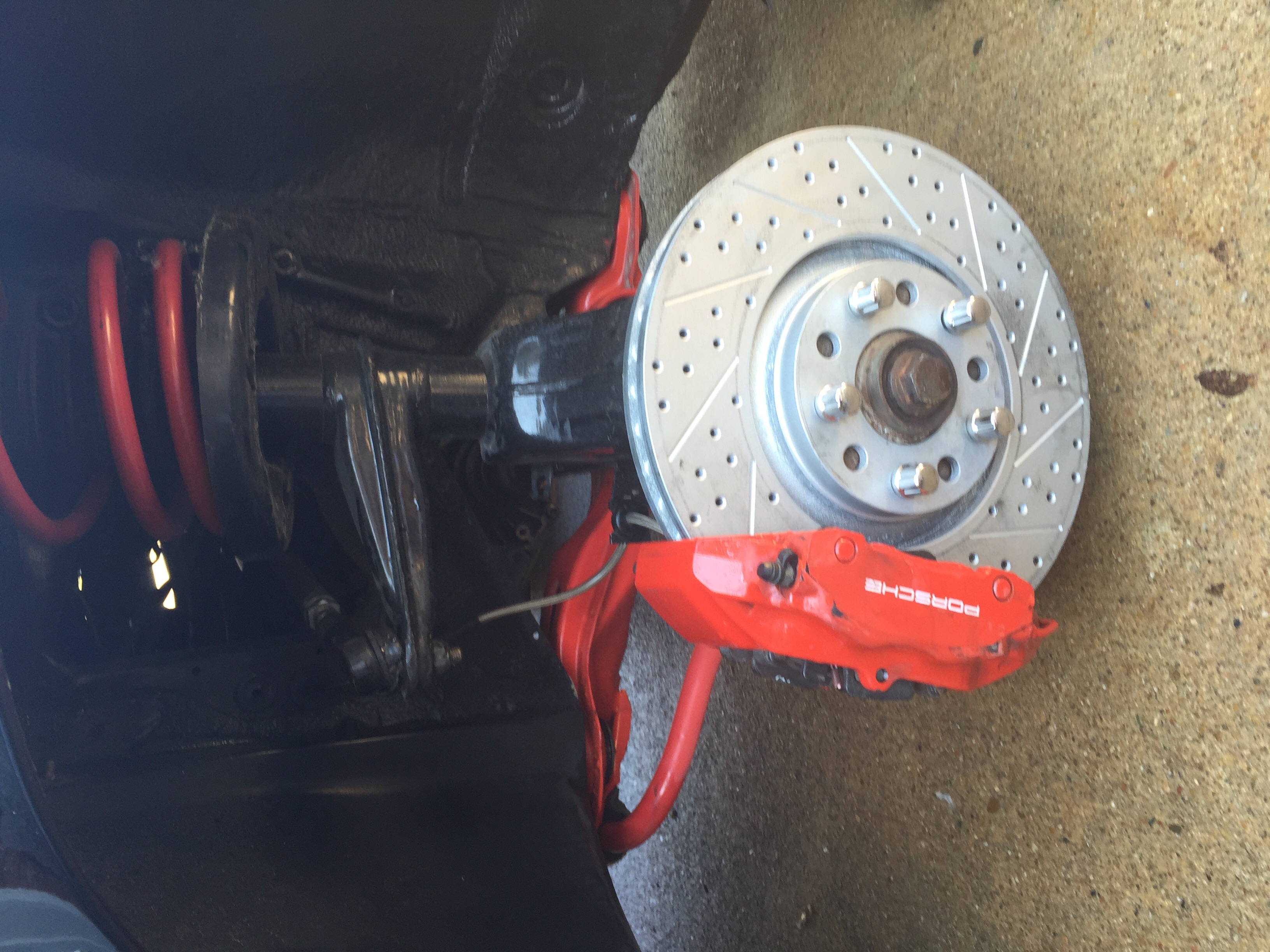

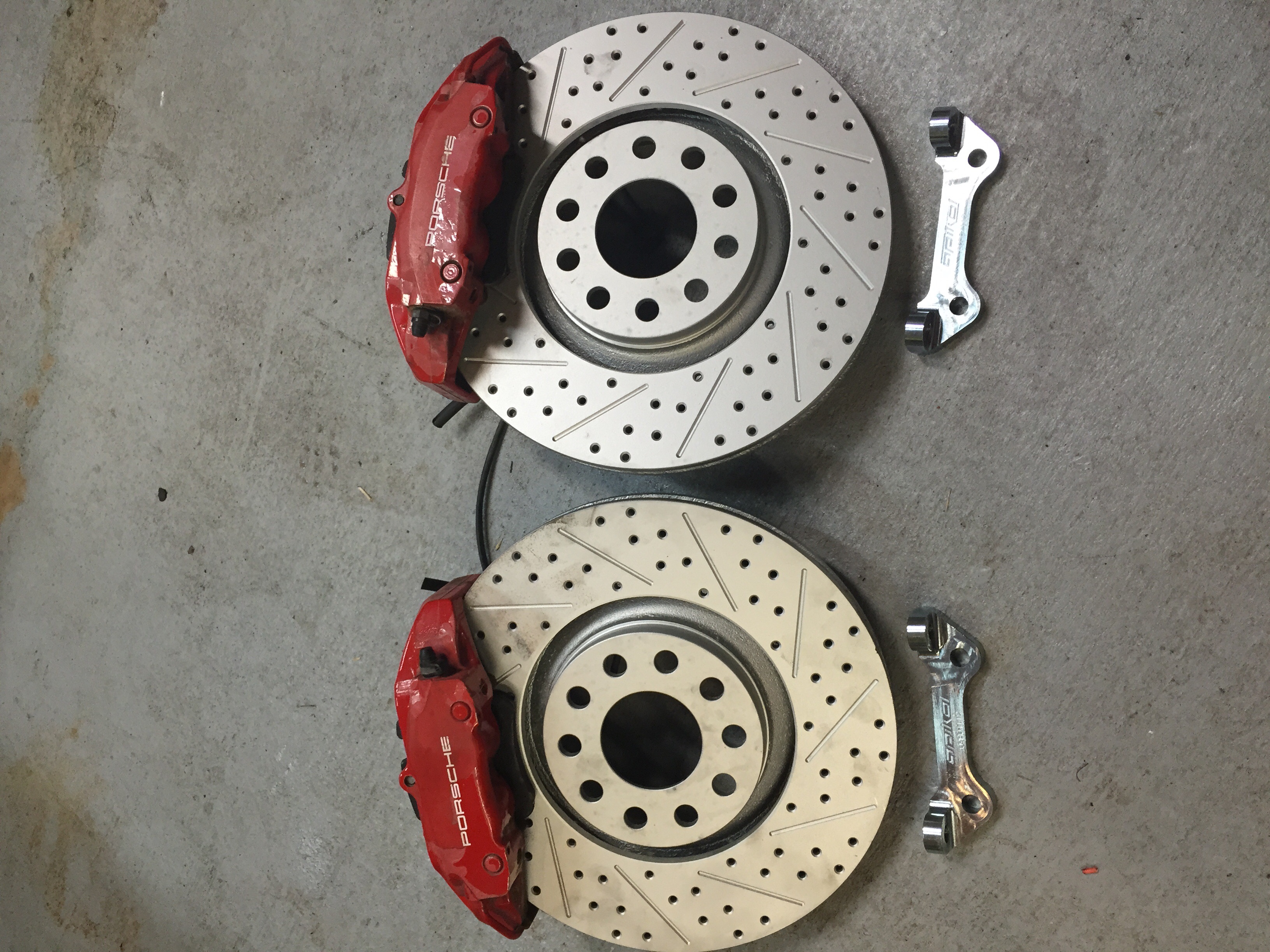

I have a couple days of delay. I'm waiting on longer wheel bolts. I ordered them from ECS Tuning and they should be in on Wednesday. When I put larger brakes, I had to get 8mm spacers from Apikol for the wheels to clear the Porsche 996 calipers. The 8mm spacers make it where I have to find longer bolts and I couldn't find them "on the shelves" at any local stores in Houston. Bigger brakes were mandatory. There were hot molten specs of steel flying off of the rotors and embedded themselves into the aluminum wheels when they hit. Soon though. I also ordered more Wilwood racing brake fluid that has a boiling point of 417 degrees ferenheit. I also put some stainless steel brake lines.
