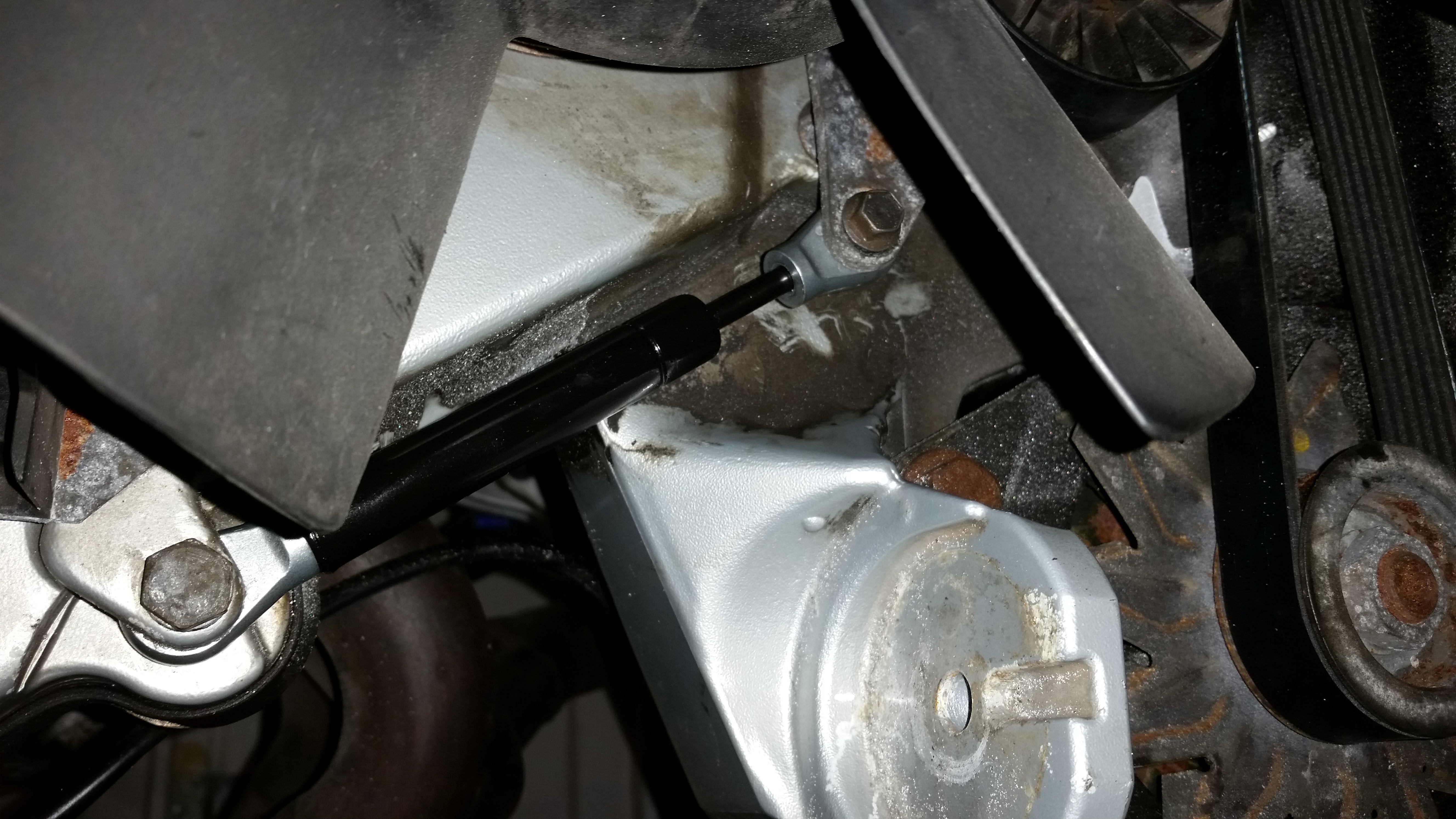

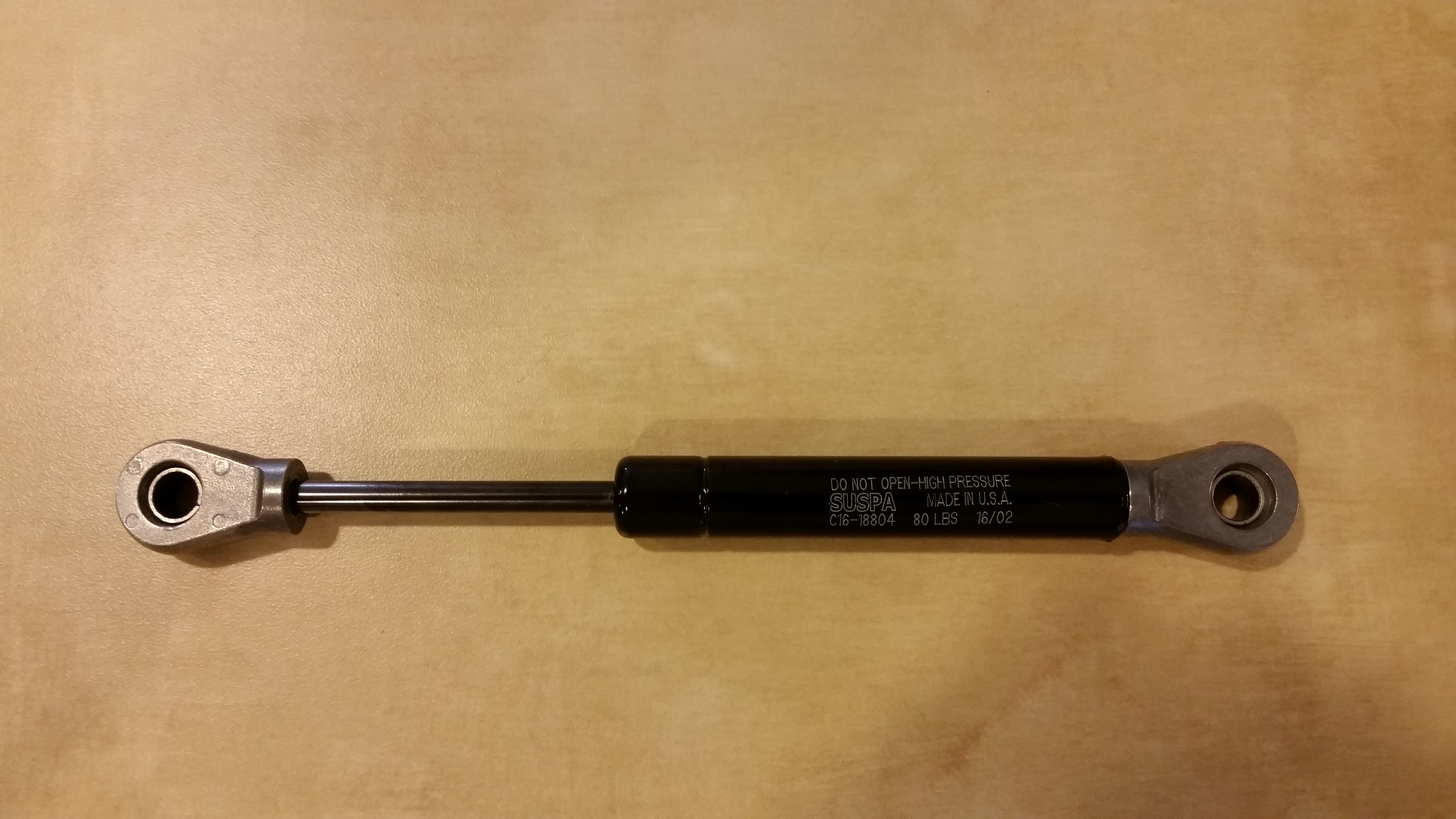

I'm also attempting to make the polyrib-belt tensioning system better. I ordered an 80lbf gas spring yesterday with metric eyelet style ends. I had to order sleeve bushings, as the eyelets are 10.5mm and the bolts are M8. Sleeve bushings are 10mm OD by 8mm ID, so while not perfect they should work out okay. Center to center length of this is 7.56" extended, which I know is quite close. I can make it slightly longer by fitting thin M6 jam nuts if I have to. Hopefully I don't, but we'll see. I had to hazard a guess based on the PT engine sitting on the stand that still has the factory belt and tensioner on it.
NOTE: 7.56" was NOT close at all. I cut a good chunk off, see below...

gas spring arrived today...Ends are separate, the gas spring is threaded on the body and rod end in M6x1.0. The ends have a 10.5mm hole, but the bolts for the tensioner are M8. I could not find any 10.5mm bushings or sleeves, so a 10mm x 8mm bushing will work out okay. Hopefully will have time this weekend to try it out.
I got the fuel tank parts painted that had the exterior coated lifted by the (evidently ethanol blended) gasoline. Unfortunately the fuel tank cover's insulation still stinks like fuel. I may have to strip a large portion of it and use something different so I can reinstall it.
- gas spring
- 20161011_180317.jpg (1.96 MiB) Viewed 72627 times

Just a note...80lbf may be too much, I had to guess. 40lbf may be plenty. I'll know more when I get the belt on. I guess I could use the PT to check since the serp belt on it is old and crusty (factory belt w/100k on it).

That spring is a great solution!

I thought so! I'll check it on the PT, since that is just on the engine stand and therefore about 1 meeelion times easier to work on than the shoehorned ABH, lol!

I think my 80lbf guess was correct. I test-fit the gas spring on the PT engine. I had to cut off about 1.125-1.25" from the rod end and re-thread it M6-1.0. I also tapped out the eyelet fully to make sure I had full range of adjustment in case I didn't get the length quite right. Compressed length with the belt on is right around 6.125". Uncompressed length is just a fuzz over 6.25". Belt feels properly tensioned. It is supposed to rain tomorrow, so depending on what we have going on I may swap the CQ into the garage and the 4.2-Q7 out, and pull the nose off the CQ so I can get this tensioner setup on it. Best part is, it looks a WHOLE lot more factory than the turn buckle (which had come loose on me and shredded a belt).
- gas spring
- 20161029_194819.jpg (2.46 MiB) Viewed 72410 times

I got the gas spring installed tonight, i was only able to take it up to 4k out of respect of my neighbors, so I'll have to road test it this week. But, the initial results are very promising.

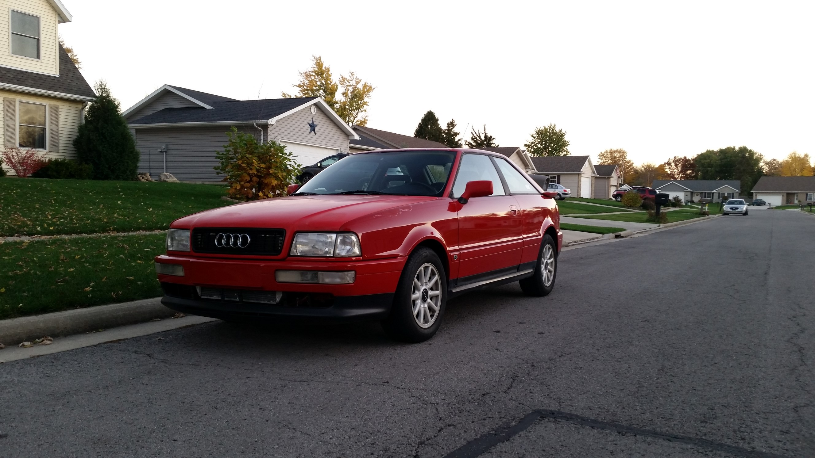

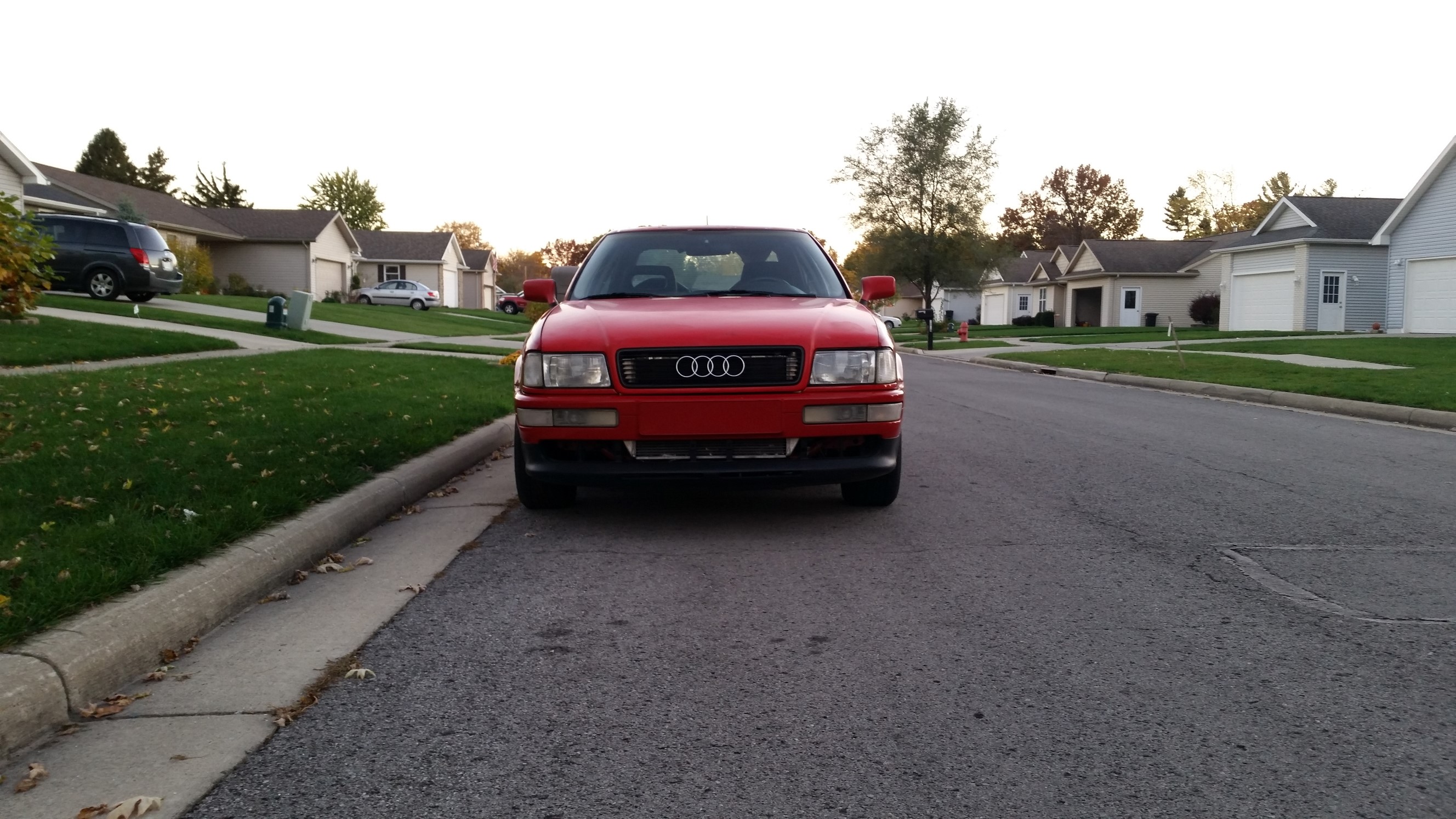

I am also going to get the S2 bumper on, and I may end up swiss-cheesing the license plate area for more air flow to the radiator. It also seems that the fan mounting is blocking a large area. Not that the car runs hot, but I plan on autocrossing this thing next year, so more airflow across the radiator the better. Also thinking about venting the hood, but I don't want it to look all ricey.

Got the S2 bumper on...Also got to test out the gas spring officially. Made several pulls to 7k, no issues other than alternator whine through the speakers, so far I'm calling the 80lbf spring a success. I'd REALLY like to get the H1/H1 headlamps installed, but the width of the radiator would force me to cut them, which I'm not very excited to do. I'll have to work a solution.
The S2 bumper went on with no cutting of the bumper, unlike the DOT setup that Ben had to clearance in several places. It even covers up the oil coolers, which is great. I also managed to sneak another 1/8" or so of clearance between the radiator and engine, but I've noticed a coolant leak at one of the hose connections on the passenger side, even before moving the radiator.
Driving this thing reminds me how under-braked it is, and that the body motion is more than in the 4.2-Q7 suspension set to comfort, lol! That will be addressed, I've got the new rotors test fit on 000292 right now, and my new adapters are waiting for me at the machine shop, I'll grab them on Monday.
- nose job 2

Looks Great!
I had considered relocating the fans into pushers rather than pullers and scooting the radiator back a bit. That would let you not cut headlights.
I'm glad you found a good solution for the turnbuckle!

Bumper looks great! Some RS2 lights and black paint on the rad would really tie everything together nicely.

The H1/H1 are RS2, late S2 and late Cabrio headlamps. I have a set I bought 15+ years ago...
