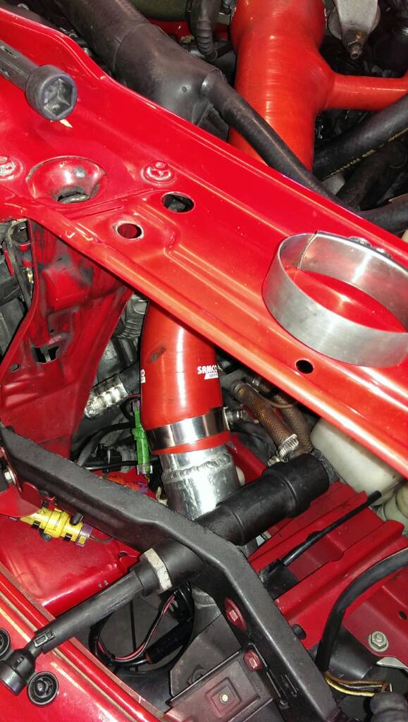

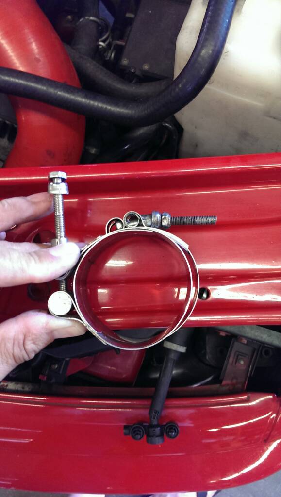

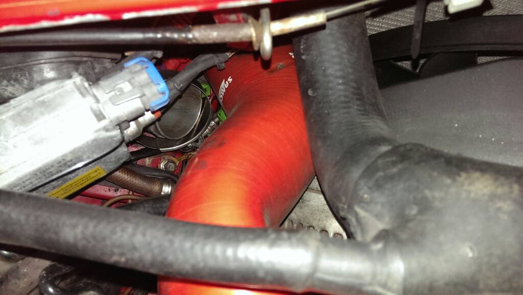

Oh, hi there slipped off silicone hose! Are you experiencing increased levels of pressure?
It's hedged up...
Maxed out clamp...
Slightly smaller one found...
Done

loxxrider wrote:I vote for Vanjens!
If I blow a Samco, I would... Till then tho....
Re: A tale of Rubí... Oil Residue and Meth Pump w/PICs
Posted: Thu Aug 01, 2013 5:34 pm
by Marc
I'm going to start stocking the vanjens. they are indeed badass.
Or, use a constant torque clamp of correct size. better than t-bolts.
Posted: Thu Aug 01, 2013 6:38 pm
by mushasho
Marc wrote:I'm going to start stocking the vanjens. they are indeed badass.
Of course you would... You're enabler #1...

Vanjen ftw. Quality was better than I expected, they're pretty slick. Now I just need 3 more for my boost piping...

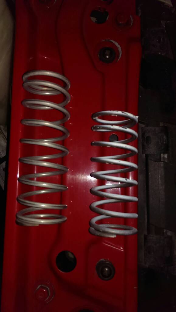

10psi BOV spring vs 8psi BOV Spring
