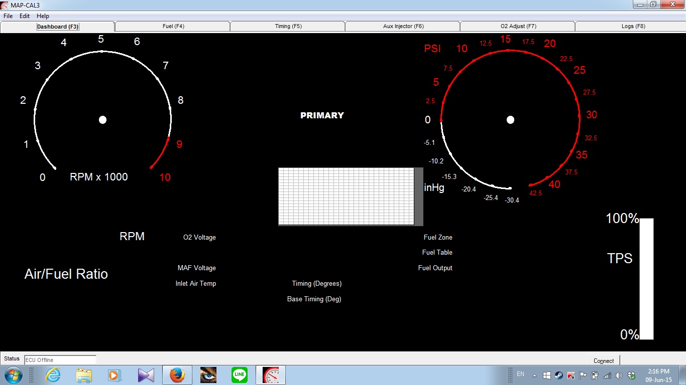

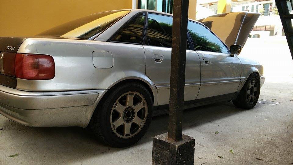

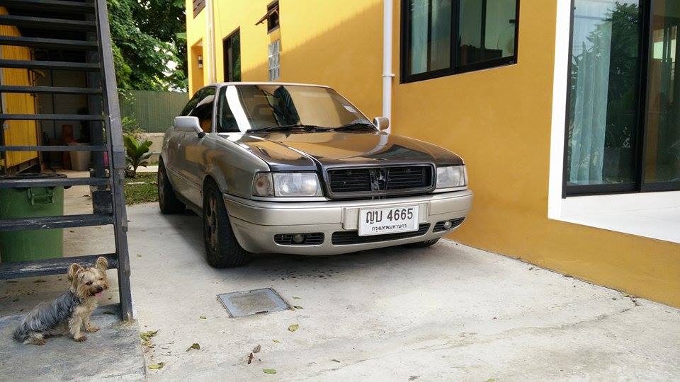

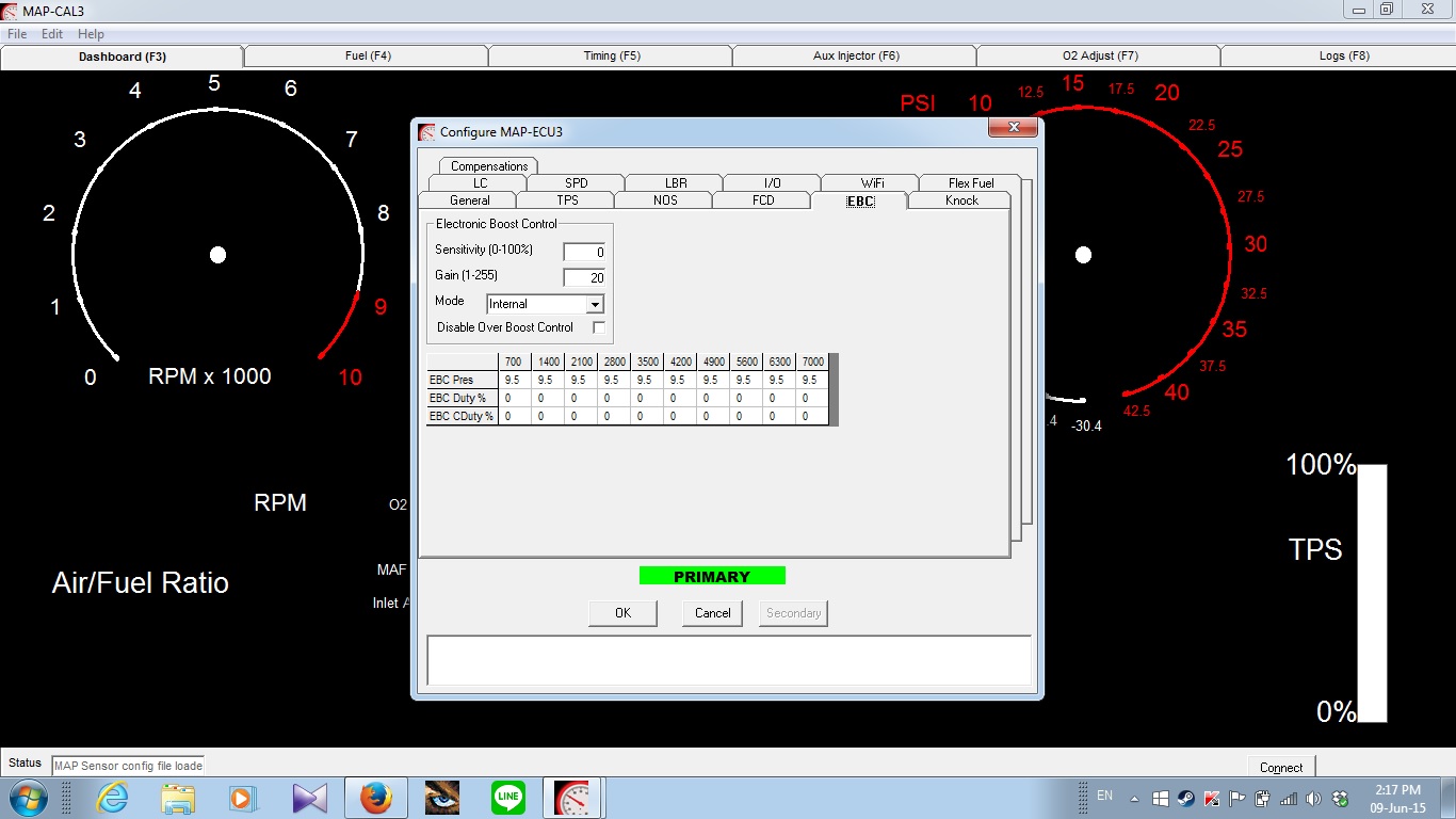

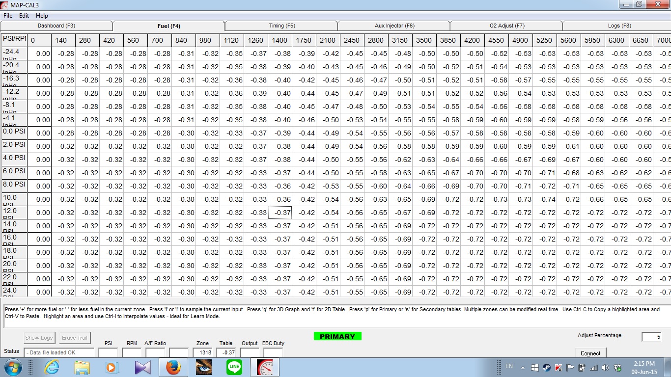

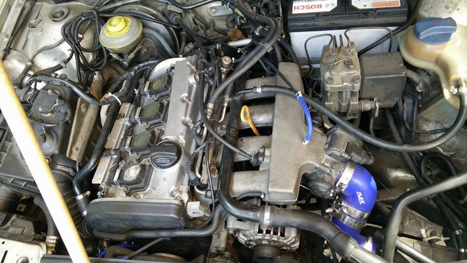

I have attached a few pictures of how she sits now and some screenshots of the MAP ECU3 application. I have one of my spare slightly damaged CF hoods on there now. My own prototype hood is borked.

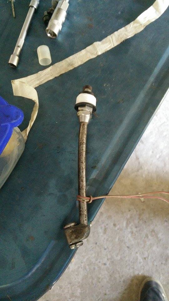

Included a pic of a neat tool for removing the injector cups safely without cracking. They seeped a bit so my buddy sealed them up with white plumber tape. Worked great.
- Front with gratuitous Yorkshire Terrier called Candy
- 11419716_851089014938327_425126450_n.jpg (79.42 KiB) Viewed 58542 times
- ghetto engine bay
- 11428965_851089034938325_586460460_n.jpg (105.97 KiB) Viewed 58542 times
- These values are voltage adjustments of the MAF signal
- Fuel table.jpg (531.33 KiB) Viewed 58542 times
- The MAP ECU boost controller
- EBC.jpg (166.66 KiB) Viewed 58542 times
- Dash of MAP CAL
- Dashboard.jpg (143.54 KiB) Viewed 58542 times

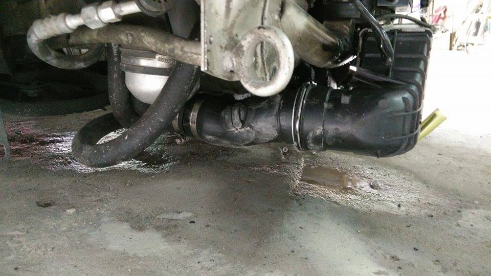

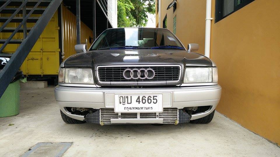

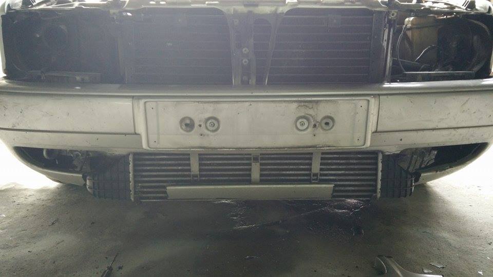

Re: B4Q 80-AEB; Finally FMIC!!
After running the 440s for a while it is clear that they work better going into boost. Much more stable boost.

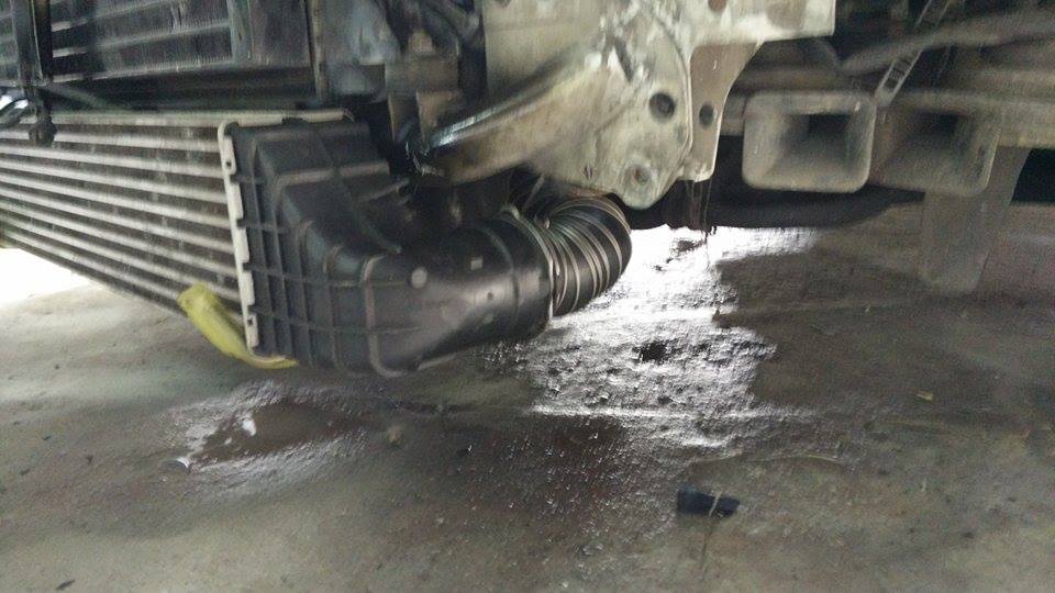

Today I installed a front mount IC with a lot of help from my buddy! The car is getting new paint, recovered back seat and door cards. That should be done in 10 days or so.
Managed to find just the right one at the largest Bangkok second hand car parts market last Friday. Its an IC from a Benz W203 Kompressor. I got the IC and the stock clip-in hoses for about 180 bucks. The core is good quality and about twice the size of the stock AEB SMIC. 25.5"x2.75"x5.4"
It was a piece of piss to mount, really. Some cutting and welding needed to be done, but the hoses were quite easy. Had to find a long 2.5" L hose.
Found a radiator hose from a truck that worked well. 10 bucks for hose and clamps. New.
Pics!
Pics!
- 11846014_874432182604010_1098487464_n.jpg (53.78 KiB) Viewed 58318 times
- 11798417_874432165937345_1734061727_n.jpg (61.7 KiB) Viewed 58318 times
- 11823707_874432162604012_1264244157_n.jpg (72.91 KiB) Viewed 58318 times
- 11816000_874432149270680_1876545126_n.jpg (79.82 KiB) Viewed 58318 times

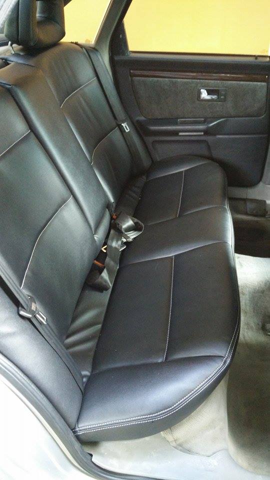

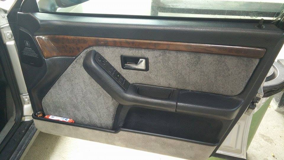

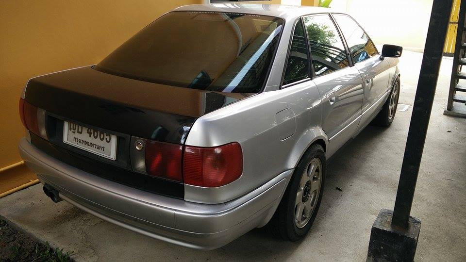

Re: B4Q 80-AEB; FMIC, New Paint and interior DONE!
Here are the pictures
- shiny ass shot.jpg (71.09 KiB) Viewed 58221 times
- new door card cover.jpg (70.33 KiB) Viewed 58221 times
- new back seat.jpg (62.82 KiB) Viewed 58221 times
- FMIC with hacked up bumper.jpg (76.97 KiB) Viewed 58221 times
I like it... did you do the paint your self?
- Posts: 875
- Location: Bangkok, Thailand
Draky wrote:I like it... did you do the paint your self?
No, does it look that bad?
It was done cheaply, though. About 600 bucks.
The paint are Toyota colors and labor is quite cheap here.

Finally got the EBC function of the MAP ECU hooked up correctly and the firmware updated.
Its now pulling nice and hard. Hilarious! What a difference
Target boost at 4200rpm is 16psi. Is an AFR of 13.0-13.3 OK at that pressure?

The car looks great! That afr is fine at that boost, but since it's petty hot where you are it couldn't hurt to make it a little richer.

loxxrider wrote:The car looks great! That afr is fine at that boost, but since it's petty hot where you are it couldn't hurt to make it a little richer.
Thanks. Means a lot coming from you considering your high standards. I am quite happy with how it looks now. And my wife likes it, which is important.
Right now I am playing with the EBC since it is spooling real hard. A little too hard. Clutch is starting to slip, of course.
Its like: nothing... nothing... DAAAAAAAMN.
Right now, AFR is about 12.0-12.5 under full boost, dipping to 11.3. It sputters and coughs a bit then booom. I think I have to turn down the sensitivity of the EBC. The K03 wastegate is fairly slow to react, right?

PRY4SNO wrote:Check out vortex for a mod by madmax (I think) about using helper springs on the WG. My brother did it and swears by it.
What is happening, I think, is that the WG is not opening quick enough, but that could just be my settings.
Today it was behaving a little better, but I have a over-rich condition when it starts to spool up. It does not like anything under 12.0 anymore. So, have to dial out some fuel in part of the zones. It's happening in the 2-6psi range, I'd say. Need to make some logs.
Today, I ran these settings:
Sensitivity: 20%
Gain: 2
Target boost: 14psi
DC across the range: 50%
