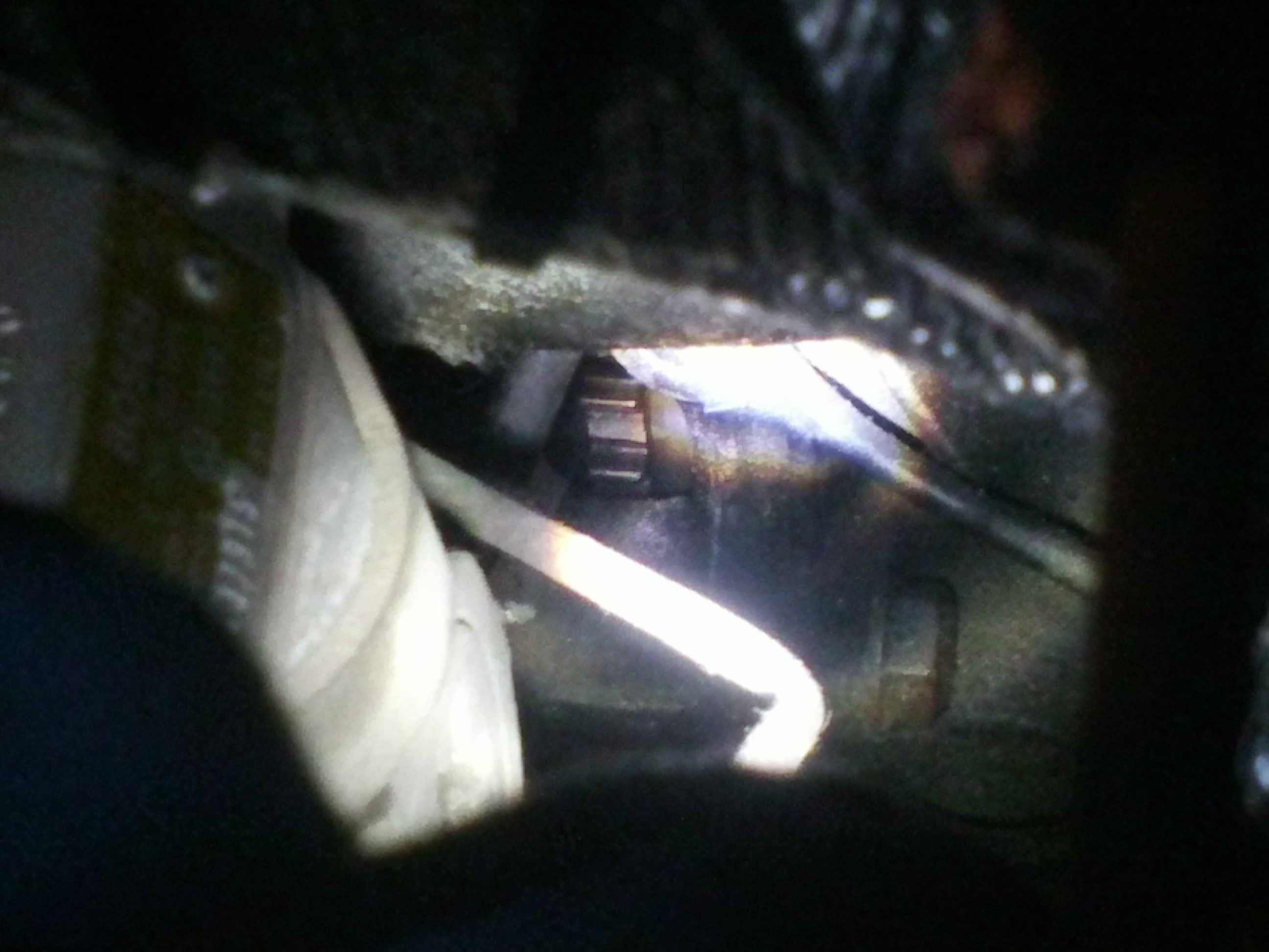

I tried to take a break today from the car after work (yeah right lol) but went to remove the FW sensors bracket and stripped the one damn alan bolt. So a break turned into 40 minutes of dremel work cutting the head off that little turd. I didn't get a look yet at the ring gear but has anyone had luck throwing some welds on chipped teeth through the starter hole and filing them down to the correct profile? Otherwise, im looking at a replacement gear from 034 and the trans being dropped again. Anyway, more tomorrow.

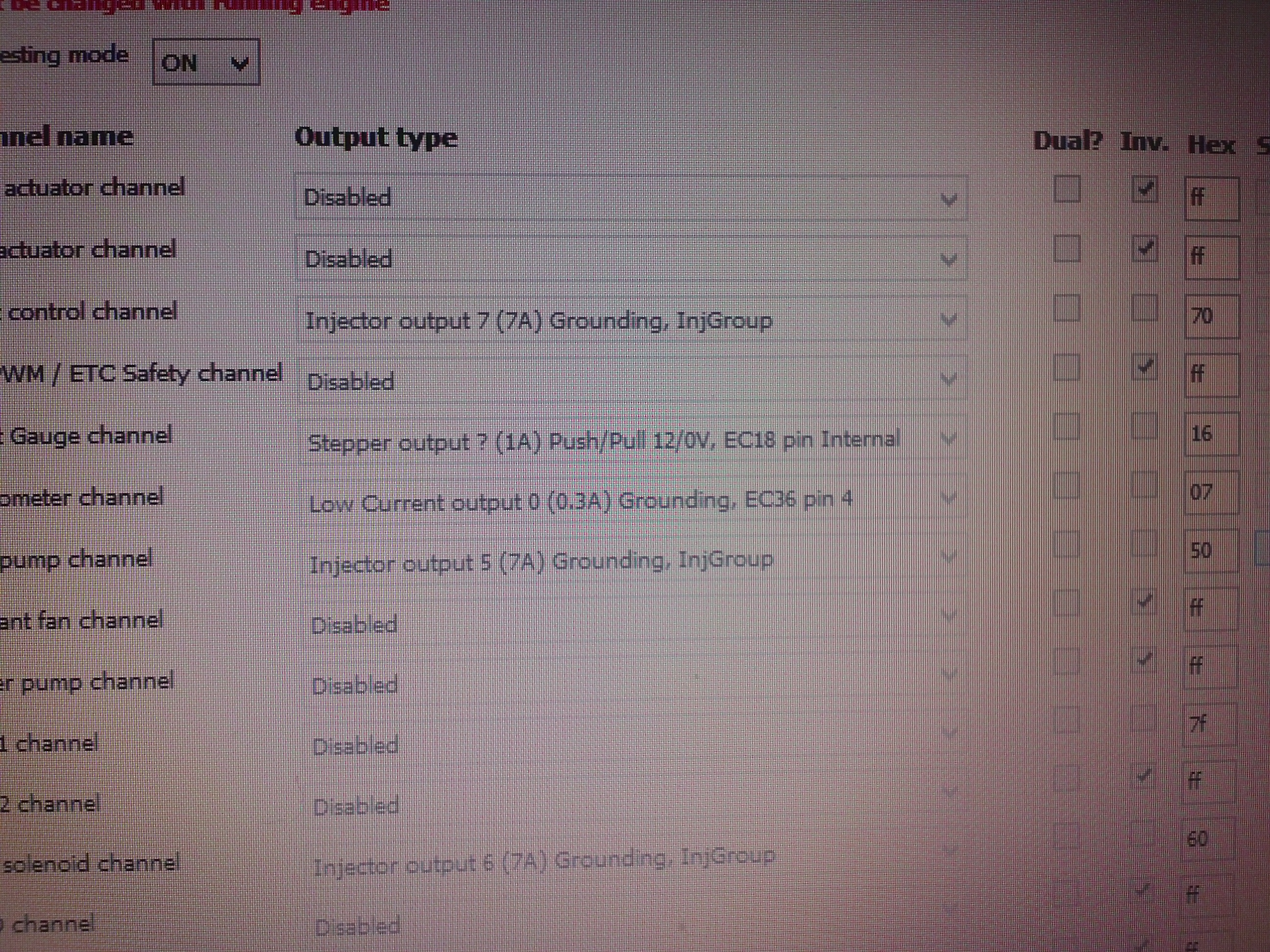

And now for the meat and potatoes of the matter. I decided to check the fueling side of things first. Here is my outputs page with testing mode enabled and the fuel pump checked and turned ON.

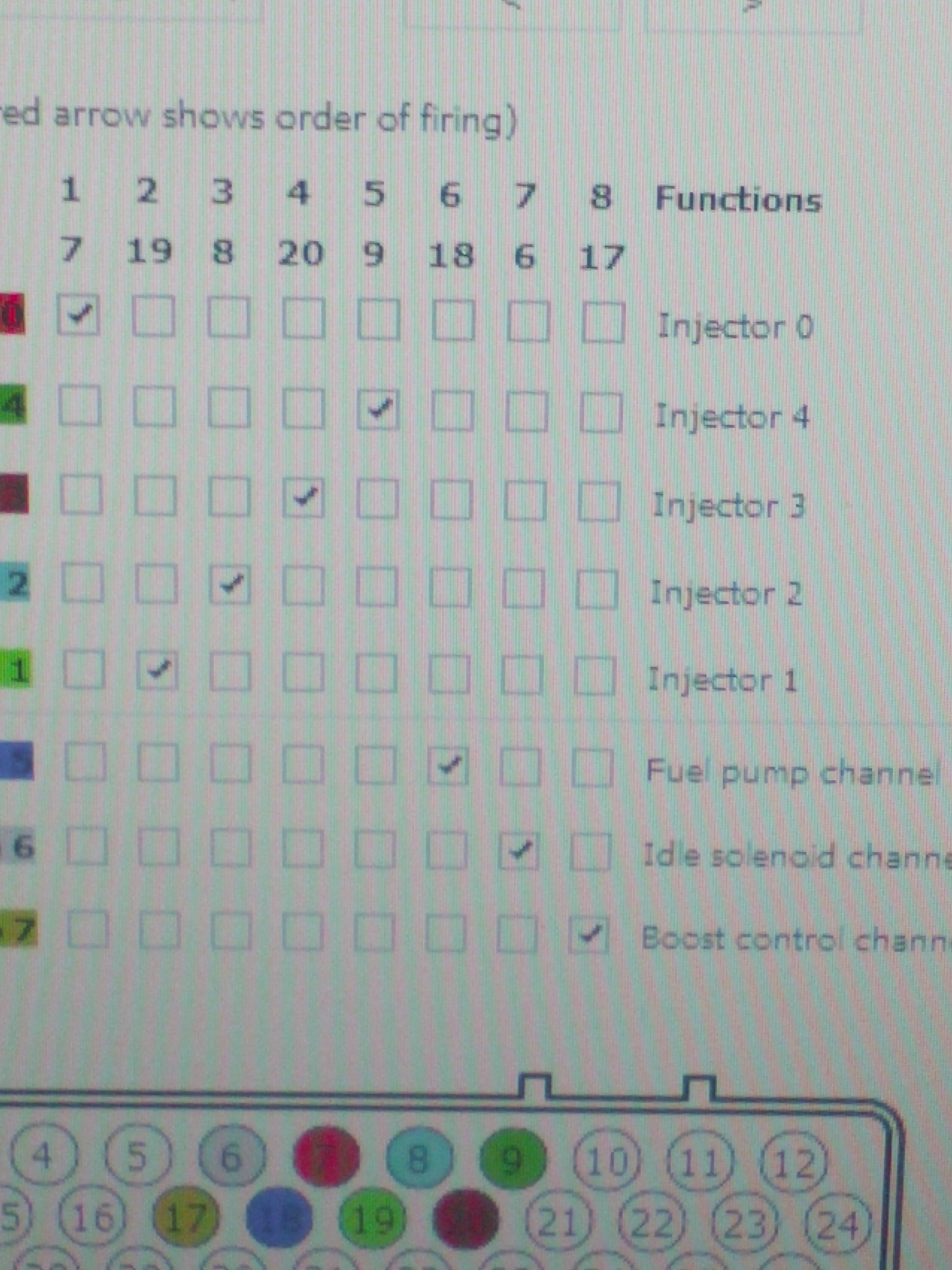

now id like everyone to look at the line to the right of the fuel pump and look at what it says. "ignition output 5 (7A) grounding, injgroup" Does everybody have the same thing in that box? Anyway when I hit ON for the fuel pump output, I noticed that injector 5 was receiving the ON signal before I even step mouse on the injector outputs visual page. I'll repeat that, I don't need to test injector 5 in order for it to stay on... In fact when I click TEST on #5, nothing happens at all. I did notice that when I clicked one injector's test button, another one went off instead. This last one is a shot of my injector output visual page
With nothing turned on or changed and still have injector 5 stick open. Is this normal

First thing first, the channel numbers are zero based. So, the cylinders get channels 0-4, fuel pump is 5. Are you saying you get no pulsing from cylinder 5 at all, it just stays stuck on? Test with a test light with engine running and #5 injector clip unplugged. If it stays lit constant, that sounds like a blown injector driver.

I have a problem and the answer is not more cowbell... My flywheel needs to go to the dentist. That's $700 or more in damage in a split second and I didn't even hit a parked car

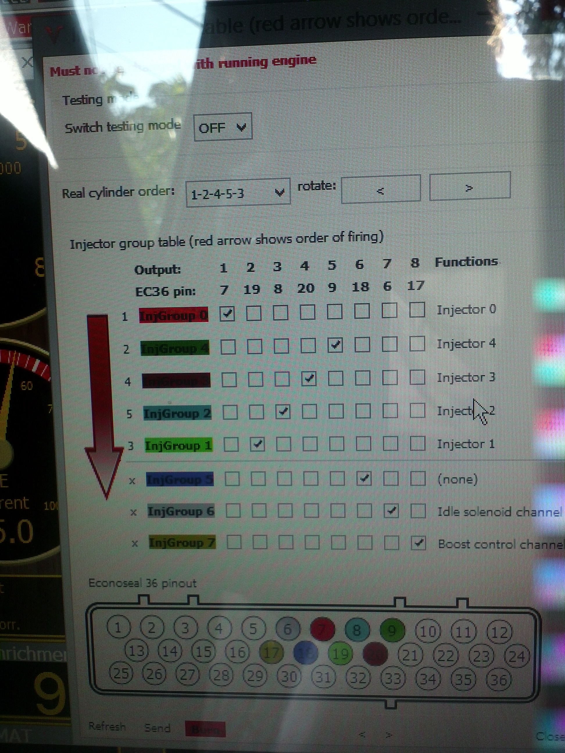

my money is on config corruption. The 3b ecus I cant test before I ship because I dont have any running 200's at my shop so we leave the default .hu firmware loaded on them and just adjust them for things like coil on plug and injector configs. I suspect what has happened here is because its 1.2.27 firmware the latest stable firmware isn't new enough to properly run things like test mode (you can see where his fuel pump channel shows as "none" on the test mode screen).
I've advised him to download the latest nightly vemstune, reset channel 5 as the fuel pump channel and repeat the test mode procedure to make sure #5 doesn't light up when turning on the fuel pump channel only in test mode.

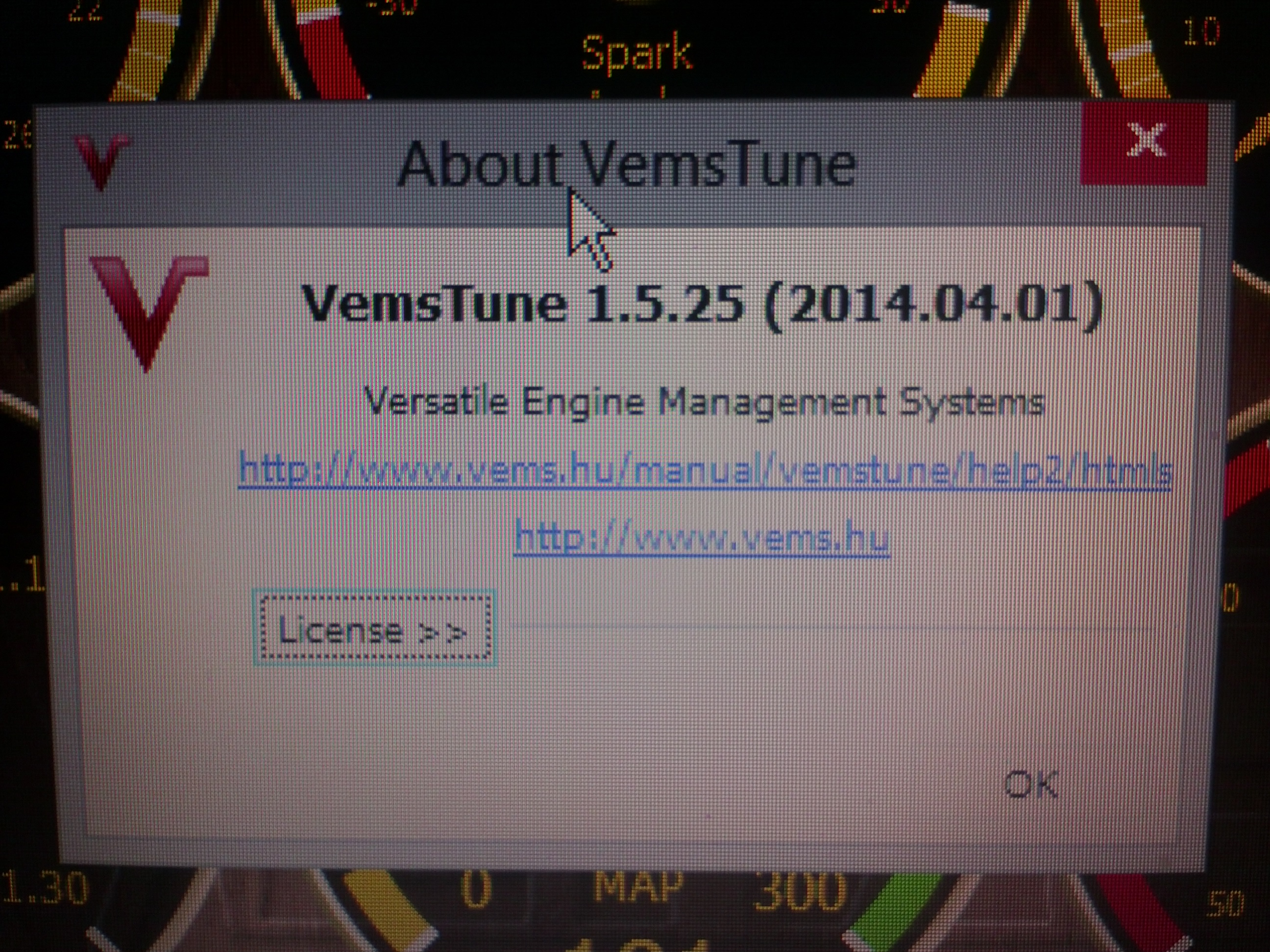

I updated to the one month newer nightly release from this. It fixed the "none" label
but as you can see I didn't need to change those settings but burned them anyway then went to this screen to see "none" was now fuel pump.
Here's the low down:
Ok so I updated to the nightly build. Now it says fuel pump channel for injgroup 5. It doesn't stop there though. When I click ON for injgroup 0, the fuel pump freakin runs like it used to when I tested the fuel pump. I was literally about to start the car again when I found that out. So now the fuel pump channel test just clicks and turns injector #5 on full but only blips the fuel pump for a fraction of a second. both injgroup 0 and 5 turn the 5th injector on still except testing the fuel pump test only blips injector 5. Its all reversed now. I tried my older fuel pump relay again (been using new one for about 3 months) but the results stay the same. Testing the fuel pump from outputs menu still turns both fuel pump and injector 5 full on.

Im curious, but pretty new to it also, is there any way of using the missing tooth to still maintain a correct primary trigger? Saw something called "missing_tooth" but it looks like the missing tooth has to be in a specific spot on the sensor's ring gear so its useless. My only other option would be to get a tone gear on the crank pulley I guess but that may prove just as pricey as fixing the flywheel. New wiring and a new config would be irritating also. Anyone have any suggestions for the p. trigger or basically just fix the FW's ring gear? TIA
Posted: Sat Aug 16, 2014 8:31 pm
by carl
Fixing the wheel is doable, but through the starter hole might be a huge pita, maybe a modified file on a sawzall or jigsaw at slow speed to shape in between. As long as you have a cut piece of cardboard to get the outline and height just right it should work. I've done it on an mc engine setup, wheel was on a table though, mac10/11 ecu was ok with the new welded/grinded teeth.
