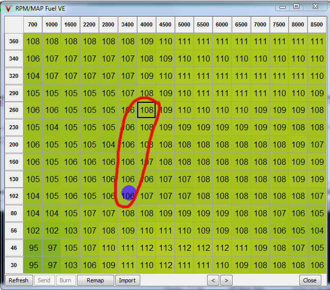

Whelp made the switch to E85 a few weeks back! need a tuning guru or two to look over a log and lemme know how things look (4th gear run).... no hard timing changes at this point will do that on the dyno in a few weeks. I am thinking i need more acceleration enrichment or a longer period?

bet your EGTs will drop by over 150c (and you'll get about +50whp) if you add +8 degrees of timing from the 102kpa row on up. Do it now, thank me later

Meant to look over this last night but I forgot. Will do in a bit! 8 degrees eh Marc? That's a lot. This is from the base map? I took a timing OUT of my tune (but I was on .63)... gonna have to have a look now.

to be clear, this is for E85. and yes, I generally find E85 likes to be around +8 or so vs pump gas.

That's pretty sweet. I have a 3rd gear log here so not apples to apples unfortunately but at peak torque (ish) you're getting an extra 4psi on me. I imagine that in 4th we'd be pretty well dead even as it sits. BUT, that timing increase is going to help A LOT so I would expect your spool to improve.
Fatten up fuelling from 3500-4200. It should help spool a little and give you moar torques. The cells circled in the attachment.
- fuel cells
- justin fatten.jpg (215.78 KiB) Viewed 42294 times

Thanks for the suggestions. any explanation of why i need a fatter tune under vacuum? It was really flat when tuned for 91ron however i did go back to marks suggested injector settings... maybe just getting into partial fuel cut down low? should i even be worried...

Well it should need more fuel everywhere... is it running bad? Misfire or fouling plugs? If not then that's just what it needs i guess.

Hmm guess it just needs a bit more down low
replaced the plugs over the weekend and no signs of rich/lean or detonation. I gaped the replacements too narrow (hard starting) so i will have to address that.. other than that car runs great
