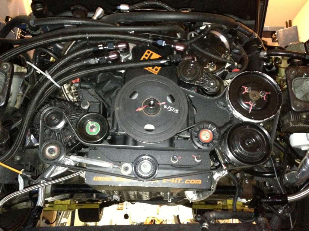

Been over run with billable work, but have been sneaking in a few hours here and there.
Should wrap up the serpentine belt rebuild rev 6+ tomorrow
ImageUploadedByTapatalk 21370914246.752636.jpg (87.11 KiB) Viewed 88024 times
Then install the turbo upgrade/rebuild kits and be ready for Dyno attempt two by the weekend

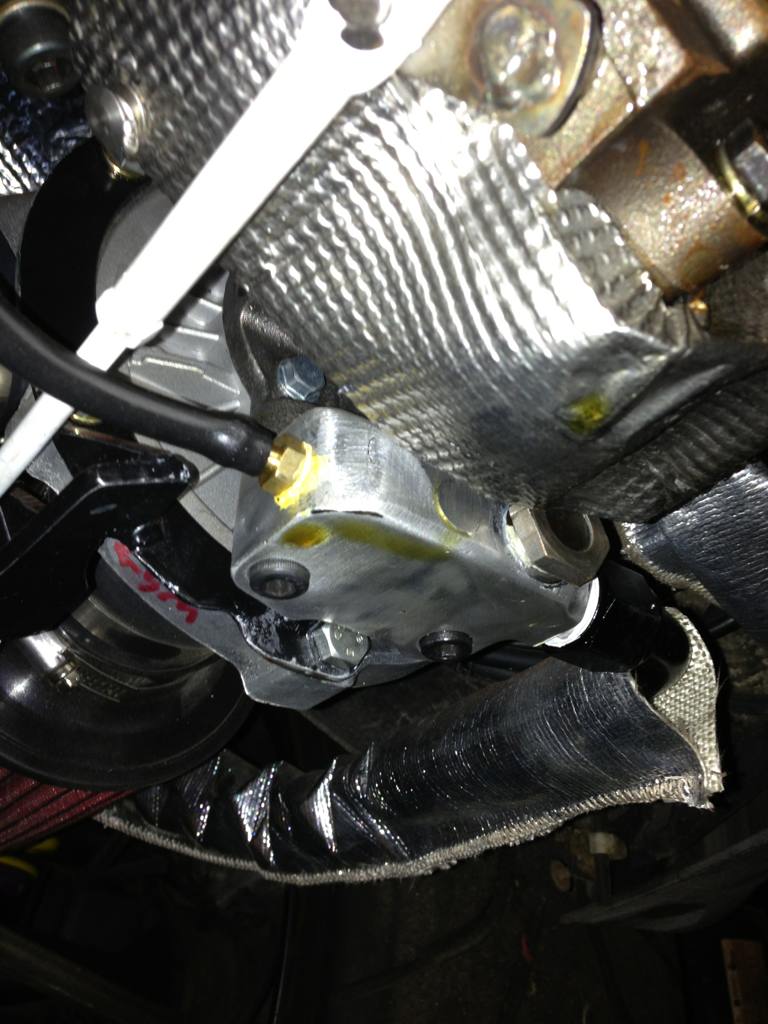

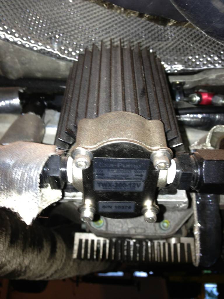

What are you using for a sump pump to get the oil back to the oil pan? It is extremely hard to blow out seals on a turbocharger, and usually if they are leaking, it is because they are not getting proper evacuation of oil or have improper oil restriction.
Re: 'Judas' 2003 Audi RS6 with 383 stroker TT
Posted: Sat Jun 15, 2013 6:41 pm
by HT Motorsport
Remember these are Chinese eBay turbos. Interested to see what they look like inside.
Pump is an all singing and dancing unit by exa
In tests it will pull 30in vac, but this pool of oil on floor after 30 seconds run time today illustrates the leaking seals well

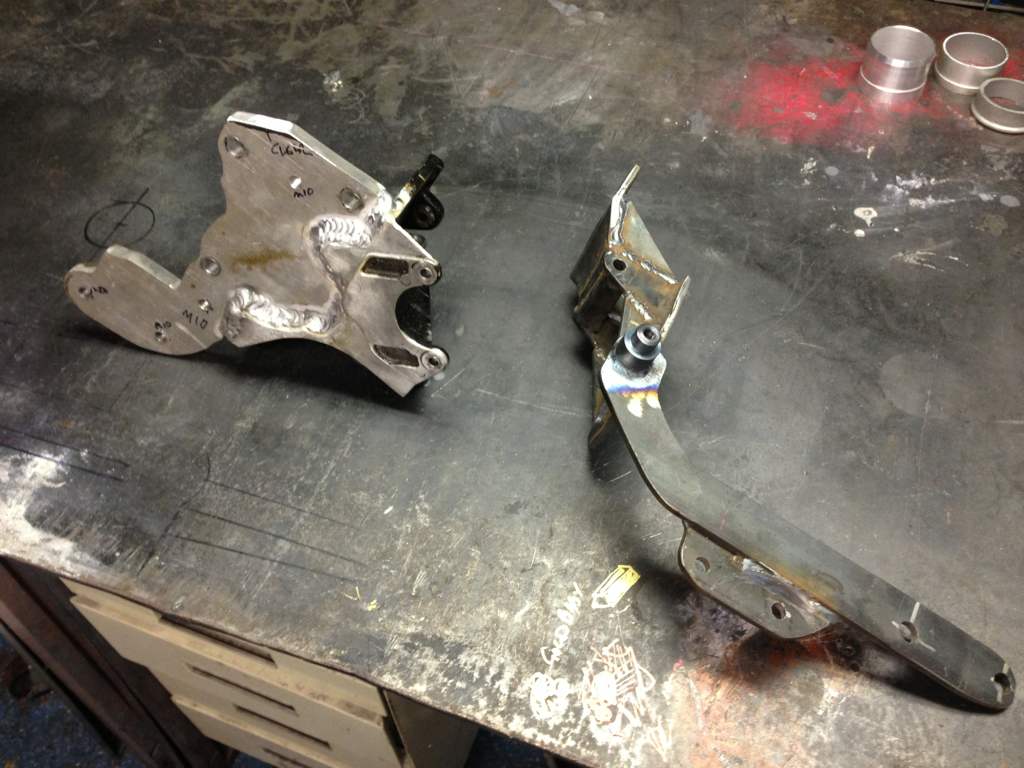

I fired it up today and the new belt setup is perfect so far. Tomorrow I will rebuild turbos and refit the radiator for a test drive
