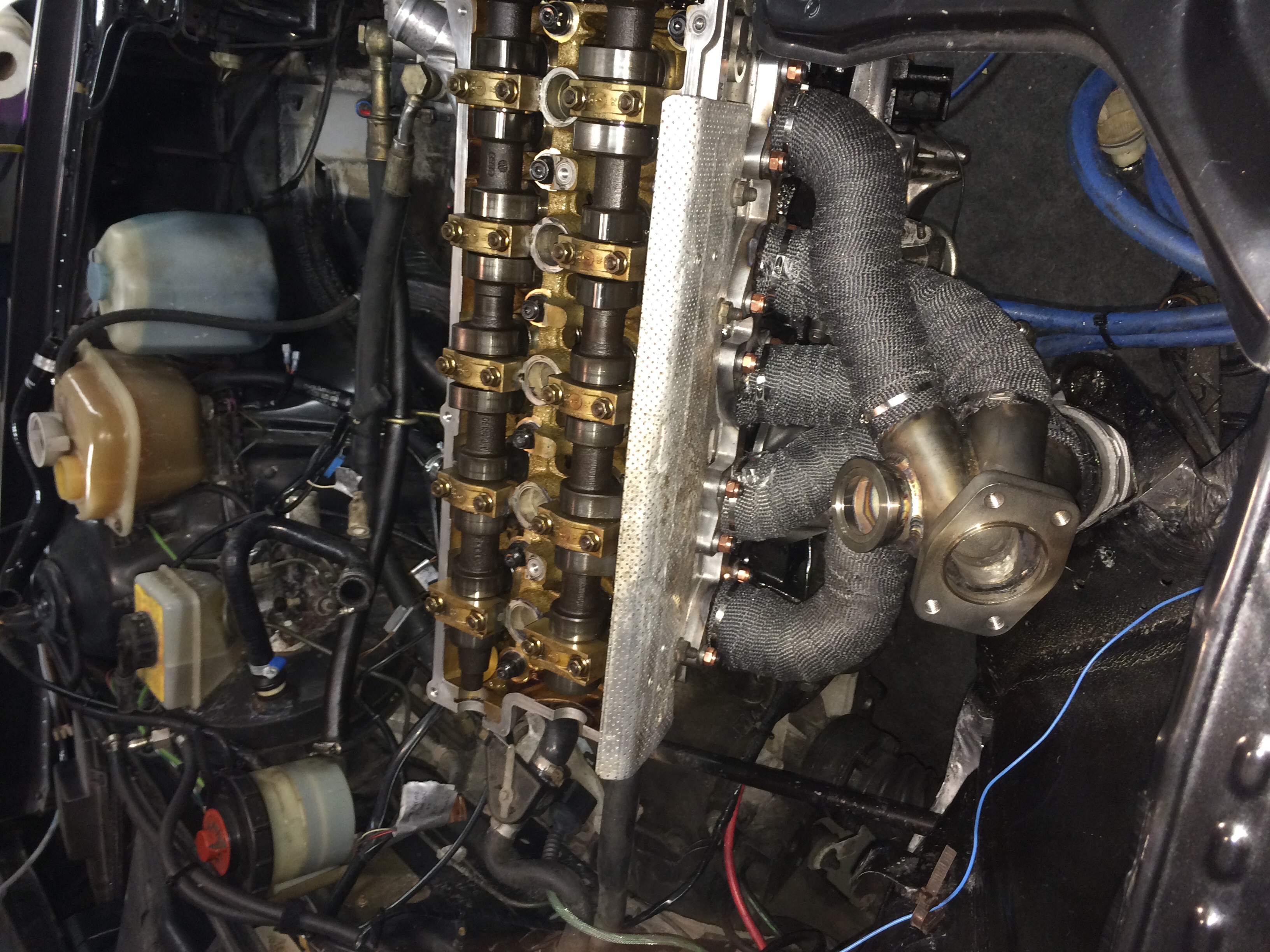

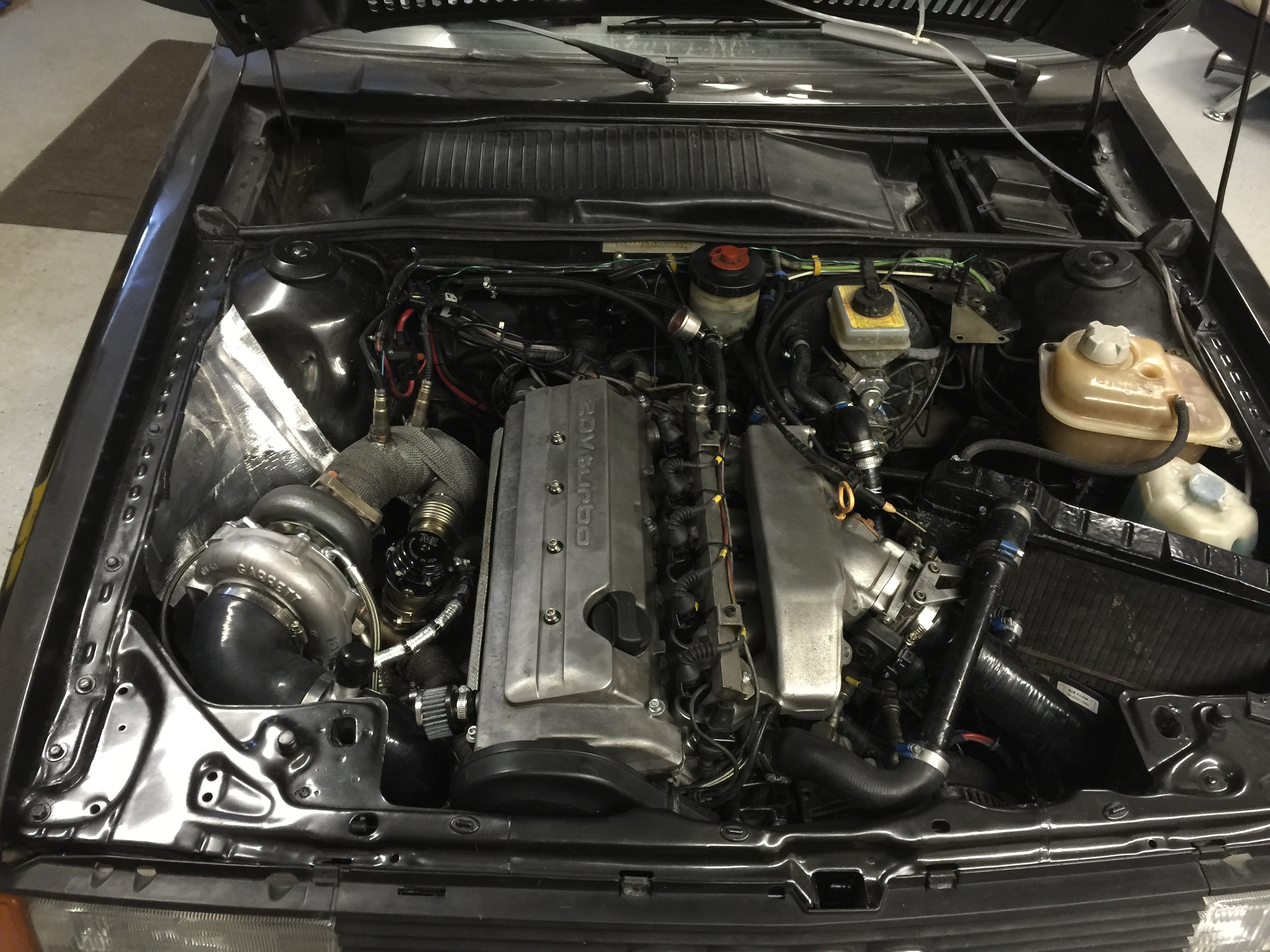

Making "headway"
- image.jpg (2.15 MiB) Viewed 52469 times

Nice! Getting right at it, I like your style. Running by Monday? lol.
You will love that turbo. If you thought it was fast before, you're in for a treat. What fuel pressure regulator are you using, an AAN one? You'll need that slight bump in fuel pressure for all the fuel you can get. I was at 86% DC with a 4bar 7a and the 60lb Siemens. Oh, and are you using a bigger fuel pump? 044?

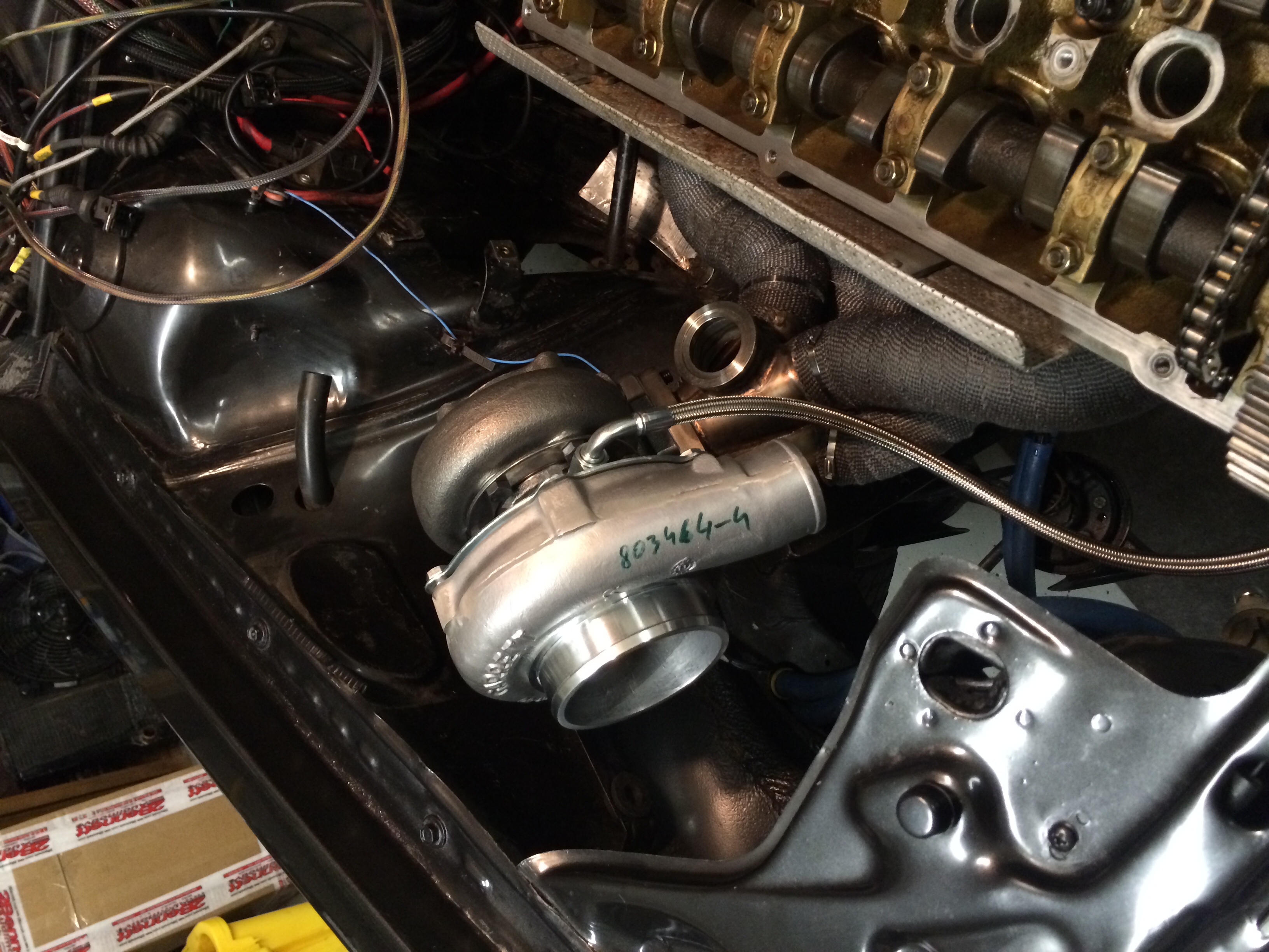

I have a new 4 bar FRP. I also got those 60lb Siemens. From what I have read the stock Bosch fuel pump will work well beyond my needs so I am just putting a new one in as well as a filter.

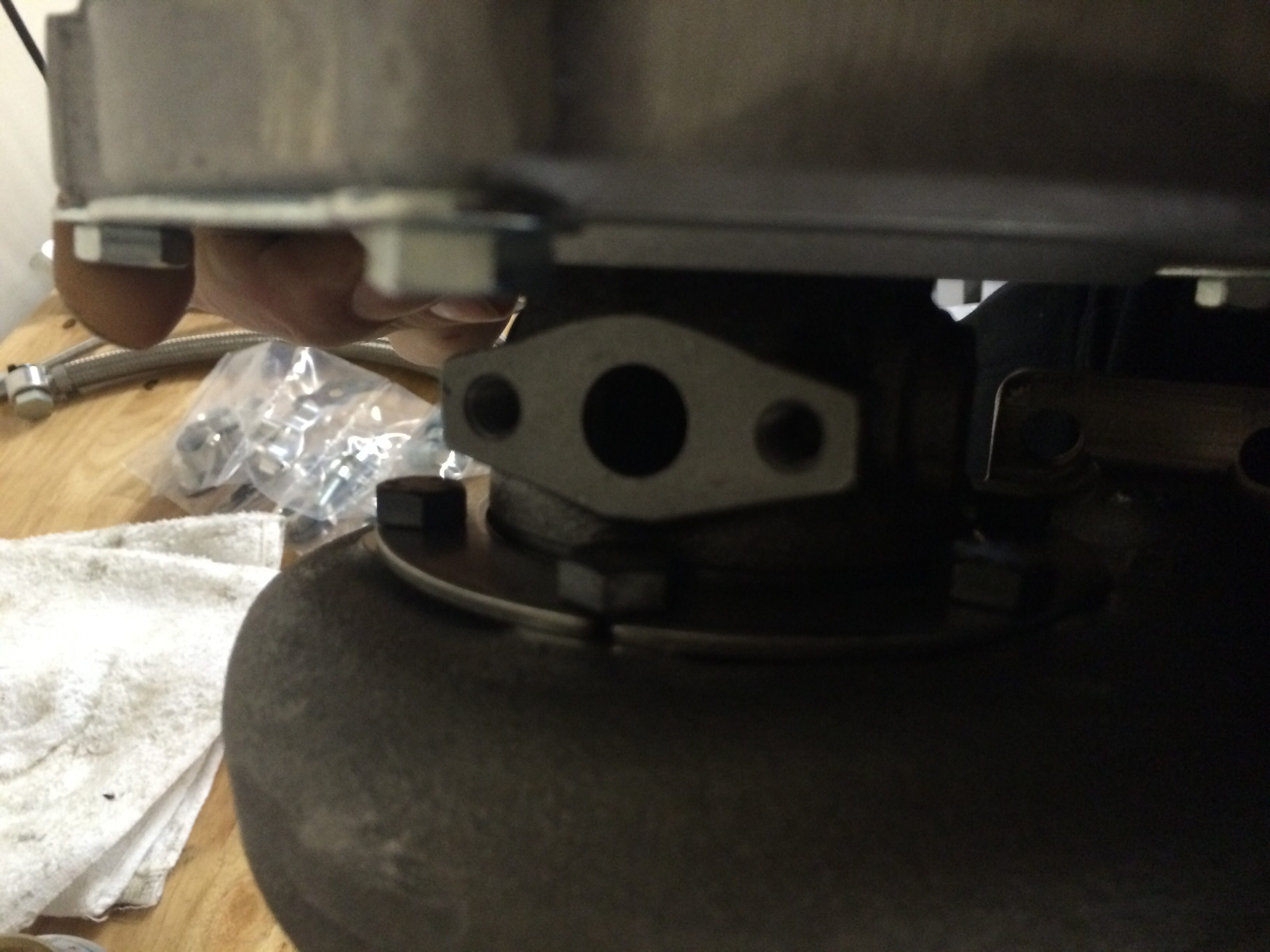

I have a question for you: How do you know which connections on the GTX housing are the oil supply/return and coolant supply/return? I need to get this thing oriented right and can't even figure out what hole in the turbo goes to what.

Oil inlet is the smallest and should have a restrictor fitting, oil drain is largest and needs a flange, use -10 hose at least.

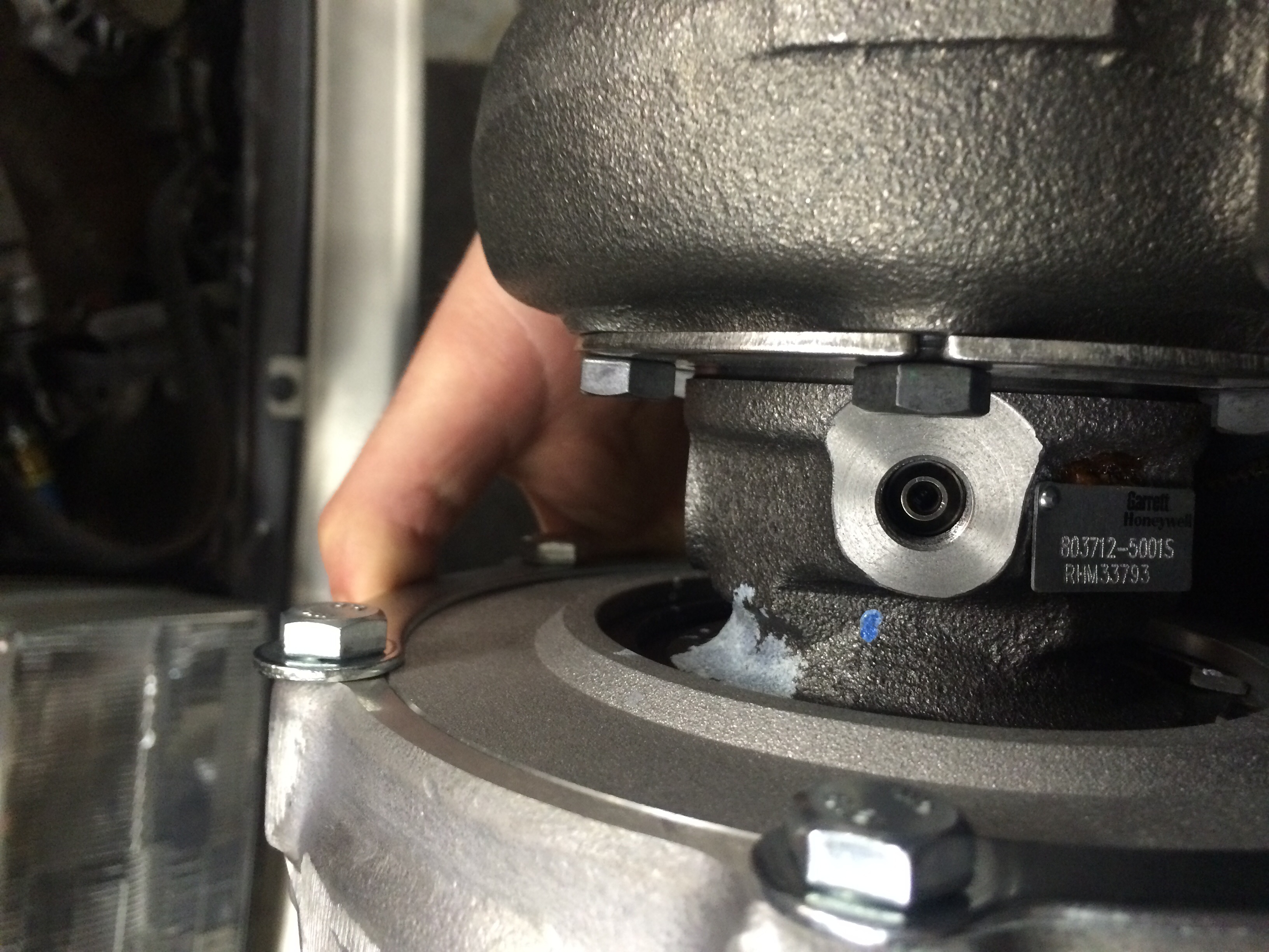

Is this the oil inlet? What is that little piece on the inside? It's not a built in restricted is it?
This is the smallest hole on the turbo
- image.jpg (1.64 MiB) Viewed 52438 times

And then the opposite side would be the drain. It has provisions for a little flange

Re: Audi S4000 - Alaska
Like this
- image.jpg (1.13 MiB) Viewed 52438 times

Yes, that's the inlet and drain. You need fittings like these

Yeah I got the kit for the lines when I got the turbo.

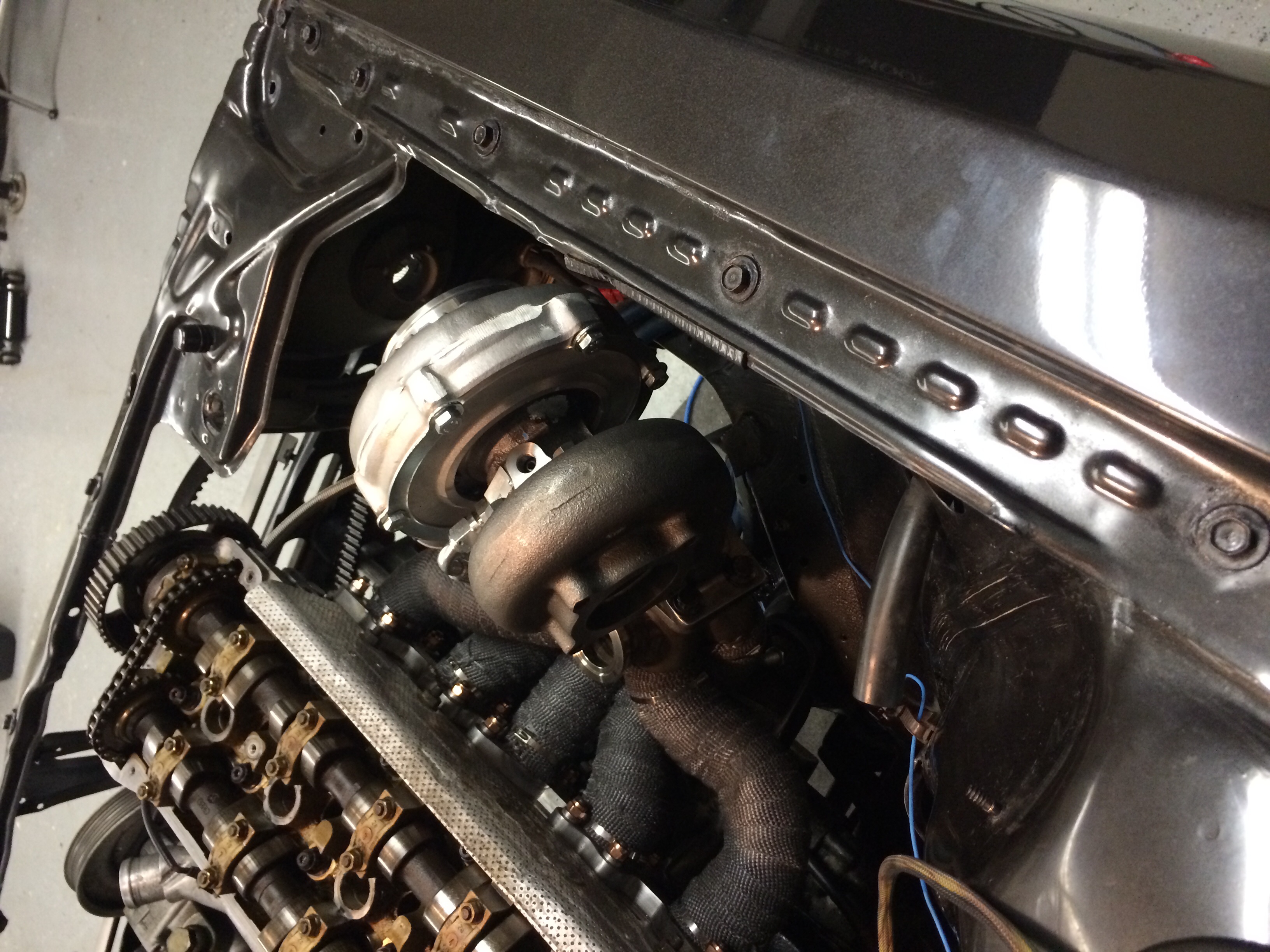

Boom

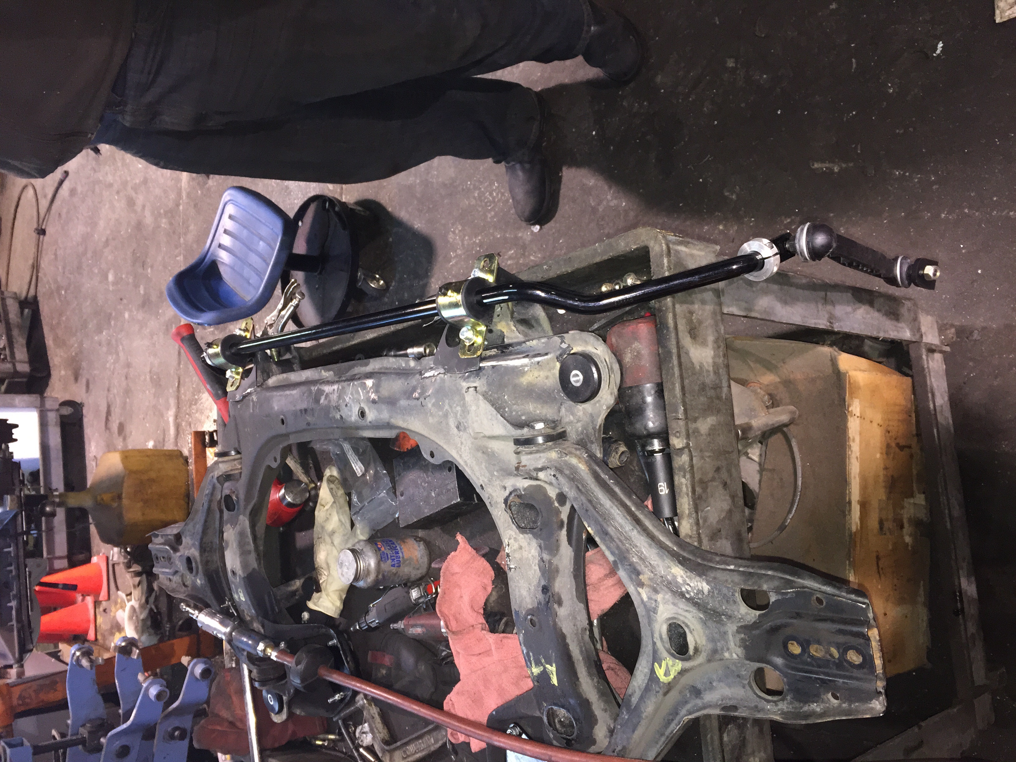

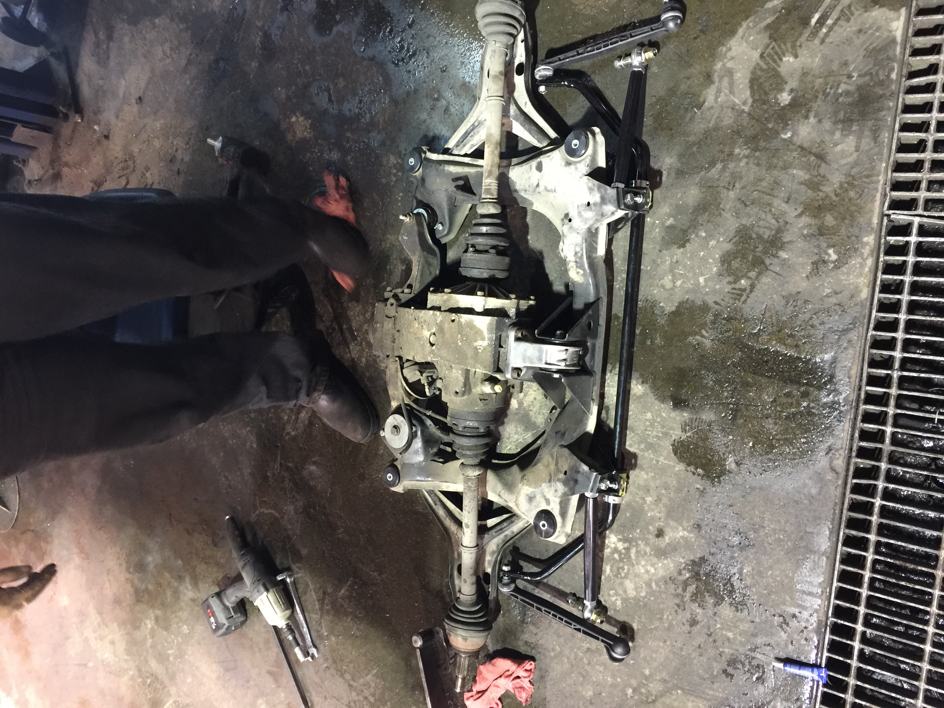

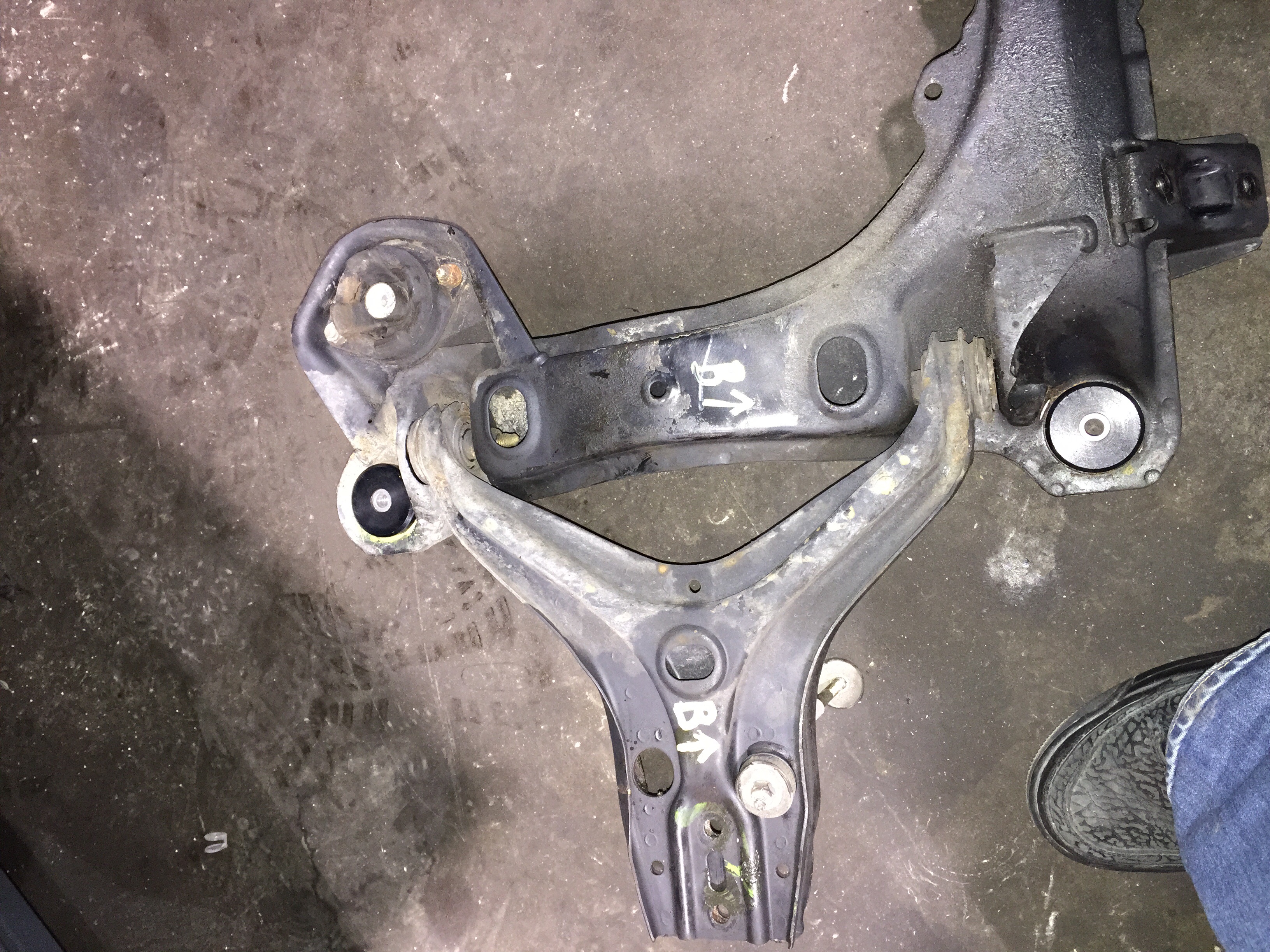

Subframe bushings and tranny/diff mounts ala HERSH performance. Subframe bushing were a dream to install. 2 piece setup, awesome.
Installed a rear sway bar and replaced everything that can be replaced under the car.
Installing my coil overs tomorrow then I'll report how awesome this thing drives.
