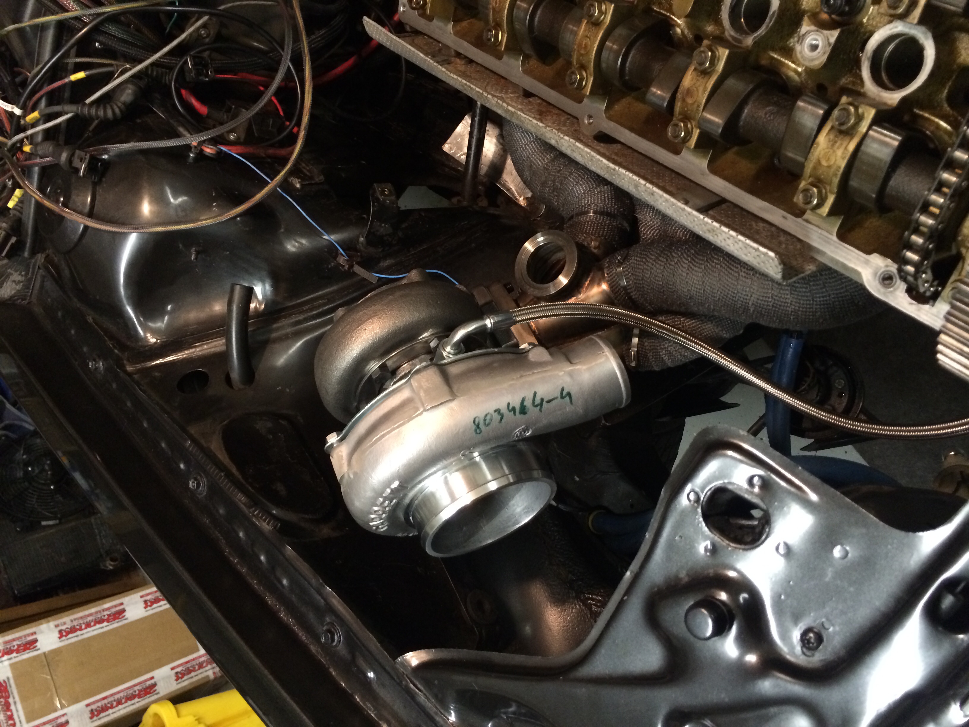

I have a question for you: How do you know which connections on the GTX housing are the oil supply/return and coolant supply/return? I need to get this thing oriented right and can't even figure out what hole in the turbo goes to what.
Re: Audi S4000 - Alaska
Posted: Sun Dec 21, 2014 12:54 pm
Oil inlet is the smallest and should have a restrictor fitting, oil drain is largest and needs a flange, use -10 hose at least.

Is this the oil inlet? What is that little piece on the inside? It's not a built in restricted is it?
This is the smallest hole on the turbo
Posted: Sun Dec 21, 2014 1:19 pm
by Namreg Rac
And then the opposite side would be the drain. It has provisions for a little flange
Posted: Sun Dec 21, 2014 1:27 pm
by Namreg Rac
Like this
