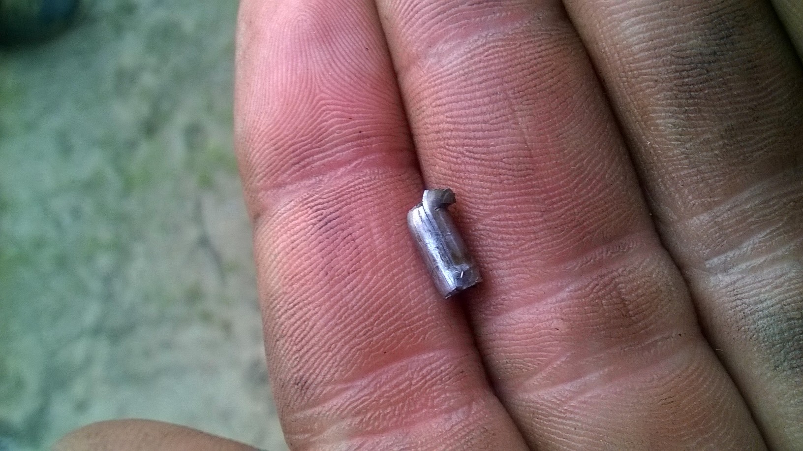

The daily tdi 80 is dead. It would need new diesel pump or major repair to old one, leaking from the main axle at the back. :shame:
The 200 is also at no go. Drove it for maybe 4000 km or more in total and then problems started.
First time it died on supermarket parking lot. Got it home, red the fault codes and tadaa, hall sensor it is. :we:
Next, remove the distributor.

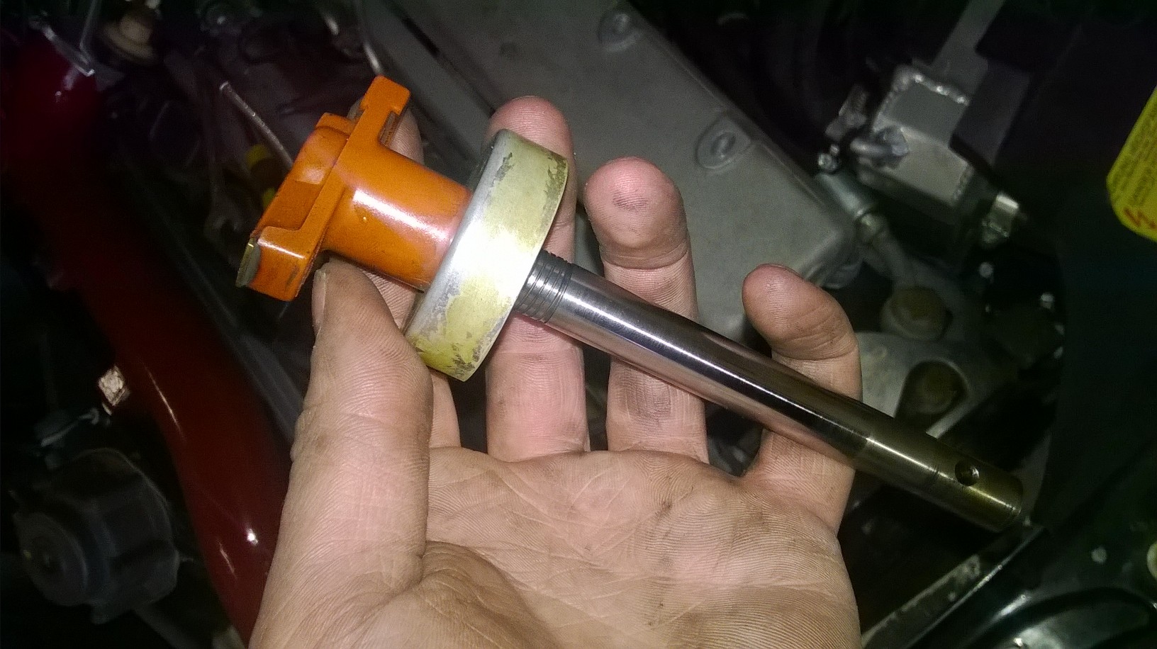

Got scared when the distributor axle ( or what would you call it.. ) came off whitout the distributor gear.
The pin was gone and all I found was this:
Gotta hope the rest of it is in the oilpan..
After I got the gear back in its place and everything ready to go, I bumped just a bit to the aftercooling waterpump and:
:bangshead:
Yesterday, a week later, I got a new pump and the car back on road. For a while at least.

Suprise, suprise.. It's the hall sender. Got the code again from vag-com.

Replaced the sender and bang, it started right away.

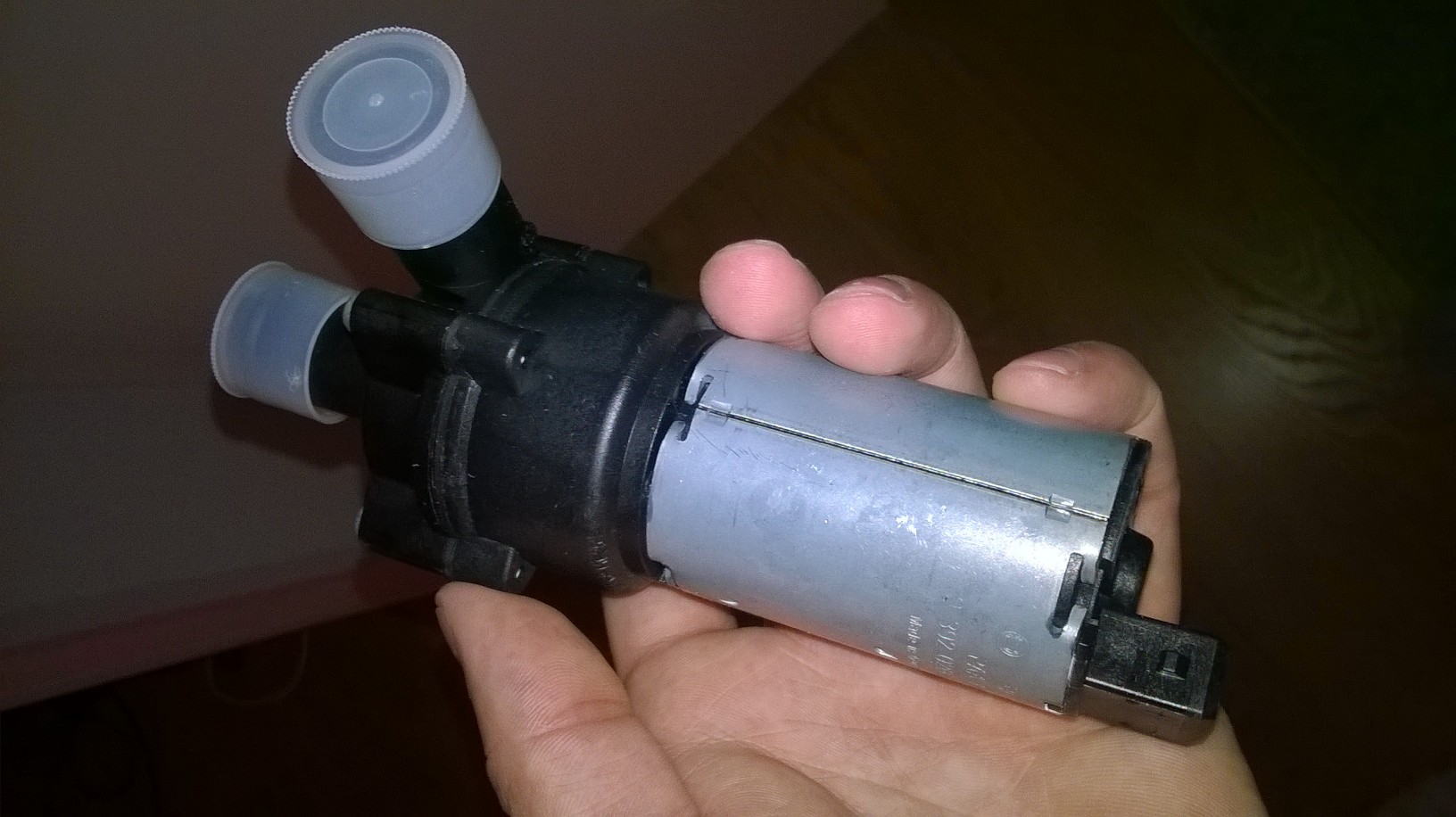

Also bought new after run pump which is a bit shorter than oem part, but fits nice and does the job. Replacement was also quite much cheaper, an Opel or Saab part I believe.. :roll:
Bosch part no: 0392020034

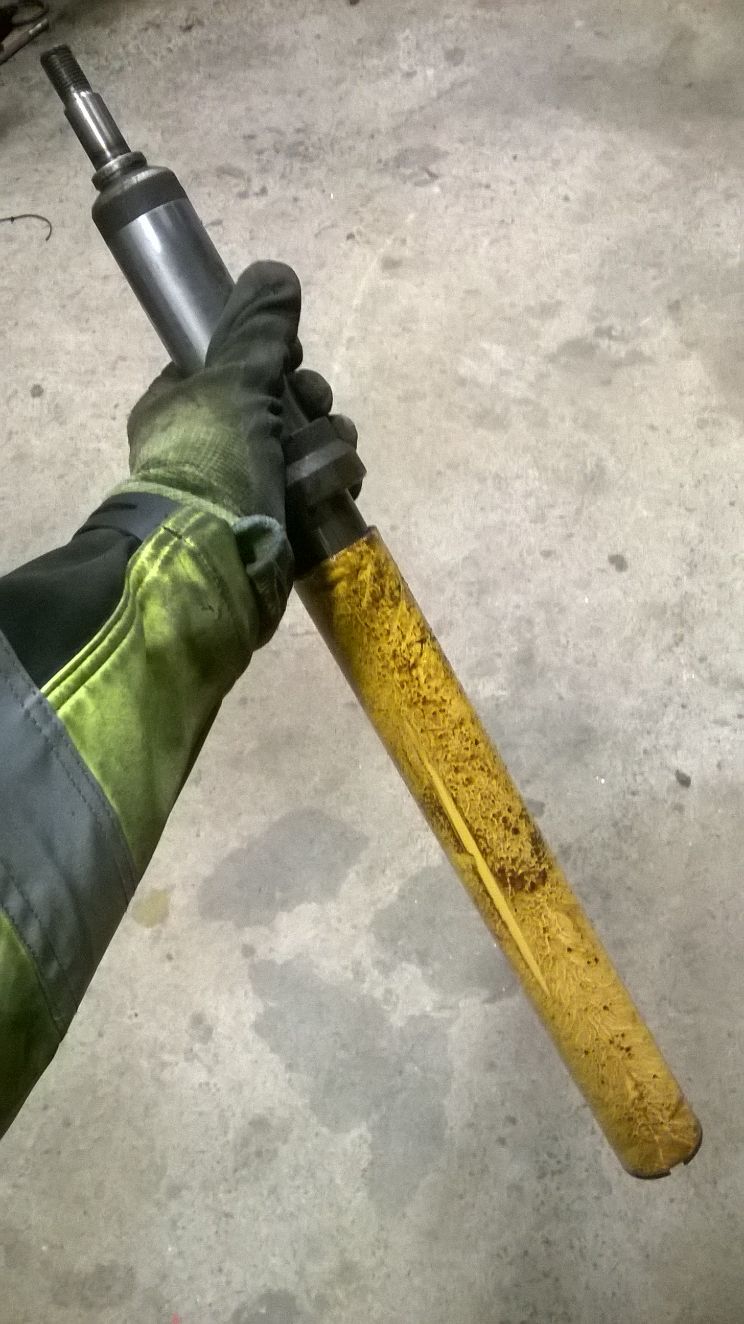

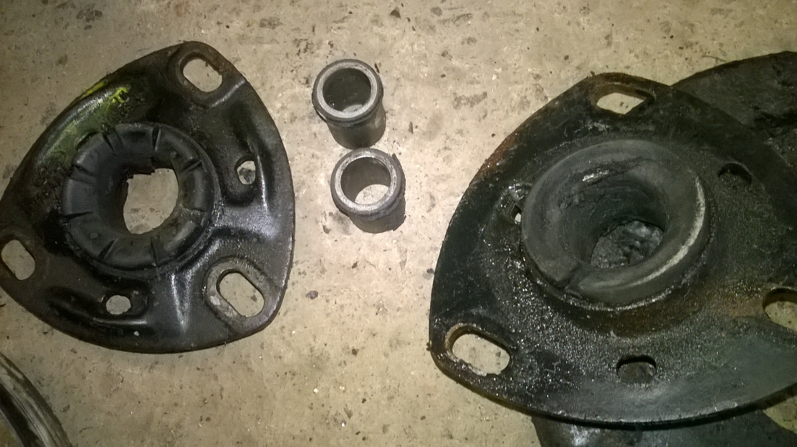

Seems it was about time to change the shocks.
old shock.jpg (1.51 MiB) Viewed 51965 times

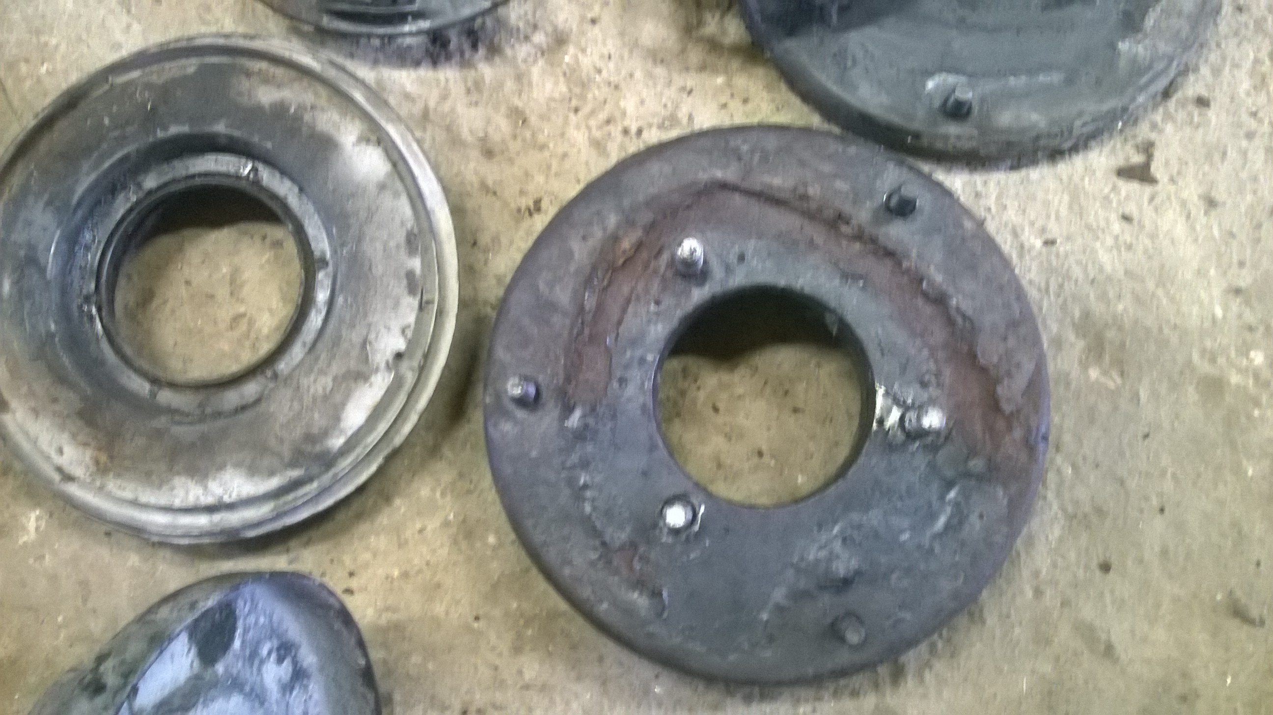

The upper mounts were also in grade a shape..
top notch top mounts 2.jpg (1.47 MiB) Viewed 51965 times
top notch top mounts.jpg (1.56 MiB) Viewed 51965 times
As well as every other bushing. No wonderthe car was interesting to drive around. :roll:
Should have done this a long time ago..

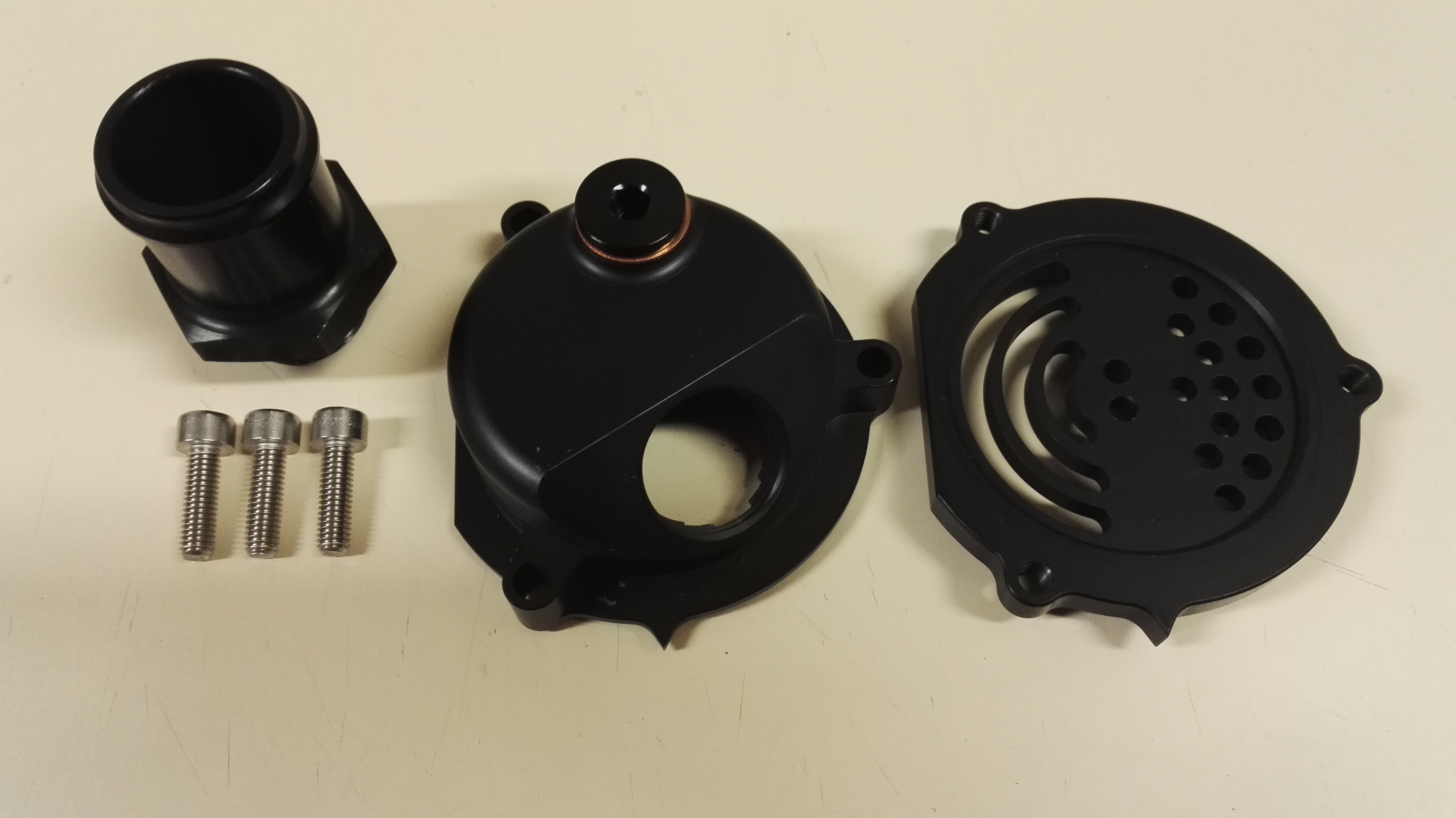

Already got some goodies from iABED Industries through S2forum group buy, the crankcase breather :
Big thanks to Issam for these, gotta love some billet goodies.

Re: 220vt from Finland
Holy crap does that breather system fit into the side of the block in the stock location? That looks awesome
88a5tq wrote:Holy crap does that breather system fit into the side of the block in the stock location? That looks awesome
Yes.
http://www.s2forum.com/forum/showthread.php?t=74680
Wow. Thanks for the link sir
