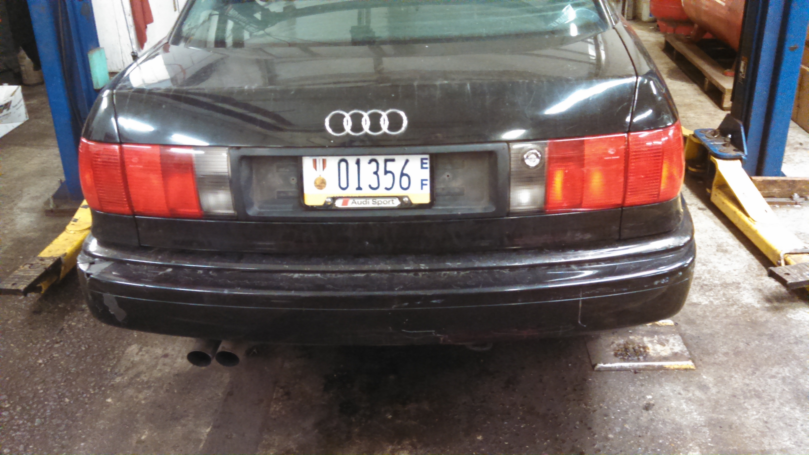

Another night of work done to the car. I got the exhaust all done. I also installed a new lower rad hose as I wasn't too happy with the first version. Finally I got the a/c done and tested that and the heat. I also got the new euro headlights installed and working.

Here is the only pic I took last night
Re: George's B4 1.8t
Posted: Fri Feb 06, 2015 6:35 am
by dalspaugh
Looks good!
It also looks like you are still running original springs?

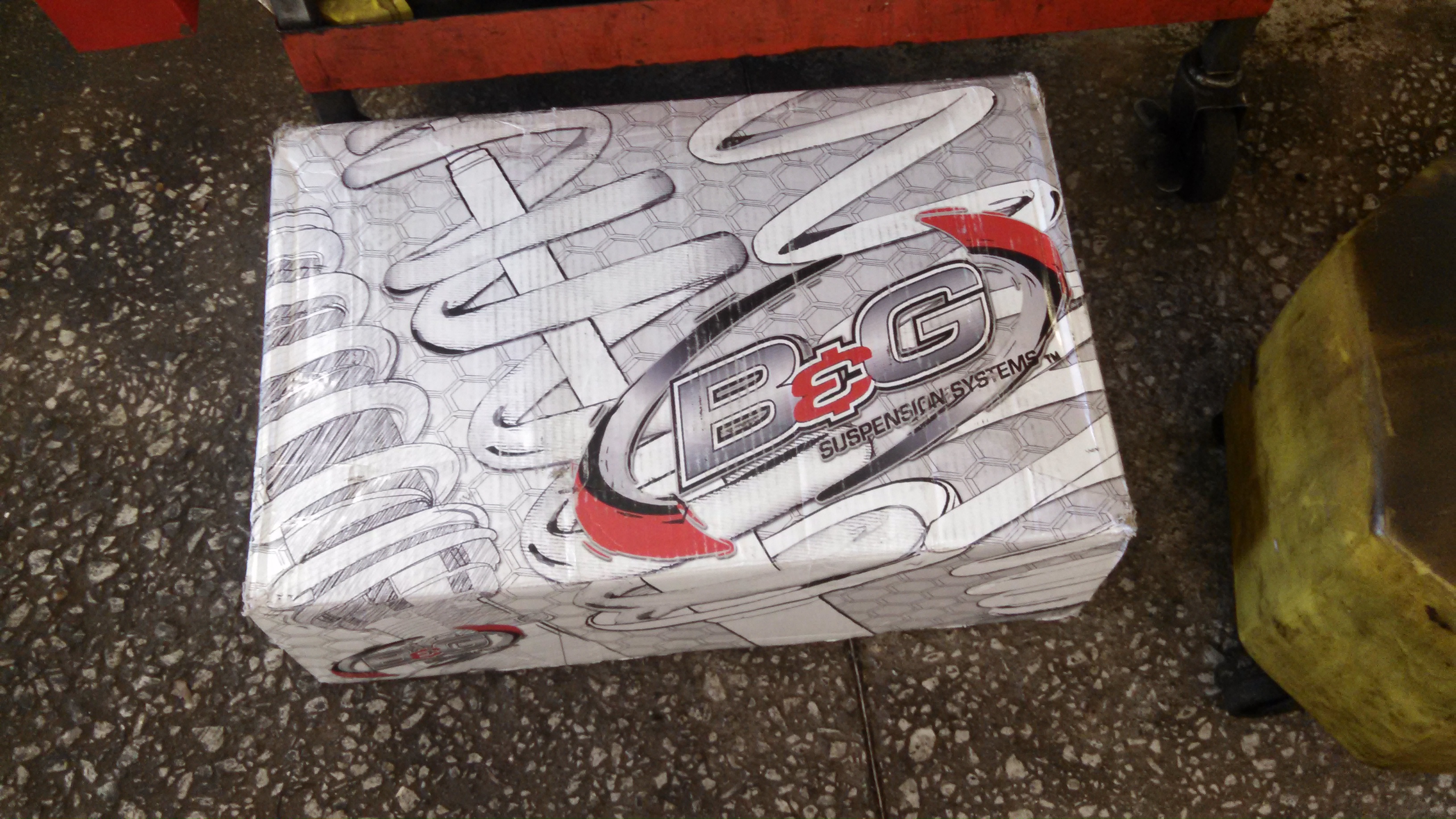

Got one major part i was waiting for today....
One more box away from this thing being on the road

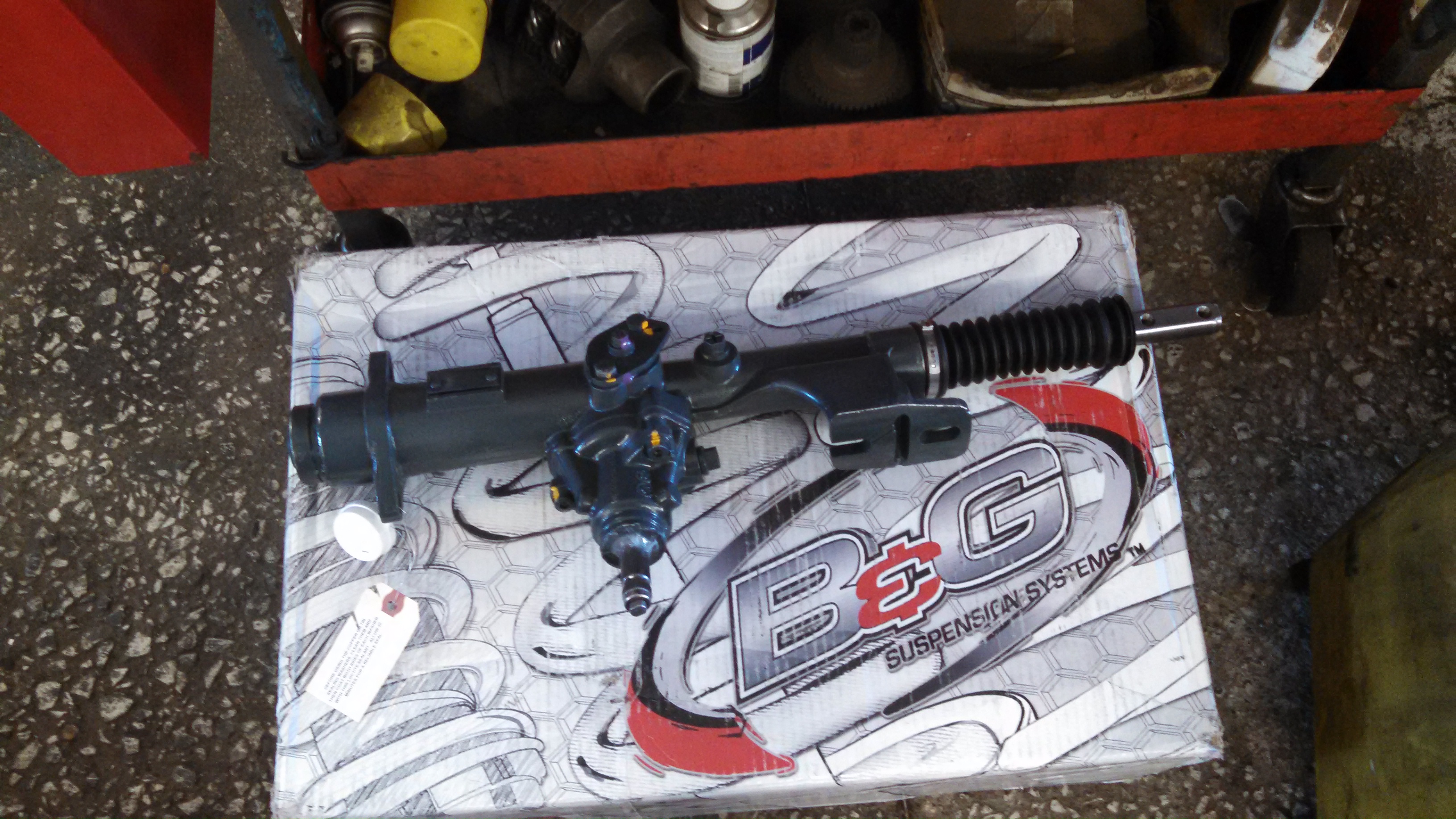

I also got my rebuilt B4 sport short ratio steering rack from Morgen Automotive the other day. That was the last part I needed to get this car on the road...now to just get working on it so I can drive it.

Posted: Thu Feb 12, 2015 10:31 pm
Love the progress so far. I definitely appreciate you approach to the build.
I'm interested in more info on your "B4 sport short ratio steering rack from Morgen Automotive," regarding: price, turns to lock, and availability.
Thanks!
Posted: Thu Feb 12, 2015 11:56 pm
PRY4SNO wrote:Love the progress so far. I definitely appreciate you approach to the build.
Thanks!
The B4 sport has a short ratio rack from factory. jorgan is company that rebuilds them.
Posted: Fri Feb 13, 2015 1:20 am
Nice. Always thought it was just the RS2 rack.
How much for a rebuild w/ core charge?
Posted: Fri Feb 13, 2015 6:48 am
by RS4Tech
PRY4SNO wrote:Nice. Always thought it was just the RS2 rack.
$337 shipped to my door including core charge, bit they are running low on core stock so unless you have a core they are hesitant to sell them. Luckily both of my B4's came with sport racks as cores. They are 2.6 turns lock to lock opposed to the standard 3.2 turns
