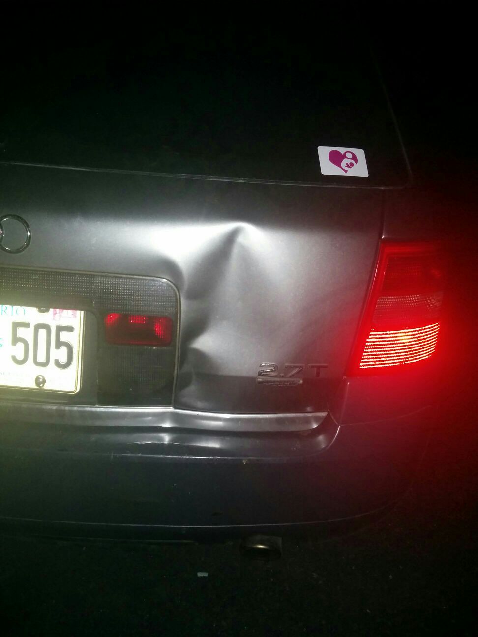

So I took this picture there other day thinking, dang the car looks pretty good in stock form, it just needs some wheels:
Then I find out later that night that it did this to itself:
Damn! I'm now looking for a hatch in Atlas Grey.
Re: Matt's WIFE'S 01 6 speed Allroad
How did that happen?
What the? Hit and run?
It rolled 50 feet backwards into a tree. :sad:
You mean a branch broke off a tree in a recent windstorm, and hit the car... right? RIGHT!?! (Act of God coverage carries no fault/no premium increase)
The tree chased it up the hill is what I mean
I'm just glad to see the car is mechanically treating you well, sorry about the dent :|

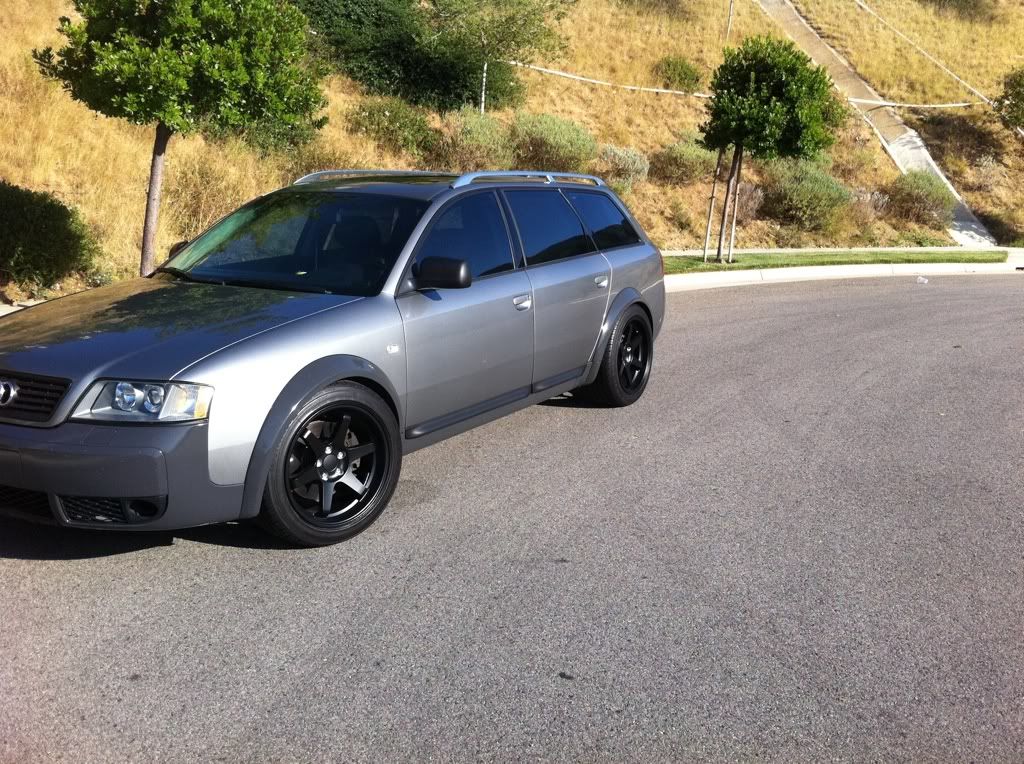

Finally got some decent wheels for this car. I picked up a set of Fast Hayaku (Volk TE37 reps) in 5x112, et25, 18x9. Also picked up a set of 10mm spacers from the ebays. Should look the business! I'm putting 245/45 tires on if it all works out, we'll see what my tire guy says. Best of all the wheels were $500 CAD. They come with a small bit of curb rash on one of the wheels but other than that they seem pretty mint. A 9" wheel is WIDE!!!
Here are the wheels. Same gunmetal colour... didn't take any of my own pics and dropped them off right away:

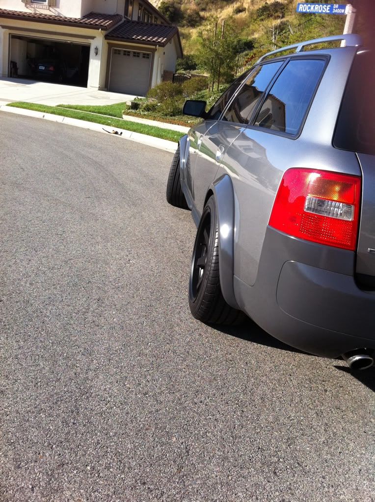

Here's a set of 18x9.5 with 245/45, ET30 with 15mm spacer. Not Fast Hayakus, but another TE37 rep. So I'll be 12.5mm narrower wheel, so not stretched. I'd like a nice straight sidewall.
Another to show the profile:
