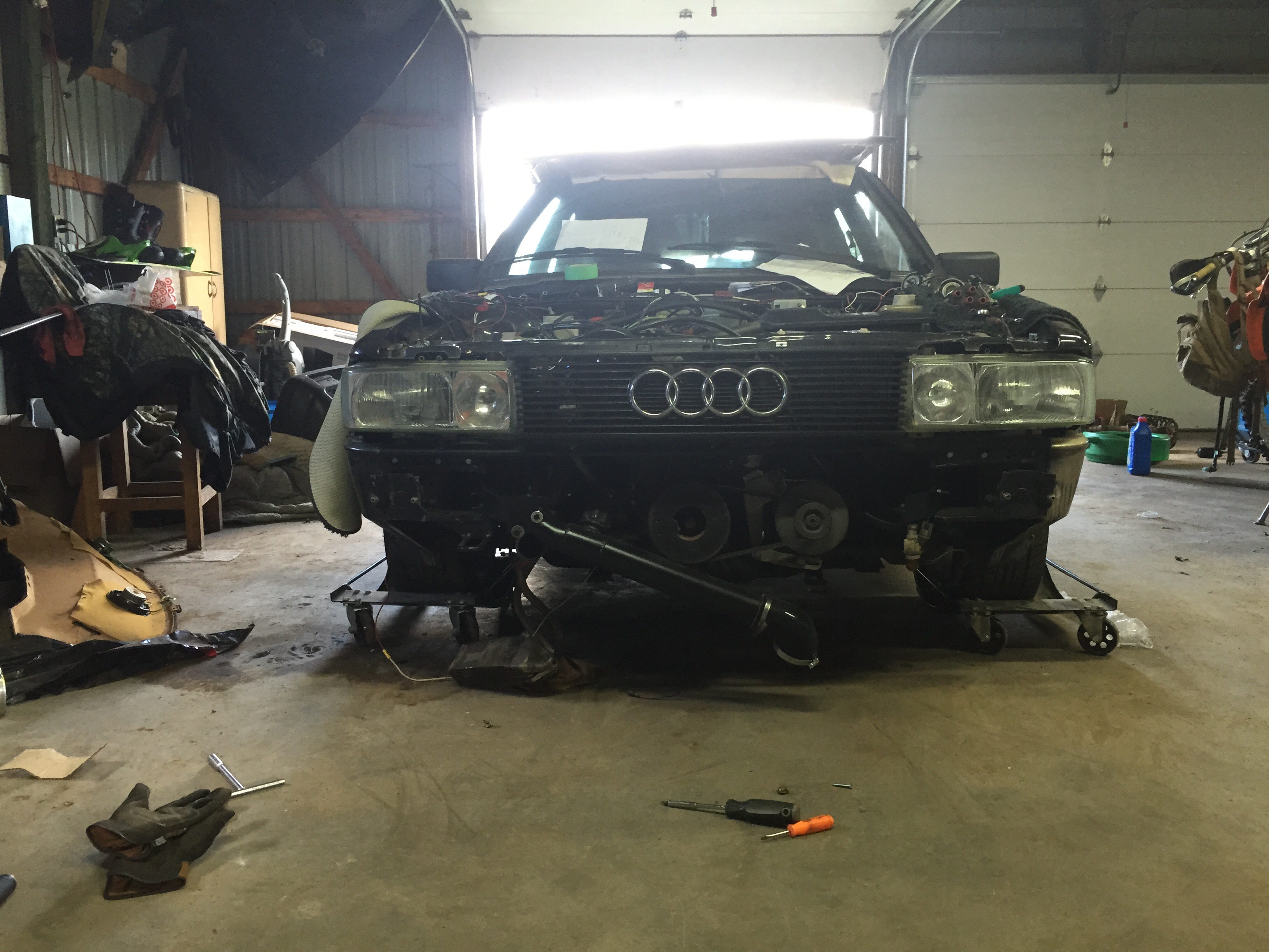

Had a chance to get back out into the shop for a few hours today! Holy cow! It's starting to come along! I can safely say I'm a week or two out from trying to start this thing! Wooohooo!
I got word from Elaw that he's finished with my ECU so I jumped into high gear to get this wiring sorted for its arrival. I spent the better part of my morning sorting through the complete cluster fuck of bare shittily soldered wires, scotch locks and knicked wires under the dash to safely be able to hook up a battery to start testing circuits. After that I added a couple more splices to the harness on the bench and then through it in the car to start terminating ends. I had it all measured and laid out on a piece of cardboard to be able to just build the harness on the bench and install, but I guess I had a few too many when I measured it all out one night haha. In the car it went! I've got two main branches of the harness, left and right. Right branch is the injectors, IAT and TPS. Left branch is the hall, ICM, CLT and grounds. I got the right branch finished today with good intentions on cranking out the other side but the wife got home and reminded me she has softball tonight, so I had to shut it down. When it's all done, it should look pretty clean. The right branch will follow the fender and the left branch will follow the fire wall. I built a couple of injector jumper harnesses a couple weeks ago that will make life a bit easier for those PITA injectors that are buried under the fuel rail. Some day I may make new fuel rail brackets, but for now these should work fine.
After staring at my engine bay a bunch today, I also realized I didn't like where I had the battery terminal. It just didn't look right sitting there on the wheel well, so I moved it to the firewall and made up a new starter cable. I need to order up some heat wrap/sheathing for both the cable and fuel lines the hang out around the wastegate. I thought I had a bunch in a bin somewhere but can't seem to find it.
Super pumped for my ECU to make its way home. The wife and kiddos are leaving town for a few days so I should be able to get out and tidy a couple things up after work this weekend along with a solid day out there on Monday. We'll see though, I've been neglecting my dirt bike for a couple weeks trying to get stuff done around the house and garage. Busy busy!

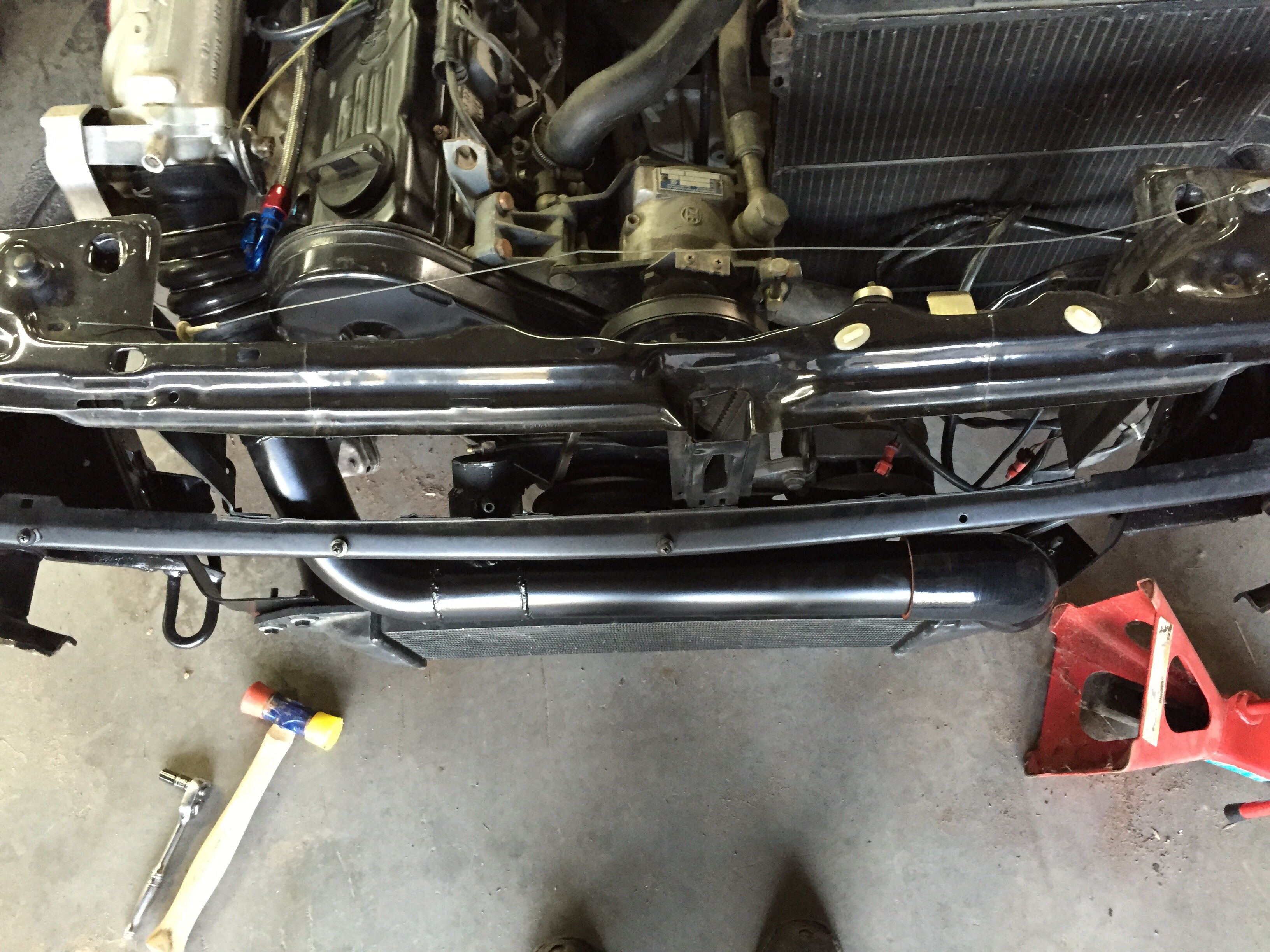

It is hard to tell but did you just do a snub mount delete for that bad ass inter cooler?
Re: Danes street 4000: megasquirt schtuff
Posted: Thu Jul 30, 2015 11:15 pm
by deaner
Namreg Rac wrote:It is hard to tell but did you just do a snub mount delete for that bad ass inter cooler?
Yeah. With how I wanted the IC to fit I had to trim the core support. I figured if I wasn't planning on running one on my AAN race car so my "babied" street car would be just fine with out a snub. After taking with a couple of guys making waaaay more power than I plan to, I put a pair of fox body mustang solid mount in the rally car to replace the 034 track densities, which then found their way into this car lol. If these 034 mounts shit the bed or move a bunch, I'll just pick up another pair of mustang mounts and plant that motor in there lol.

Get the mustang mounts now. Unless you want a nice dent in your hood. You will rio the 034 mounts right out with out a snub mount. I now have a complete set of Epic mounts from angry Taco, I like them a lot. Make sure to heat shield your PS motor mount. I have already melted the 80a poly in mine, and I wrapped my down pipe very well...
Posted: Fri Jul 31, 2015 8:03 am
by deaner
I assumed when I put them in that the 034 mounts weren't going to last forever. They're better than the floppy, old stickers that came out, that's for sure. I also had them lying around.... Until I notice wear or decent movement, I'm just going to leave them. They're easy enough to change out and at the moment, I've got loads of other stuff that would gladly suck up the $70. :)

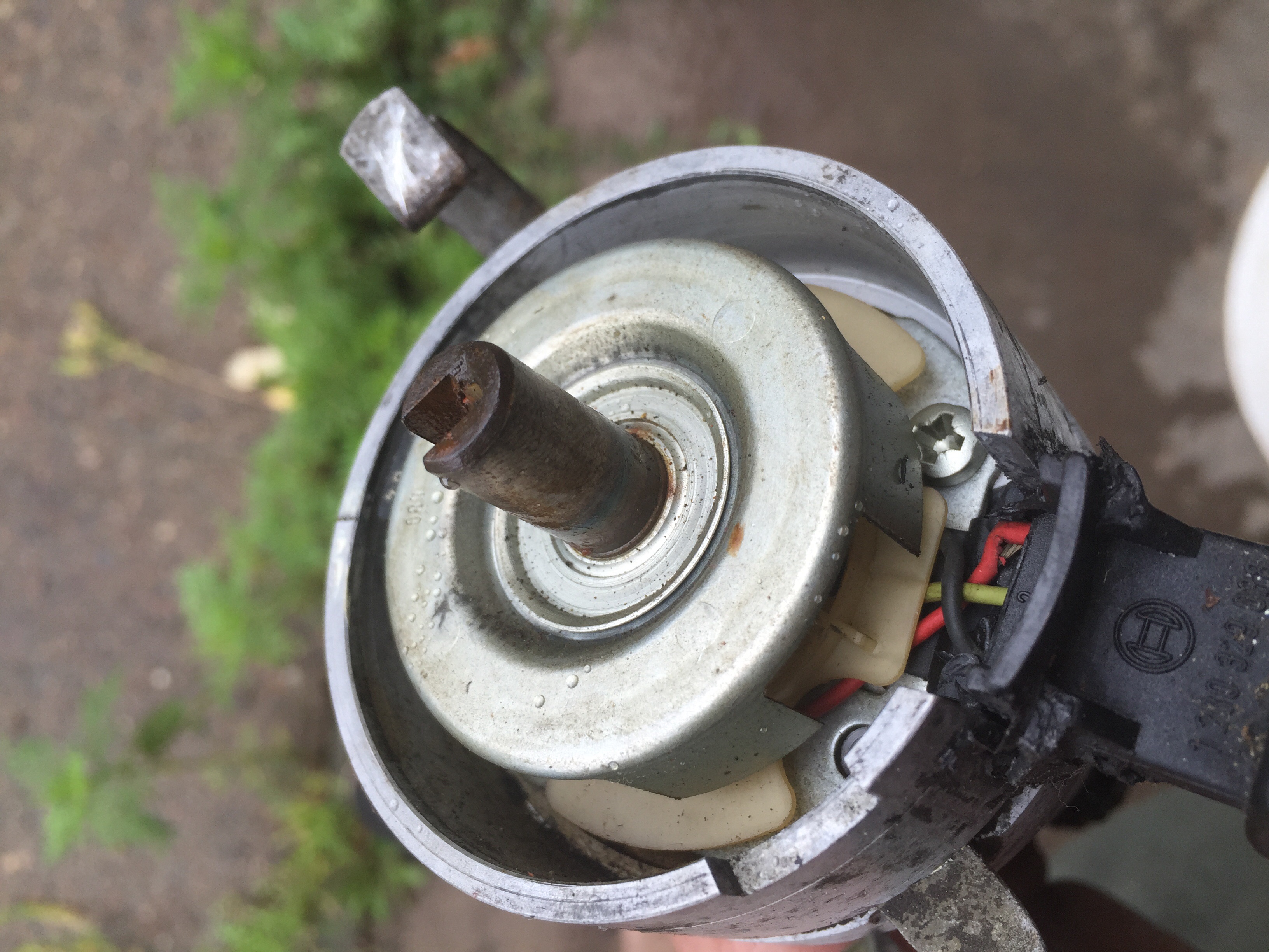

So where were we? Hmmmm.... I had a couple of issues with my distributor I figured out a couple of weeks ago. I'd posted up in the megasquirt thread over in the standalone forum the issues I was running into. I'd gotten lucky with the fuel line crap I was dealing with! Ended up having a half inch long obstruction RIGHT at the rubber hose connection to go back into the fuel tank. Cleaned that out and slapped the line back in and all was well. I think the FPR is sticking a little or a stuck open injector because pressure bleeds off, quite quickly at that. So I'm leaning towards the FPR. So that got resolved.
Tried starting it that same week as my last time posting and had issues with no trigger. Quadruple checked all my wiring and it was good. Took a good close look at my distributor and found this...
Poopy
Poopy
Junky distributor. If you look close, you can see that the red wire is bare. Being as I'm picking up power for both the hall sensor and the ecu from the same place, the only thing I could figure out is it would reset the ECU as it grounded when I cranked it. Huge THANK YOU to "DE80q" for sending me out a couple of dizzies and a cap to get this thing diagnosed! Sure as shit, plugged one of his dizzies in and got the injectors, well 4/5(reckon I have a stuck one) clickity clacked away as I spun the shaft. Sweet!! We have fuel!!!!

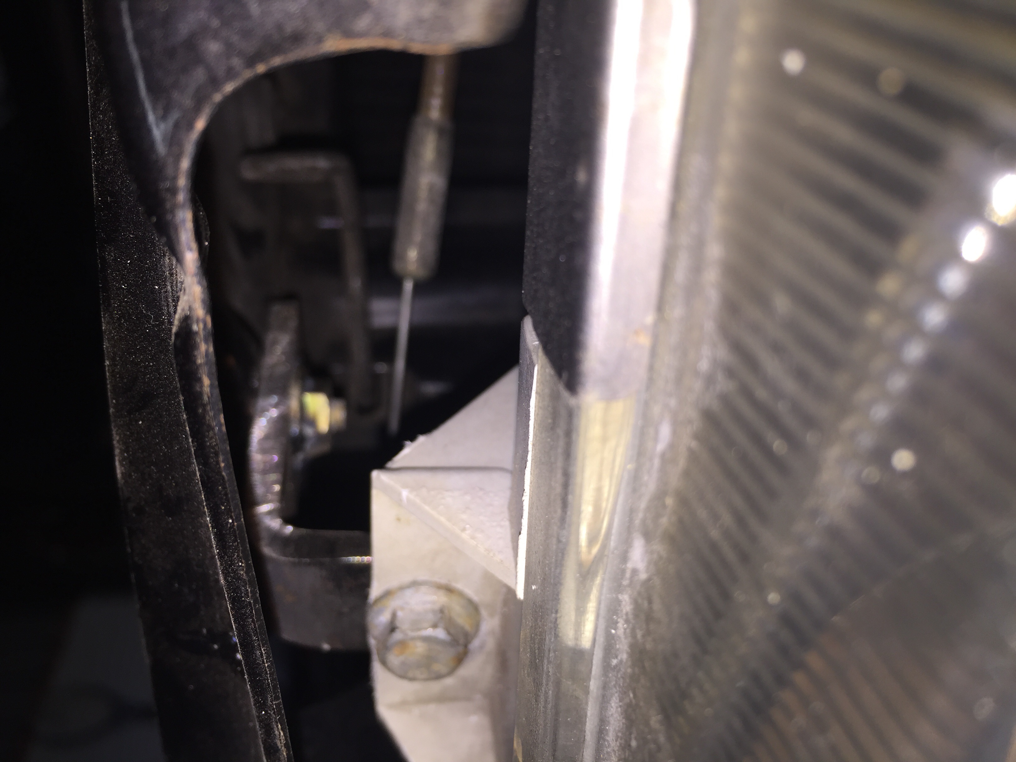

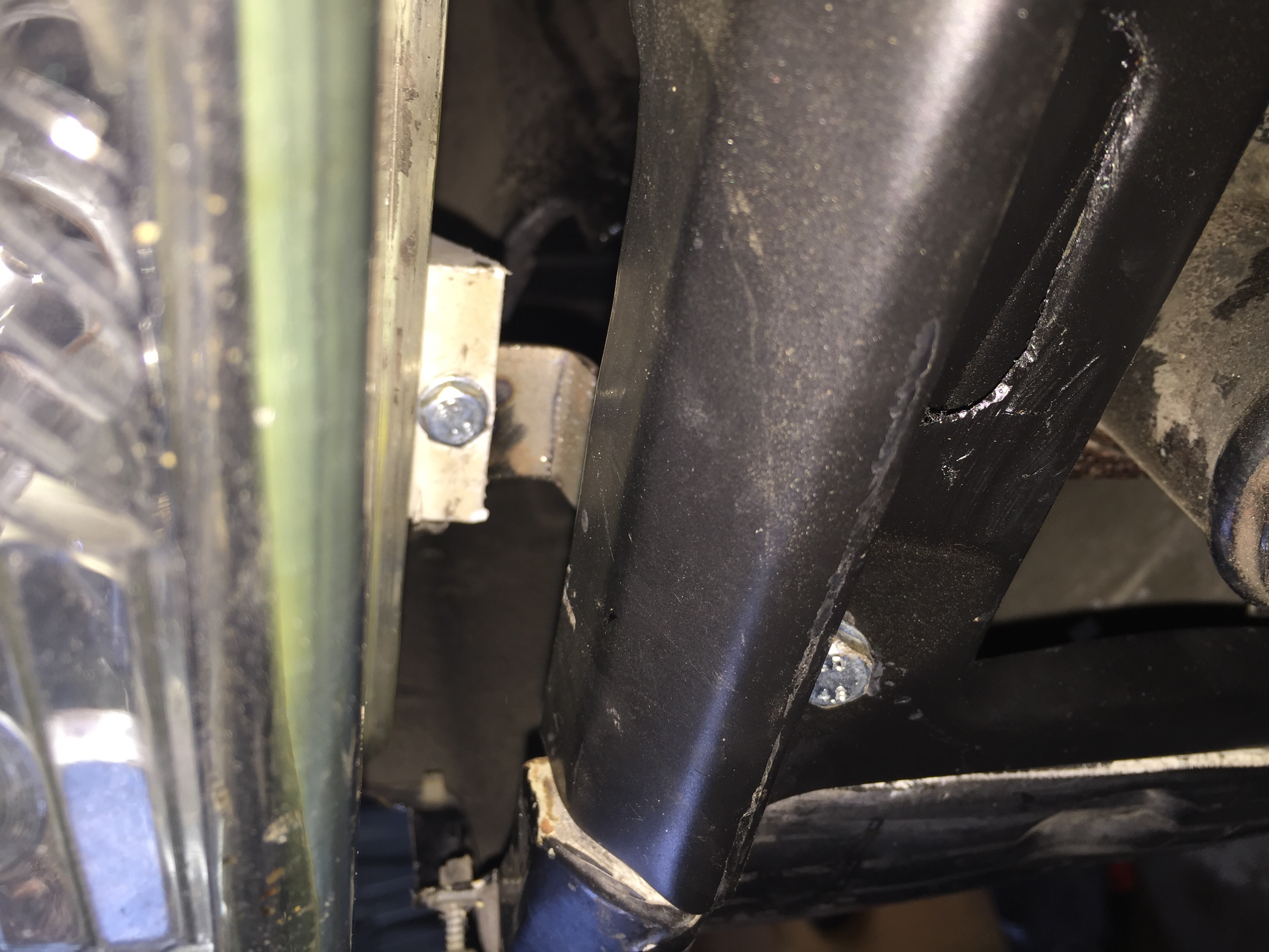

My plan for a lazy day working in the shop was to get the euro light mounts made and wired. Well.... I got the mounts made lol. Lazy was an understatement! For once I was able to sleep in(9 am) AND my mother in law is in town so the kiddos were taken care of, yet I still didn't get out into the shop until noon! Ha! Anyhow, with the headlights I was kind of at a point where I HAVE to install the euro lights or else rob the lights and brackets off my rally car. The lower headlight mounts that bolt to the chassis are MIA on this car. I used the tried and true "bent steel plate" method of bracket making. A couple of "Z" brackets, one for the top and one for the bottom and we are in business! I still need to round the edges and paint them but for now, they're done lol. The pictures suck but so be it. I'll snap some decent pics when I pull them out to finish them off, may be a year but whatever....
The mounts!
Upper bracket
Upper bracket
Lower bracket
Lower bracket
Finished product. Still needs a liiiiiiittle tweaking but good for now.

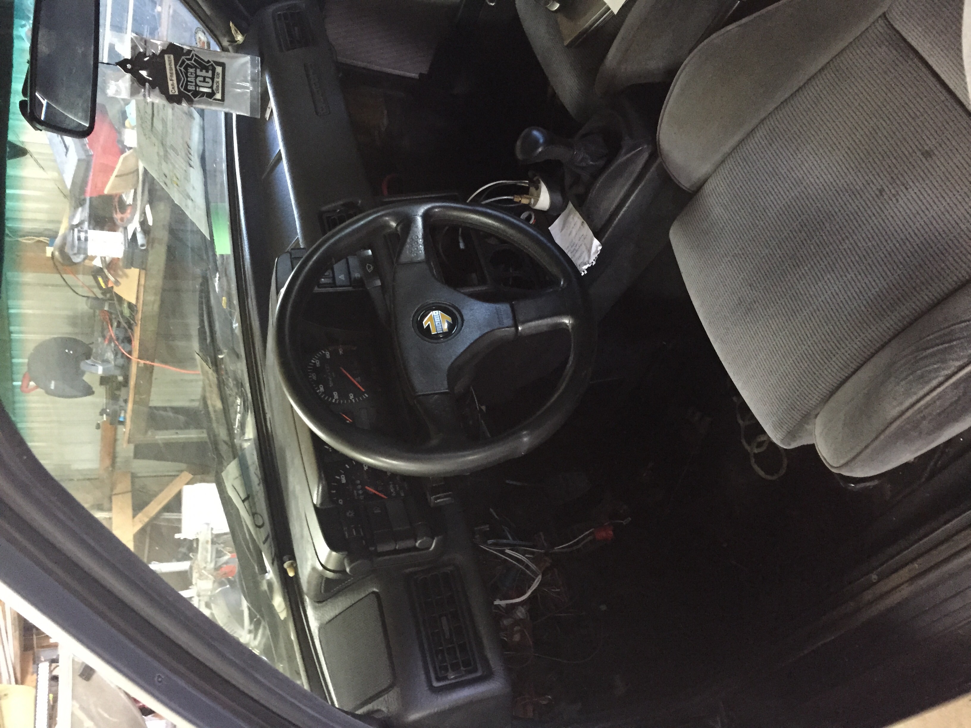

Also got part of the dash put back together. The wiring is going to be its own couple days of sorting... Yikes!! But at least it's coming together!
Interior
Interior
