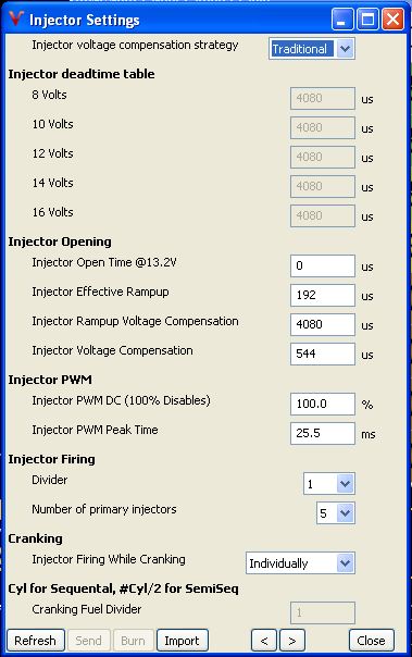

What tupe of injector settings are you guys running? The simplified or traditional? I've been trying to get my VE close enough to where I dont need to retune it when I change Lambda targets and I think the fact that I am running the Traditional style strat is screwing it up. Thoughts?

DuBistS4 wrote:What tupe of injector settings are you guys running? The simplified or traditional? I've been trying to get my VE close enough to where I dont need to retune it when I change Lambda targets and I think the fact that I am running the Traditional style strat is screwing it up. Thoughts?

What type of injector settings are you running Nick? Traditional or Simplified?

DuBistS4 wrote:What type of injector settings are you running Nick? Traditional or Simplified?
This is how it came from Marc. I have made no changes to them and have not had any issue.
