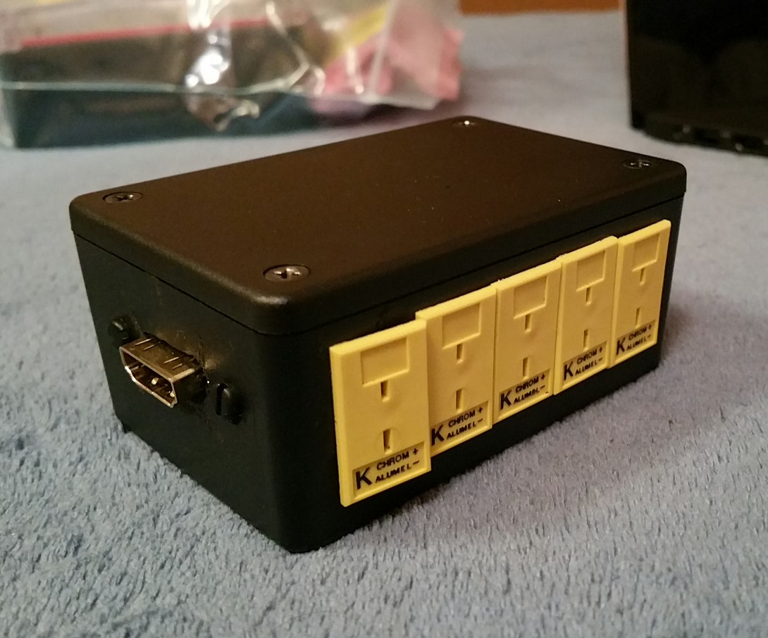

Last week I got the chance to try making some hardware fit in a nice little box. Unfortunately, I didn't account for a few things and it doesn't quite fit everything in the configuration I wanted it to. I will have to find a slightly bigger box. It was a good learning experience though.
I had to use a dremel to cut most of the holes out unfortunately. I will come up with a way to avoid that in production models (templates, jigs, waterjet, etc). I have a die for the thermocouple connectors, but it doesn't quite work for the outer connectors, and it definitely doesn't work for the HDMI, USB, etc.
Here are some pictures. Please ignore how rough everything is (especially that floppy TC port lol). This was just me experimenting with different layouts, trying to make the smallest enclosure possible work.
TC ports

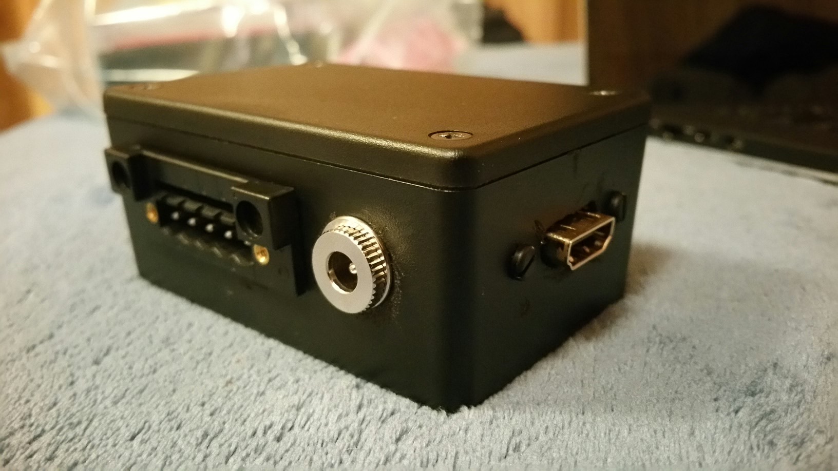

Analog outputs, power, and HDMI out to LCD display (HDMI connector will probably not stick out like that)

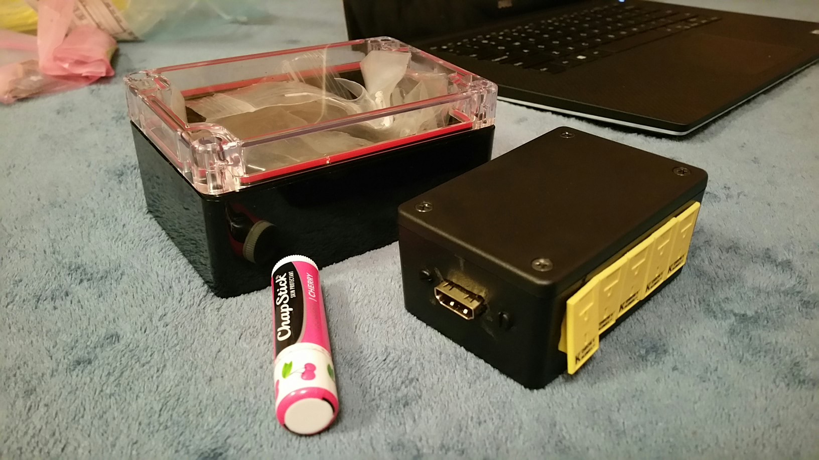

Chap-stick for scale. The box in the background is another one that I ordered for consideration, but it is too big and expensive.

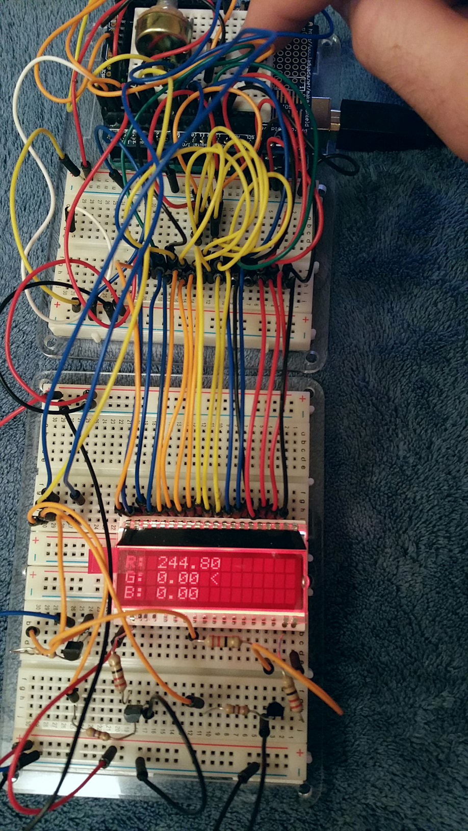

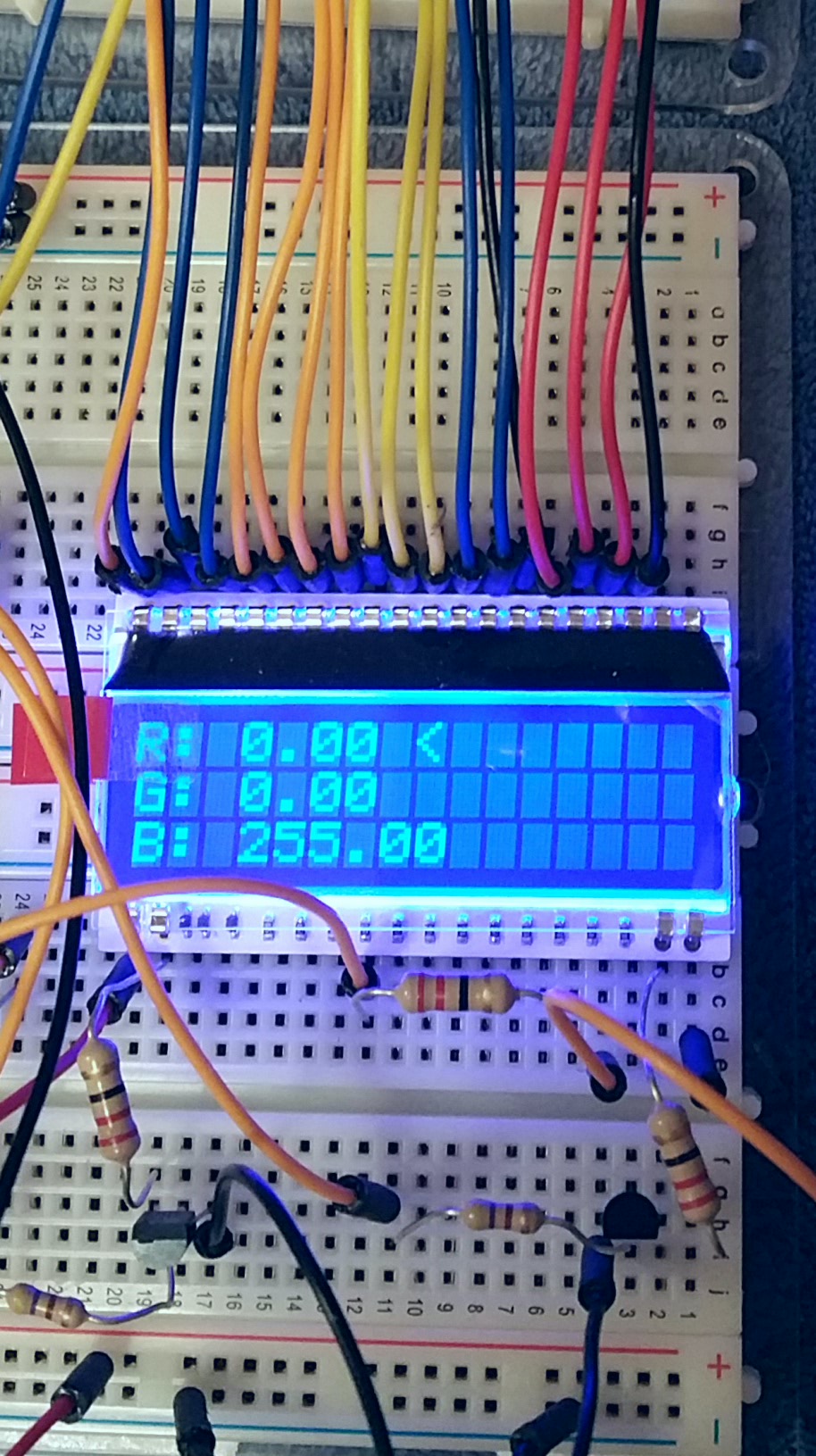

Over the past few days, in-between 18 hour shifts and despite the most contradictory and conflicting documentation I've ever received with an electronic component, I somehow managed to wire up the RGB backlit version of this display. I only had to fix a line or two in the code that I'd already written but had been unable to test and it worked. It had a strange "beat-like" flicker to it though, and it turns out that one of the PWM pins I was using runs on a different timer than the other two. Not the most fun kind of issue to chase, but I managed to track it down in a reasonable amount of time. That would have been super annoying to have to deal with! It's perfect now though :)

I haven't taken it in the car to find out what settings produce the stock instrument color yet, but I do plan to do that and send them out with that as the default setting.
