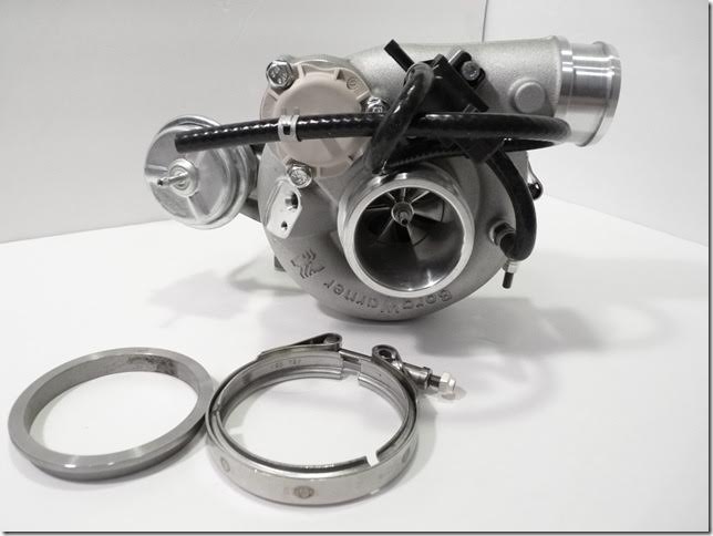

Here is the stupid plan I came up with, it may or may not work.
The manifold I was going to use for the URQ now has been re-purposed for the 4000. I want to run an EFR in that car ultimately and when I get my engine back from the shop and start putting it together I will have that to protoype a setup on.
There is an eBay store that sells used EFR turbos off of Penske Indy Cars. for the price I'm sure they need work but I ended up picking one up a while ago just to see if i could make it work. I tried searching the webs and could not find any reports of anyone using one.
So here is the turbo.
EFR 7163 , AR 0.85, NonWG
P/N 1163980000
The first issue I will have to work through is the flange on the exhaust side. it is slightly off in size from the ones Hank uses (Tial ?) Im not sure how they measure the flanges. There is an inner race, the OD or whatever, the ridge on that, measures 2.5" the ouside of the flange is
Exducer Inlet flange
Fitment in the car
Re: 86 Alpine white 4000's
Same turbo I have:
EFR 7163, 0.85 A/R, v-band in/out, EWG
Hank ran into the same issue with the v-bands on my set up, using his old personal exhaust manifold running standard TiAl vbands.
Digging through my emails, here's what Mike Hood figured out:
Mike Hood @ Ringer Racing wrote:You can use the Tail flange for the input at the manifold, the discharge on the 7163 is the BW EFR style V-band like the rest of the EFR’s.
So you will need a discharge EFR v-band clamp and maybe a flange if you are going to be making your own down pipe.
Mike
And in a further email:
Mike Hood @ Ringer Racing wrote:If that manifold was made for a Tial V-band housing then the V-band you have for that will work for the EFR. Since the EFR exhaust outlet uses a different type of clamp/flange you will need those, they are $22 and $24 each.
You can see the EFR clamp/flange in this picture, the clamp is completely different then the normal V-bands used for other brand turbos.
HTH
