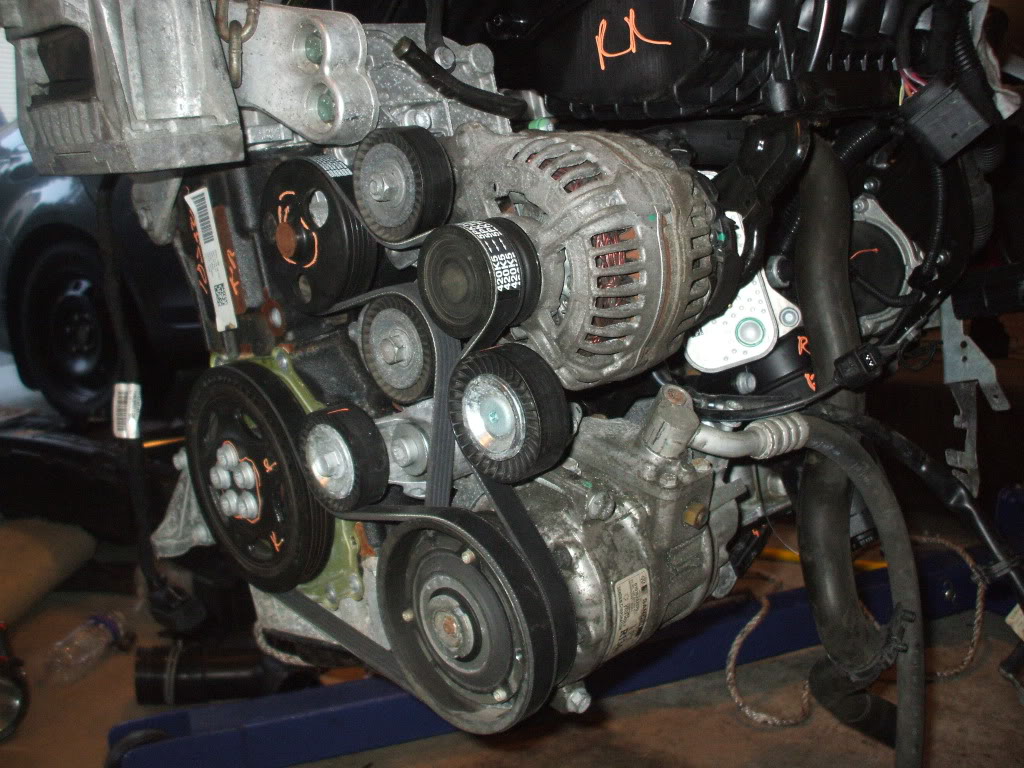

Ah, I think I figured out what caused my confusion.
In this photo:
07K belt setup DSCF9921.jpg (157.16 KiB) Viewed 116234 times
...I thought the pulley in the upper left area was the PS pump. But maybe it's the water pump?
On a related note, how much do you guys suggest budgeting annually for replacement of serpentine tensioner/idler pulleys on these motors? ;)
Eric Law
Re: Basic 07K Facts?
Old, but all Beetles and some 11-12 Jettas had PS pumps up top. They make an intake manifold a chore though.
Posts: 2142
Yes, the most upper left pulley is the water pump.
