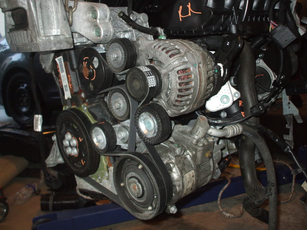

Okay so here's my next dumb question...
I made an inquiry about an engine that's available locally out of an '09 Jetta. They said that car does not have a p/s pump on the engine, it's electric.
Is that true of all years, or just the later engines? Is there a clever way of retrofitting a p/s pump to an engine that originally came without one?
Re: Basic 07K Facts?
Posted: Sun Dec 28, 2014 2:17 pm
by Noisy Cricket
I don't think the accessory drive layout would allow for a power steering pump. Every 07K that I've seen in the wild has had electric steering, including '05.

Ah, I think I figured out what caused my confusion.
In this photo:
07K belt setup DSCF9921.jpg (157.16 KiB) Viewed 116285 times
...I thought the pulley in the upper left area was the PS pump. But maybe it's the water pump?
On a related note, how much do you guys suggest budgeting annually for replacement of serpentine tensioner/idler pulleys on these motors? ;)

Old, but all Beetles and some 11-12 Jettas had PS pumps up top. They make an intake manifold a chore though.
Posted: Thu Jan 15, 2015 8:06 pm
Yes, the most upper left pulley is the water pump.
