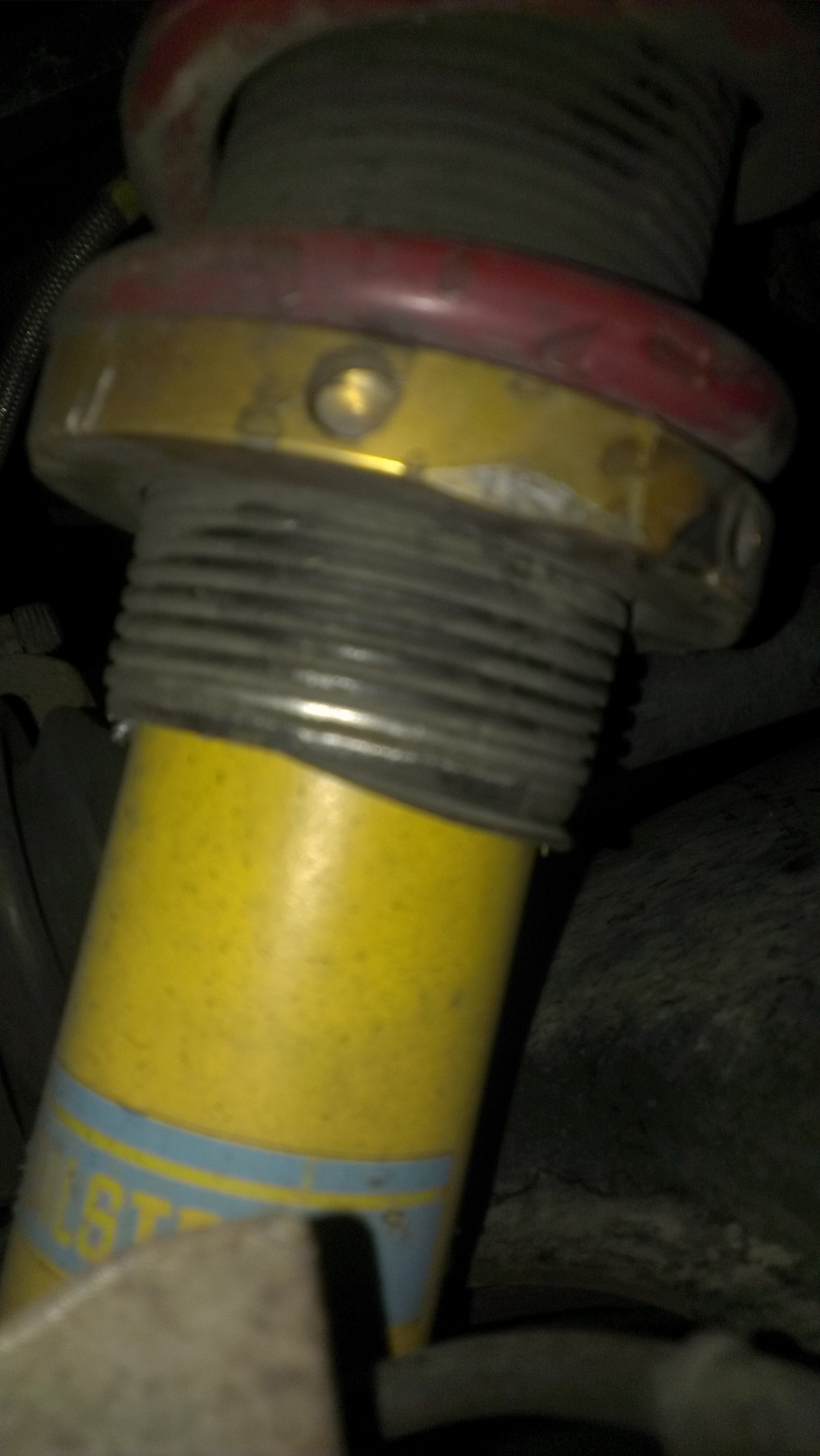

I can't wait to get it pulled apart to take a picture. The coilover sleeve managed to force its way down OVER half the C Clip on the Shock body.
Yeah. Apparently that can happen.

This is getting annoying. I noticed the right rear C clip was looking like the left side was after it had blown off at autox and how the right side looked after the first time it happened. the other edge was bent down and was not flat like it should have been. And this was a brand new clip put directly into the groove with no factory clip still in there. The left side is still the bent one that blew off at autox that we bailing wired to be able to run. Now it was some crazy thick uber heavy duty stainless huge gauge wire. But still, it's still holding together.
Managed to get the sleeve over only part of the clip. and it is STUCK.

More carnage pictures. The clip is extremely destroyed. There's a lot of slack inbetween the sleeves and the shock body and I think that might have helped with the carnage. Still not sure how this keeps happening. Brand new clip straight into the groove.

It looks like the sleeve is just too big and it's pushing on the outer edges of the clip, forcing it to just twist in.
Re: Phil's 20vt 5ktq. Post BBQ fun. Hooray broken stuff.
I know the 200 20v rear struts have a bigger diameter shaft. Maybe the body itself is bigger? Might be the reason I'm having so many issues with these rear clips turning to death.

The rear mounts are different between the two vehicles and you can't use all the 200 20v stuff on the 5k shocks. I tried to, didn't work. Not enough threads to use it fully. So yeah if going coils on a 5k, upgrade to 200 20v rear shocks and the upper mounts. Leagues better. Now time to find some bilsteins.

Agreed, it looks like the sleeve is too big. That doesn't mean you can't easily order one a size or two smaller... that is a much easier solution.
