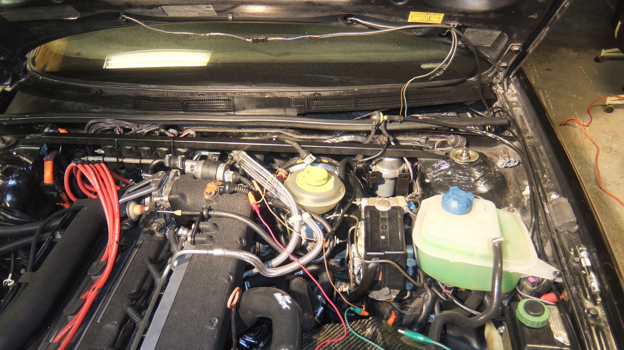

Still dealing with the vacuum booster leak (new is coming) but till i did a vacuum pump test setup.

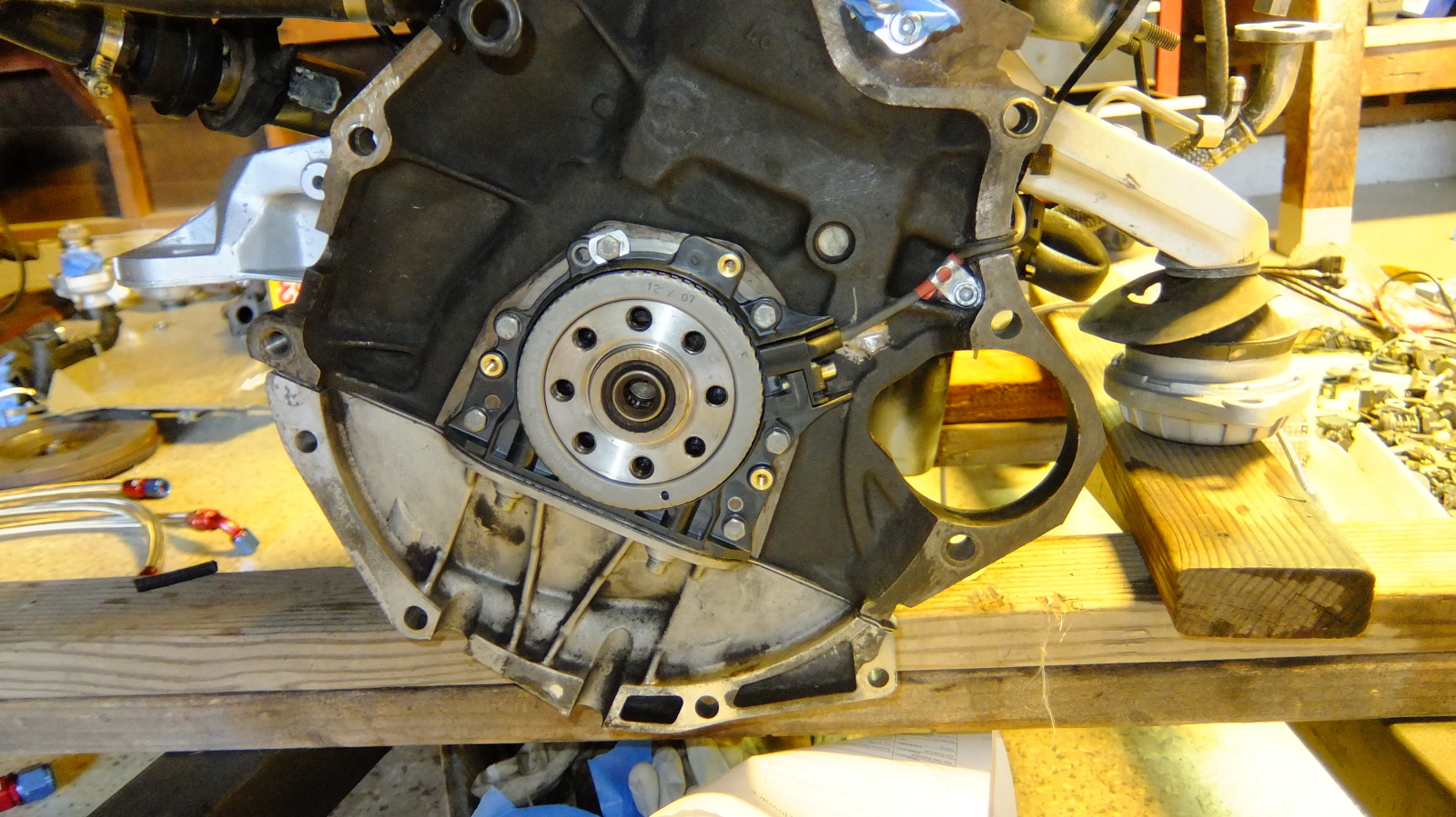

Got vems, but I got some error because the flywheel pin (consulted with Marc, thank you).
So my vems went thought a surgery and got converted to work with the rear crankshaft seal/sensor.

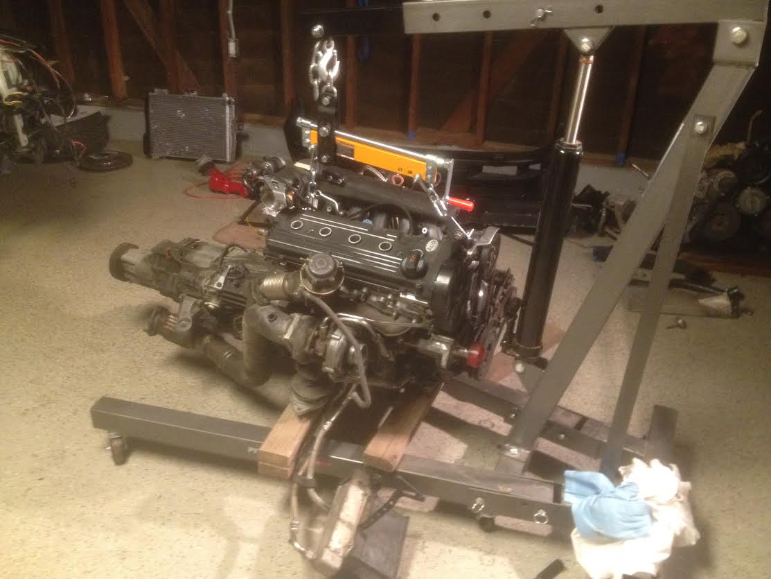

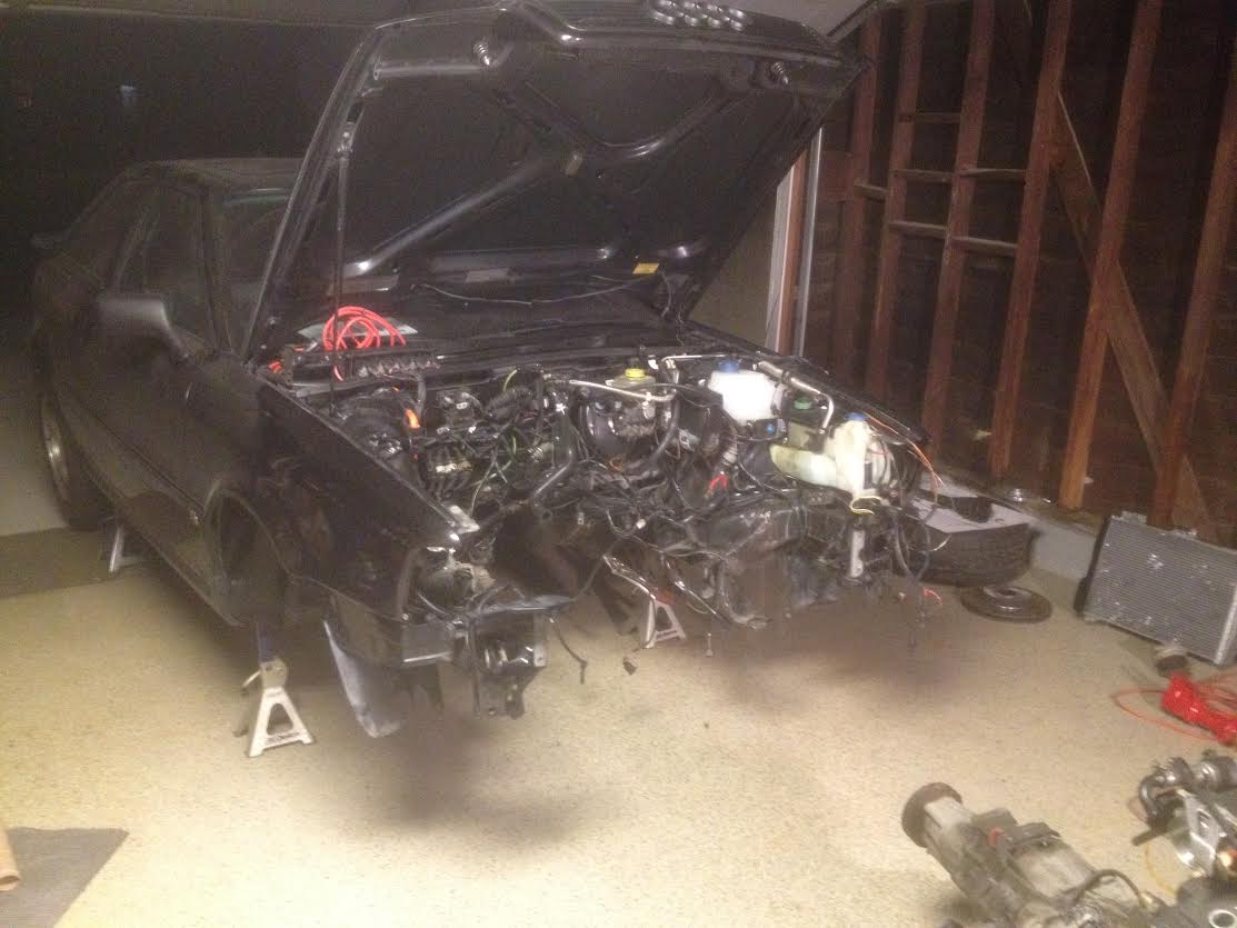

i pulled the engine out. now i can work on the exhaust/turbo swap and the crank seal/sensor
I have to really wrench on it, cos that guy, Dave he is really pushing it :D

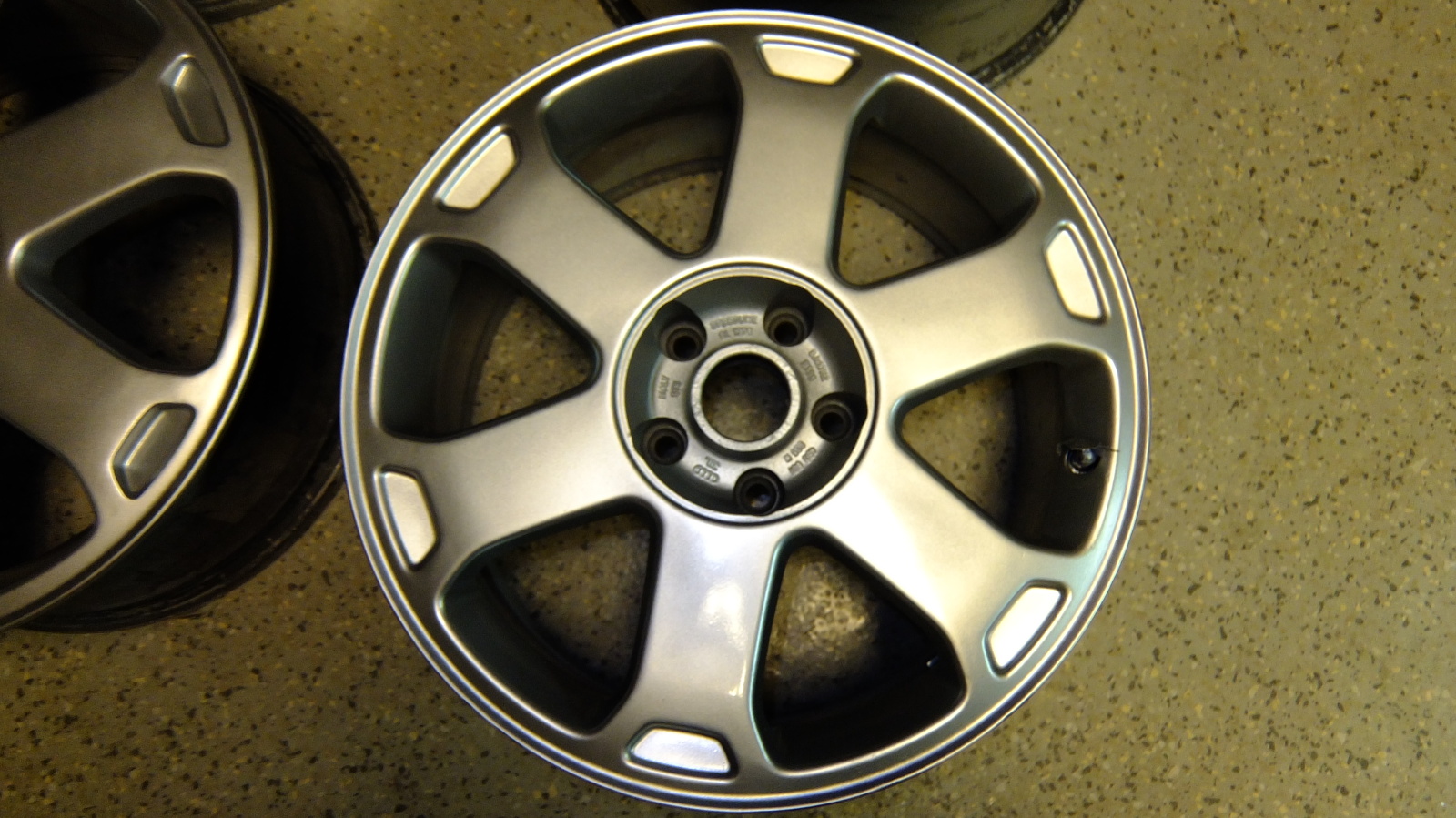

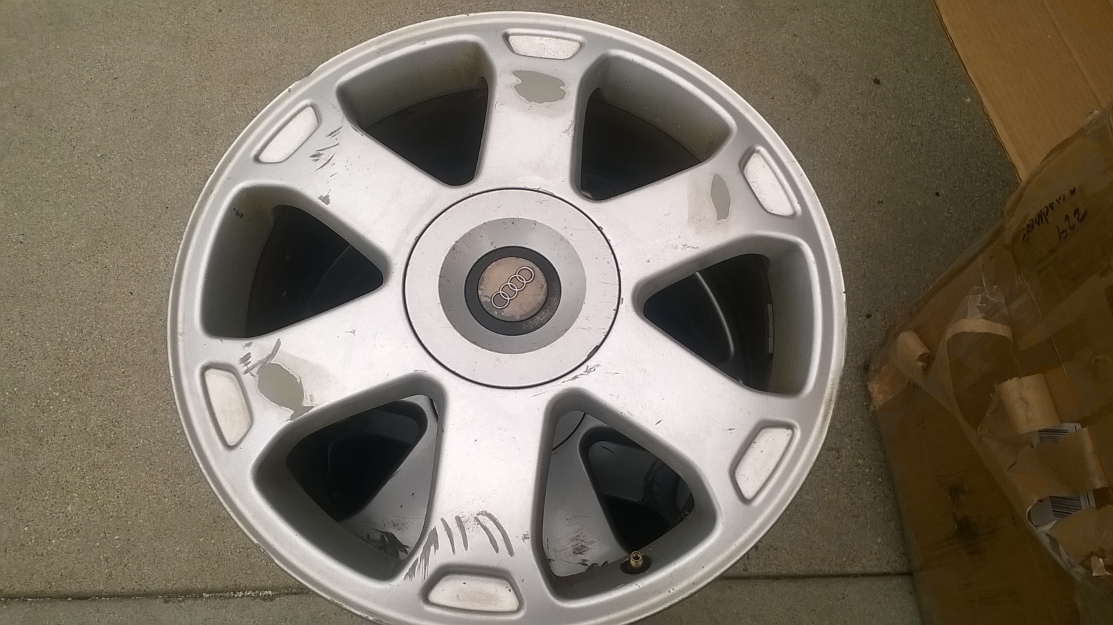

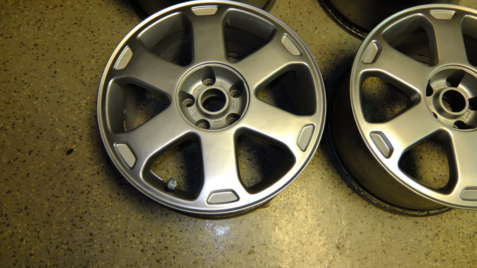

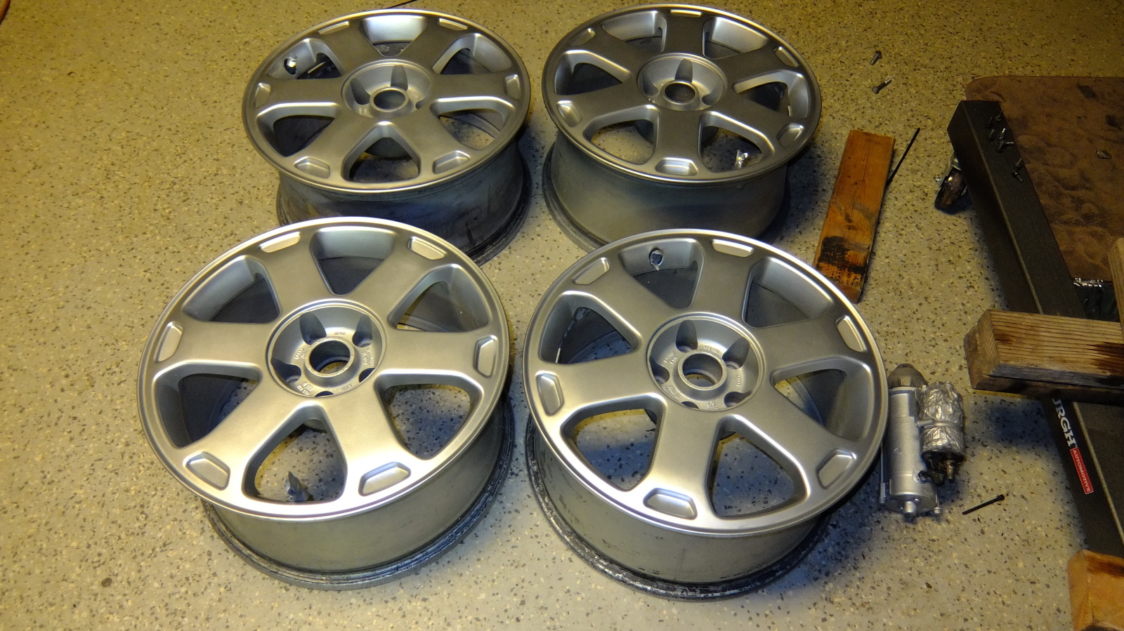

I got a pretty abused set of S6 avus wheels
i had a few hours, so i refinished them
¯\_(ツ)_/¯

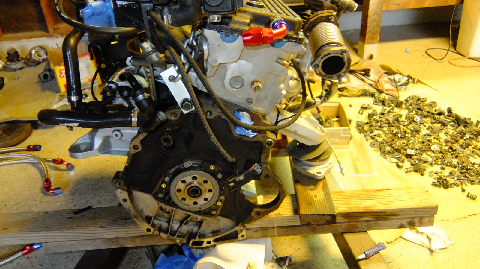

Posts: 2142
Re: another S2 conversion
Now that's a crank trigger. Nice work.

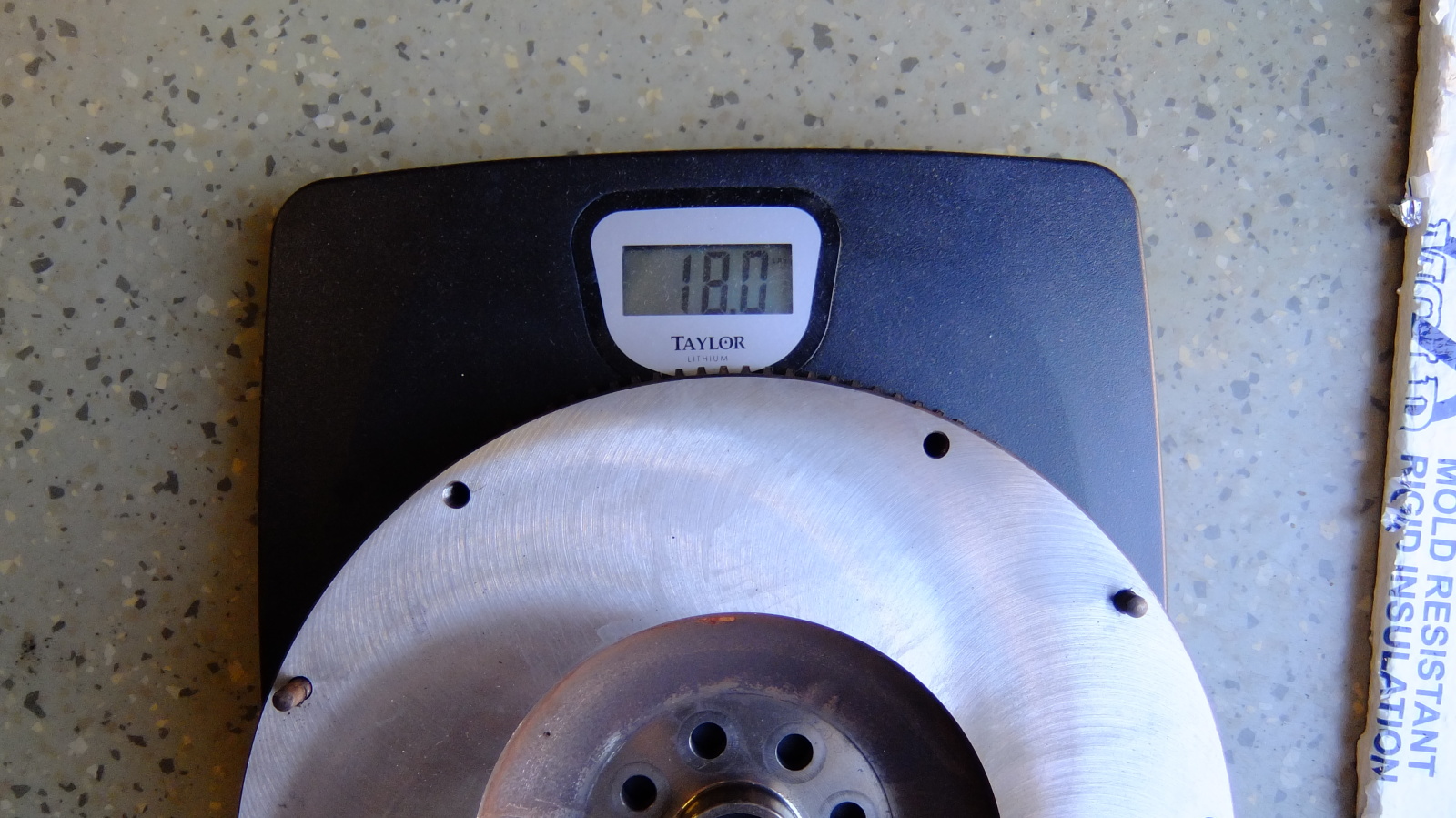

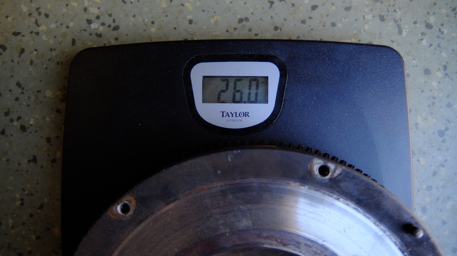

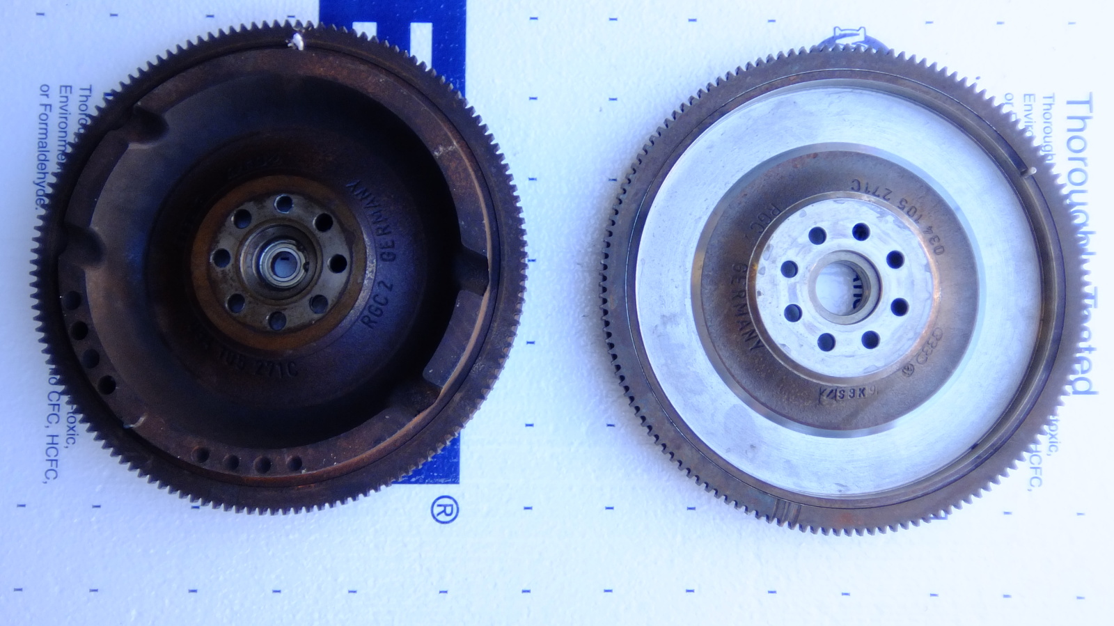

Got the flywheel back, it lost 8 lbs.
Not the biggest diet ive ever seen, but healthy enough for my setup
Re-surfaced, balanced.

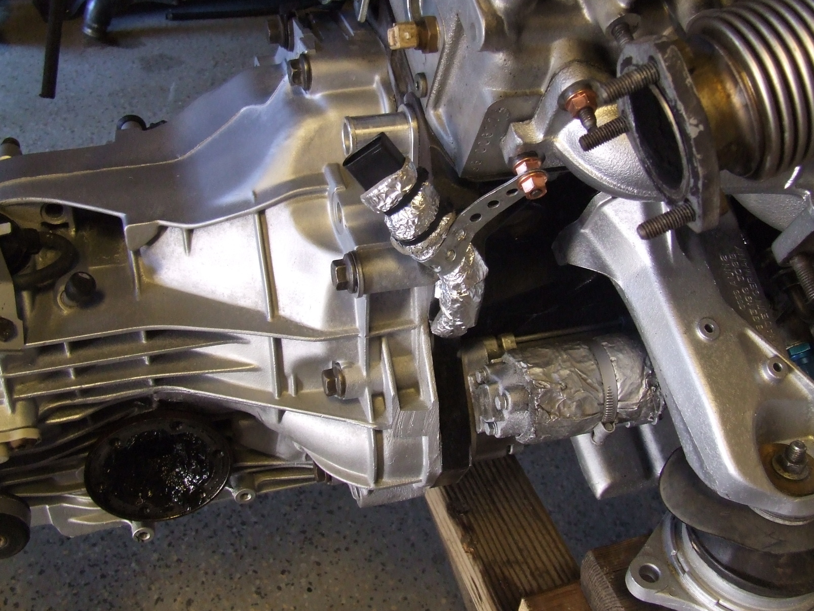

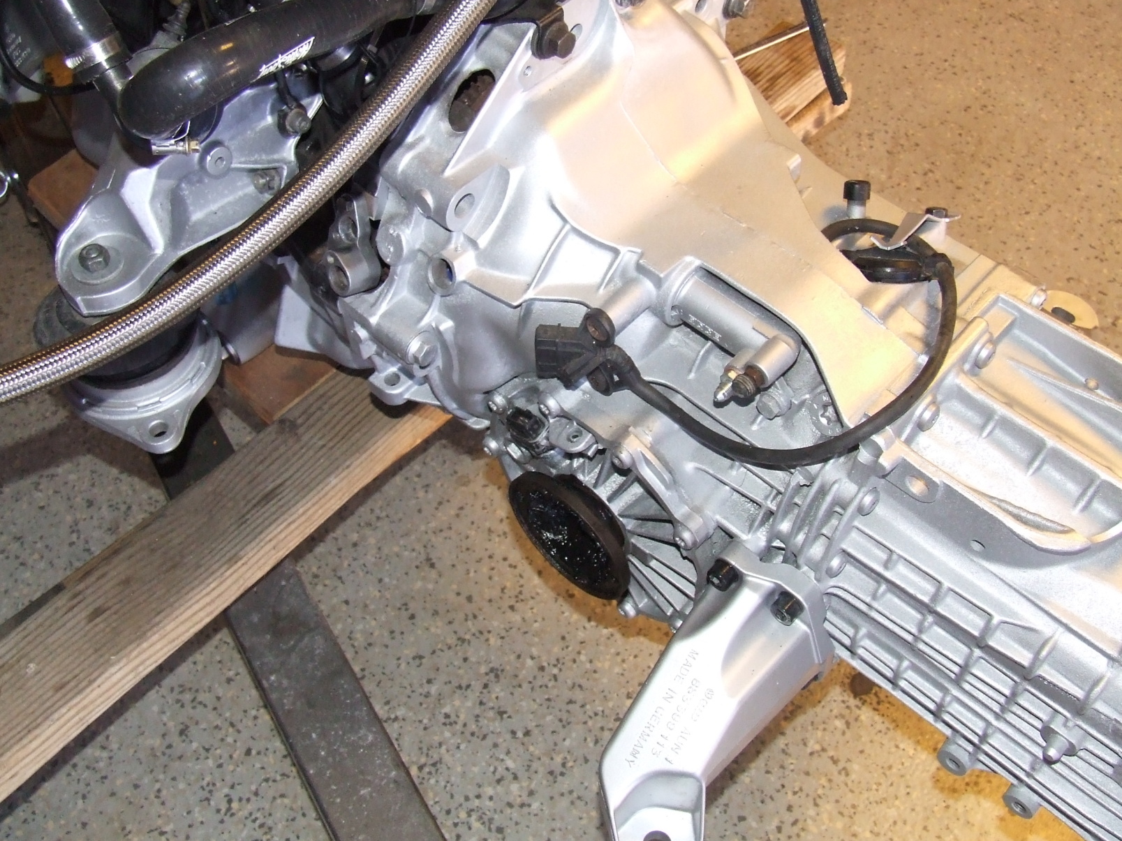

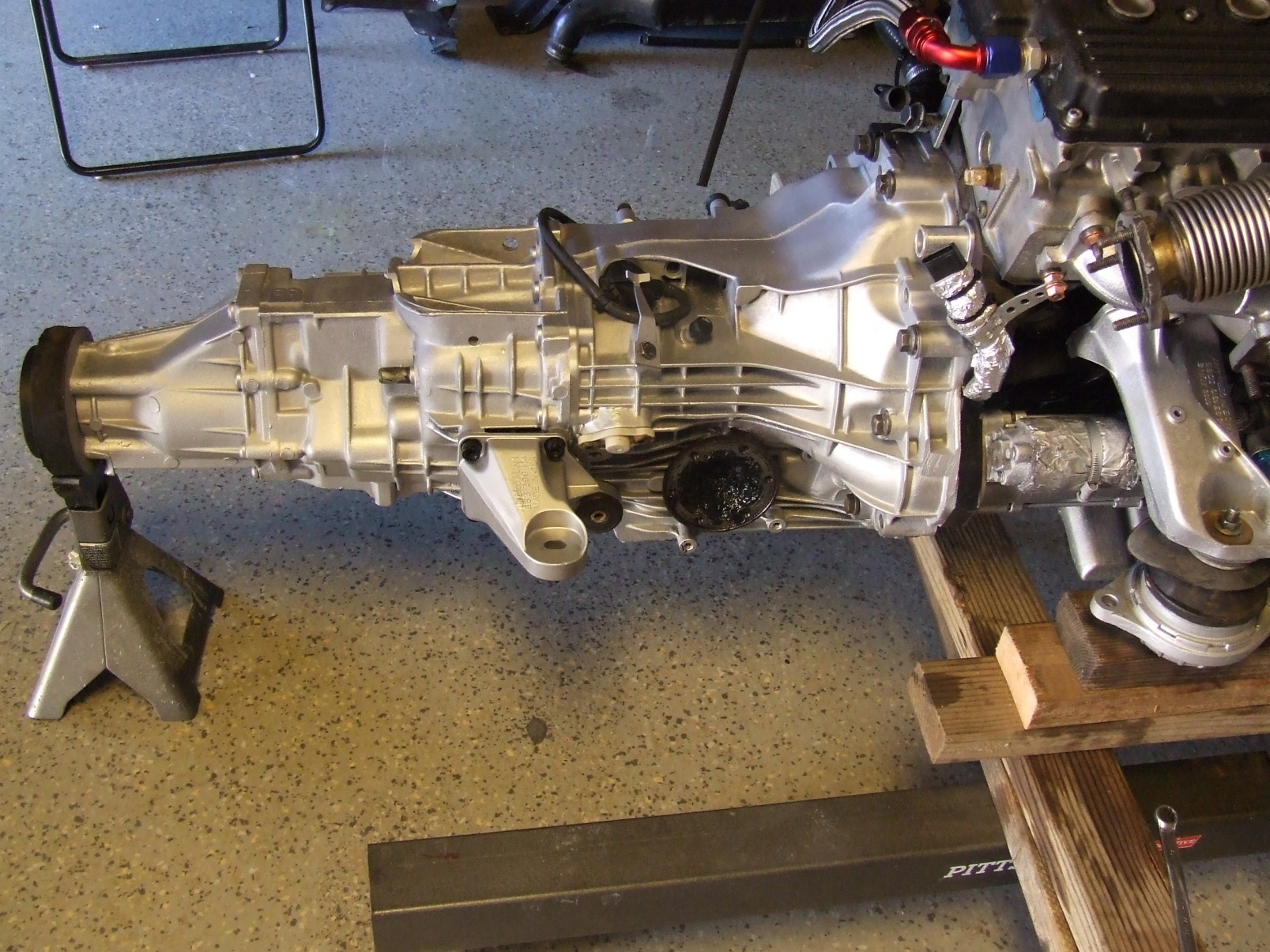

installed a new NTC IAT sensor, had to tap a tread
Cleaned and painted the tranny
Not much i could do....
¯\_(ツ)_/¯
Post by 90quattrocoupe »
I like the bracket for the crank sensor bracket. :D You might want to change the plastic zip tie out to stainless ones.

varia wrote:its a usa 1991 cq. the plate came with the taillight inner section
Cool, well you managed to get a 1991 'J' reg plate so it matches the year of build perfect! :-)
That's looking very spangily! How did you clean up the transmission? What product do you like to use?
Post by varia »
I cleaned it with soft scrub + 3m scotch brite; rinsed it, then let dry.
I used VHT cast aluminum caliper paint, nice coverage and super fast dry time, not too sensitive for oil residue
¯\_(ツ)_/¯
project 2226

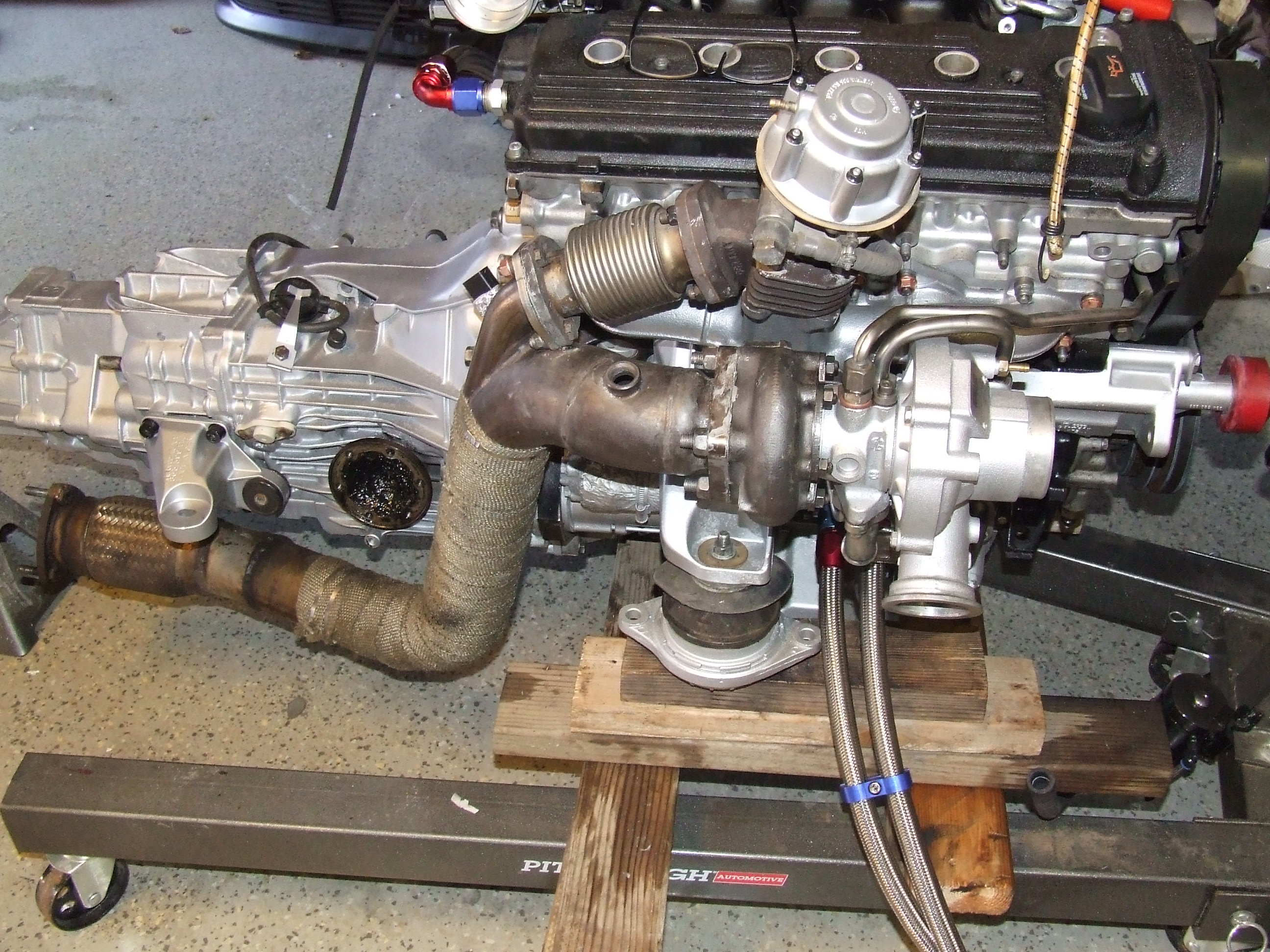

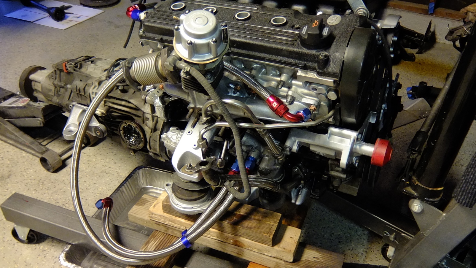

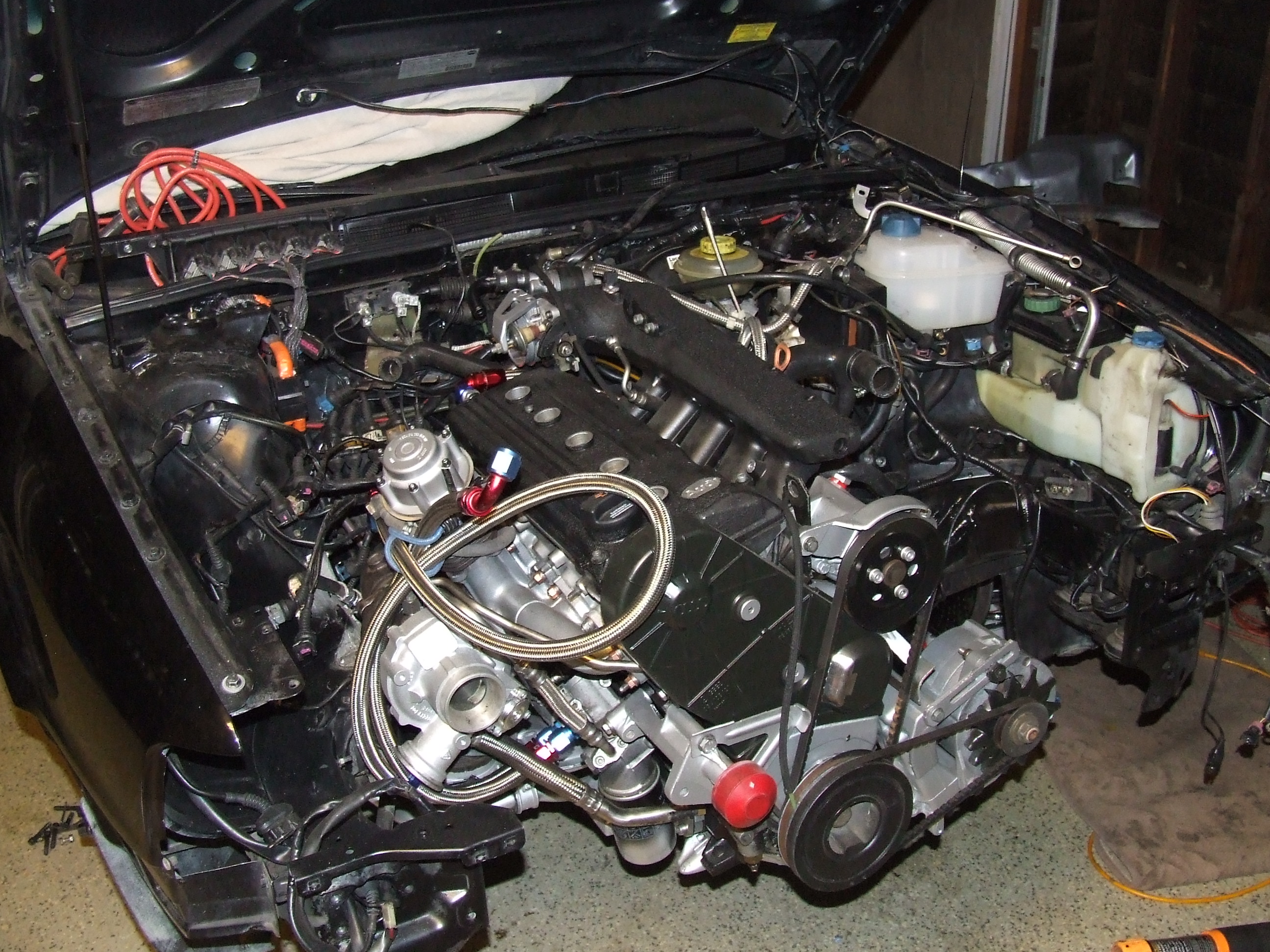

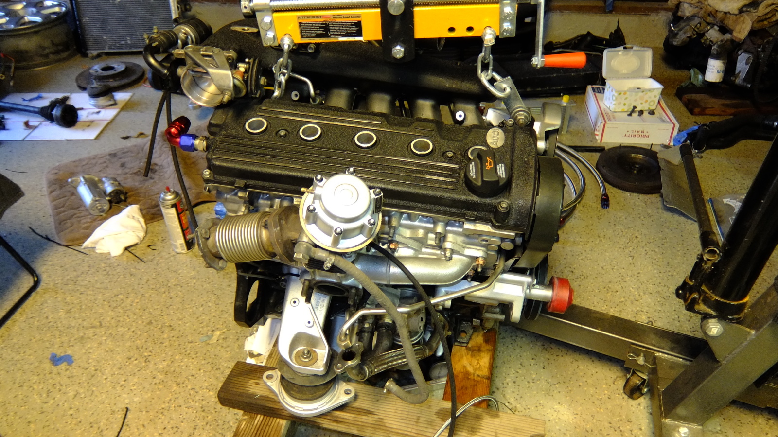

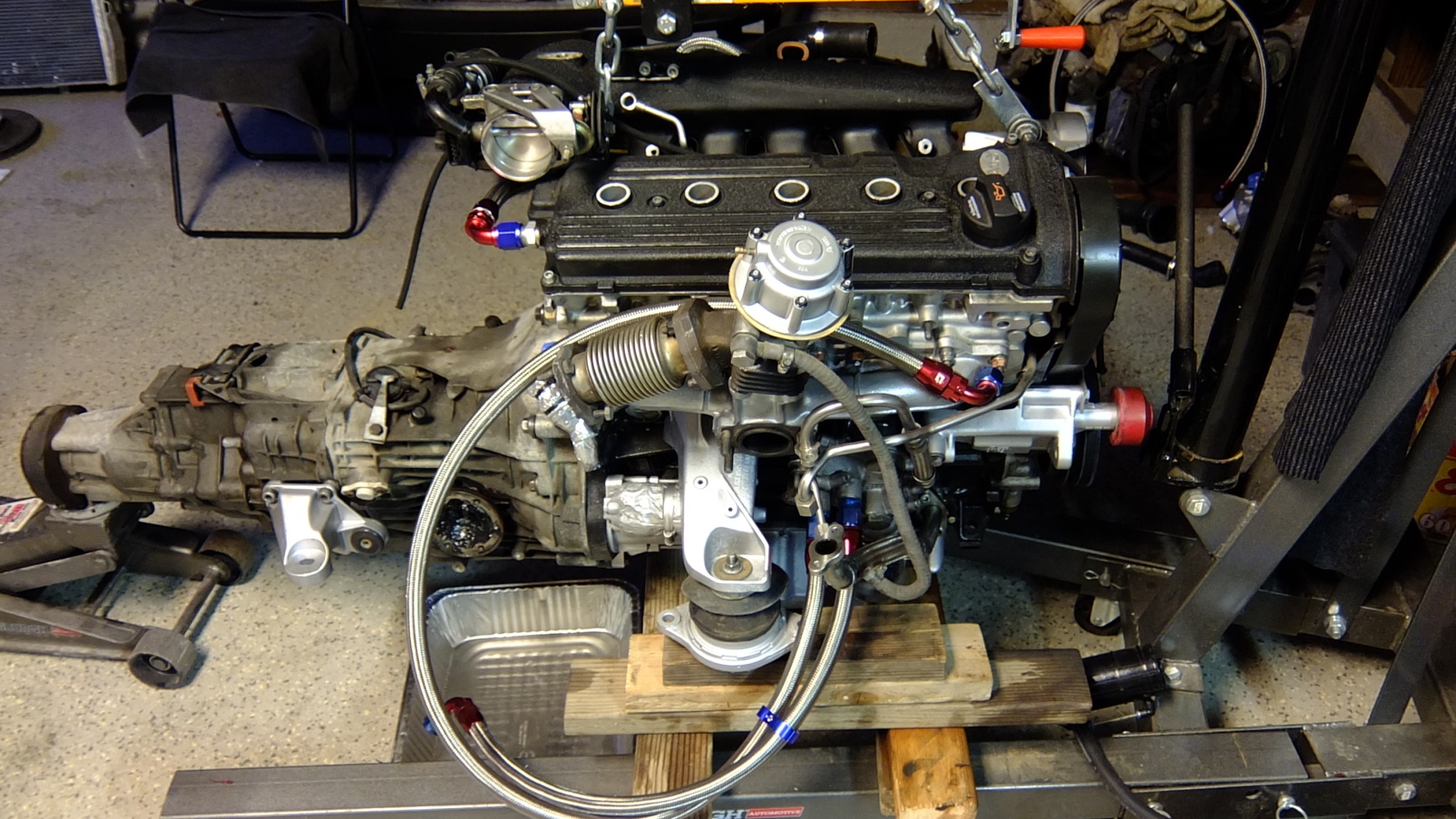

Turbo bolted on:
engine bolted on:
