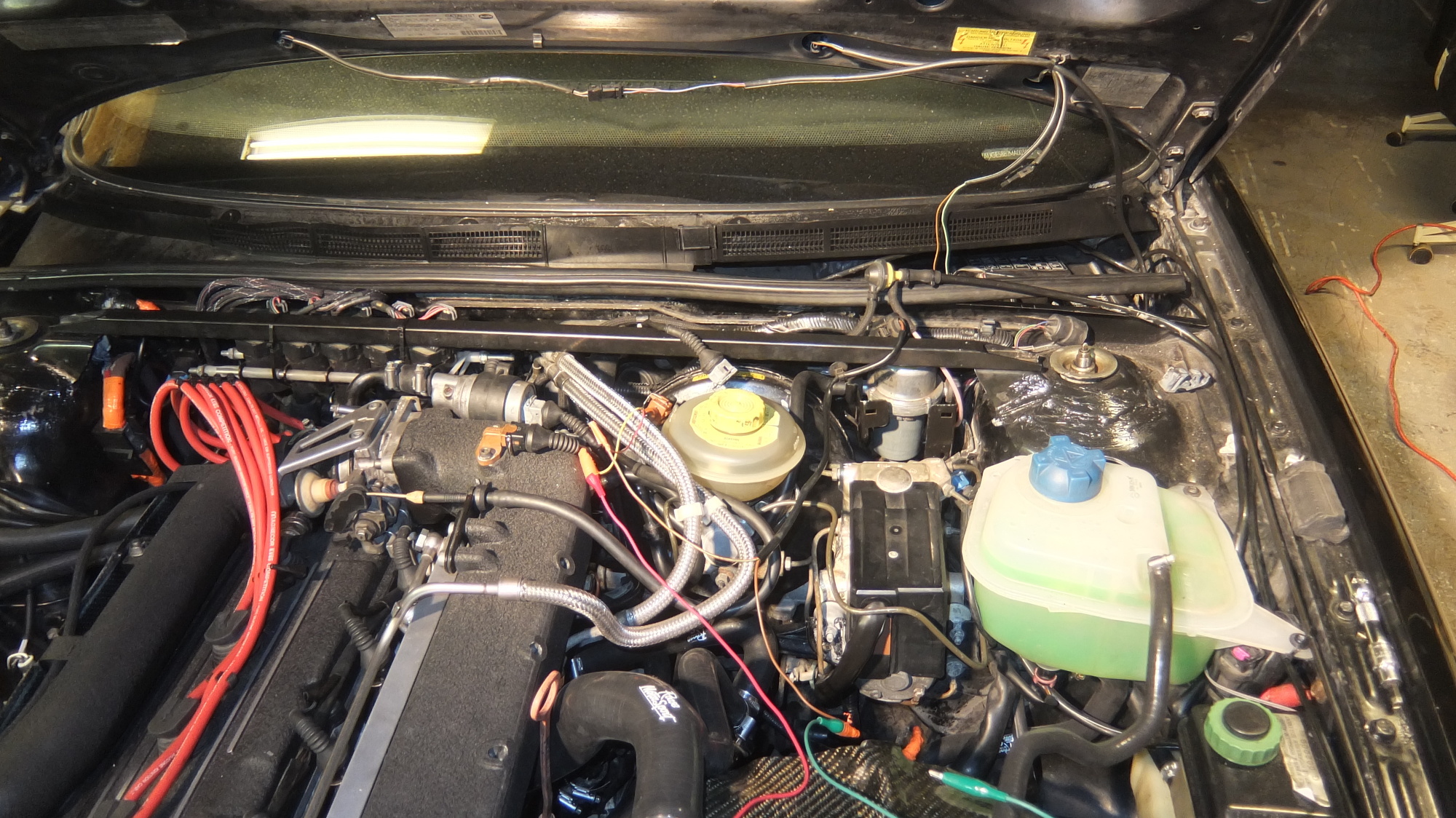

Still dealing with the vacuum booster leak (new is coming) but till i did a vacuum pump test setup.
Re: another S2 conversion
Posted: Sun Dec 07, 2014 5:44 pm
by varia
Huston, we have good vacuum booster, brakes are super!

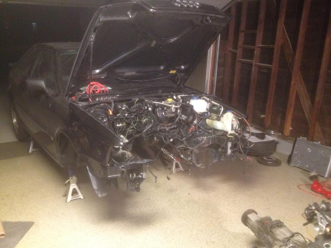

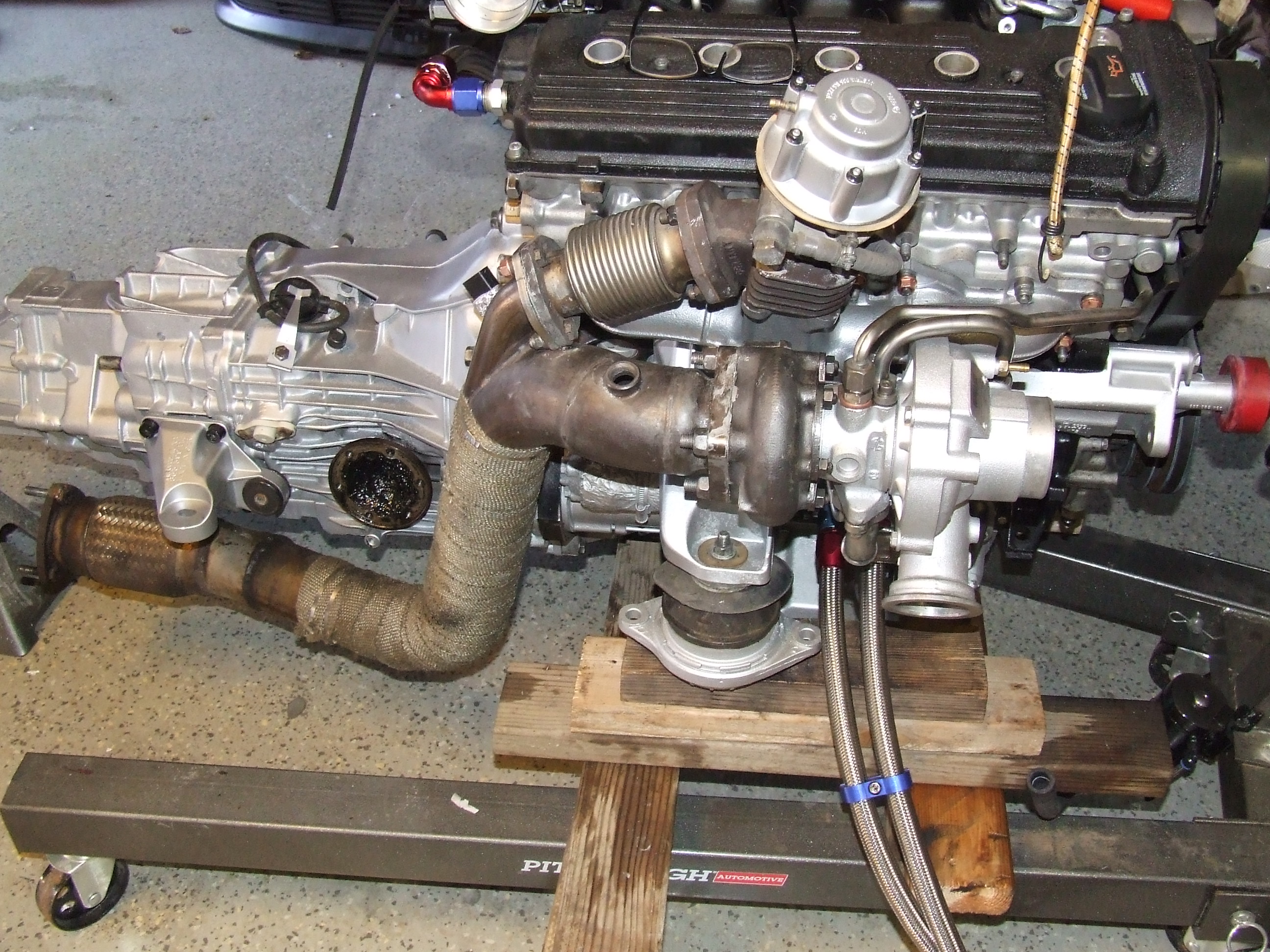

i pulled the engine out. now i can work on the exhaust/turbo swap and the crank seal/sensor
I have to really wrench on it, cos that guy, Dave he is really pushing it :D
unnamed (2).jpg (67.7 KiB) Viewed 39455 times

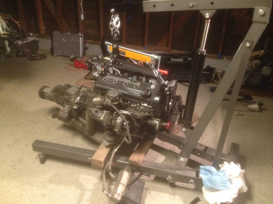

Made some progress:

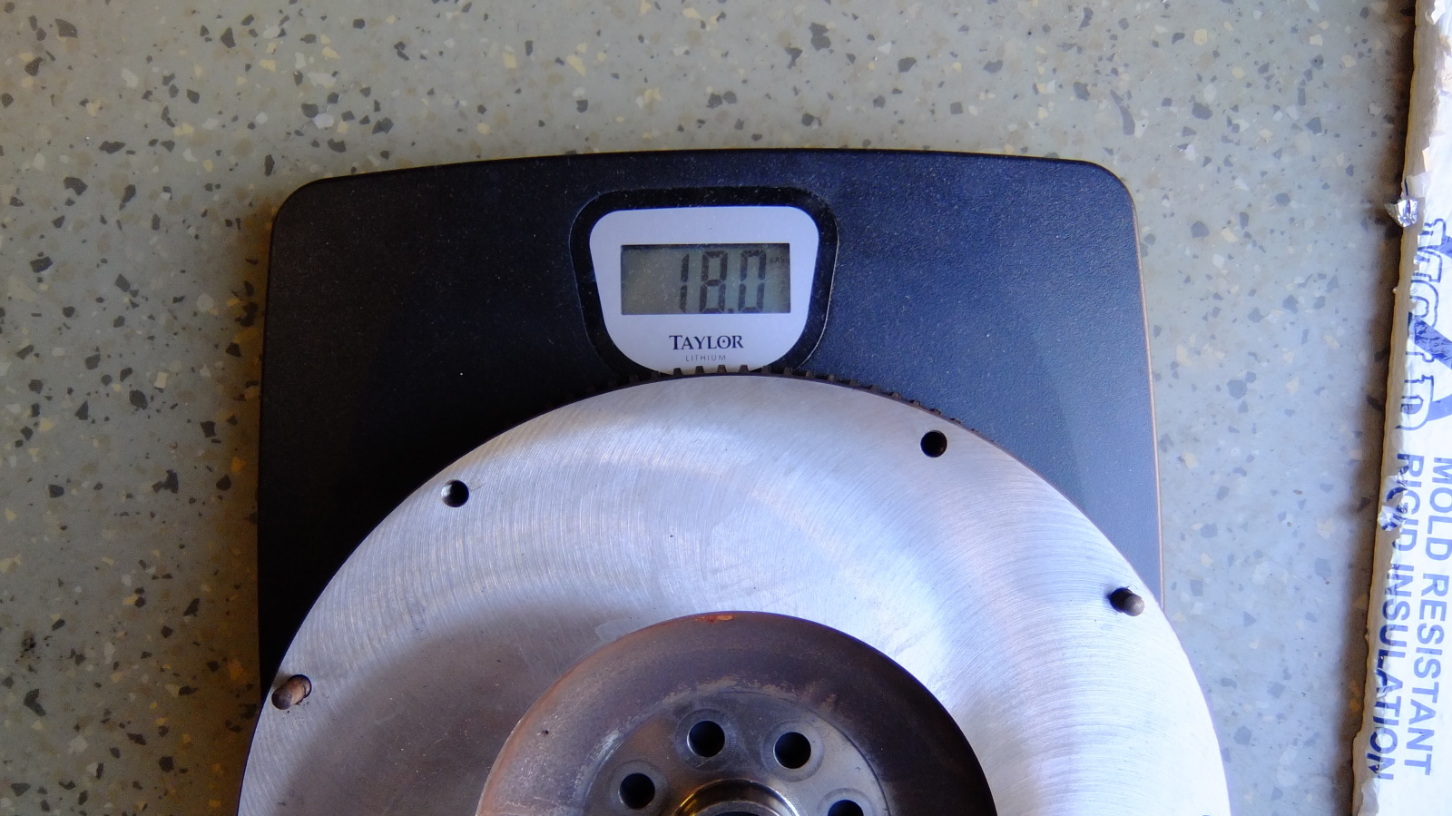

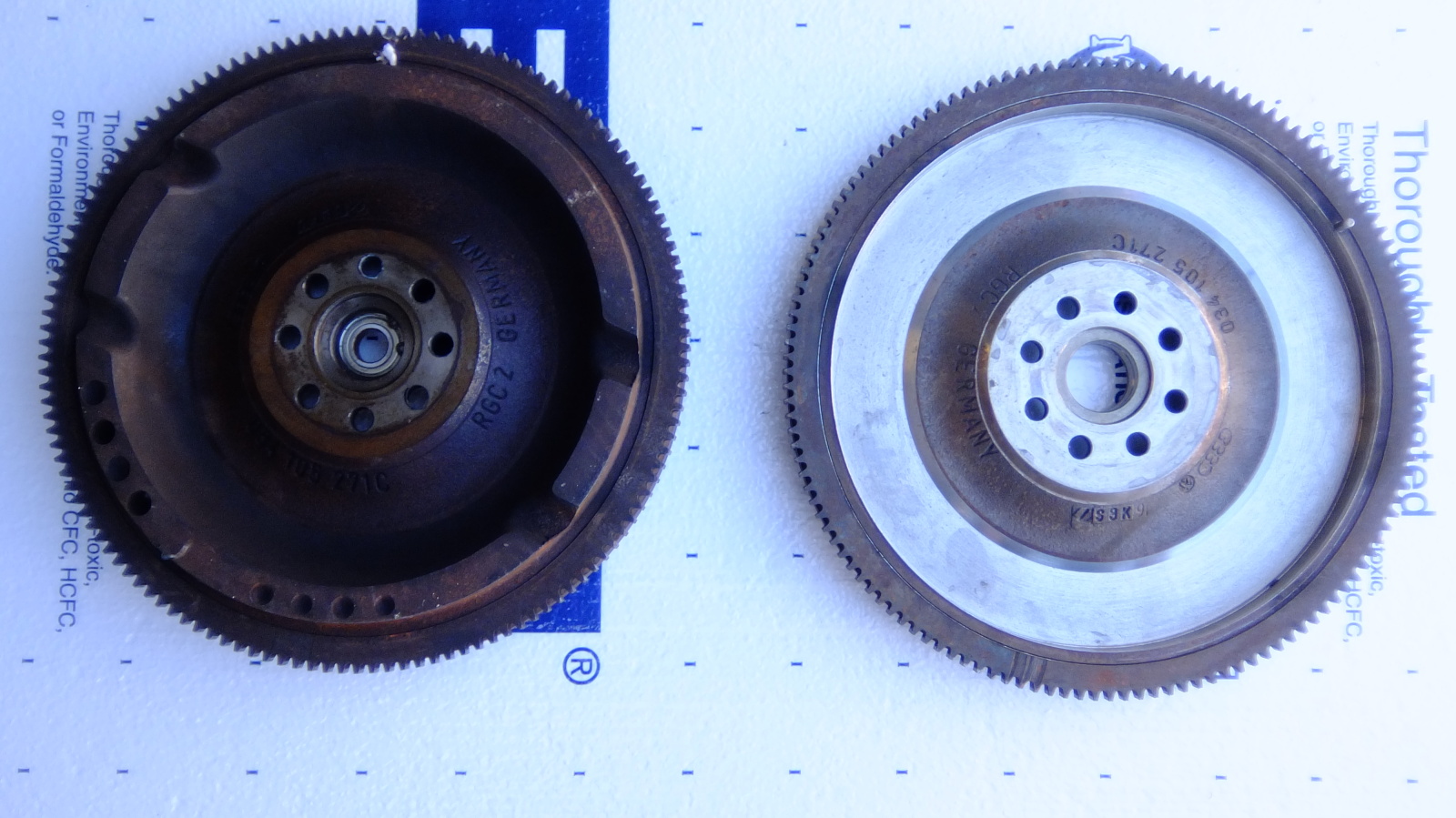

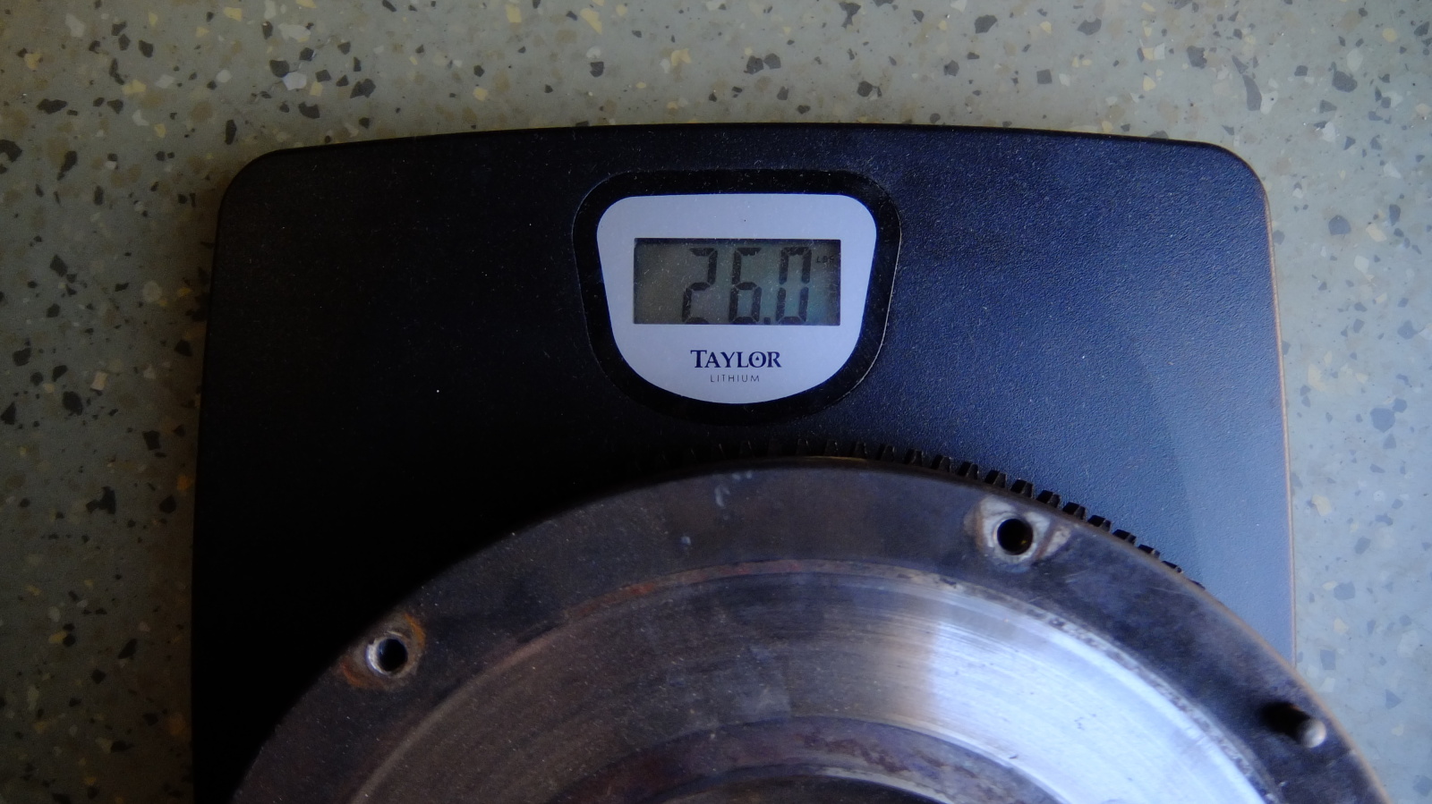

Got the flywheel back, it lost 8 lbs.
Not the biggest diet ive ever seen, but healthy enough for my setup
Re-surfaced, balanced.

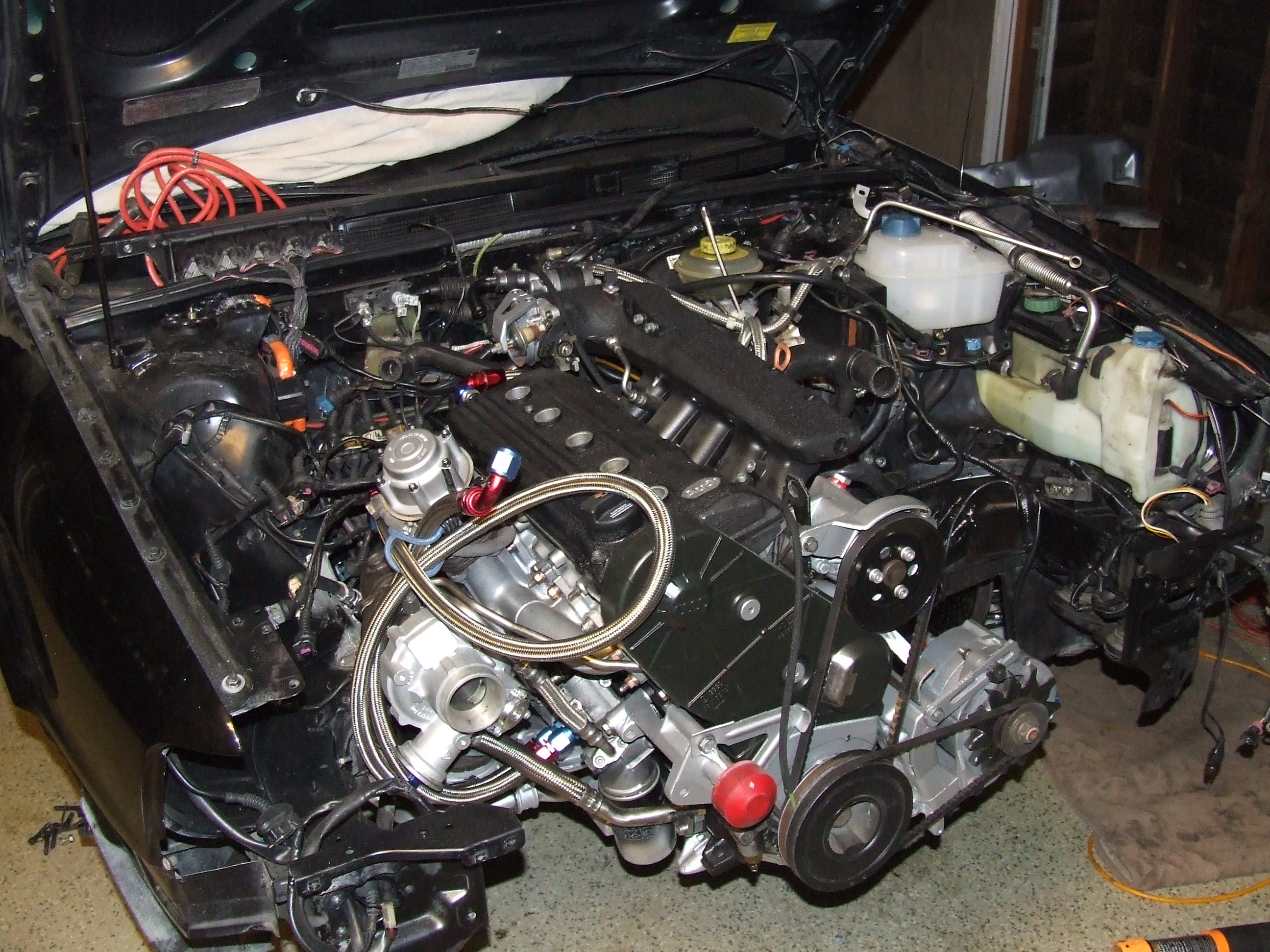

Posted: Wed Sep 09, 2015 1:34 am
by varia

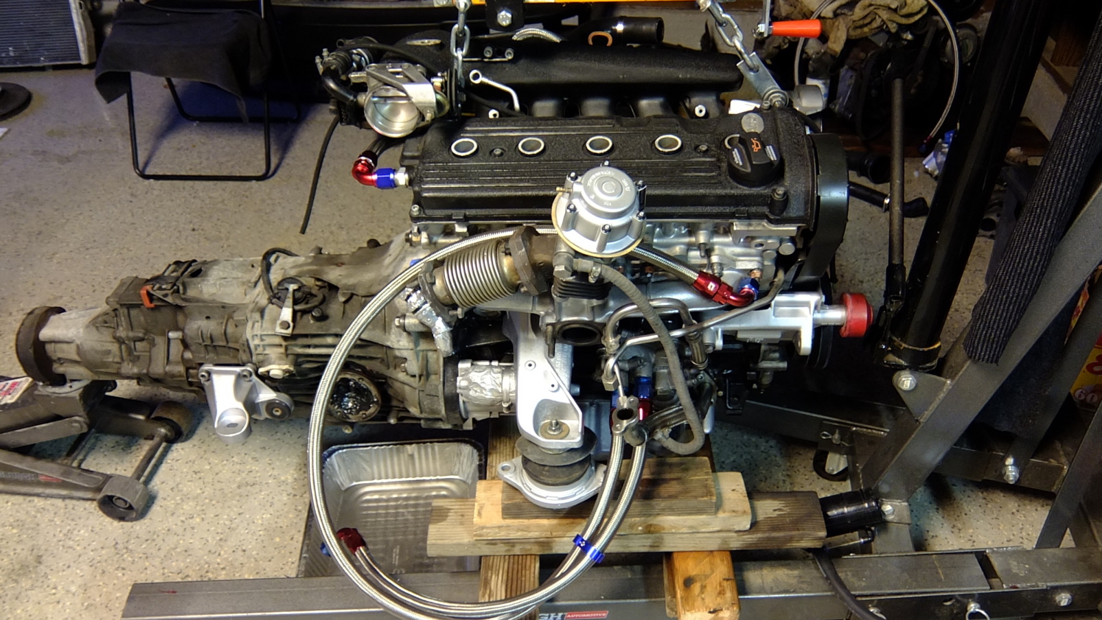

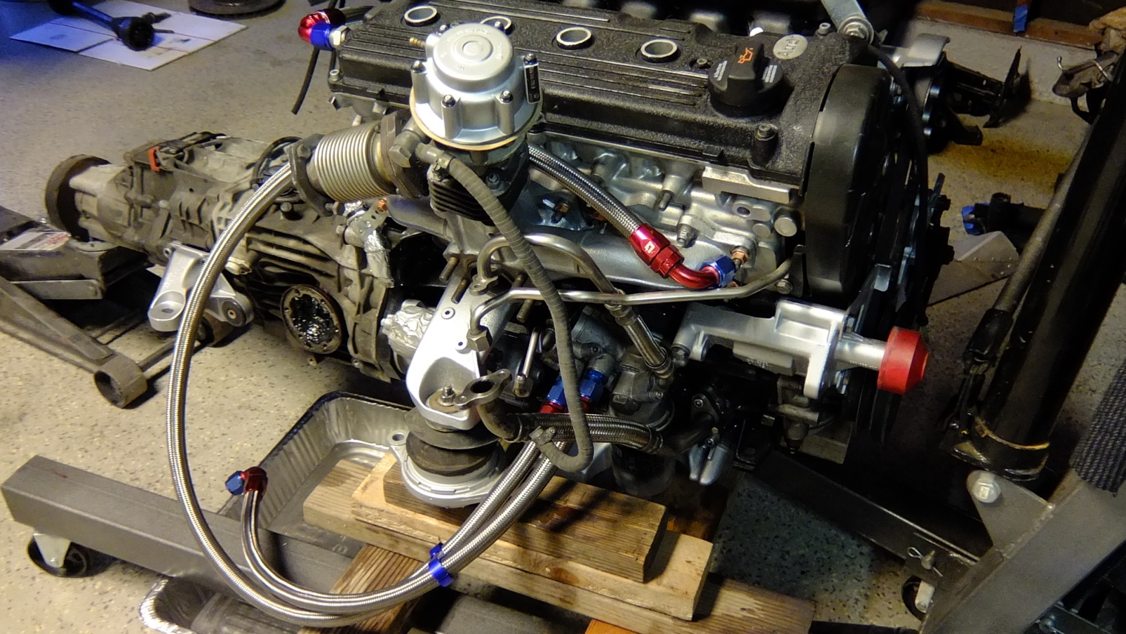

Turbo bolted on:
engine bolted on:
