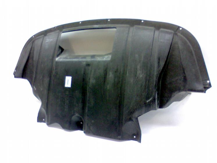

Here is a picture of an RS2 encapsulation panel. Notice the vent to help extract air out from behind the intercooler. Might work to move more air thru a front mount radiator. Looks to me that this would be doable on a B4 encapsulation panel with a little work.
HTH, Chris
RS2 lower encapsulation panel
RS2 lower encapsulation panel.jpg (29.14 KiB) Viewed 73063 times
Nulla tenaci invia est via
Re: Eric's V8 CQ
cuatrokoop wrote:Hey Ben, thanks, but I'm not sure how Greg got his belly pan to fit, unless that bumper is some sort of hybrid. It looks like S2/euro-B4V6 lighting and the chin, but the grilles look taller and no license plate area like on a genuine Euro bumper like the one I have. The trailing edge where the belly pan would sit is vastly different than both of the US B3 and B4 belly pans I've tried so I either need to source an S2 or make something. I can cut/plas/bend/break/drill/punch/weld at work...
He modified his bumper to be more square.
