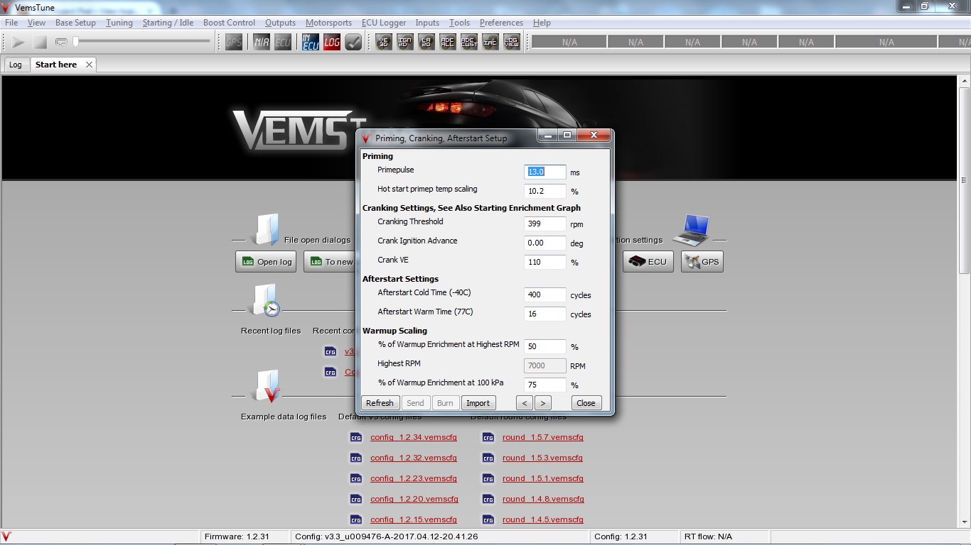

So, I'm working in VEMS trying to get this thing to start easier. I've decreased the cranking, afterstart and W/U enrichment curves, but it still starts hard and has to idle for a bit before you can rev it w/out almost stalling.
Before, with a stone-cold engine (& therefore coolant temp) I'd have to give it probably close to 90% throttle, then it would rev up to ~5k almost as soon as it caught, and puffed a big stinky fuel cloud (NOT oil smoke, I know the difference). As I said above, you'd then have to let it sit and idle for a few minutes to get coolant temps up.
I have not messed with the Priming/Cranking/Afterstart setup. I've attached a screenshot of that window. I can attach the curves as well, if that would be of benefit.
prime-crank-afterstart

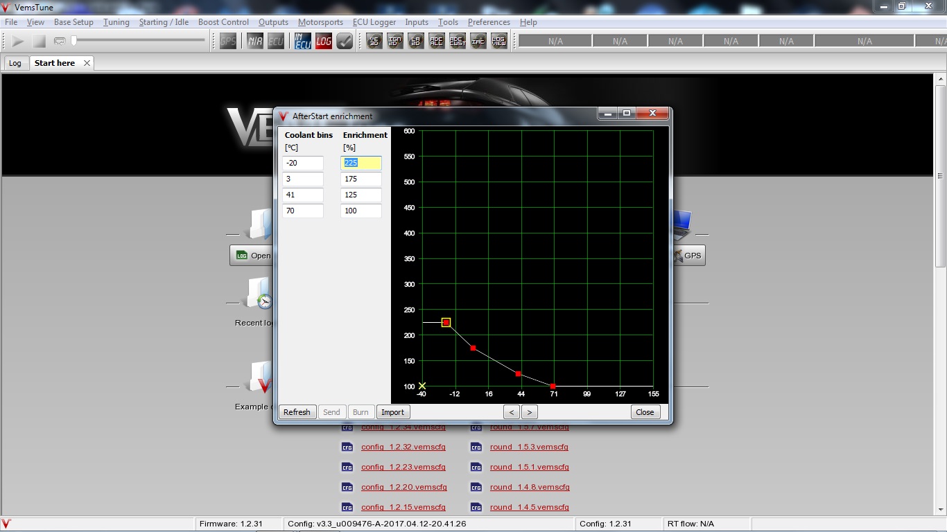

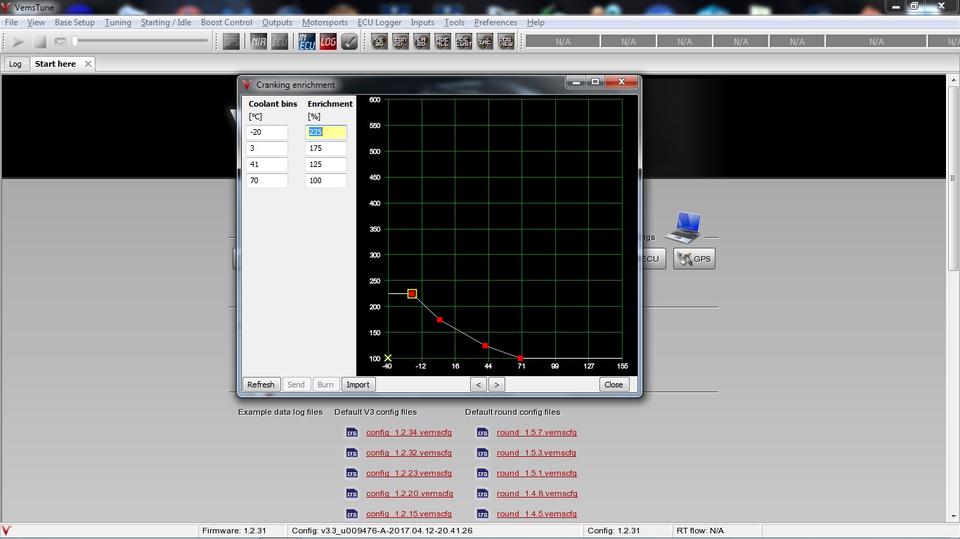

More screen grabs

after
after
afterstart enrich.jpg (176.72 KiB) Viewed 107968 times
crank
crank
crank enrich.jpg (169.61 KiB) Viewed 107968 times

So...no one had any suggestions...
Anyway, I found a couple of Nesbitt's files for his ABZ'd B4-90q (one from January 2017), and those screens are all vastly different than mine. I'm going to try some of his settings this weekend.

I got it to behave better, I didn't have to touch the throttle really at all when I left work today, but it still cranks for a while before it catches. I used some of Ben Nesbitt's numbers (namely those for the curves).

Starts soooo much better. Just need to figure out the longer crank time, but I haven't had to touch the throttle when starting since making the changes to the curves. I may lower the cranking RPM set point, it is at 399 right now. I think minimum is like 199. Lower may shorten the crank time, not sure.

399 is very high. When logging my abz with vagcom I was seeing 200-300 rpm on cranking, iirc.

Yeah, I think that is one of the reasons why it cranks so long before it tries to start, I'm going to set it for 199 (I think I read somewhere that there is a bug in one version that causes 199 to be 299) and see how it goes.
