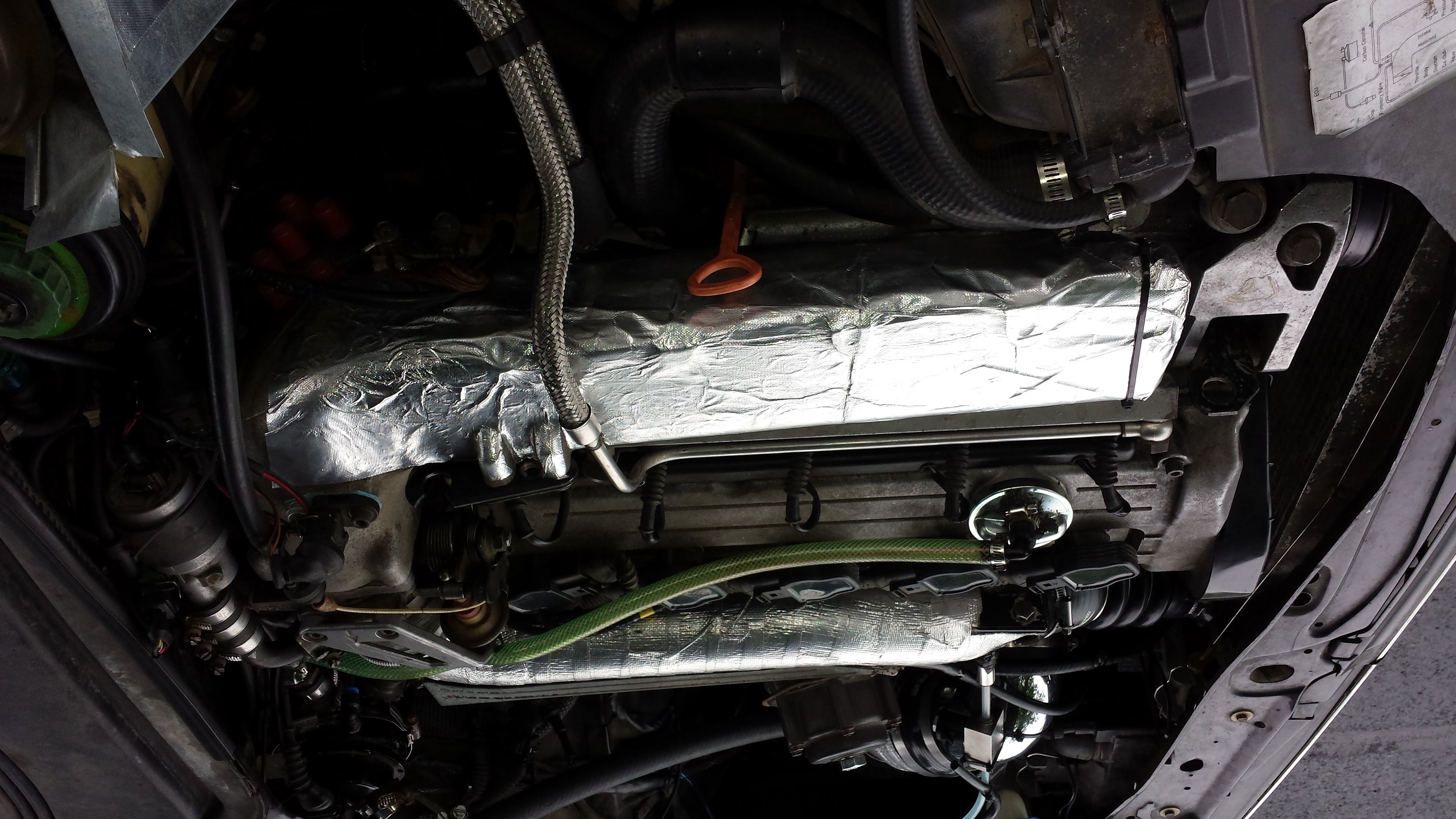

I bought a sheet of DEI reflect a-cool silver to put over the hottest area of the cyl #1-3 IM areas. In the winter I had frost (from w/m) on cylinder 5 of it by the IAT sensor lol. Always made me smile when opening the hood. The DEI isn't insulated but only reflective in nature which I believe us the best approach for the manifold. Still waiting for my free 034 BPV seals that shipped 8 days ago
I went partial retard on the IM after work. Enjoy a laugh
Should block radiant heat from the coolant manifold. I think I should've used the same material when I wrapped the pre-throttle body pipe as well. *not a show car*

Coolant gauge reading is staying below half range. I think the IM was acting as a huge heat sink. I'll check that out chris!
So far WOW. Gonna redo the other pipe too
Nice! If you really want to get serious with it you could get a phenolic spacer too. It really does help keep the IM cool.
