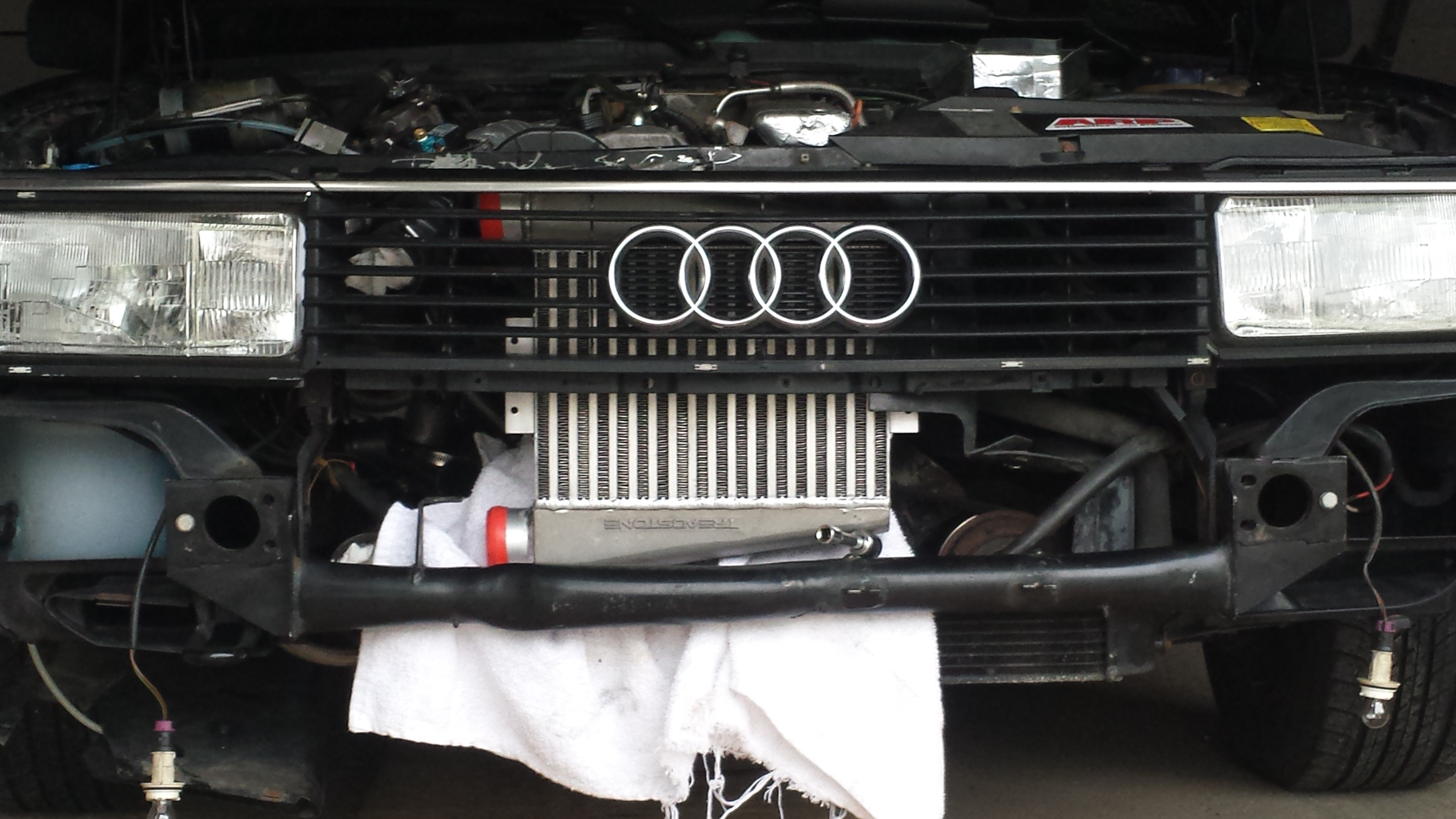

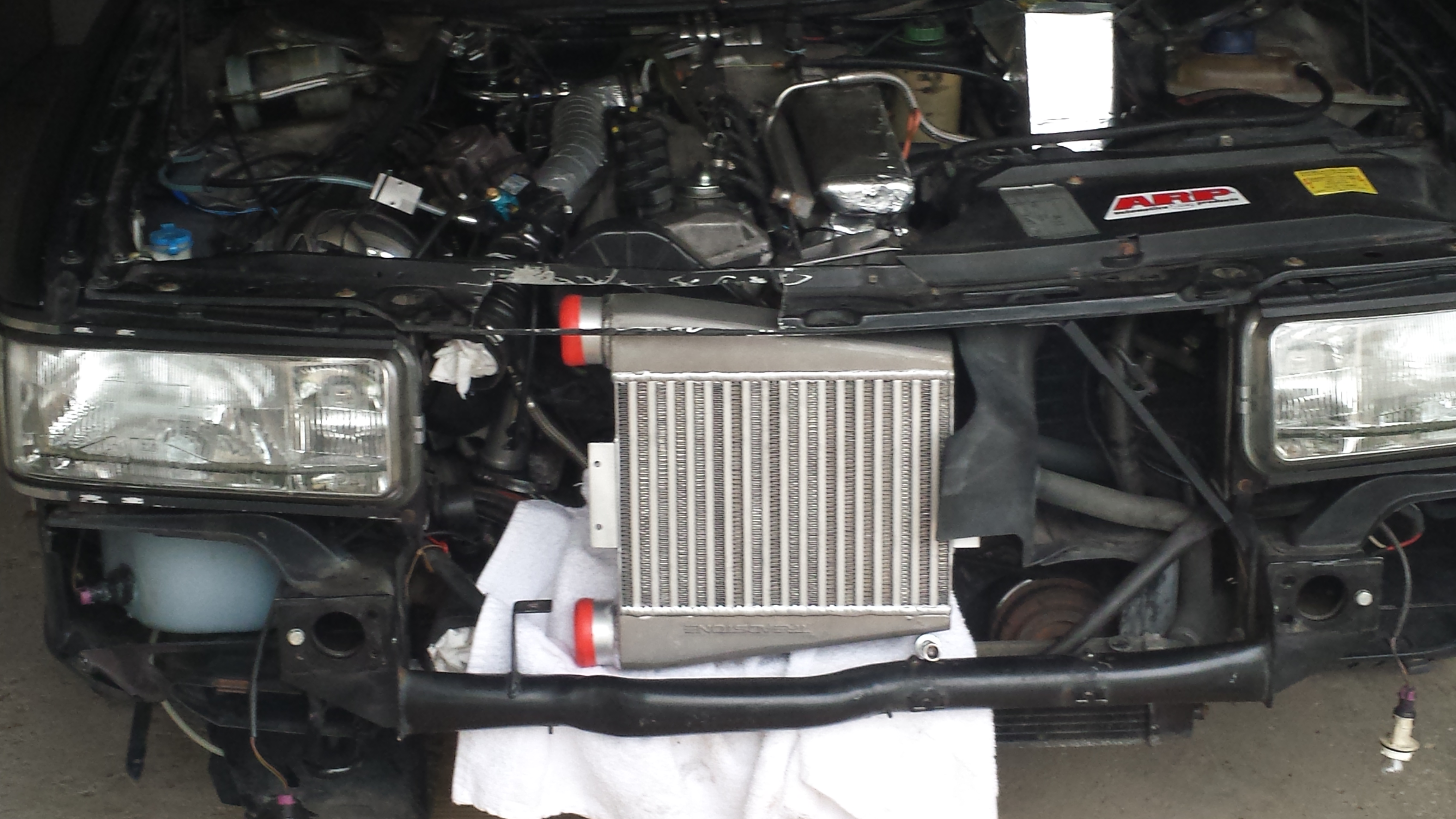

It's not bad tho. Had to cut off the snub mount lol. I need to rethink the snub mount in general and left some meat on it so I can still anchor it somehow. Been trimming extraneous shit off the OE crossmember and I'm just gonna flip it upside down and reuse it

Definitely cut the bumper if you don't care about it.
What did you have to modify? You should only have to flip the crossmember around to get it to fit. My much wider core only required that, although I've never run a snub mount on that car. It's not needed.

I cut off the snub mount bracket for cleanliness and the wide end tanks made it so I had to cut away part of the cross piece that the hood release stuff mounts too. In the previous shots, the IC is actually a couple inches lower that it will be in the end

I'm pretty sure my core is the same height as yours because its a 9" core with probably the same height end tanks... It fits, but BARELY. Then again, yours gets to it's full height in a different location than mine does. Mine is at full height by the hood latch.

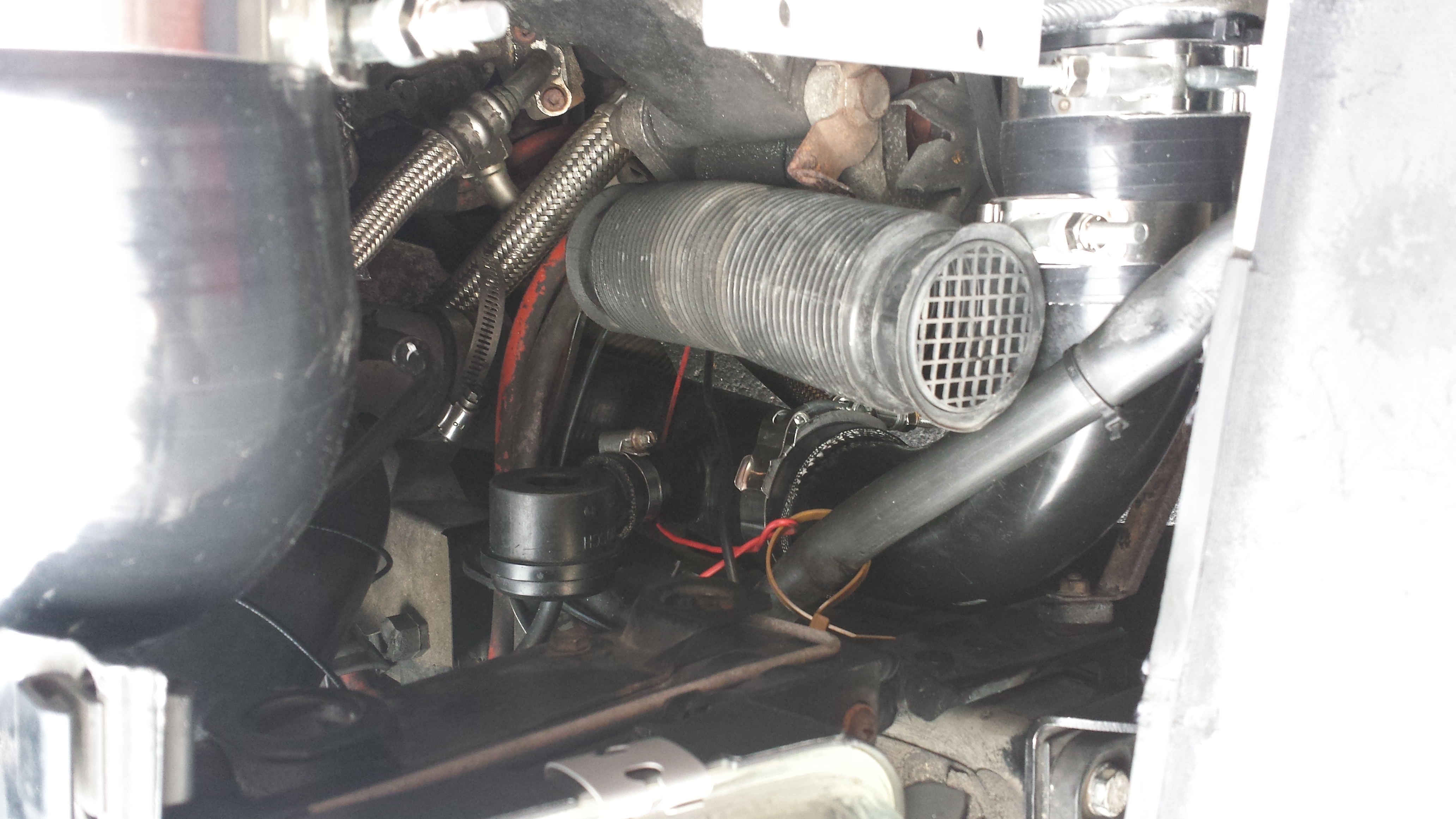

It's in and plumbed. I drove 3 blocks away to park and get food. Drove home and felt the bottom end tank that's basically touching the aux rad. It was heating up from the rad for sure. Admit defeat or forget about it lol? I'm sure the very few if any that are looking at this are saying "always something!"
Wait. What?
Aux rad?
Dude... get rid of that ish. Pronto!
Aux rad?
I never thought about that on mine. I wouldn't worry too much about it but I kept mine because I lived in FL at the time. Not really needed up north I guess.

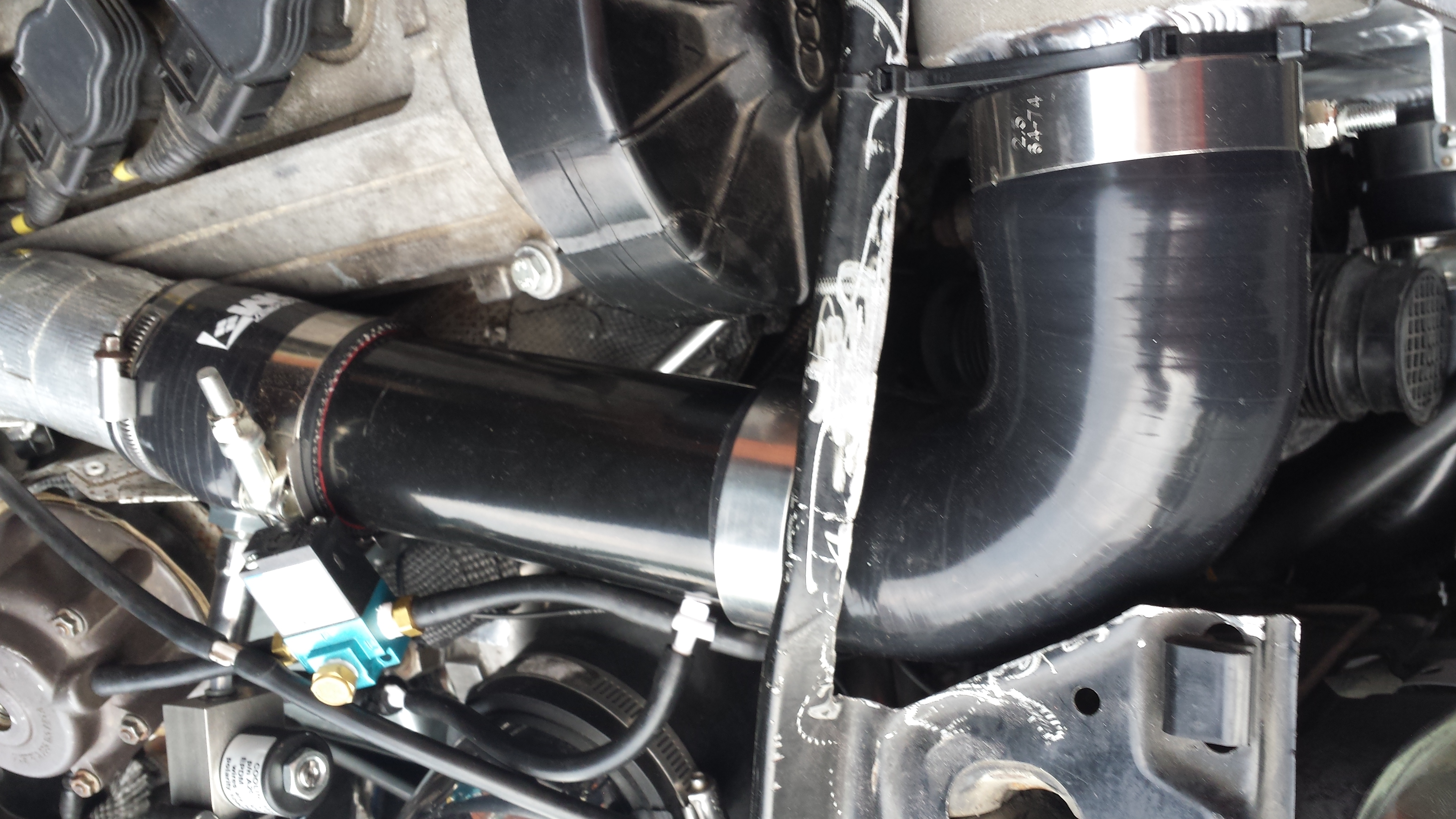

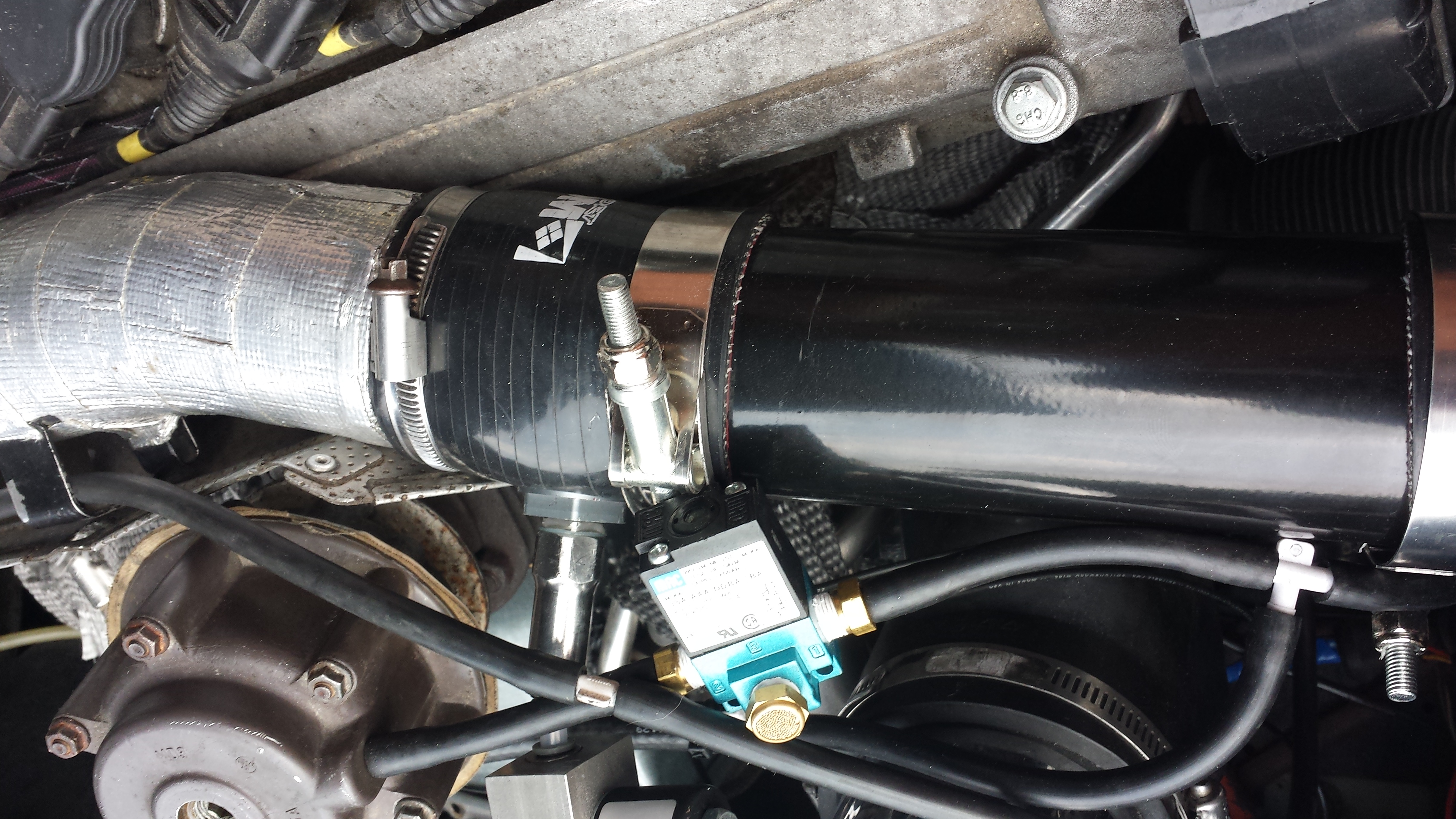

No more turbulent michelin man hose

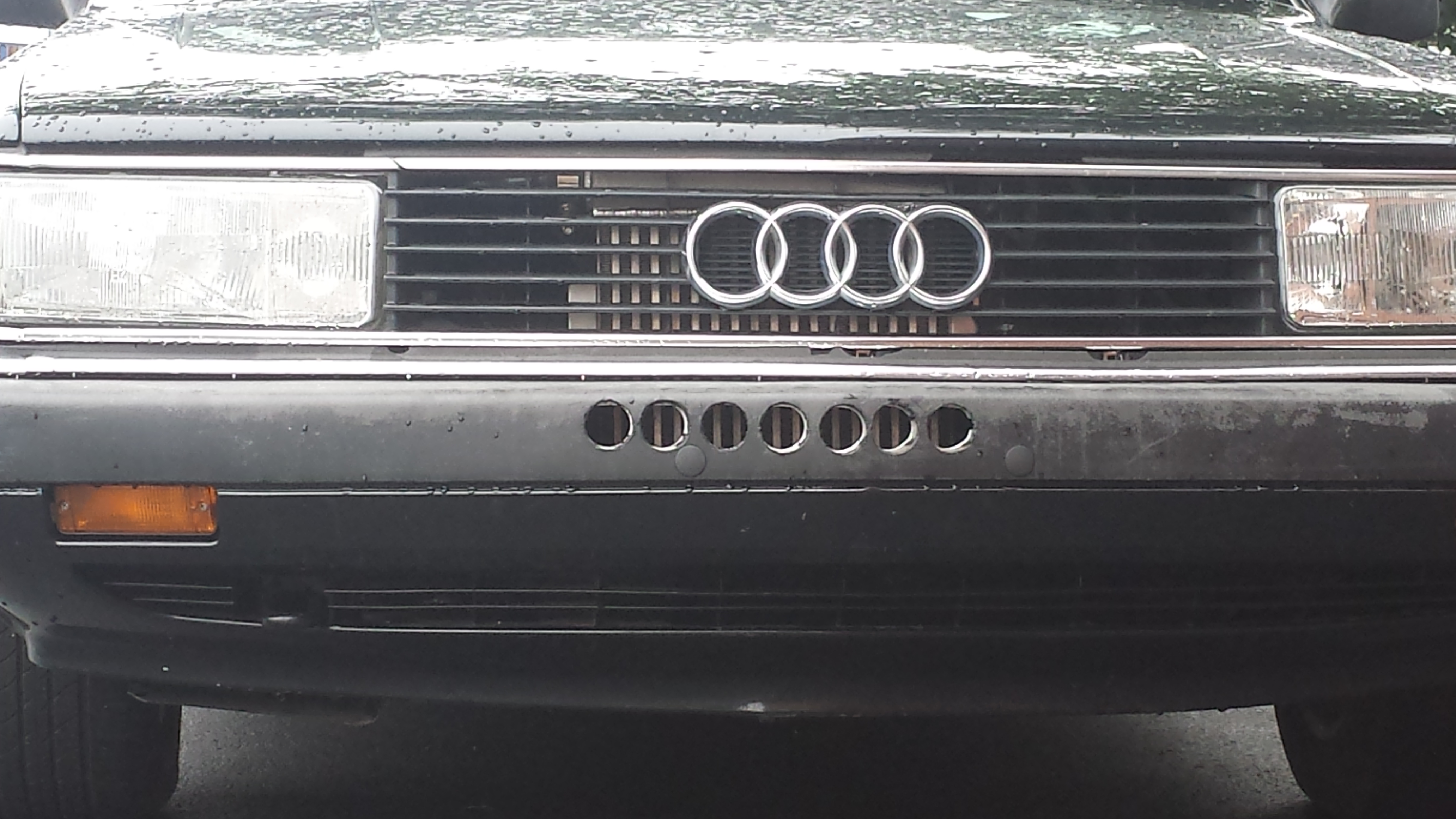

Turned out incredibly stealth ( well except for the giant holes in the bumper). Nice and cool to the touch in 85 F weather
