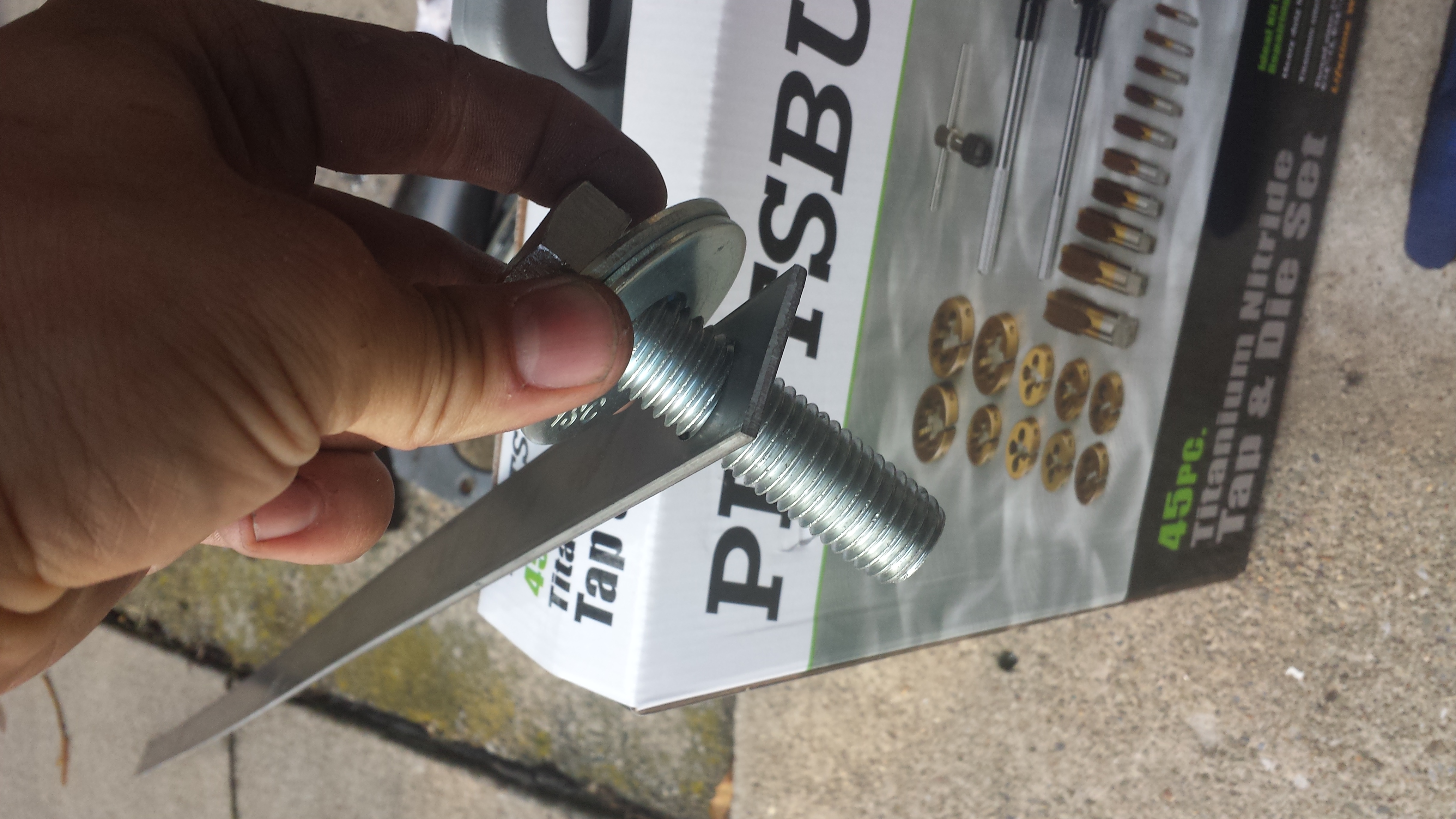

I got all the stuff together to hopefully accomplish this ghetto snub linkage. Got the the 3/4-10 tap courtesy of the harbor freight rental program :D got all the hardware at home Depot including a 1/2" bolt of 6" length that will go through the cross member and run under the IC and just above the now-lowered aux rad. Hoping to get mostly done tonight

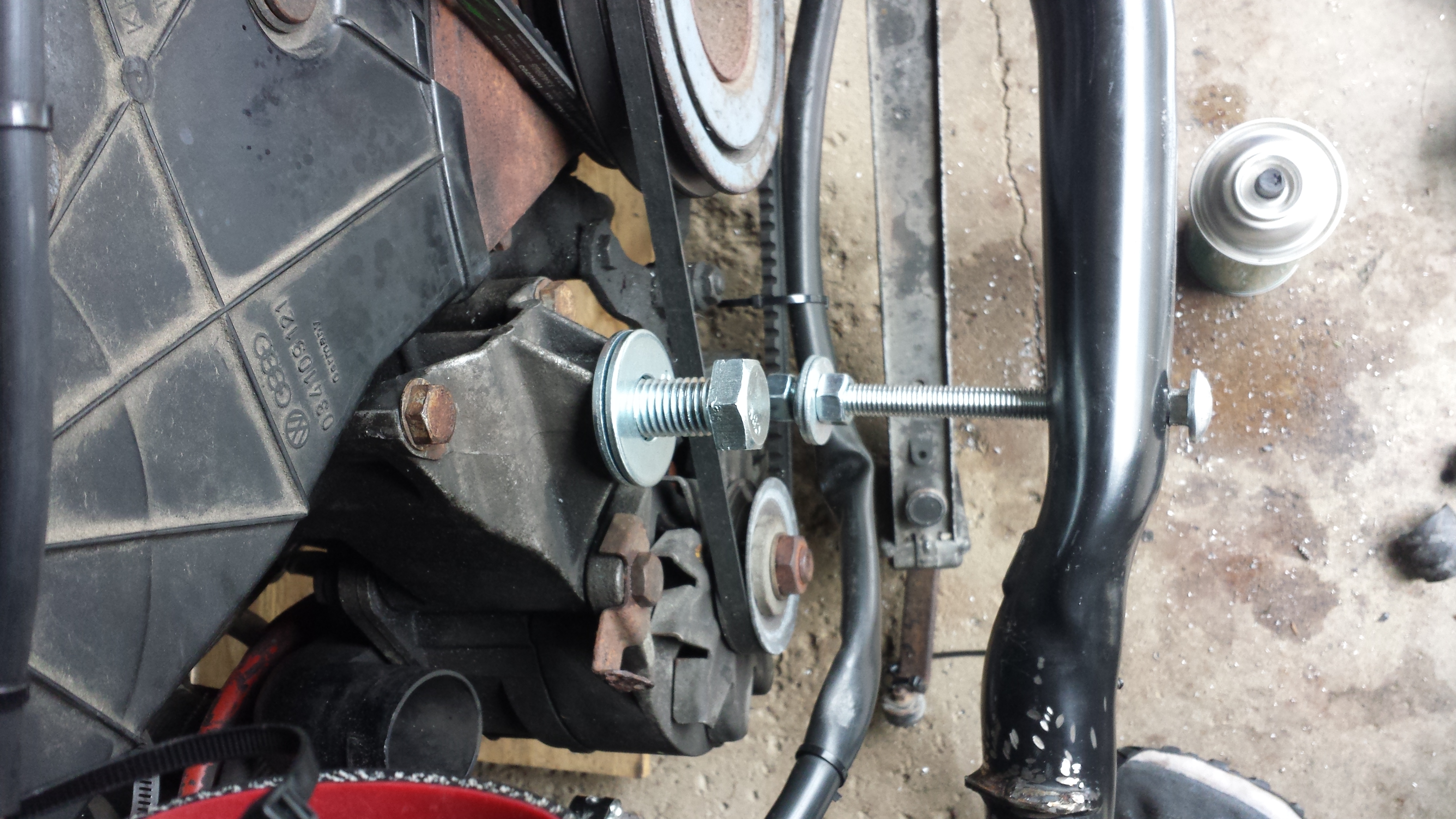

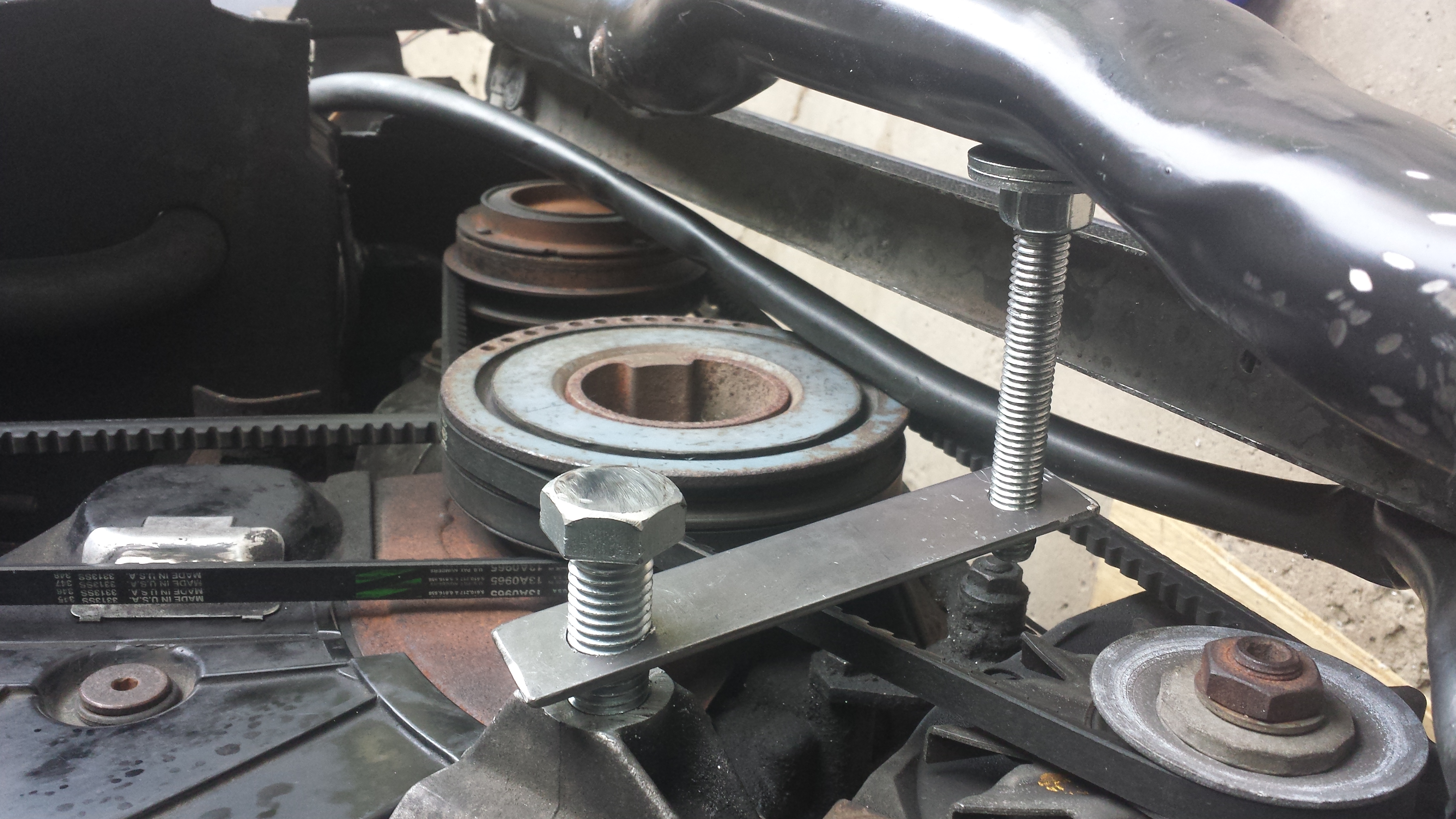

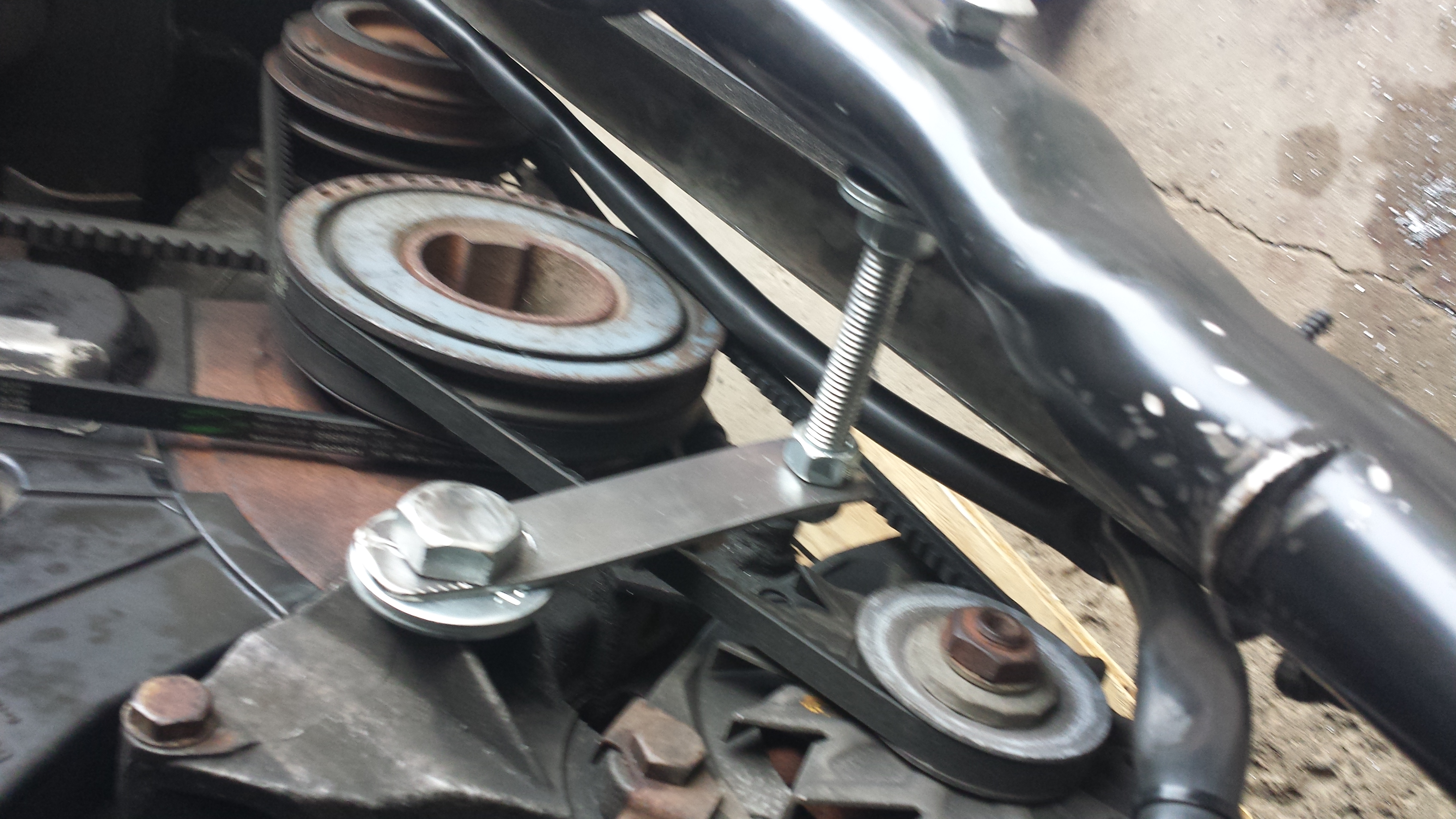

It's starting to take shape
Another.
Do you naw mean now? :)
Thick ass steel "link"
Nearly done
Finito

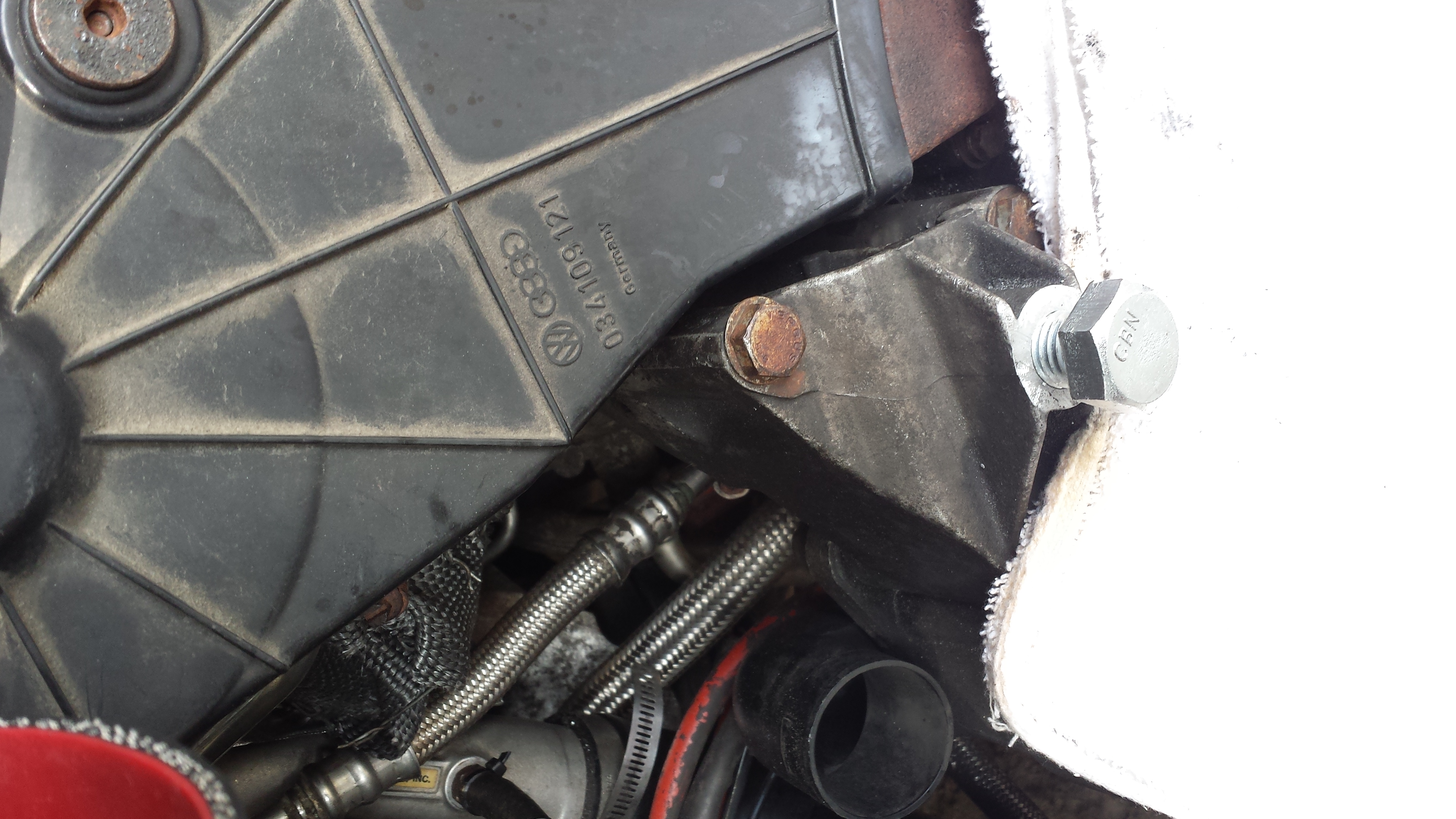

Thoughts :idunno:

From an engineering at any point, you should never put a bolt in shear, but those are thick enough that from a redneck standpoint, it'll work just fine! Of course, you're only stopping movement in the up direction, but that's probably what's needed most anyway.
Lol I suppose I mispoke when I said ghetto. Thanks for the compliment. Car drives GREAT with that mount solidified. I was concerned about shear and tearout for the bolts and sheet metal and that was the reason. I didn't use the thinner sheets I had leftover as well as the much thicker bolts. The 1/2" bolt might even give enough elastically to take some of the shock out of the worst of scenarios.

No issues during the drive yesterday and the IC has just enough room behind it to prevent contacting the 3/4" bolt's head. Wasn't even any new vibrations!

Sleeved the 1/2" bolt through the crossmember for her pleasure
Thanks for the advice Dave
Glad to hear that. I would hate to see the bolt rip through the cross member.
Threads can be vicious in metal/metal environments :)
my biggest fear was it actually failing and throwing my bolt and that sheet metal around violently and punching a hole in the new IC and maybe even being as bad as destroying belts. God forbid it take down the timing one. Solved!

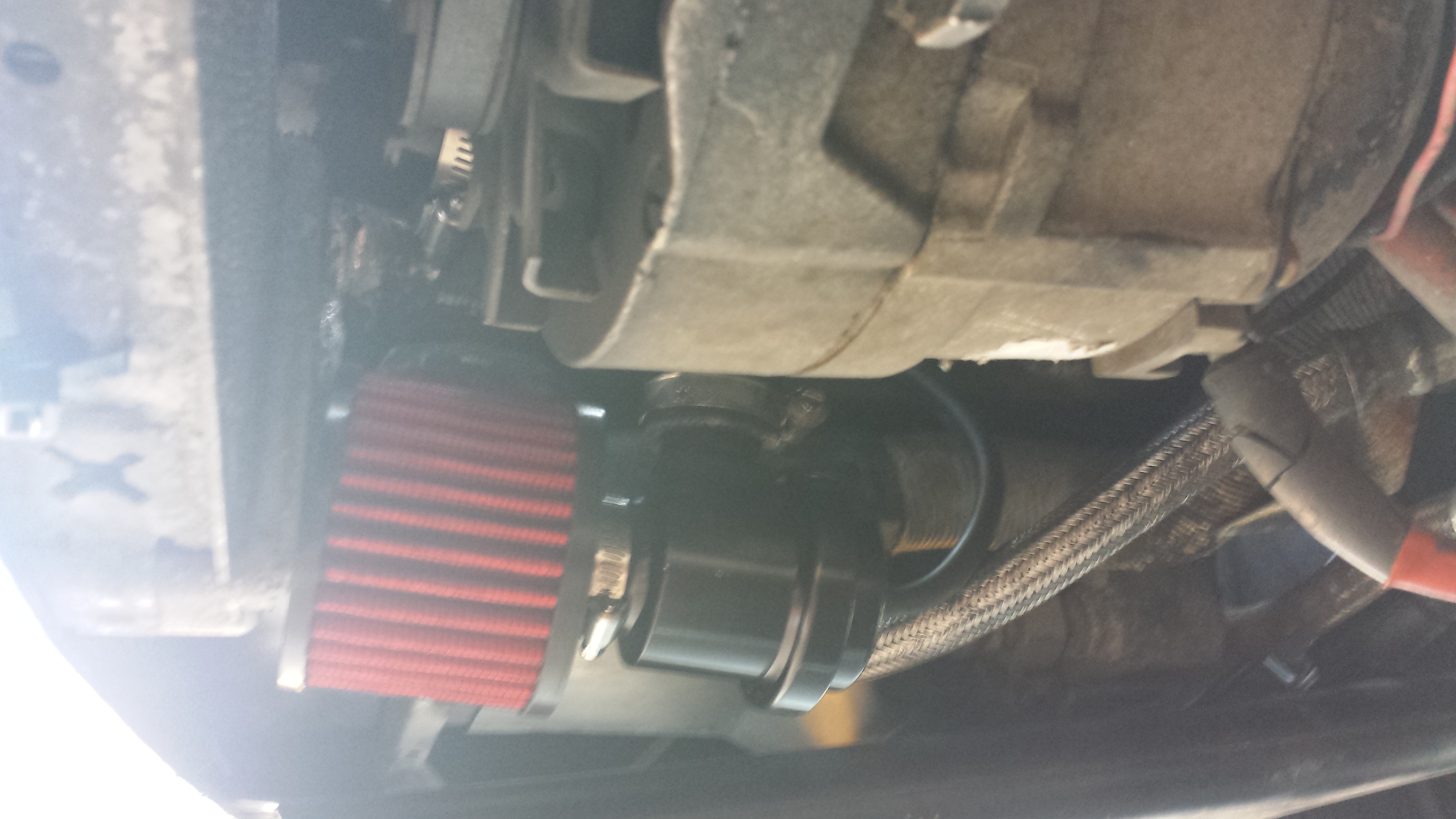

I ordered this large k&n to put on the vented BPV to save my motor when off throttle. Anyone seen a check valve large enough to prevent unfiltered air from entering at the BPV?

Note that the filter does not interfere with anything and there's no contact. Seemed good after a long drive yesterday. Even went back to the 034 BPV
Just don't go thru any puddles!
Oh ya I'd say you're right. I was thinking about shielding it but it's already so wimpy sounding with the filter on there! No comparison to pre-filter. It was pretty intense before and I dare say it was louder than any of the BOV's that were SUPPOSED to be loud enough to scare people. Sounded like an industrial accident unleashing right next to your head before.
This might seem odd (like alot of my thought patterns) but I'm considering trying this to completely eliminate the possibility of air being sucked in to the BPV when at high rpm/off-throttle. I saw a research website linked too from an mr2 forum IIRC that said air being sucked in was a very real problem. I just don't like the muffled sound it's making now.
