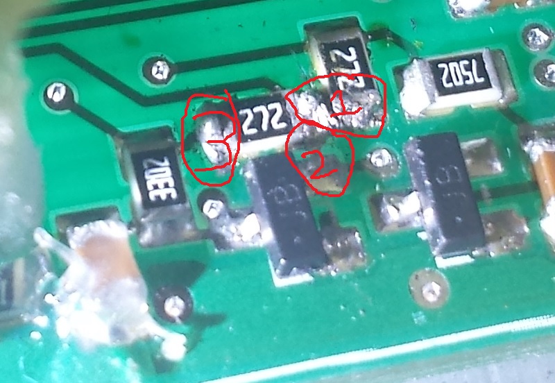

My Iat sensor reading SHOT to 150 C and settled down to 79 - 83 C quite suddenly while on a 15 minute drive... maybe I need to warm up the IAT sensor resistor sauder joints?
Thanks tho dave. I always thought it was in the # rating of the springs that would prevent roll.
EDIT: after parking and starting/driving again, the temp ranges between 60 and 130 C. I'm gonna warm the R joints shortly here...
The fluctuations are pretty quick too
I'm beginning to think it's this knock off sensor. Disconnecting yields a reading of -40 C and connecting reads 82 to 154 C!
Riiiight so I don't want to mess around with failing sensors any longer so I bought one locally for a exorbitant price (~$72) with a lifetime warranty. I bet the meth injection somehow kills it off more quickly. I should also mention that I cleaned the sensor and tested it again only to see the same impossible temps fed back.
Not sensor I guess lol. Gonna warm the sauder joints
anybody have any insight concerning the following picture and questions. Below is the IAT circuit section that needs modified for using the 1.8t iat sensor. My temps have gone haywire and when I attempted to reheat the sauder joints of the left 272 resistor, I ended up losing the connecton entirely and am stuck with 154 C.
VEMS IAT Circuit.jpg (133.75 KiB) Viewed 29795 times
Spots 1 and 3 were all warmed with the sauder gun. Are the legs of the 272's both supposed to be melted together in spot 1? In spot 2, is the leg of the JB (3 legs) component allowed to touch the 272's leg?
:idunno: :idunno: :idunno: :idunno: :idunno:
TIA!!!

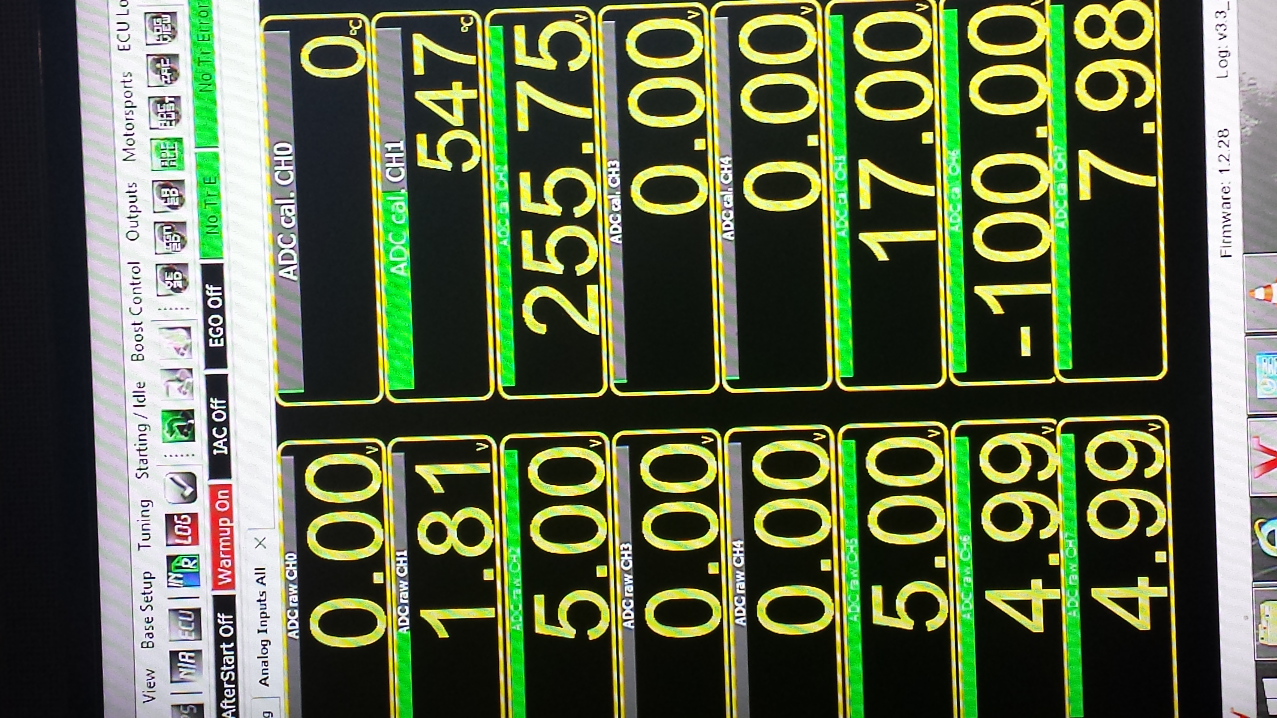

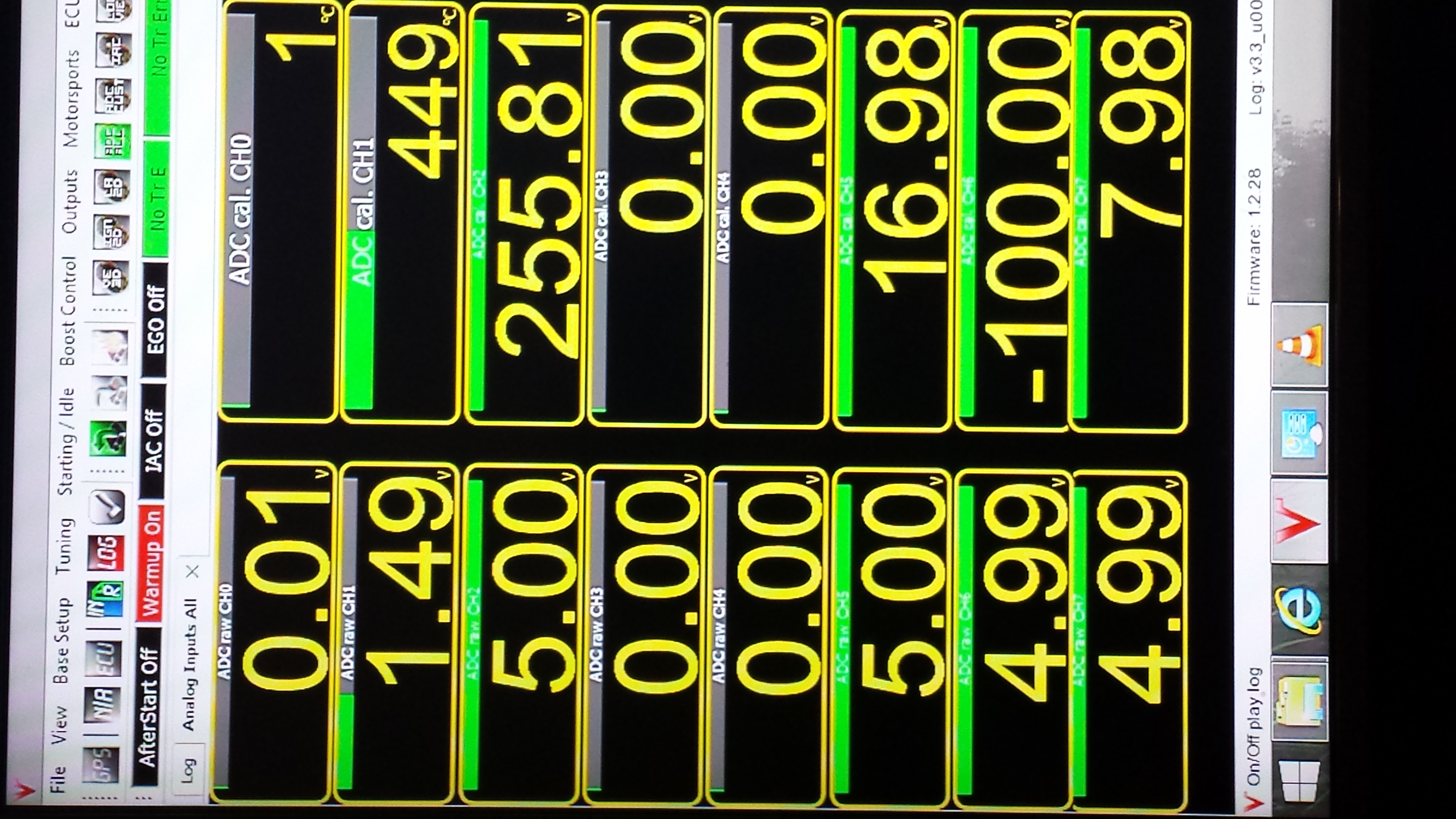

Marc helped me with the circuit above. I went back to review my log when this all went crazy and found that the only things that changed on my ADC ALL page was that ADC raw CH1 slowly rose to 1.81 v and ADC cal. CH1 went up 100 C. That 100 C seems significant. Idk.
Before:
After:
I feel like Marc deserves some big time credit for his work today. He repaires my IAT circuit and got 3 gauges working again and all since the ecu left my hands yesterday from PA! Seriously awesome support folks!

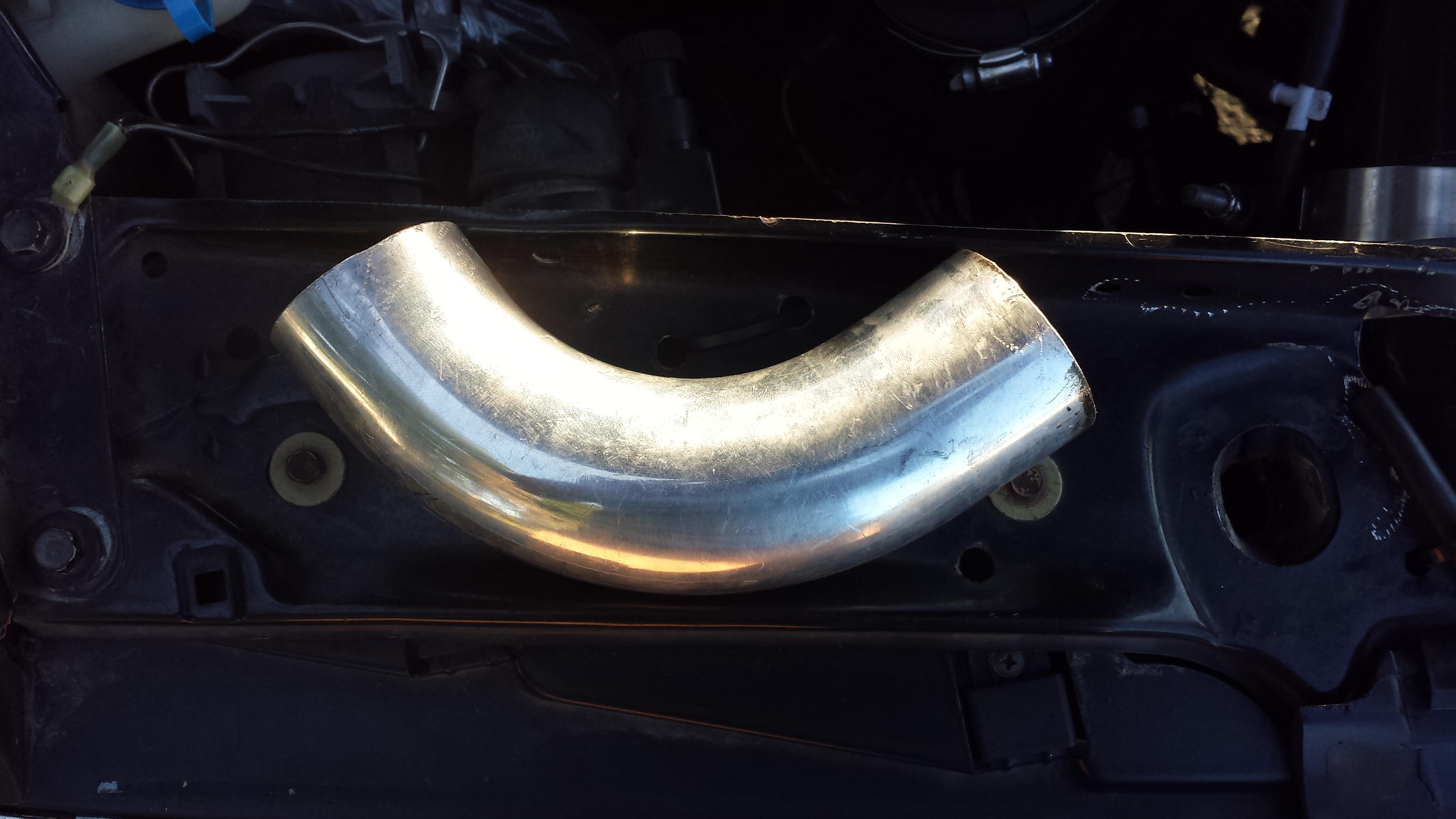

All is well ATM. Actually I had to pull this aluminum elbow back out after it was choking up my top end. Couldn't flow as much as the old silicone elbow (cut down stock turbo-IC hose)
Seems to flow much better. It's strange because the wall thickness is only slightly thicker than my other 2" OD pipes. ID is slightly less but OD of the Chinese-source elbow is small enough that the pipe can nearly fit INTO the other IC piping that 2". No I didn't bother measuring any of the pieces lol.

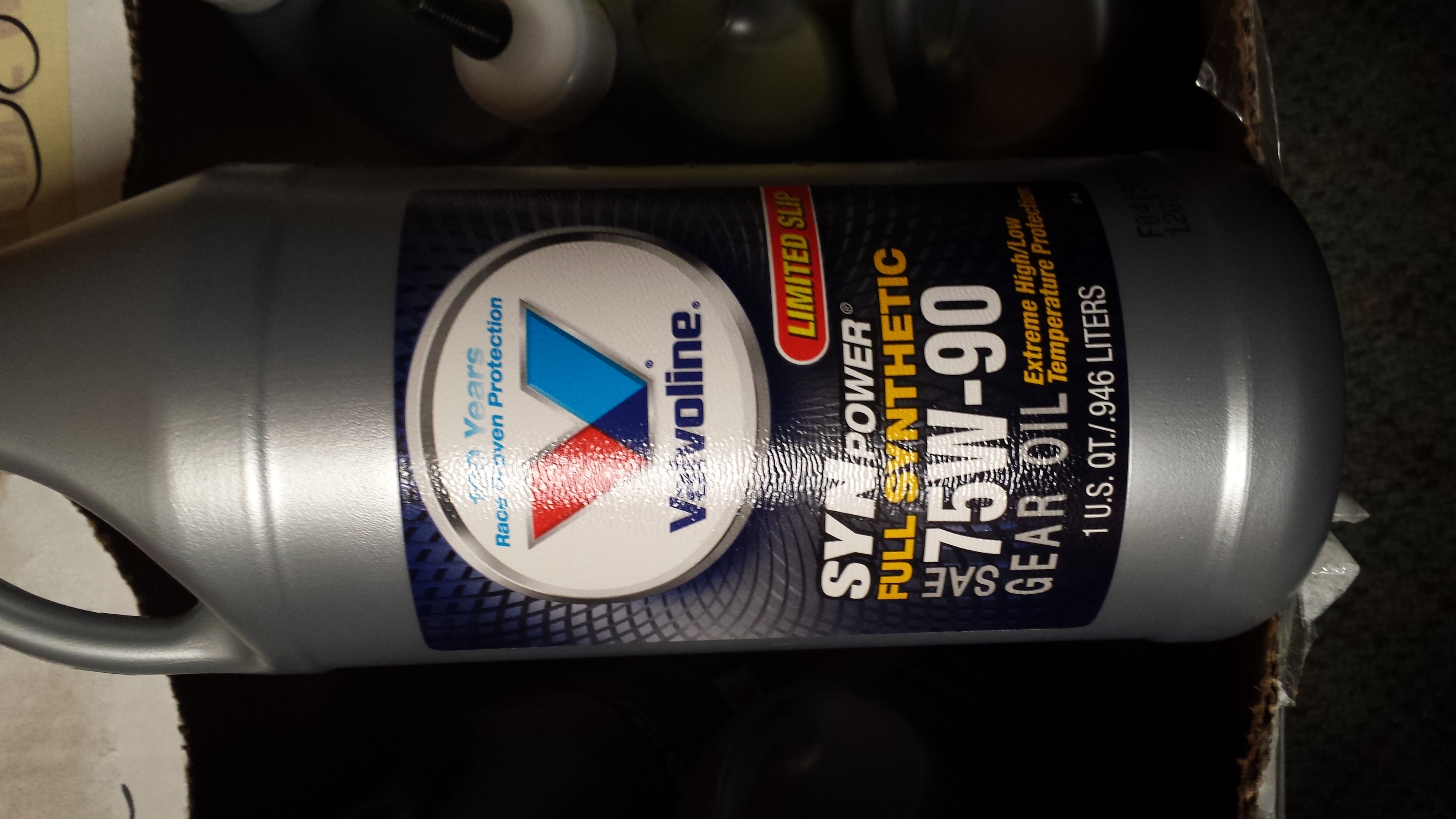

I bought 6 qts of this synpower to do the trans and diffs.
Made an appointment for it for Wednesday next week when I decided to try doing at least the trans myself. Got the fill and 1 drain plug loose but the one for the center diff has me nervous. I want to skip it actually bahaha! Can I ya think?
Anyway it's $65 labor back in my pocket if I do the trans like I want to tomorrow.
Chris, do you have an opinion one way or the other of that synpower? I believe I used it in the trans of the 5000 yrs ago... looks like it's similar to the redline mentioned on sjm. Also, I think I skipped the 2nd drain plug on the 5k's center diff as well :hide:

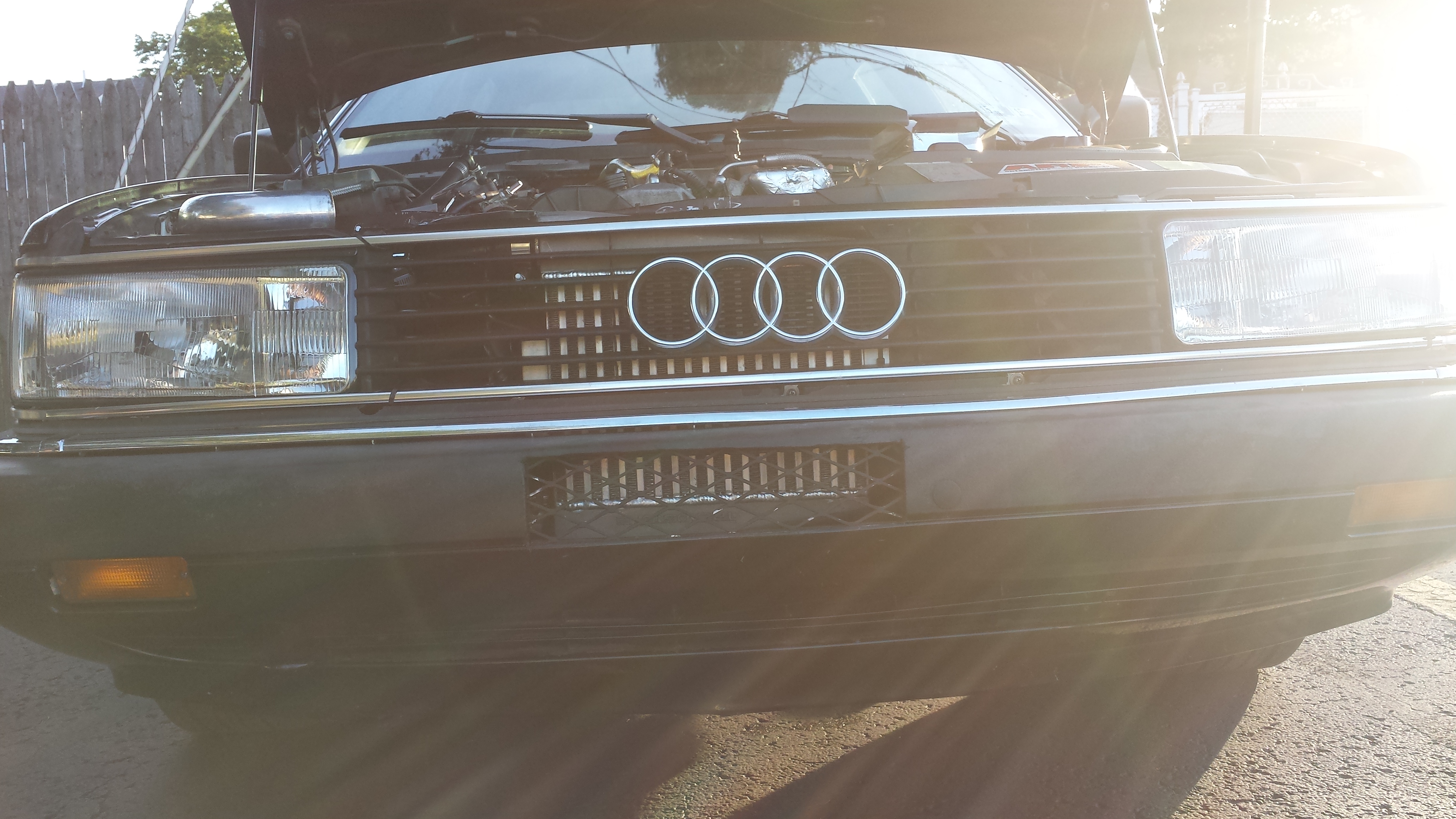

And now for a quick photo carpet bombing
That's the IC with a flat black painted grill to keep birds out.

On the synpower, no I don't really have an opinion. All I can say is that I've had good luck with both redline and royal purple although one or the other made the rear diff in my e46 louder than the other. I can't remember which I went with in the end though. I guess it doesn't matter if you're using that synpower stuff anyway!

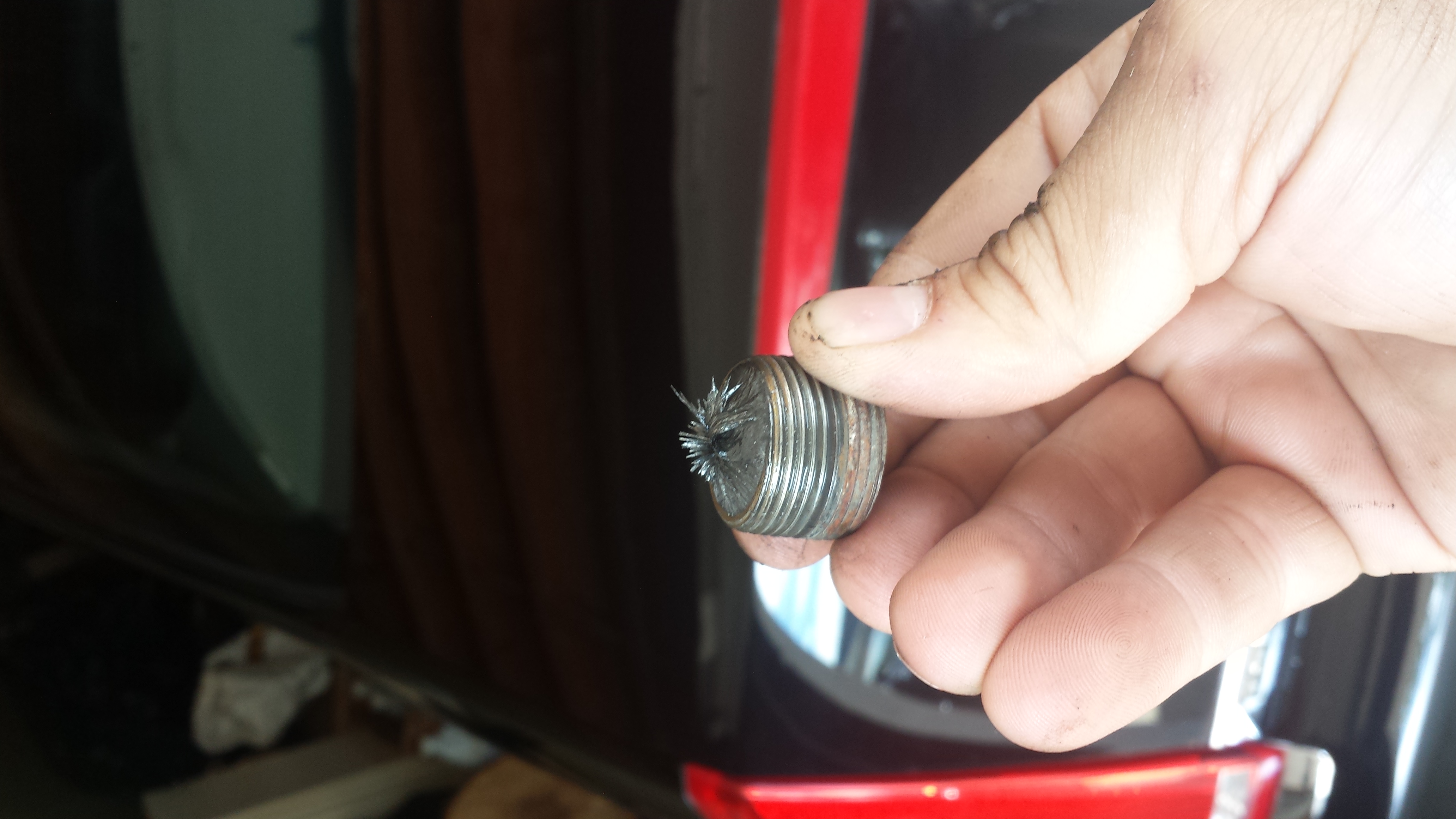

Dang this fill plug is nasty! Didn't realize they went to magnetic on the 200's tho
Ended up only being able to put ~2.9 qts in after jacking the back of the car up as well as the pass side for awhile to drain
I was really sure that the so-called normal vibration quattros make on sharp slow turns was from my rear diff but now I feel like it was the center diff having old fluid.. no longer does it. Also my shift out of 2nd to N no longer sticks. VERY slight sticking sensation. All gone ;)
Glad to hear the fluid change helped. I personally run motul, and love it!
Glad you found your problem! Changing fluid never seems to help much when I think I have a trans issue, but I guess it really does work sometimes.
Well when I saw the collection of sh#t hanging out on the magnetic drain plug I had the realization that it probably had no further magnetization left for the other still-suspended particles and new drain and dilution were my best option. Trans worked great and I actually thought the sticking of 2nd gear was due to my half-ass'd shifter bushing repair using a zip tie inside a short piece of vac hose :D it's pretty funny but effective. Good thing I'm the only local that knows it's there :hide:

The metal shavings are pretty normal by the way. Just the product of constant metal on metal interaction. The same thing happens in your engine! (get a magnetic drain plug). Also big time in the power steering systwm and everywhere! The great thing is that agnostic particles are super easy to catch.
Oh man ya that's sorta what I figured for the trans. Although I didn't realize it would be so pronounced in there. I guess when I did the 5k I didn't think about it because there aren't magnets on those plugs. It was all out of sight in the oil. Thanks for confirming my suspicions though. The rear diff is what I'm most looking forward to having done.
