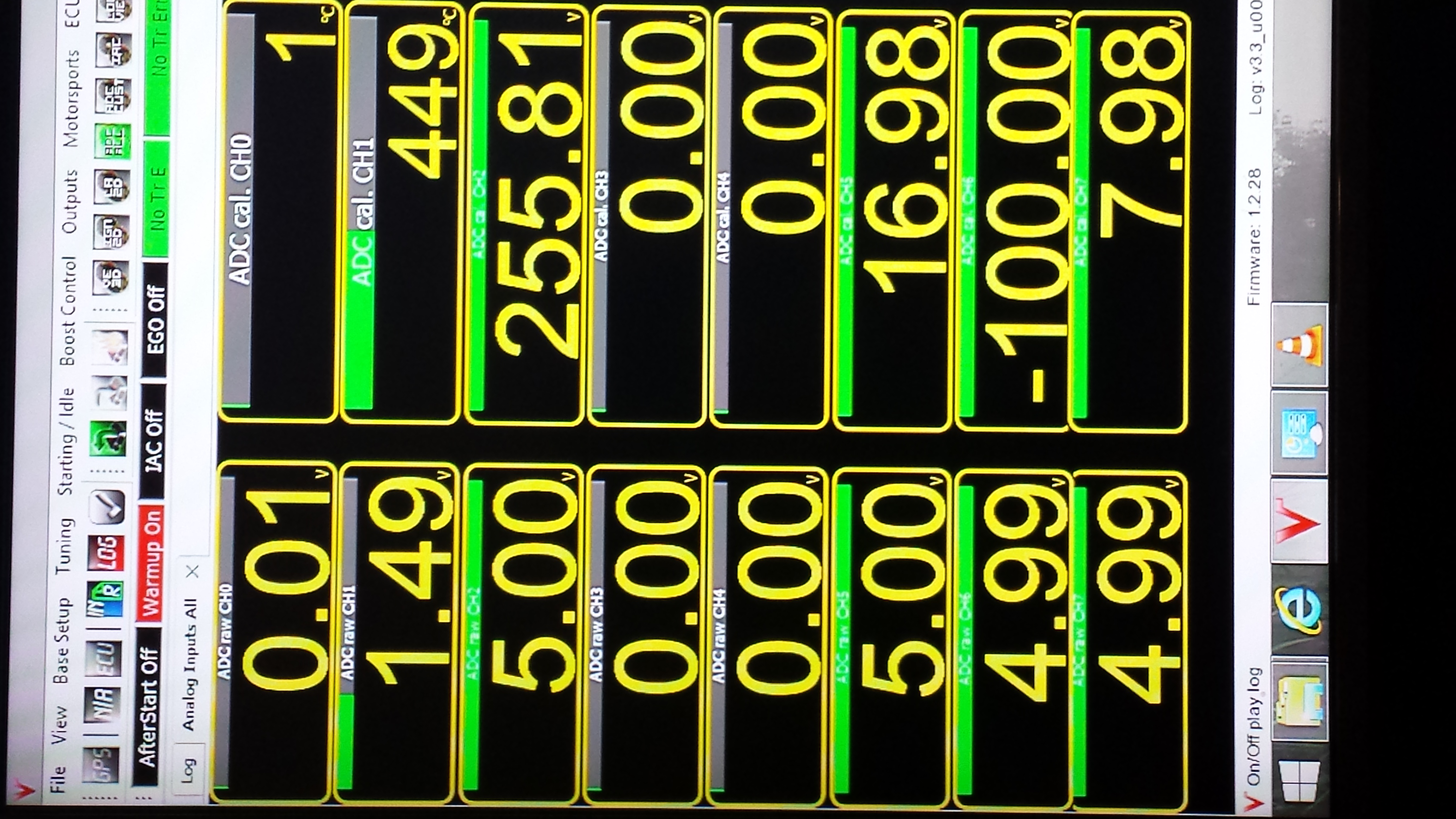

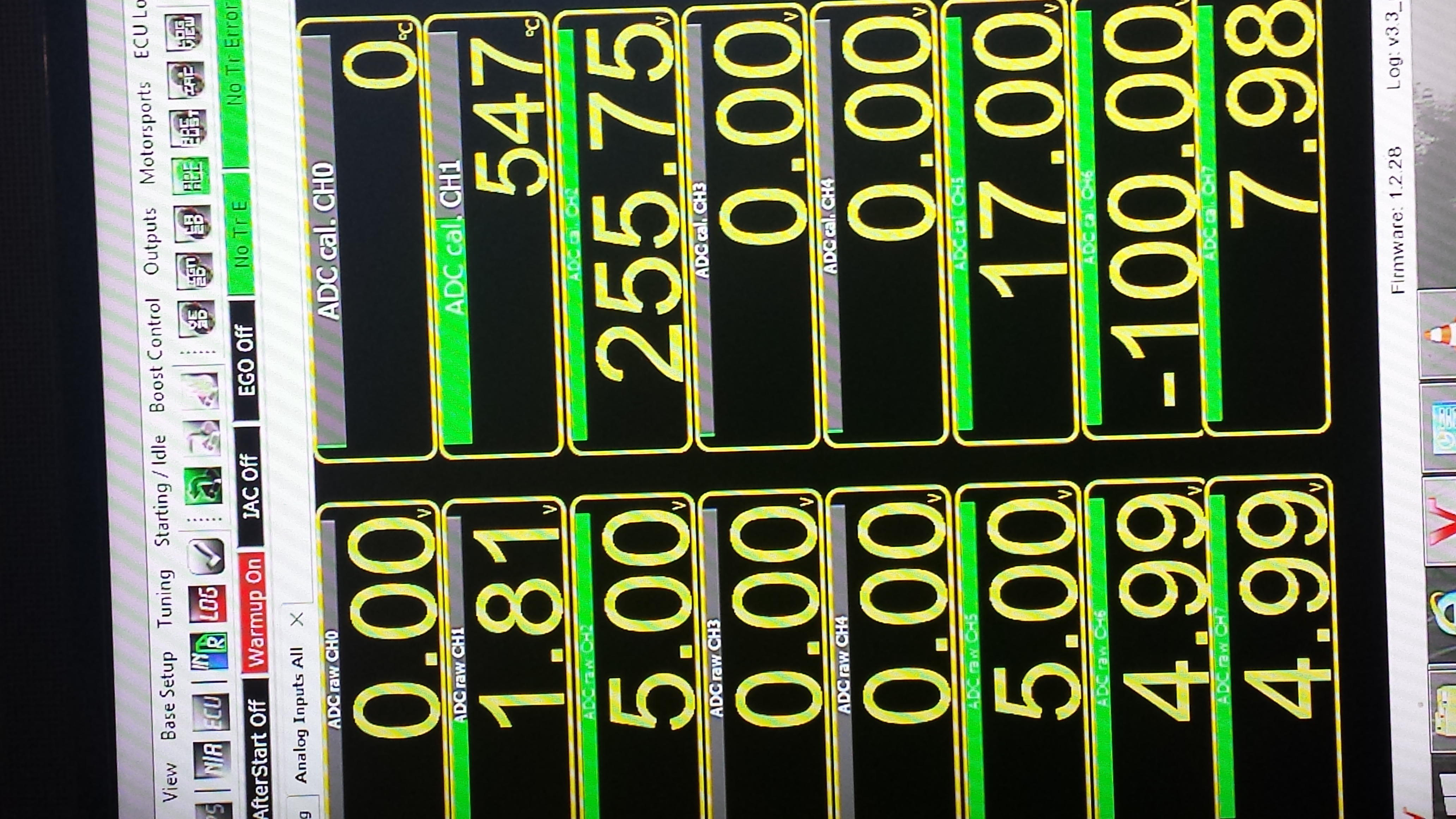

Marc helped me with the circuit above. I went back to review my log when this all went crazy and found that the only things that changed on my ADC ALL page was that ADC raw CH1 slowly rose to 1.81 v and ADC cal. CH1 went up 100 C. That 100 C seems significant. Idk.
Before:
After:

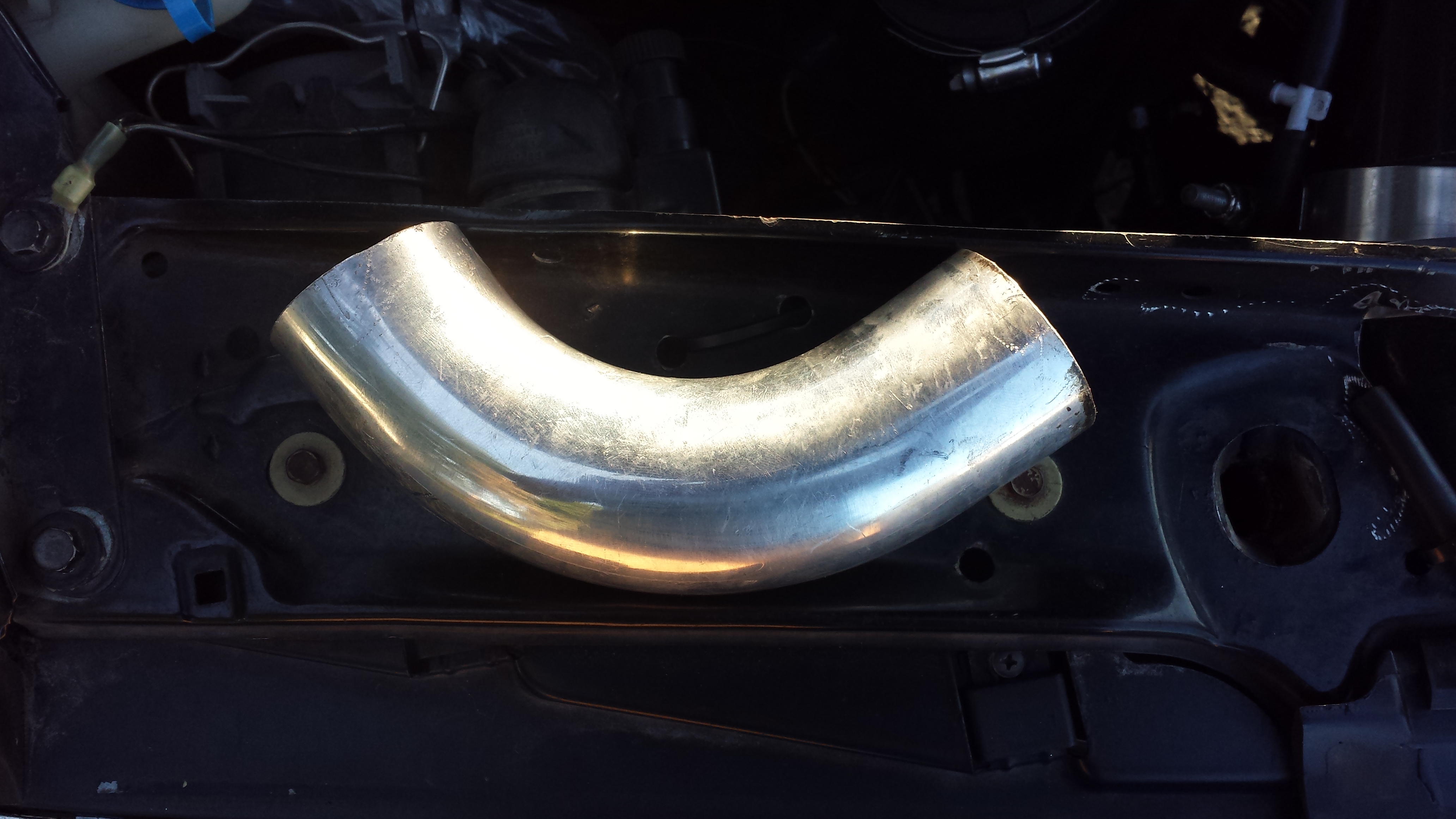

All is well ATM. Actually I had to pull this aluminum elbow back out after it was choking up my top end. Couldn't flow as much as the old silicone elbow (cut down stock turbo-IC hose)
Seems to flow much better. It's strange because the wall thickness is only slightly thicker than my other 2" OD pipes. ID is slightly less but OD of the Chinese-source elbow is small enough that the pipe can nearly fit INTO the other IC piping that 2". No I didn't bother measuring any of the pieces lol.

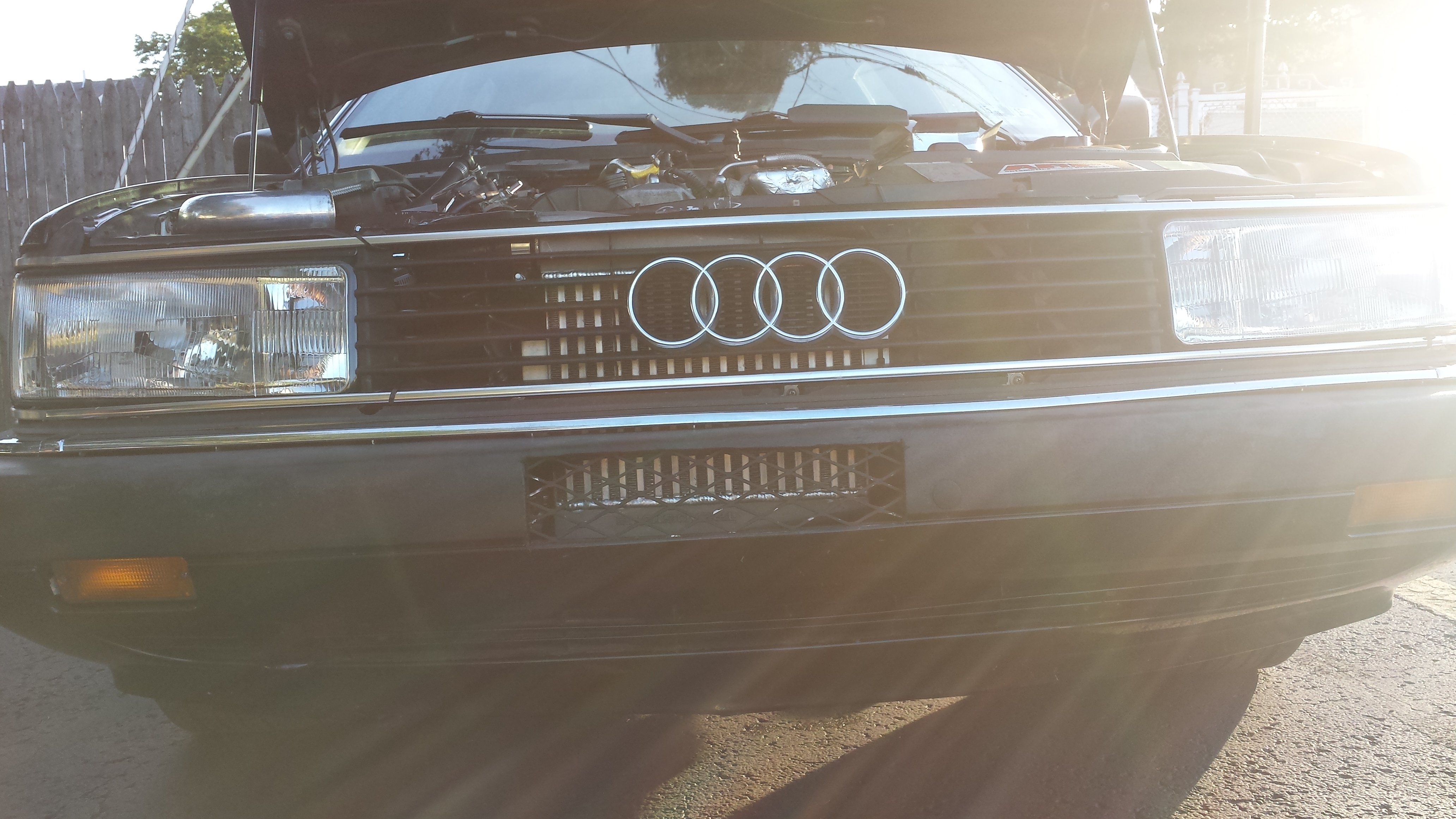

And now for a quick photo carpet bombing
That's the IC with a flat black painted grill to keep birds out.
This keeps people either away, or in today's case, tailgating and harassing-ly following me at an incredibly unsafe distance at 50 mph.

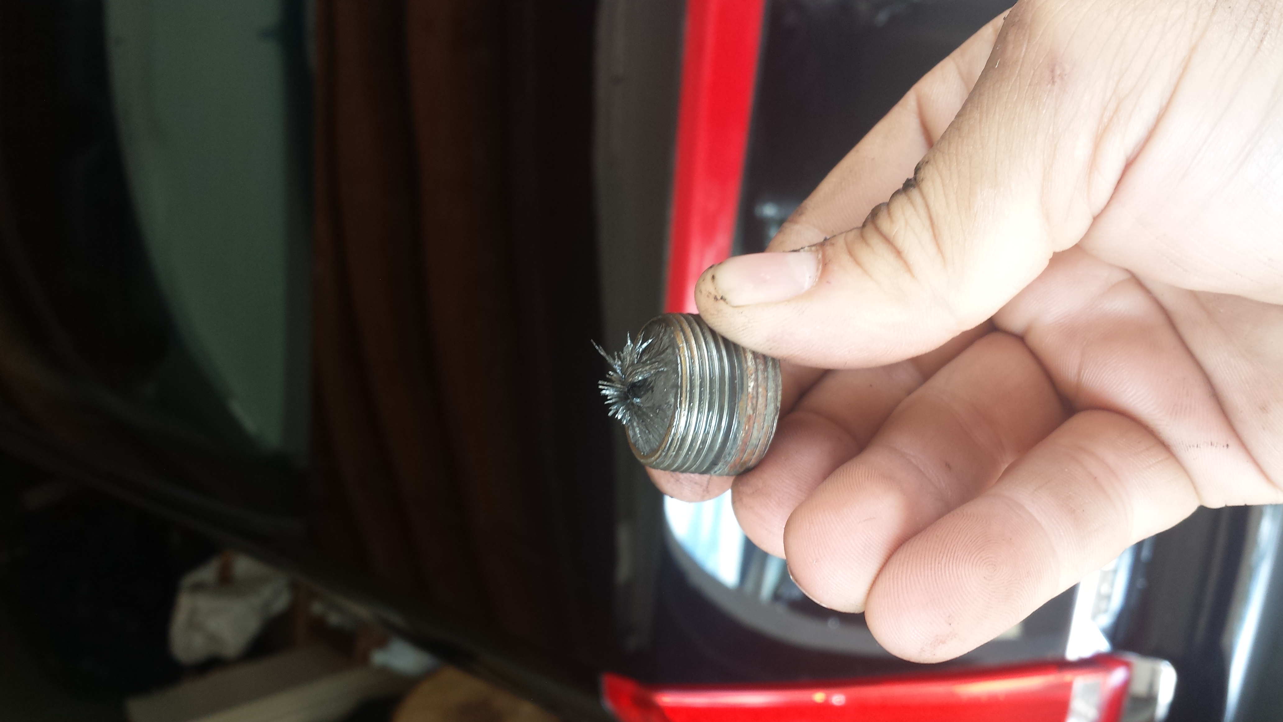

Dang this fill plug is nasty! Didn't realize they went to magnetic on the 200's tho
Ended up only being able to put ~2.9 qts in after jacking the back of the car up as well as the pass side for awhile to drain

Well when I saw the collection of sh#t hanging out on the magnetic drain plug I had the realization that it probably had no further magnetization left for the other still-suspended particles and new drain and dilution were my best option. Trans worked great and I actually thought the sticking of 2nd gear was due to my half-ass'd shifter bushing repair using a zip tie inside a short piece of vac hose :D it's pretty funny but effective. Good thing I'm the only local that knows it's there :hide:

The metal shavings are pretty normal by the way. Just the product of constant metal on metal interaction. The same thing happens in your engine! (get a magnetic drain plug). Also big time in the power steering systwm and everywhere! The great thing is that agnostic particles are super easy to catch.

Oh man ya that's sorta what I figured for the trans. Although I didn't realize it would be so pronounced in there. I guess when I did the 5k I didn't think about it because there aren't magnets on those plugs. It was all out of sight in the oil. Thanks for confirming my suspicions though. The rear diff is what I'm most looking forward to having done.
