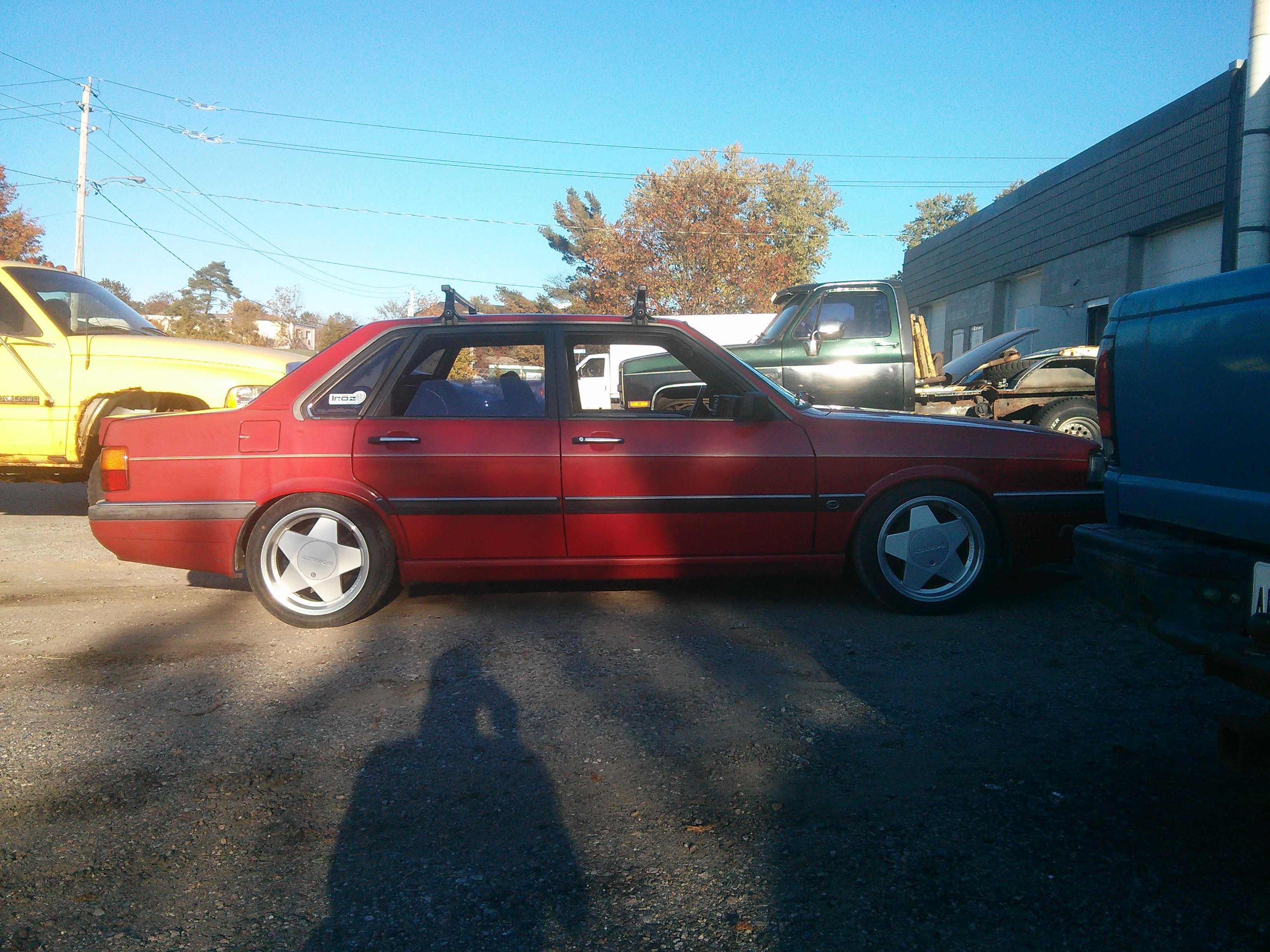

drop it drop it low now

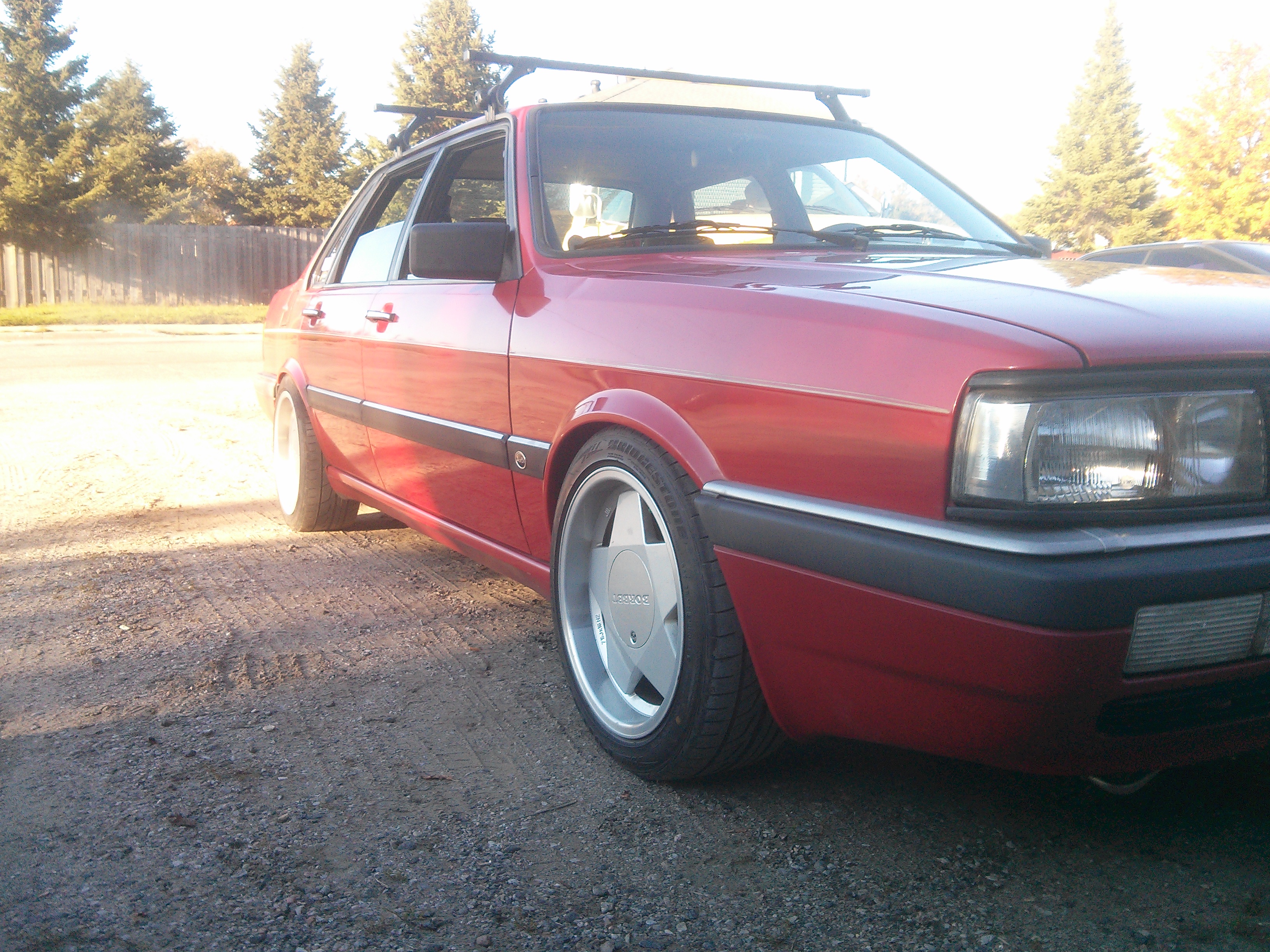

Rolled the fenders today with Andrew (okay, andrew did the rolling, I did the grunt work). no rub! even over big bumps
So my dwell settings are standard. The pulse width in logs appears to be around 10 or so way up at 6-7krpm. And lower down low. I don't know man, I'll post a log. It's time to retire the car back to the shop anyway seeing as how the ignition problem is slowly returning. What the FUNK.
Today I also blew a coolant hose, the one coming out of the back of the block. And of course it was the first day I started carpooling with someone. "Maybe next week we'll take my truck..." ugh. I got the cam for my Jetta so I'll be putting that in tonight and will relegate the 4k back to shop piece of shit.

Looks fantastic man!
Re: Matt's 87 4ktq -
Definitely looks very nice!

absolutely love the car dude the type A's couldn't look better on your car - hopefully you resist the urge to keep turning things up

What a nice car... but DAMN do I hate those wheels...lol

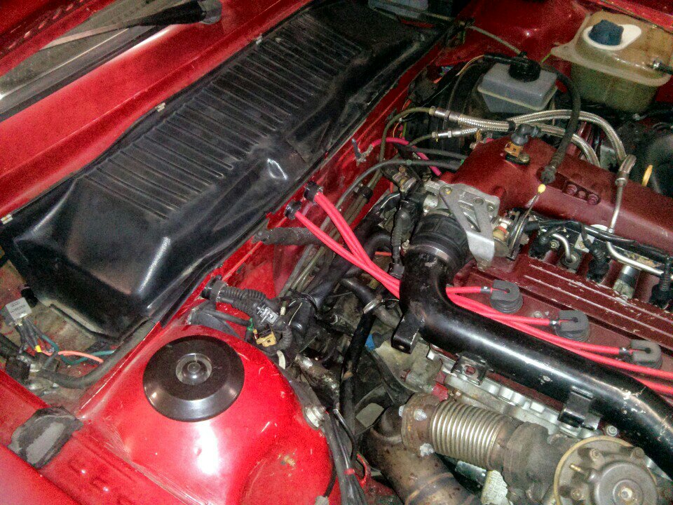

So I put my ignition under the rain tray. Really cleans it up back there and gets the coils away from the heat. I know it didn't look like it in the pic, but it's way better! Also hooked the speedo back up and figured out that I need a new alternator. Replaced the voltage regulator and it didn't do much of anything so I'll be putting a new alt in tomorrow or Monday since I have to dd this car a little more (cam for TDI was wrong one... good day today)

I really think that the coils being under the rain tray away from the heat helps a lot. I also moved the coil ground from a chassis and engine ground in one to just a chassis ground. And the new plug wires from Marc and better/cleaner routing. The trigger drop appears to be totally gone. So whatever did it, I am happy. Siiiiiiick yo
